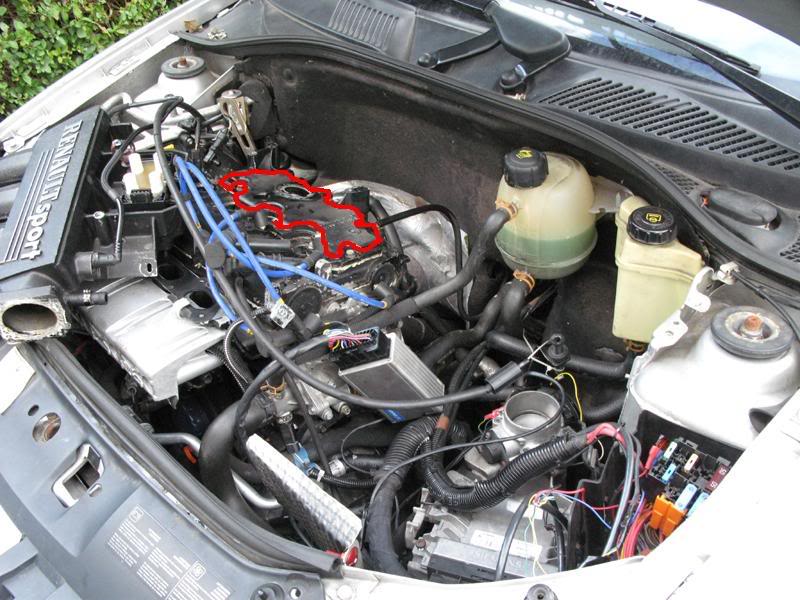

The air circ cover on the top of the cam carrier can leak thats not a cams out job. Thats at the back it might be worth a look if its leaking - same sealant gasket. If the front area of the cam carriers leaking you may aswell wait till the belts/plenums off and do the whole lot.
The Red bit in this photo. (Not my photo/bay - MarkMs)
