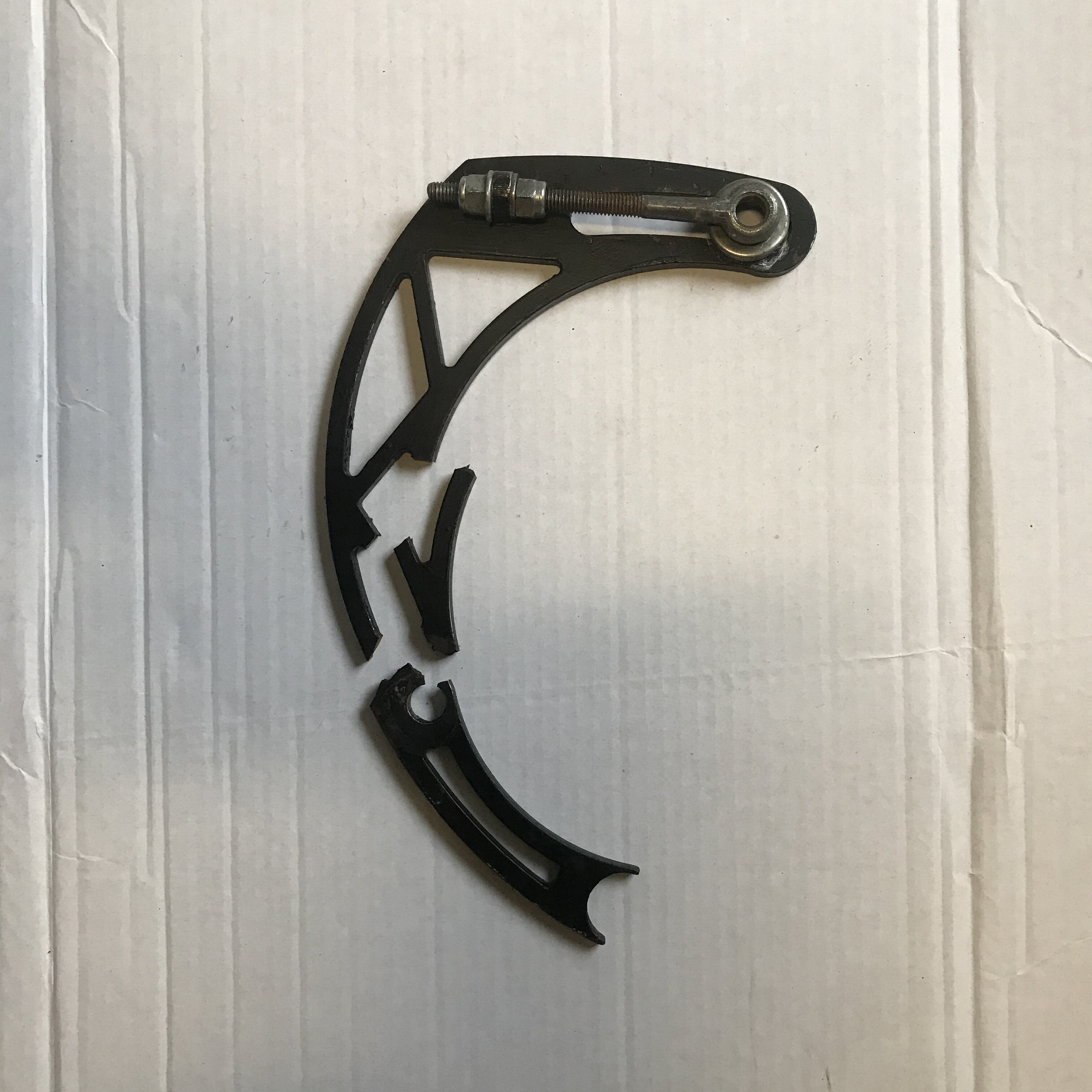

I'd avoid the mk1 (old style) bracket if you can. I'm running the new PMS bracket which is much more robust and better engineered. This one snapped on my daily whilst travelling to work, luckily i was just pulling into a car park so the auxillary belt didn't get a chance to wrap around the timing belt and destroying the engine. Just a thought.

Im looking to run cup set up on my track car and pontentially change to the new version pure set up , i did see people have had failures , i bought mine new but the car has just been parked up ! Shame Pure didnt replace them free of charge for the poor design

My mates have the Clio 182 which is road legal but more track focussed. They're going EPAS and have bought the new PMS A/C delete kit with the 6PK PAS pulley kit after loosing the PAS Pump at Croft a few months back. The new PMS kits are very good though, nice and light and feel solid, but i'm not 100% sure i'd run it on track. I don't even trust it on my daily to be honest after what happened with the MK1 bracket, but i needed to keep my car on the road. I'm sure it'll be fine but time will tell I guess.
Yeah its not very good them selling a product that costed alot of money ! I bought the original one but my car did about 300 mile on it and i sold it as i got a cup set up , the new design does look far superior and havent heard of any issues yet
