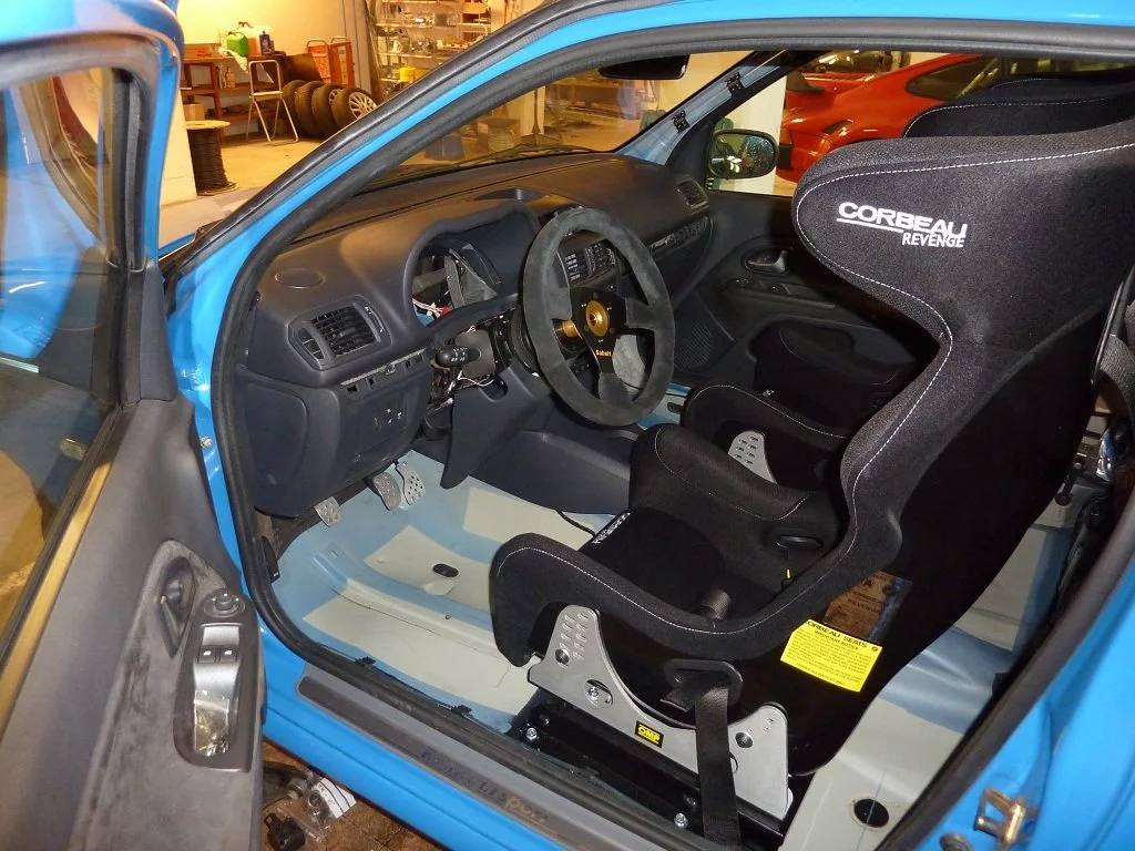

Removed original seats + plastic spacers under standard seats. However it seems like the OMP subframes dont sit right in a horizontal position. The checking it with a spirit level confirmes this. The side closest to the center of the car need to be spaced up by 23mm in order for it to be correct. Subframes come with no spacers or instructions so I find this very strange.
Has anyone else experienced the same kind of problem?

Pics might help mate
8783_2011-02-14-p1050534.webpView attachment 52359View attachment 52361
Because my pc have crashed I dont have propper images avaliable atm. So these will have to do.

Using all plastic spacers wount help this at all, they are of different height and will actually make the problem even worse. Even if i only use the center of car plastic spacers its still needs to go up about 10mm further to be horizontal. Now i have the seat in horizontal position, by having no spacers on the outer mountings and 23mm alu spacers on the inner ones. Would be kind of sweet to get the seat position down by those 23mm!!
Cunney: Since my interiour was striped out I noticed the strange angle looking at the subs through the boot, otherwise I would not have noticed. Did you check yours with a level? If not are you able to do it?
