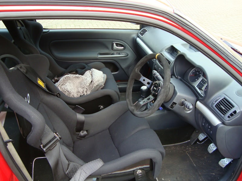

Anyone got any pics of these fitted? Theses ones : http://www.kamracing.co.uk/index.ph...ories/renault-clio-mk2-omp-seat-subframe.html
Im trying to move my sparco buckets back and lower as the previous owner of my clio was quite a bit shorter than me and I cant drive anymore with my knees on my chest.
Im 6ft 1 and using Sparco Sidemounts at the mo. These are the ones I have http://www.sparcousa.com/pseats_acc.asp?id=152
I've been wrestling with these all day, trying to find a way of getting a lower and futher back seating position.
Any help would be appreciated :)
I have them, you can go quite a way back, but they give you quite a high driving position when combined with side mounts ...
The subframes are only maybe 4mm thick. You can bolt side mounts to this and set the seat in them as low as possible. You may want to look at a smaller steering wheel and a spacer so you can get your legs straighter and seat further back . Something like the OMP Corsica 330 which is a dished wheel
Ive already got a small steering wheel and drive with the column at its lowest setting due to the seats being lower then the OE ones. I think the main issue is the previous owner mounted the bracket on the transmission tunnel, Im guessing where the stock mounts are originally? This means they are offset compared to the ones nearest the sill.
I guess what I'd like to know is do the OMP subframes attach to the original subframe mount points and give you more flexibilty to attach the side mounts.
