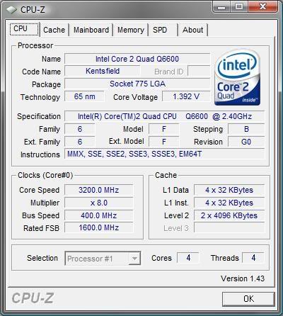

Is it the B3 or the G0 stepping version?
My G0 version runs at maximum 55deg full load and about 28deg idle at 3.2ghz. you could have some cooling issues, 70c does seem a bit excessive, what volts are you running at? I would possibly try upping the multiplier to 9 and have the FSB at 356 ish, then it should run at standard FSB volts and around 1.4v for the core.

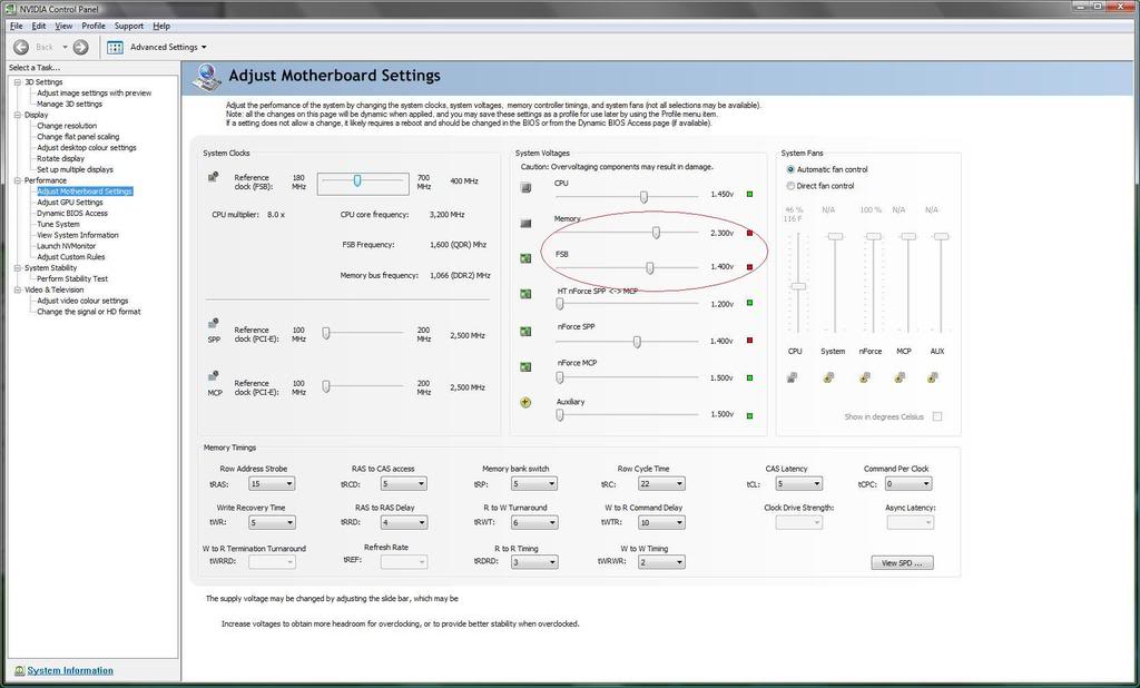

haven't changed the volts. Although oddly in ntune (didn't use this for the overclock but installed it to look around) the volts have red dots by them on fsb and memory, should I reduce their voltage you think?
CPUz said g0 I think...
CPUZ doesn't show the actual stepping code.

CPUZ does show the stepping code. This is how I found out ebuyer had sent me the B3 when I had ordered the g0, i then got a replacement and CPUZ changed to g0 stepping as soon as i put it in.
I use Everest Ultimate for temperatures, but afaik Coretemp is also fine.
CPUZ shows "stepping" and "revision". It does not show the actual stepping code, batch or week number.
Saying that you're correct and it should identify a G0 by the revision field.

I mean, if I turn voltages down, could it cause an issue? Just worried about them being marked as red in ntune...

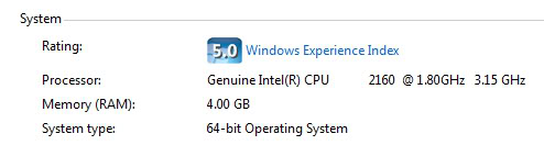

any of you know why windows reports my cpu as Q6600 @ 2.4ghz? instead of the oc'd value?

Isn't yours a dual core? They run a fair bit cooler than the quads.

this is what i'm worried about...the red dots

The name/description of the cpu is hard coded as "Q6600 @ 2.40GHz". If you go into "System" you'll see it actually says something like "Q600 @ 2.40GHz 3.20GHz".
Edit - Like..
  BMW e46 320 Ci Sport
woooaa in windows properties it says Q6600@ 2.4ghz 3.6ghz how can vpuz and the bios both be reporting differnet? well confused.

Also memory voltage is quite high. 2.3v should not be needed Looks like you are running 1066mhz memory. So 2.1v should be more than enough at standard clocks.

ok i've lowered the voltages on fsb and memory, they've now gone yellow in the ntune software
BTW i DIDNT OC FROM NTUNE! i done it from the bios, i just looked a ntune while i was monitoring stuff.
