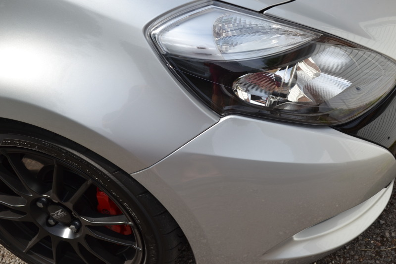

Good colour match

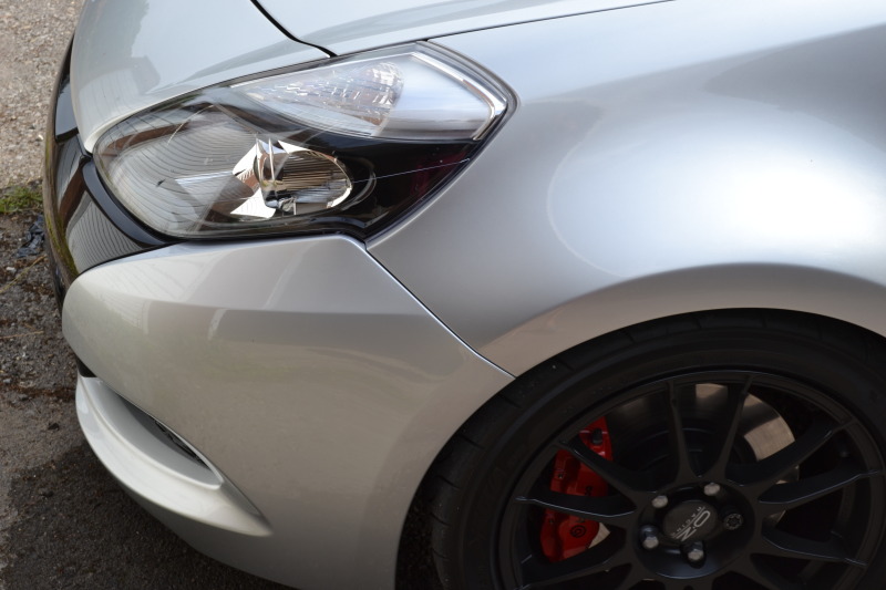

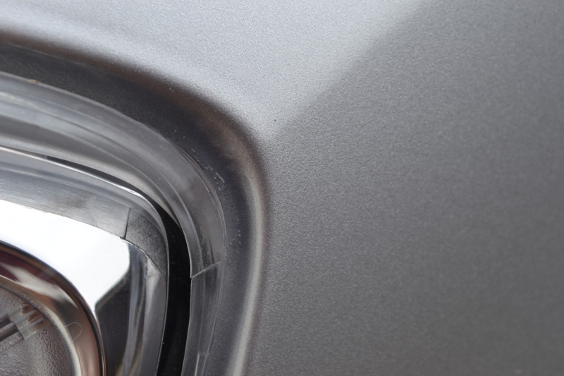

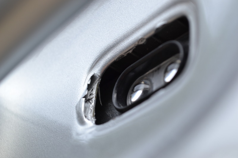

Paint coming off behind passenger headlight

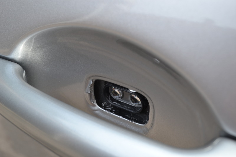

Alarm sensor in passenger door handle was ill fitting last week, now its disappeared.

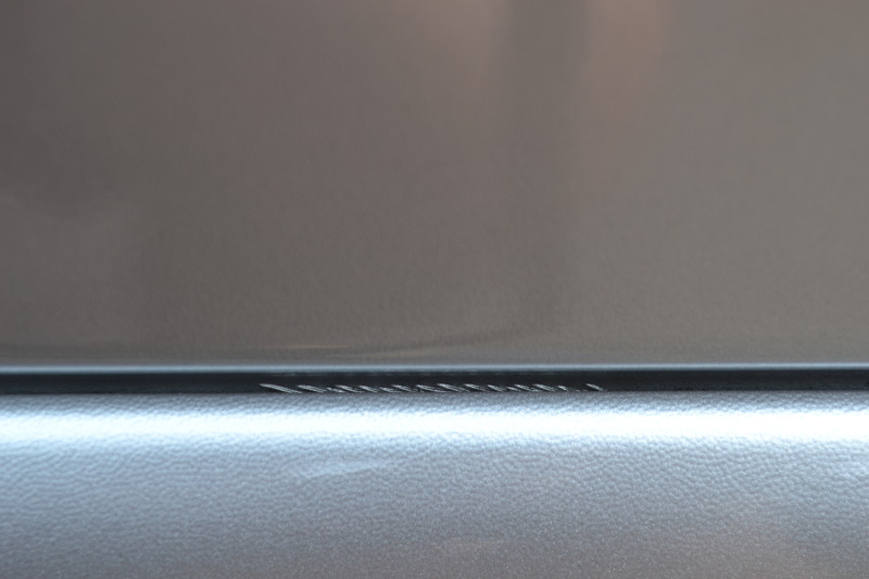

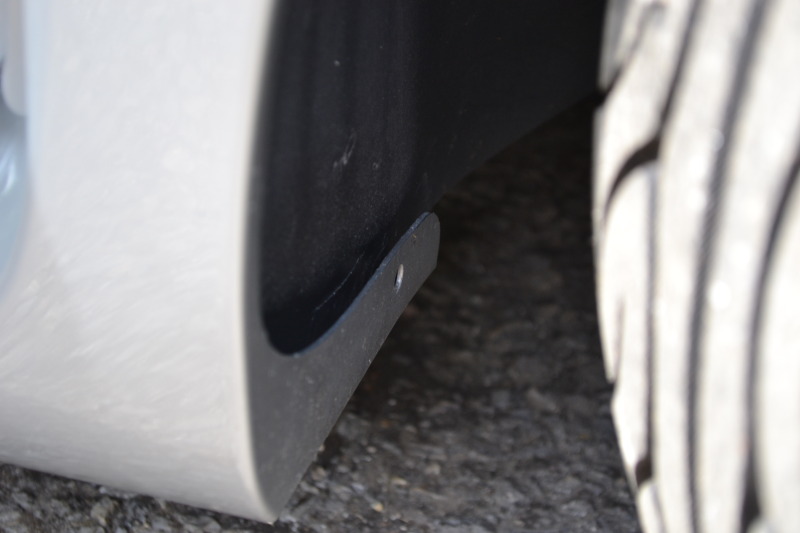

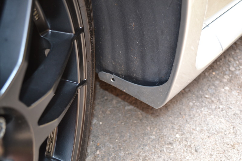

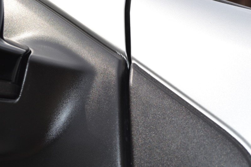

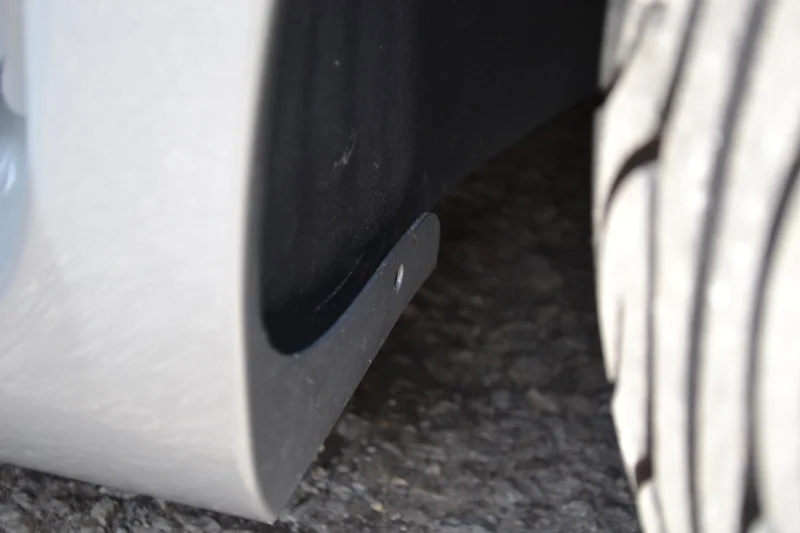

Passenger side skirt, so much over spray and these marks

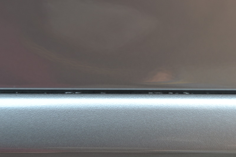

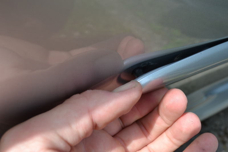

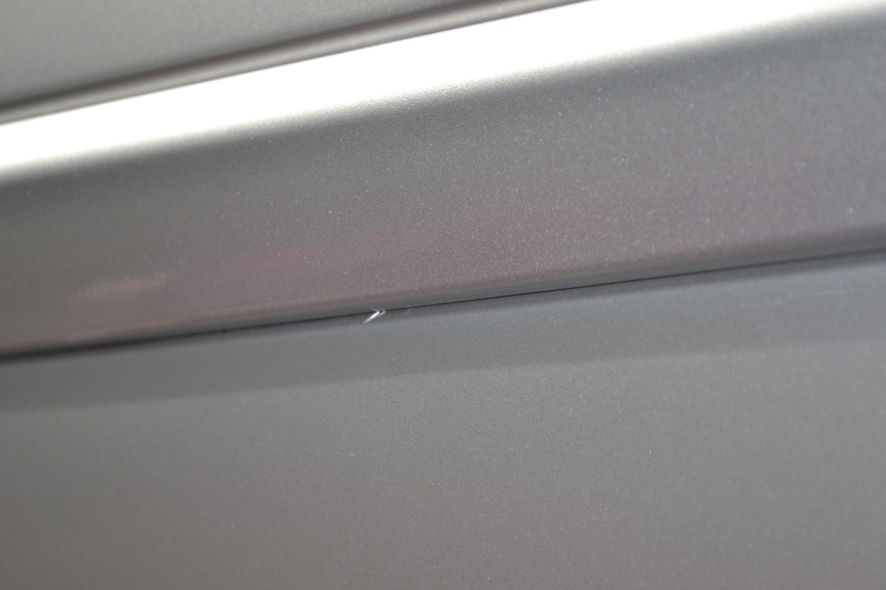

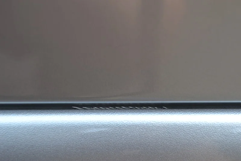

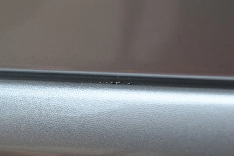

Under the passenger door trim it looks like the paint is creased where they have put them back on too soon
All the way along... I tried to take the trim off but im guessing its been held on with more of the black stuff as it would not shift :banghead:

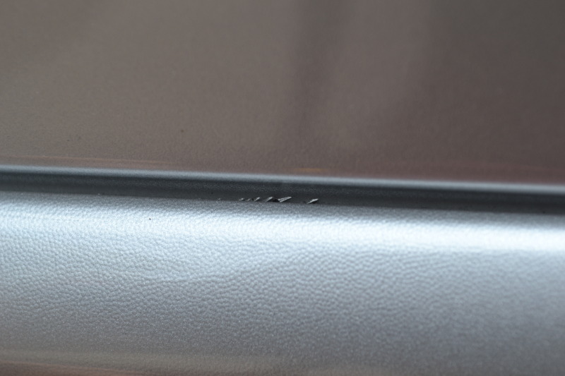

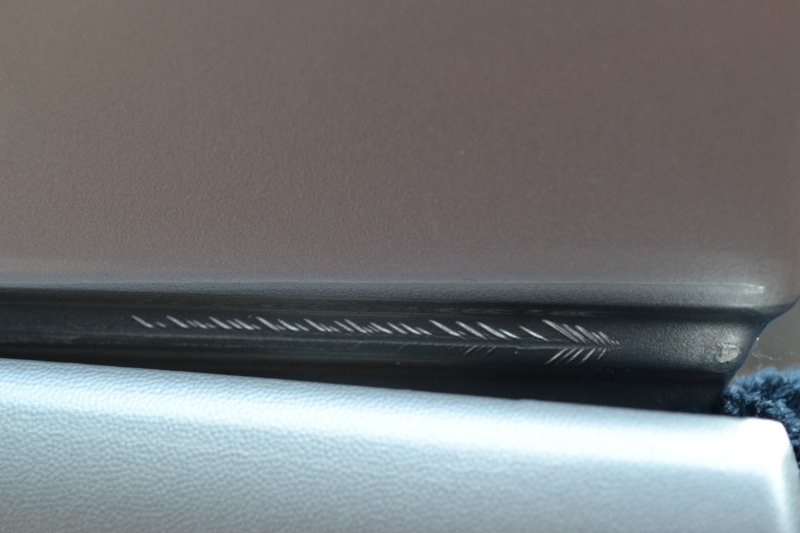

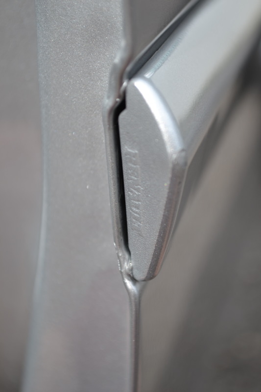

More on drivers door trim
Plus the trim is painted to the door!!! Which im also guessing is held on with black stuff!

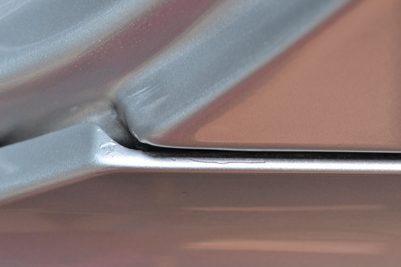

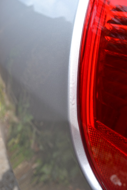

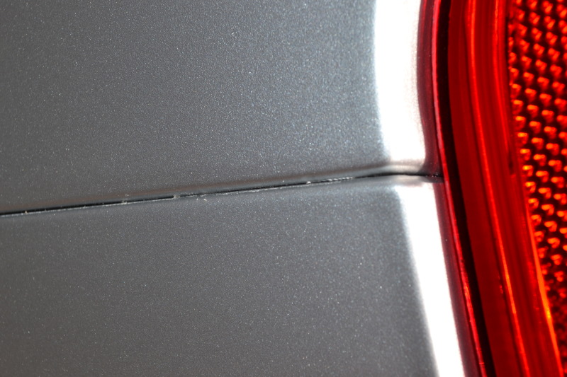

Rear wing painted to bumper and more creases!
Runs

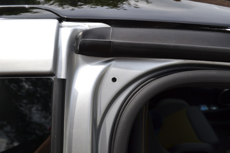

Various clips missing and broken!
More creasing
Plus on top of it all the paint finish is dreadful. I still have lines around most panels and in places they have just sanded it back with a rough finish!

That is fcuking terrible! I don't have much else to say unfortunately :(

The door trims are a little textured from factory but the paint finish as a whole is dreadful. Im not 100% sure but i think i have found a pube in the paint on the drivers front wing, along with loads of defects! Most of the problems i have shown above are the obvious ones as my SLR does not like silver paint and wont focus half the time. The car looks great from a distance but the closer you look the more horrors you find.

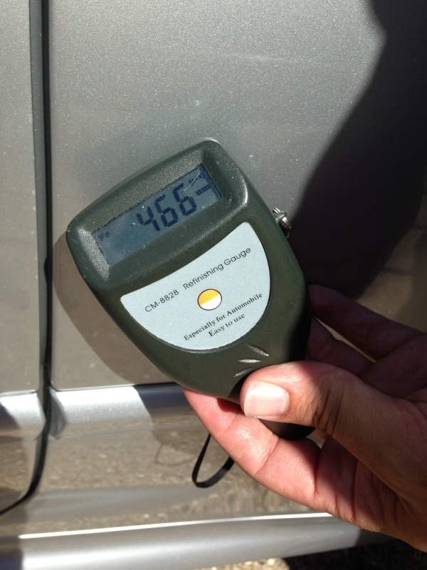

Ok well I went and saw Nick at "Detail My Car" today (nice chap) to get some paint depth readings taken to try and figure out what the current state of play is.
finding we're as follows:
Bonnet = 125
Passenger door = 335+
Passenger rear wing = 466+
Boot lid = 116
Driver rear wing = 373+
Drive door = 398+
Spot what's been painted!
:eek:
With the front wings being plastic I have no idea but I can only imagine its 500+ as these have been resprayed 5 times now!
Bonnet = 125
Boot lid = 116
Drive door = 398+
