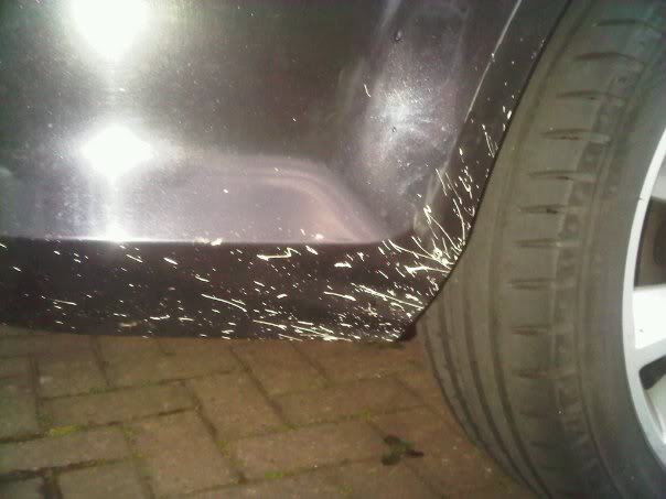

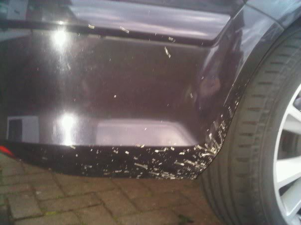

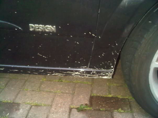

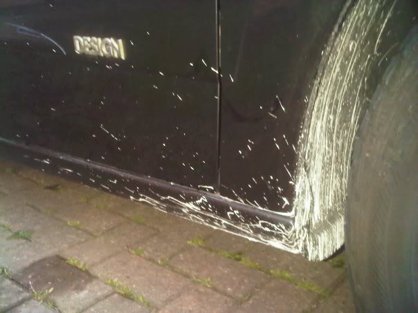

A mate of mine has driven through some paint on the road...
are there any products that will lift this off? or how would he go about getting it off?
Thought you guys could help as i didnt have a clue :p
Awful quality photos(blackberry) but you get the idea.
No idea what kind of paint, he said it was all over the road so i presume its fallen off the back of a van. looks like gloss though.
Would wd40/petrol not damage the paint at all?

I would suggest starting with a TFR or Traffic Film Remover. Then gradually up the chemicals if that doesn't s**t it.
G101 at 4:1
Failing that, Tardis.
Failing that, IronX.
If this doesn't s**t it, your only route is an agressive clay, designed to remove overspray, then polish.
Petrol won't definitaly damage the paintwork unless you pour it and leave there for 2 weeks.
i drove over a spray can that exploded red paint all over my mini
my brother used the autosmart tar remover i thnk it was (big blue square tin)
came straight off
