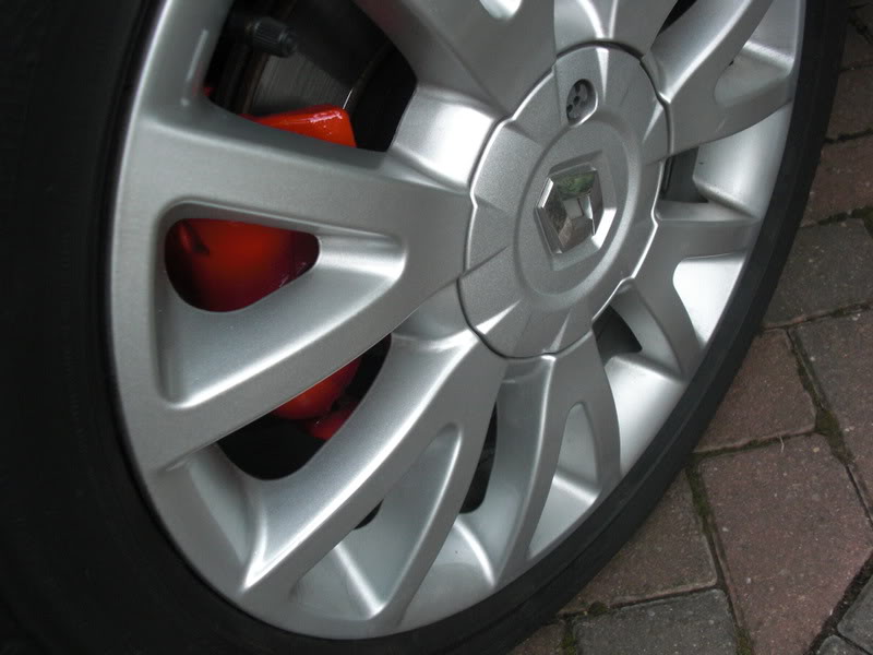

Painted mine with £5 caliper paint from Halfords, took about 3 - 4 coats but gave a great finish:

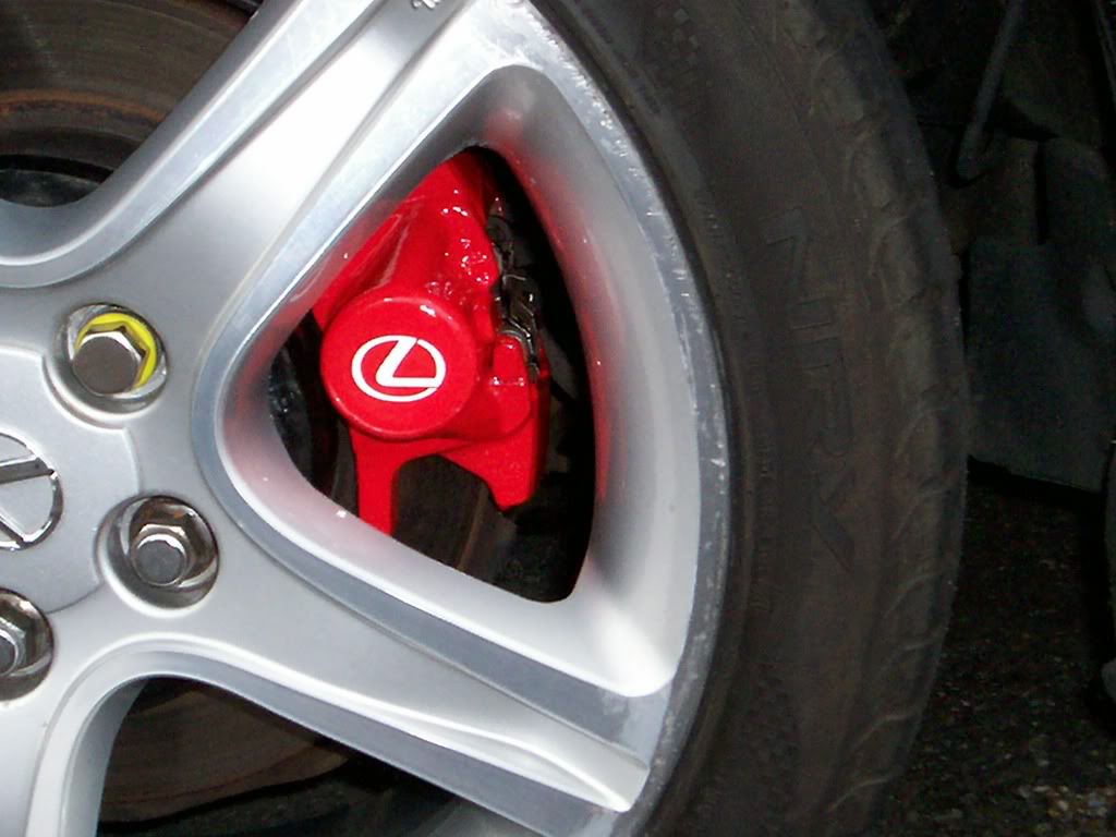

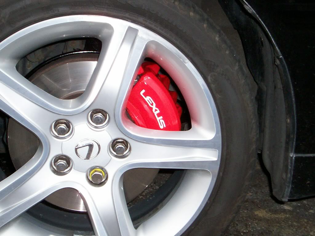

Use Hammerite smooth , I've done loads on all sorts of cars and have never had a problem , just make sure you prepare the surface properly and get rid of all the rust and get it as smooth as you can , give it plenty of coats and you can acheive a powder coated finish . here's a pic of my Lexus ones.
Decals are from e-bay
Regards.
