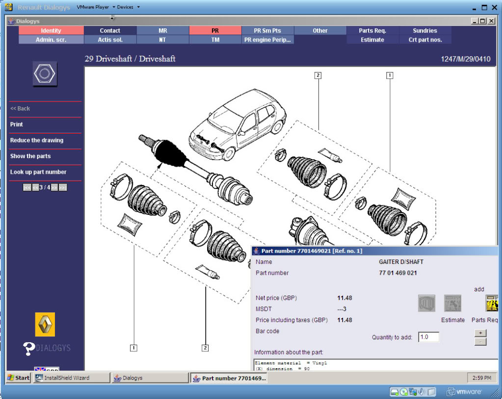

You'l more than likely need the outer (closest to the wheel)...
I just checked that on the phone when ordering some other bits, only apparently gone up by 3 quid more than that price, lol.
On what price Jord? The £36 or the one on your screen shot????
Cheers for the help btw, so the outer one ja?? Does it come with grease etc?

Mine was for a 182 so might be different part number, its a recent version of dialogys too. Feck knows.
13 quid or something, they've got one in and put it aside, don't wanna go get it and it be the wrong one mind... hmmmm.
Oh, and another question, is that definately drivers side?!? Can't see if it mentions that on your SS.
The image shows it coming with both clips, the grease and the boot, so it should...

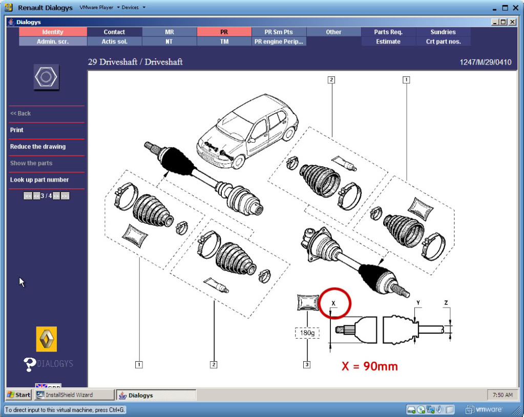

Dialogys says its for driveshafts that are 90mm at the widest part, which is the end of the boot that goes over the CV part of the driveshaft. Measure yours, if its 90mm, the one they have got is correct.
