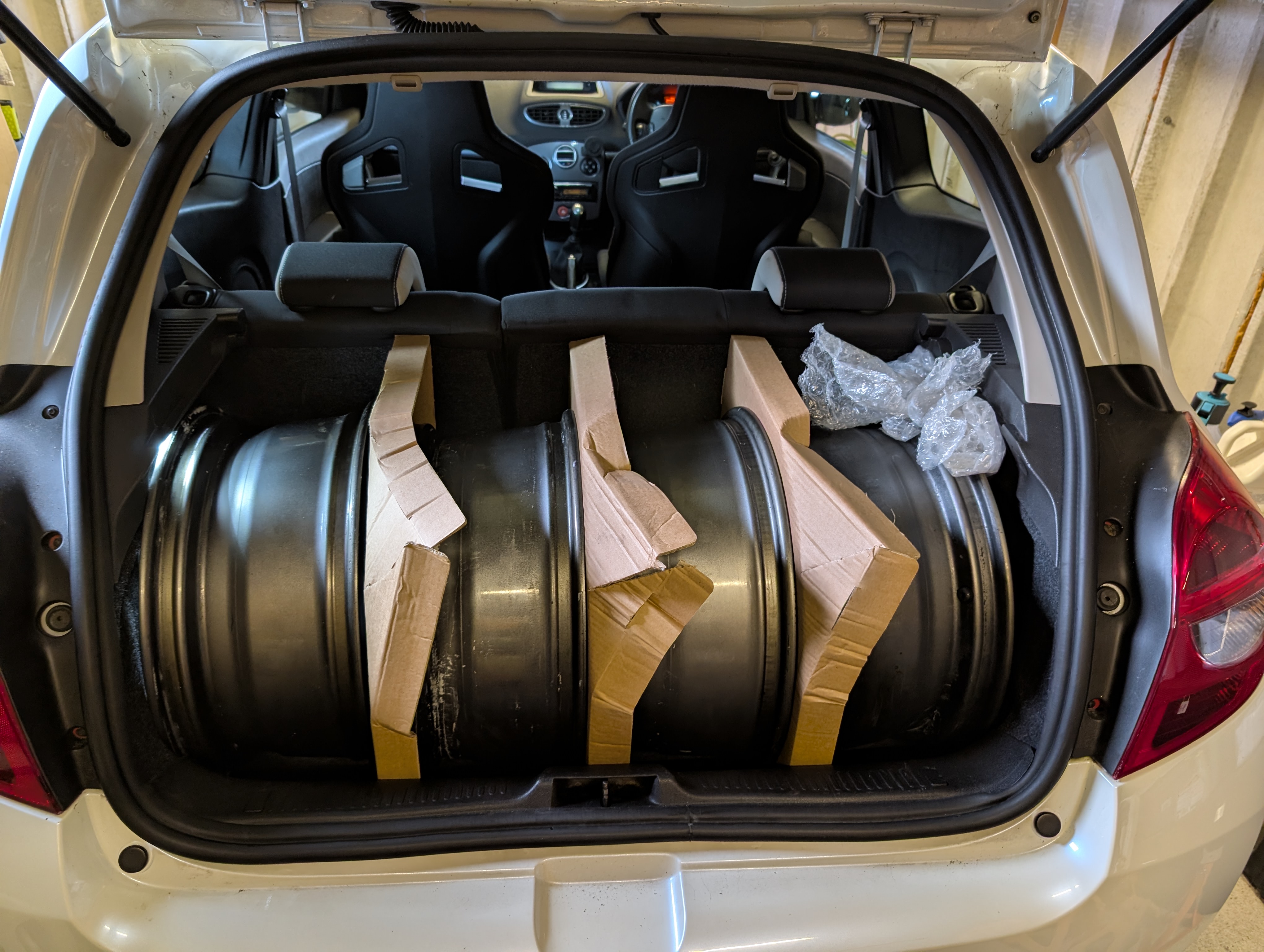

New tyres tomorrow so I loaded up the wheels in the car. Who needs an estate car?

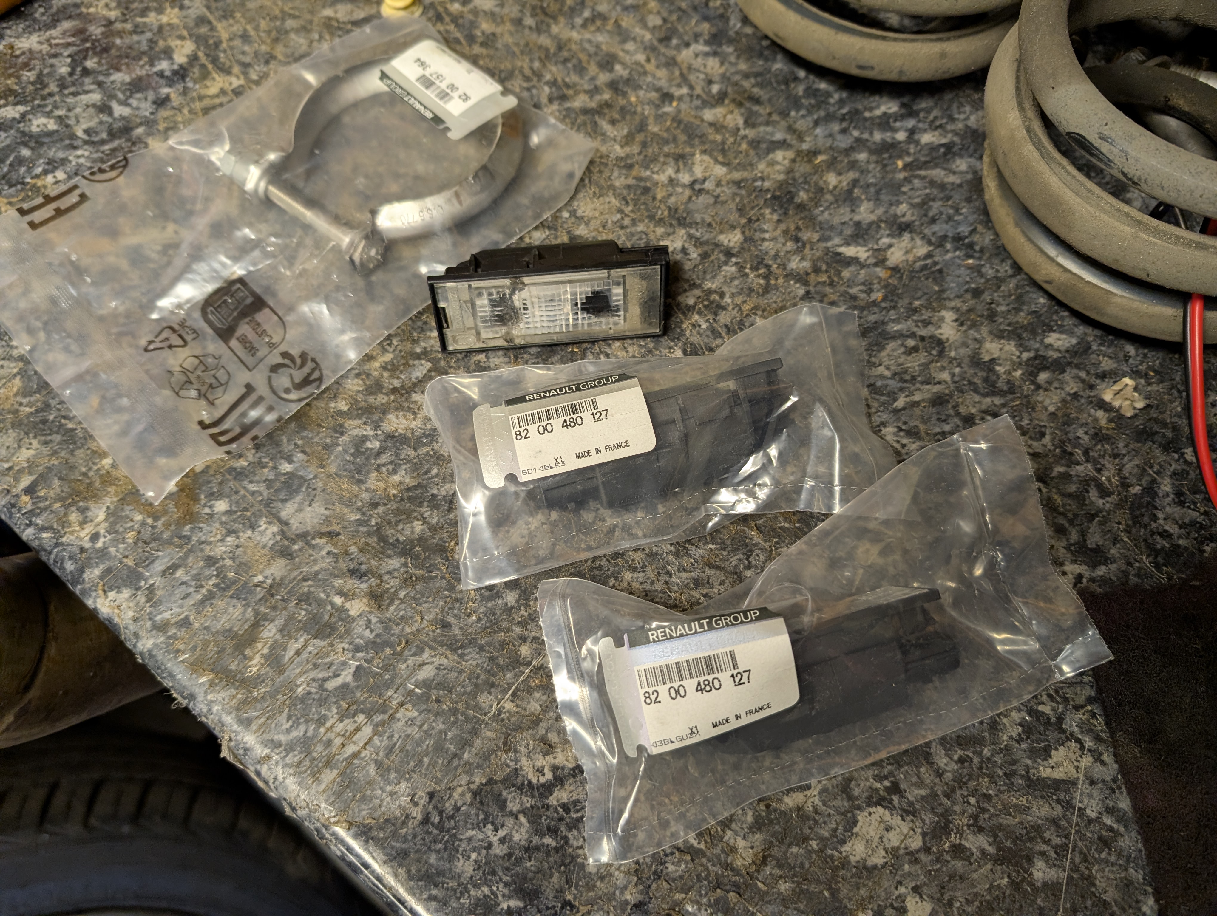

And I fitted the new number plate lamps. Turned out both the old ones had broken covers so now I have 2 nice clear ones and no led bulbs in sight.

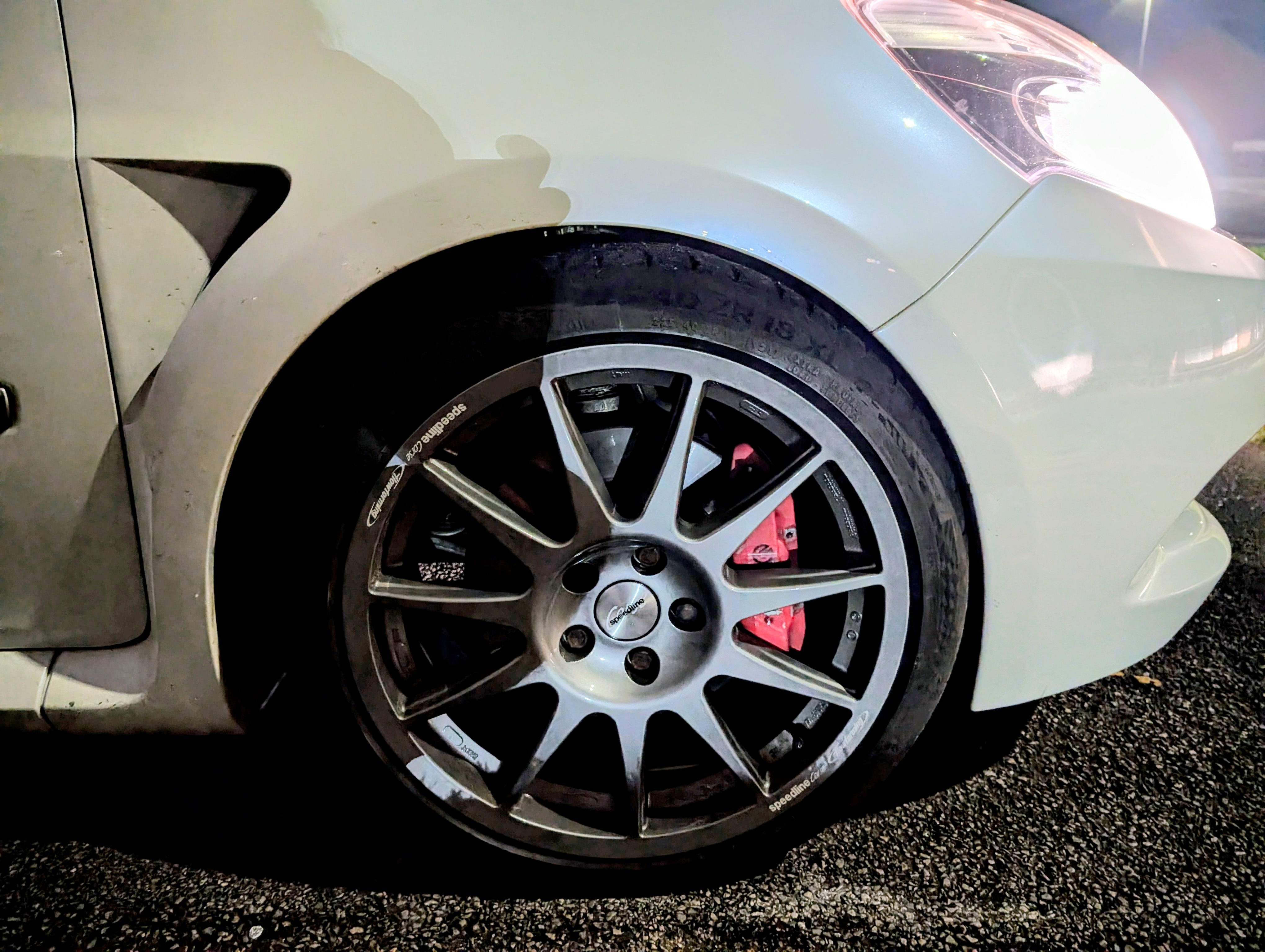

Ooft f**k off with your 2118's Turini's for the win 😍.

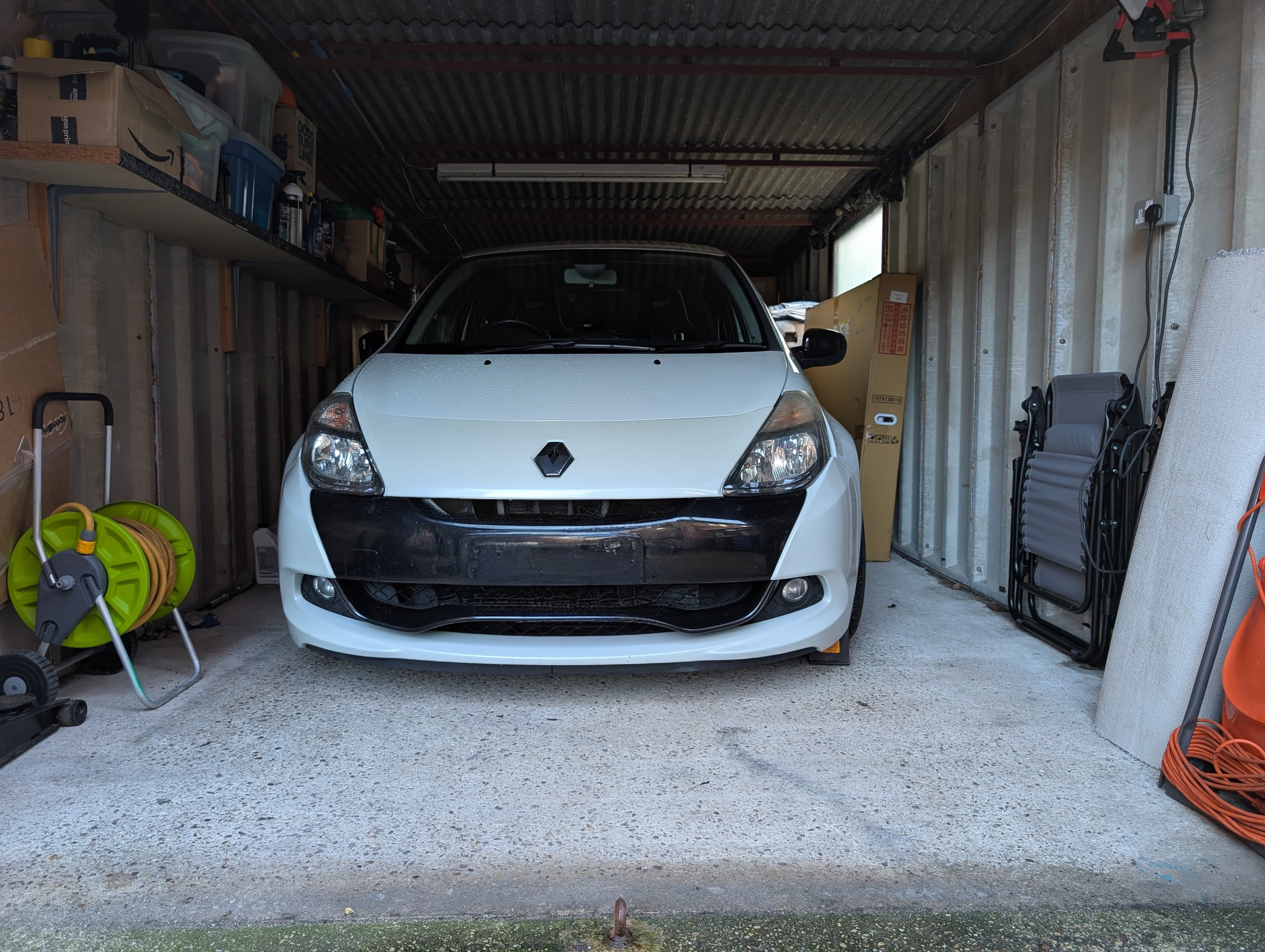

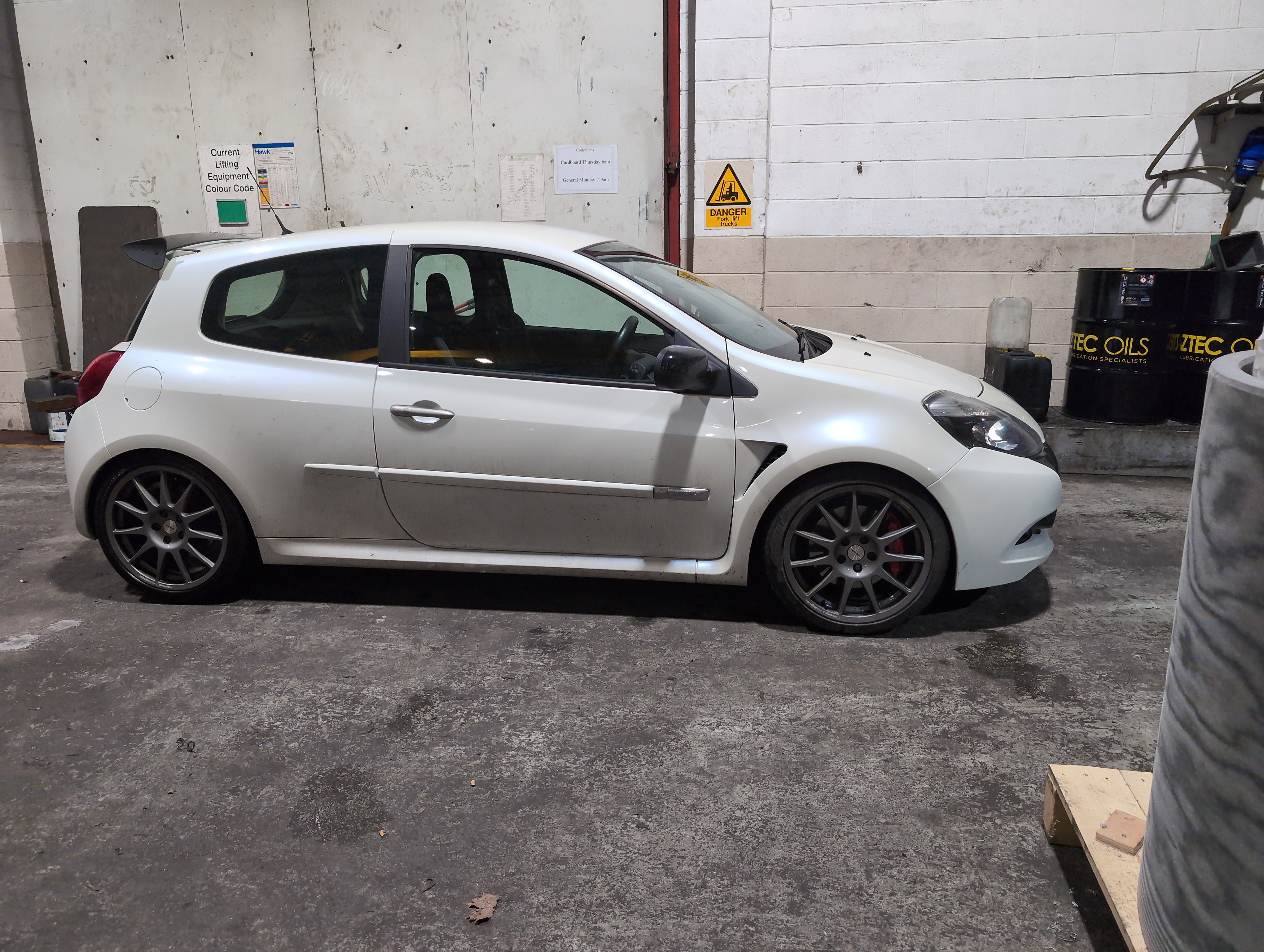

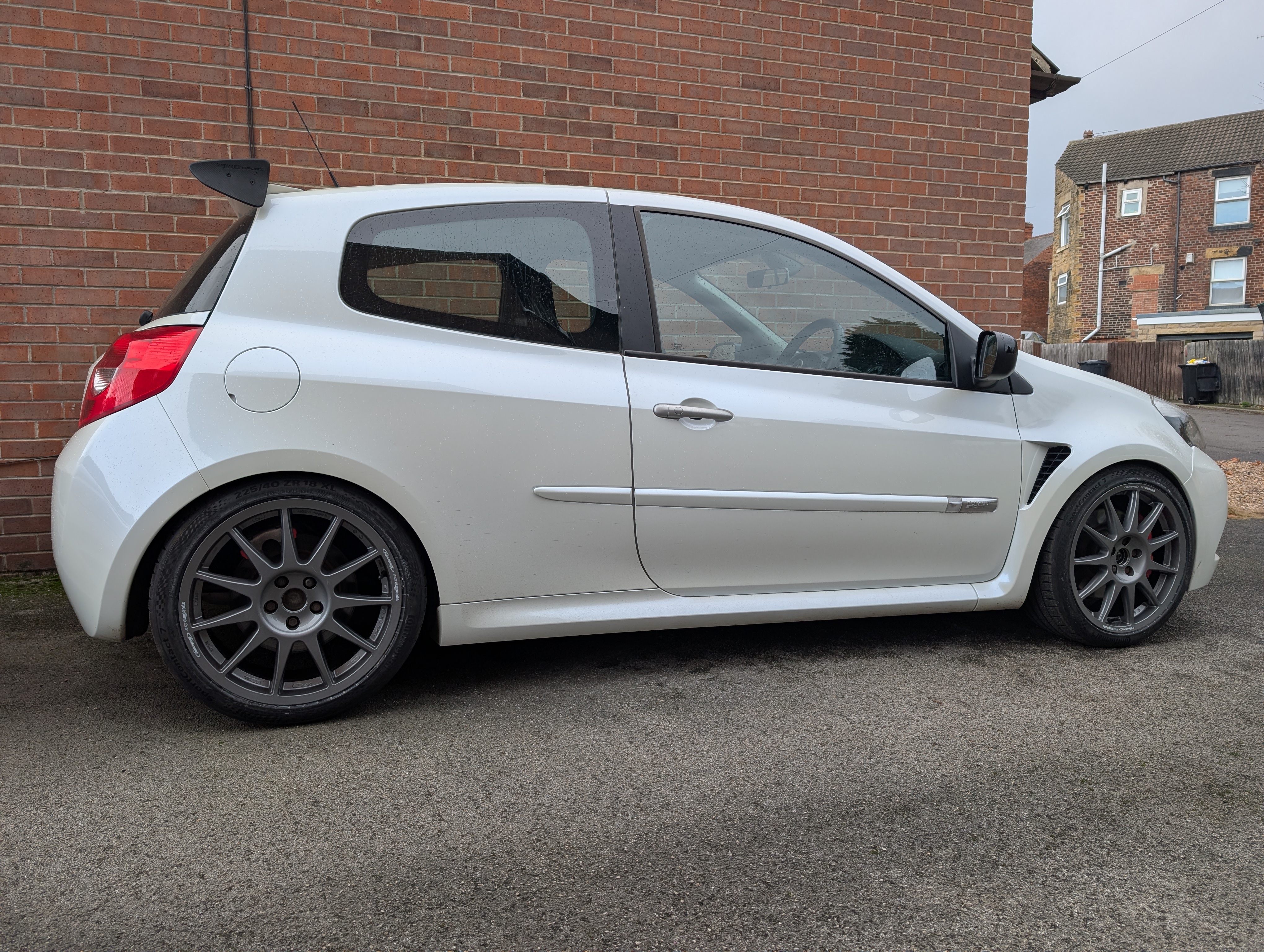

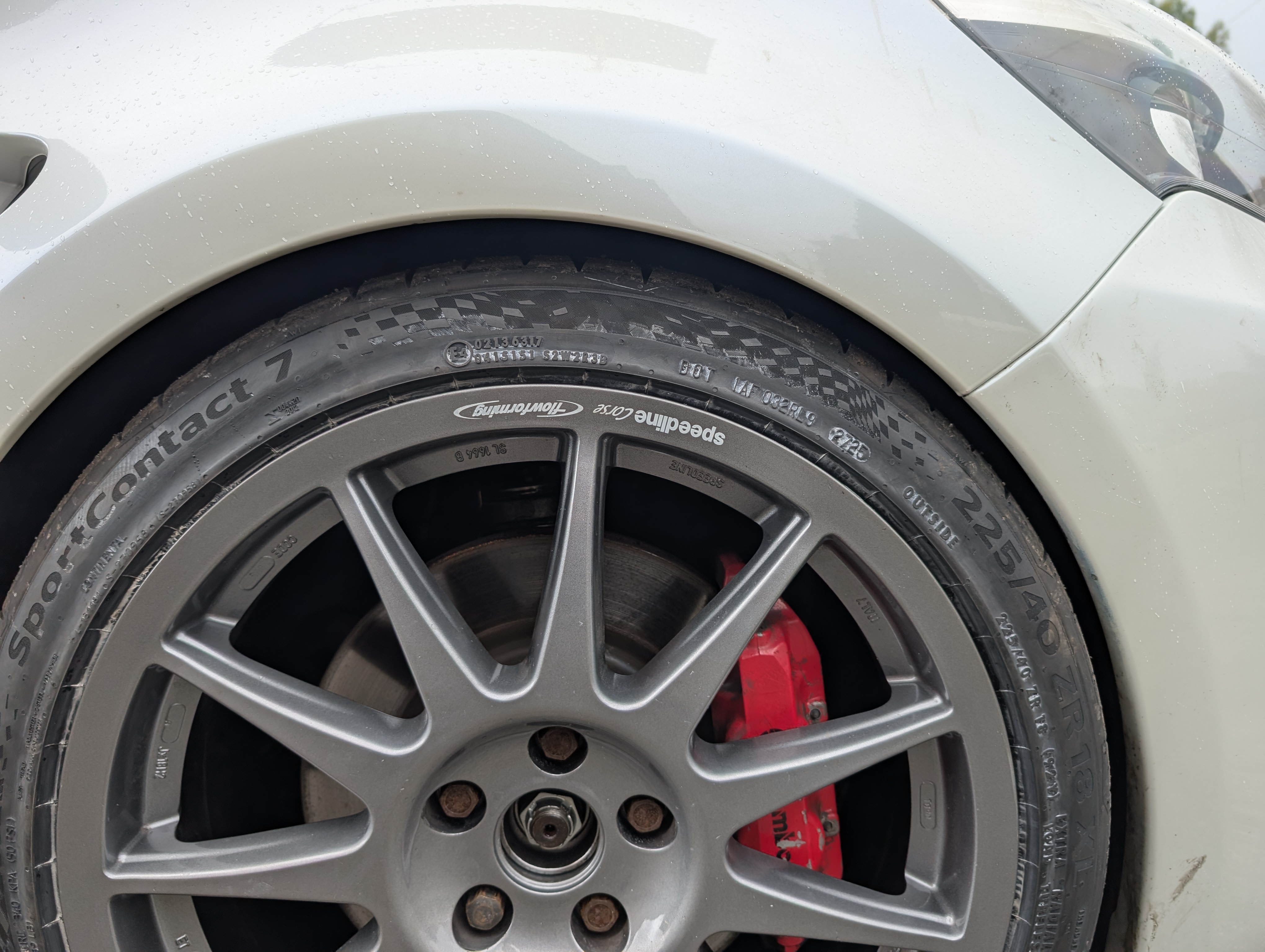

I can't decide if the car is too low or not now🤔. It's not rubbed yet which is surprising because they are close!
Fitment is good though, maybe needs a little spacer at the back?

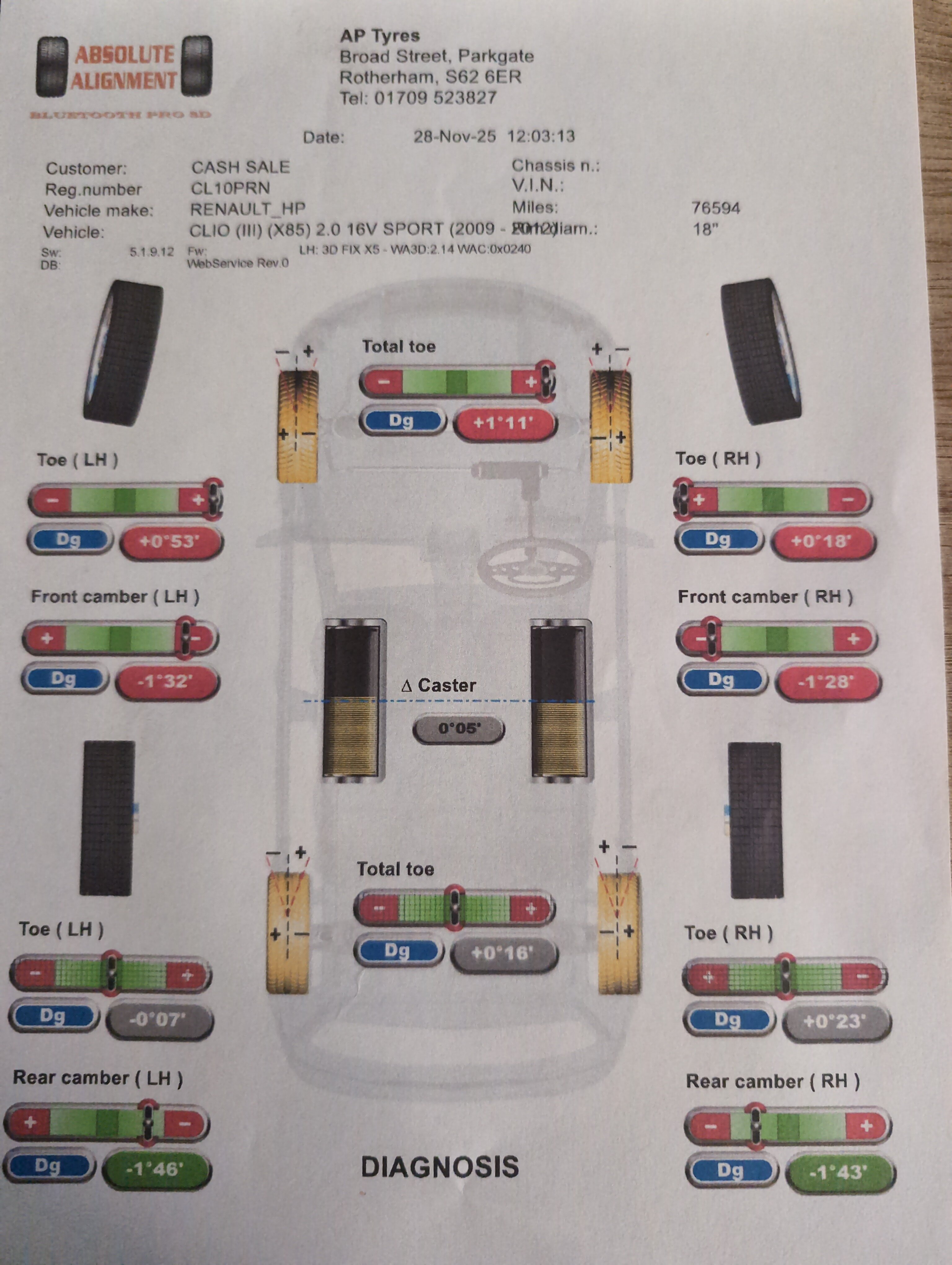

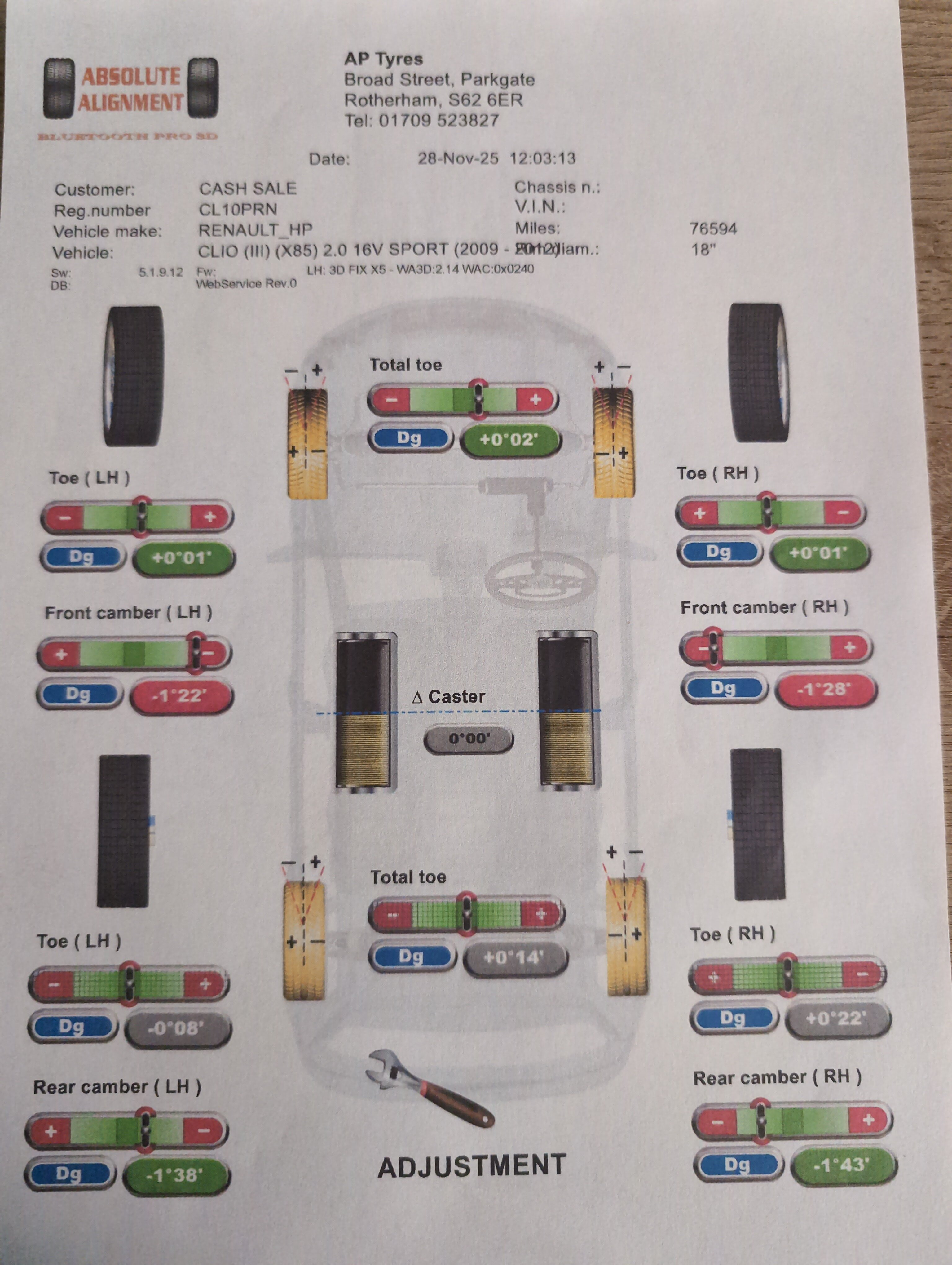

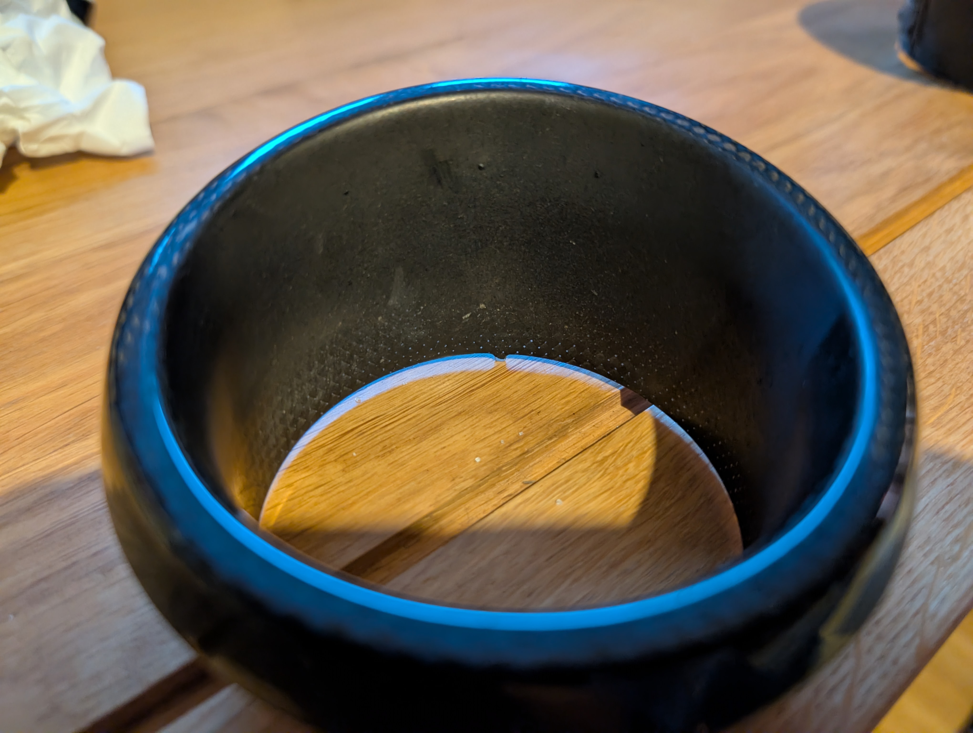

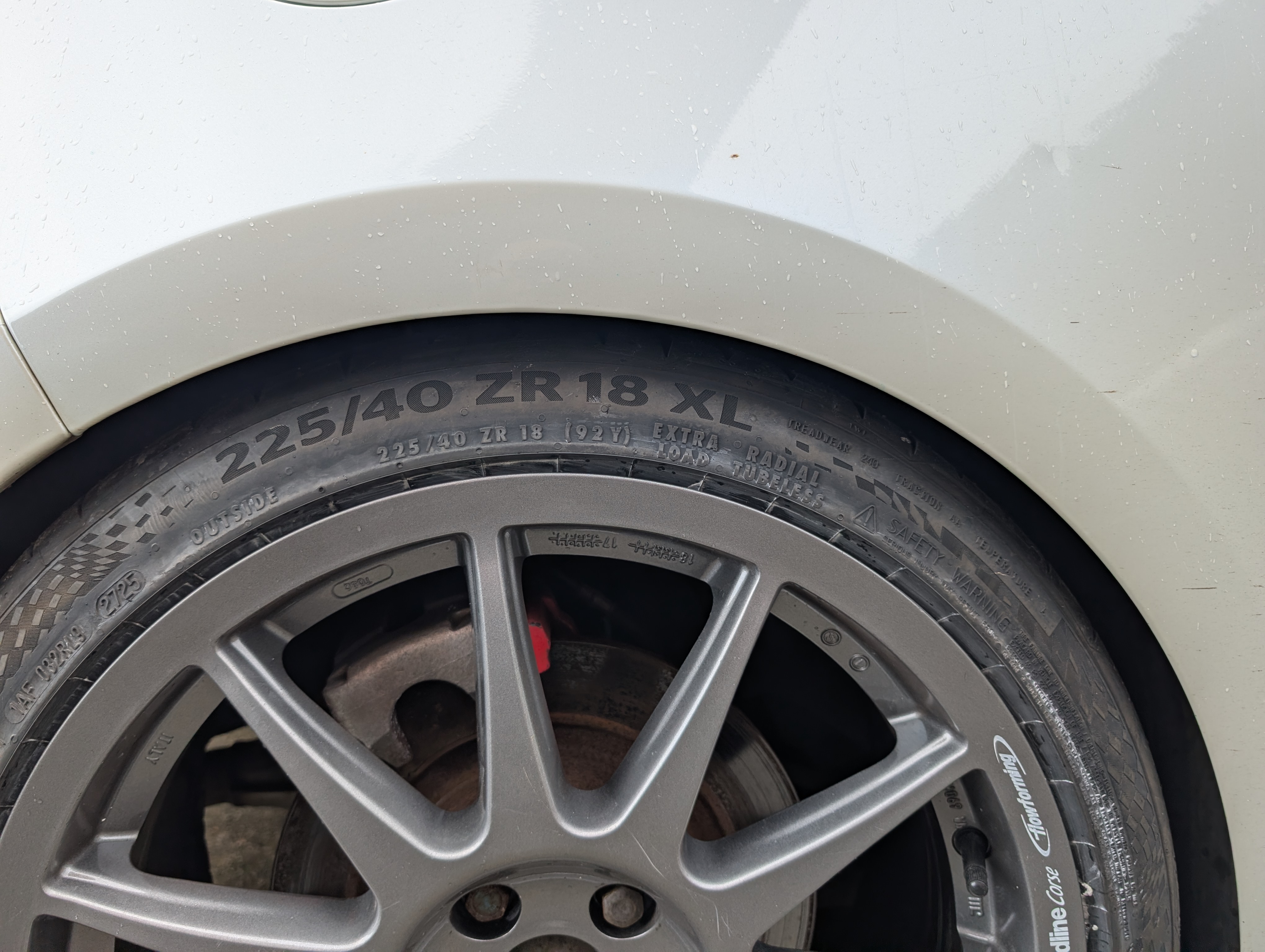

And yes they are 18's with 225/40 conti sport 7 and even though they are megane fitment they needed spigot rings that on don't have. Luckily the tyre place do alloy wheels and they found some the correct diameters but they needed a bit of fettling so they weren't proud of the wheel mounting face. After that it went on the alignment thingy and some slight adjustment to the front toe was required.
OK so it was miles out still 😂.
Thats better 👍. Miraculously the front camber is pretty even and the rear is decent too. Next year I'll look into modding the suspension turrets so I can actually get to the top mounts and shock adjusters as being a late 200 it's got the small top mounts.

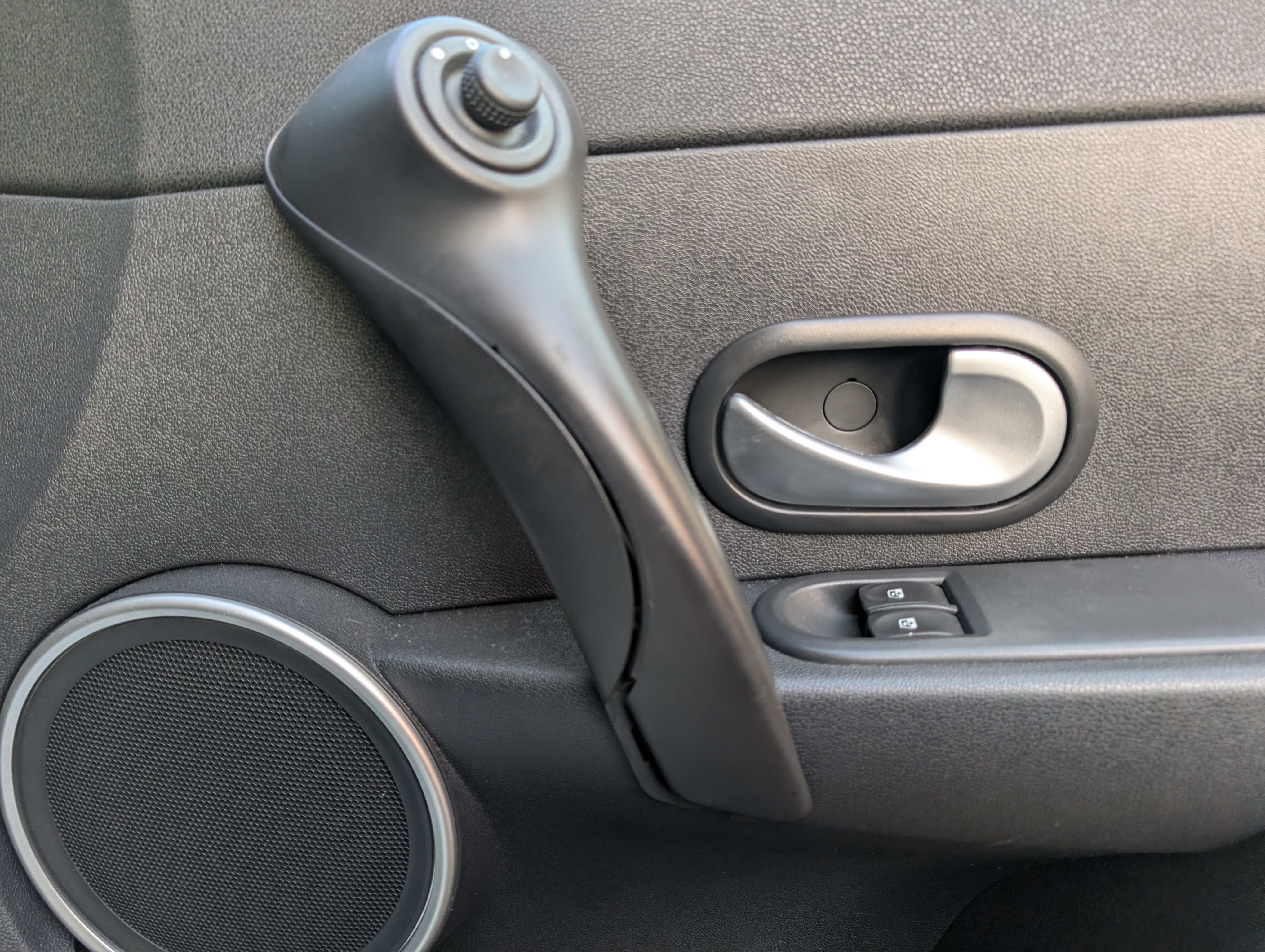

Annoyingly the door handle has come apart and doesn't want to stay in one piece so I might have to look out for a replacement.

I might have an interior door handle too
I will when I remember where I put them 🤔🤦😆.
The interior door handle just wants to match the exterior one in uselessness. I went out to clean the windscreen since driving into the sun it was greyer than all the cataracts in Africa and was surprised that the passenger door sensor works perfectly. f**king drivers side one won't unlock though 🙄.
Looks great mate and Turinis are the best wheels.I would get a set for mine if i could find a mint set,i think height wise.Maybe raise it a little bit more but all good apart from that.

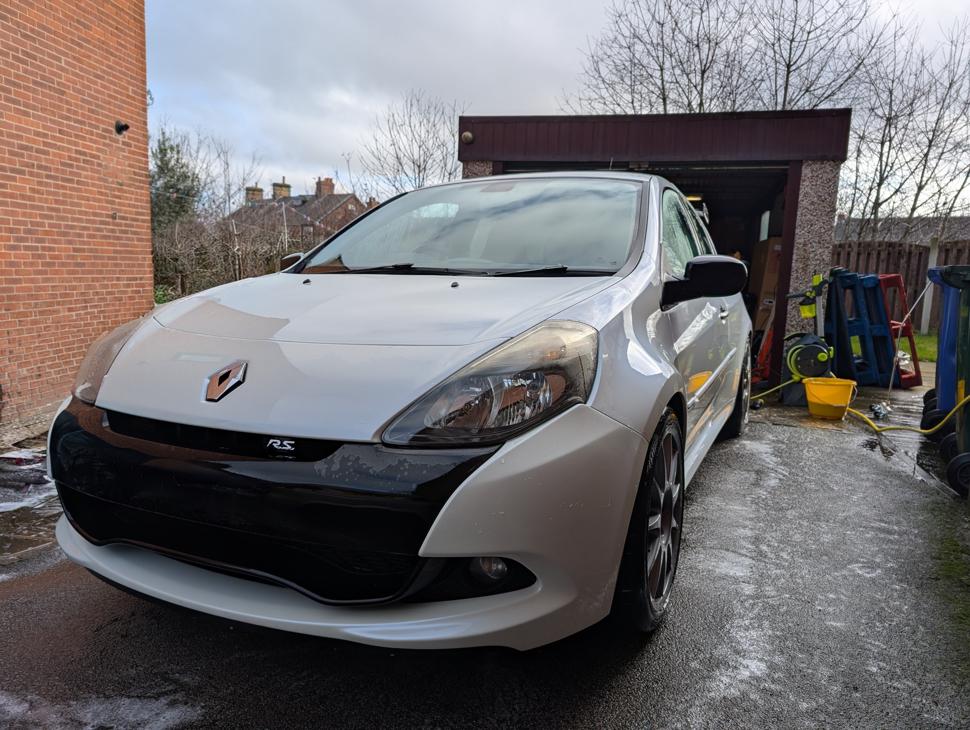

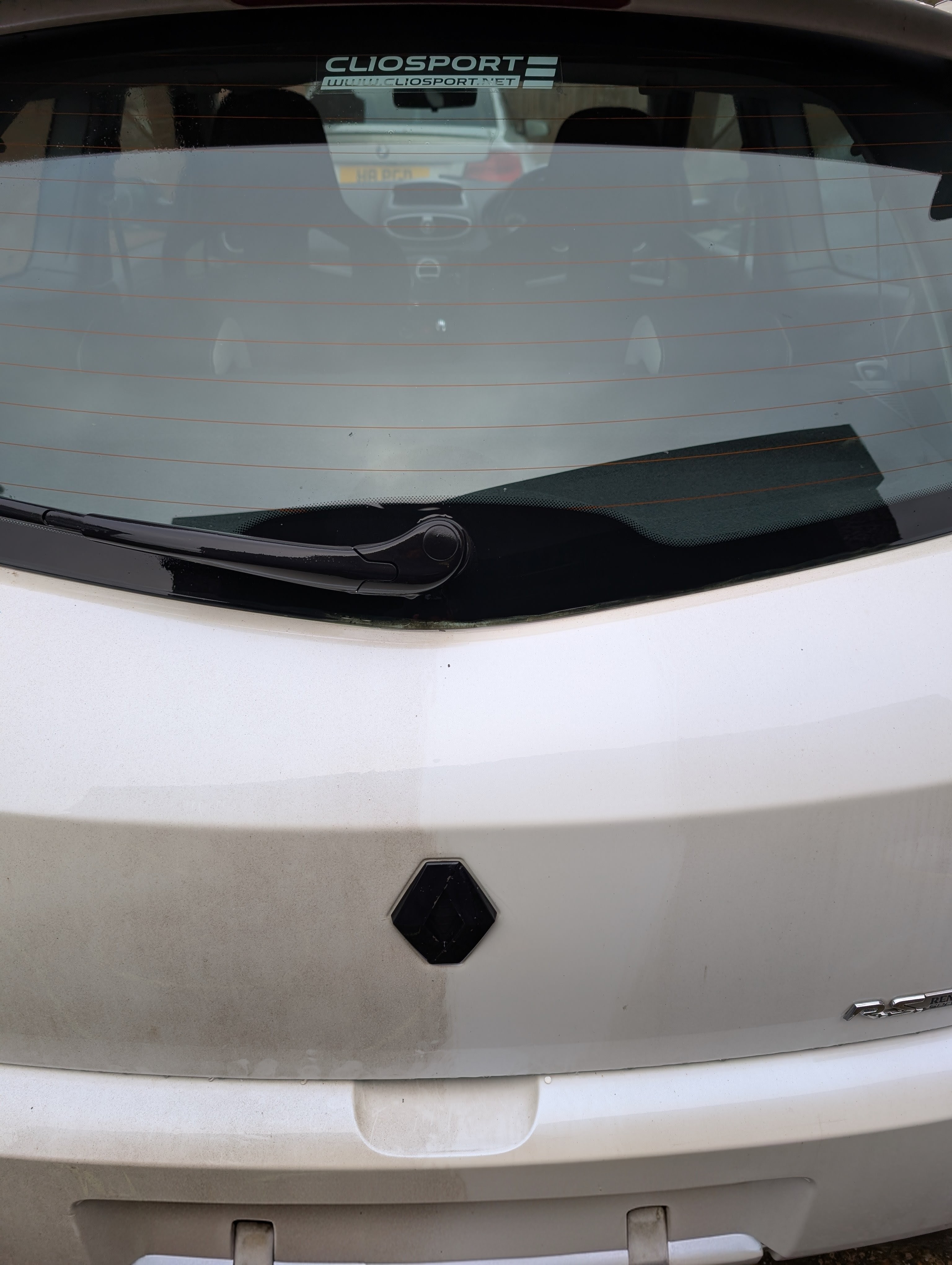

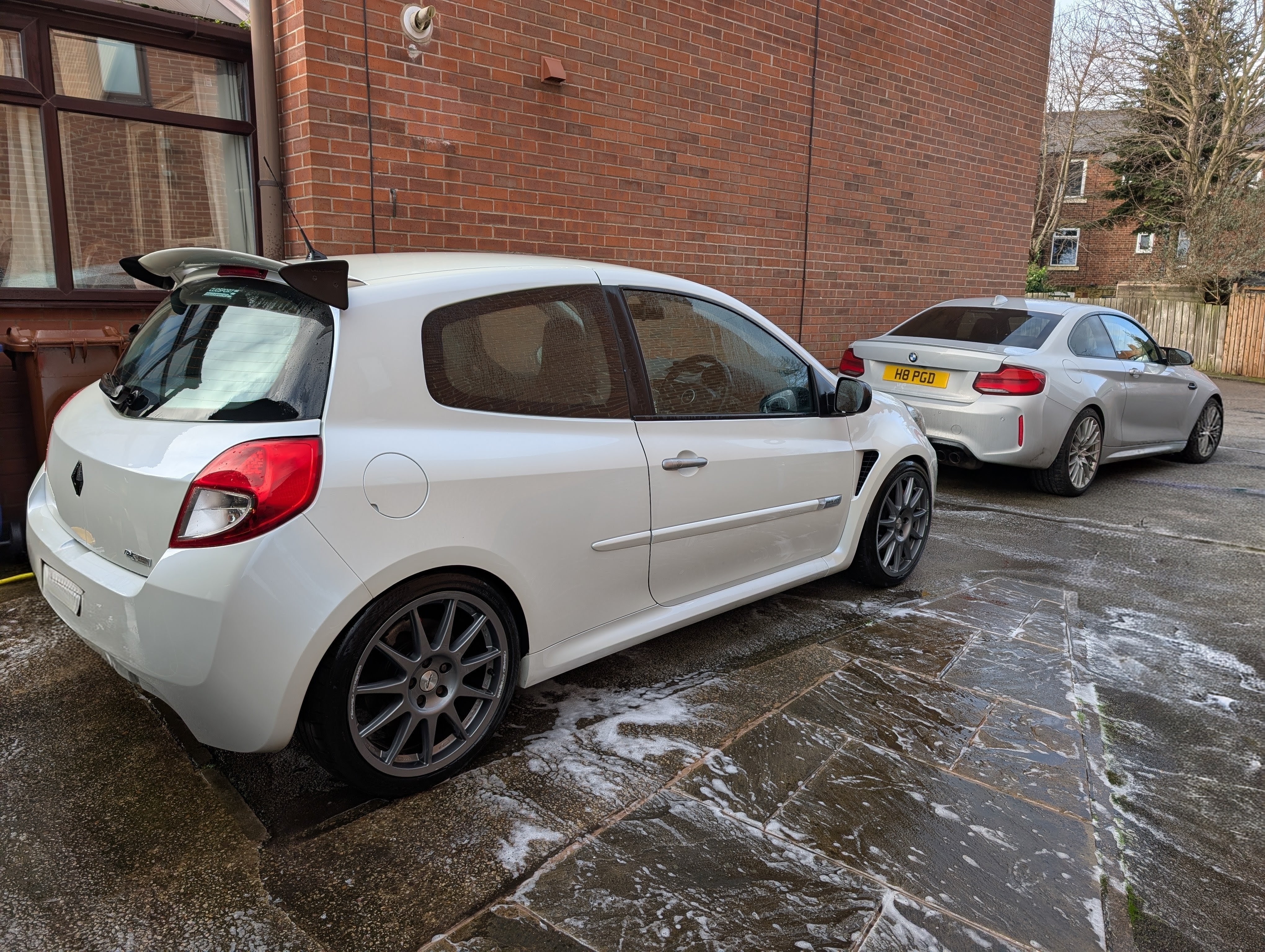

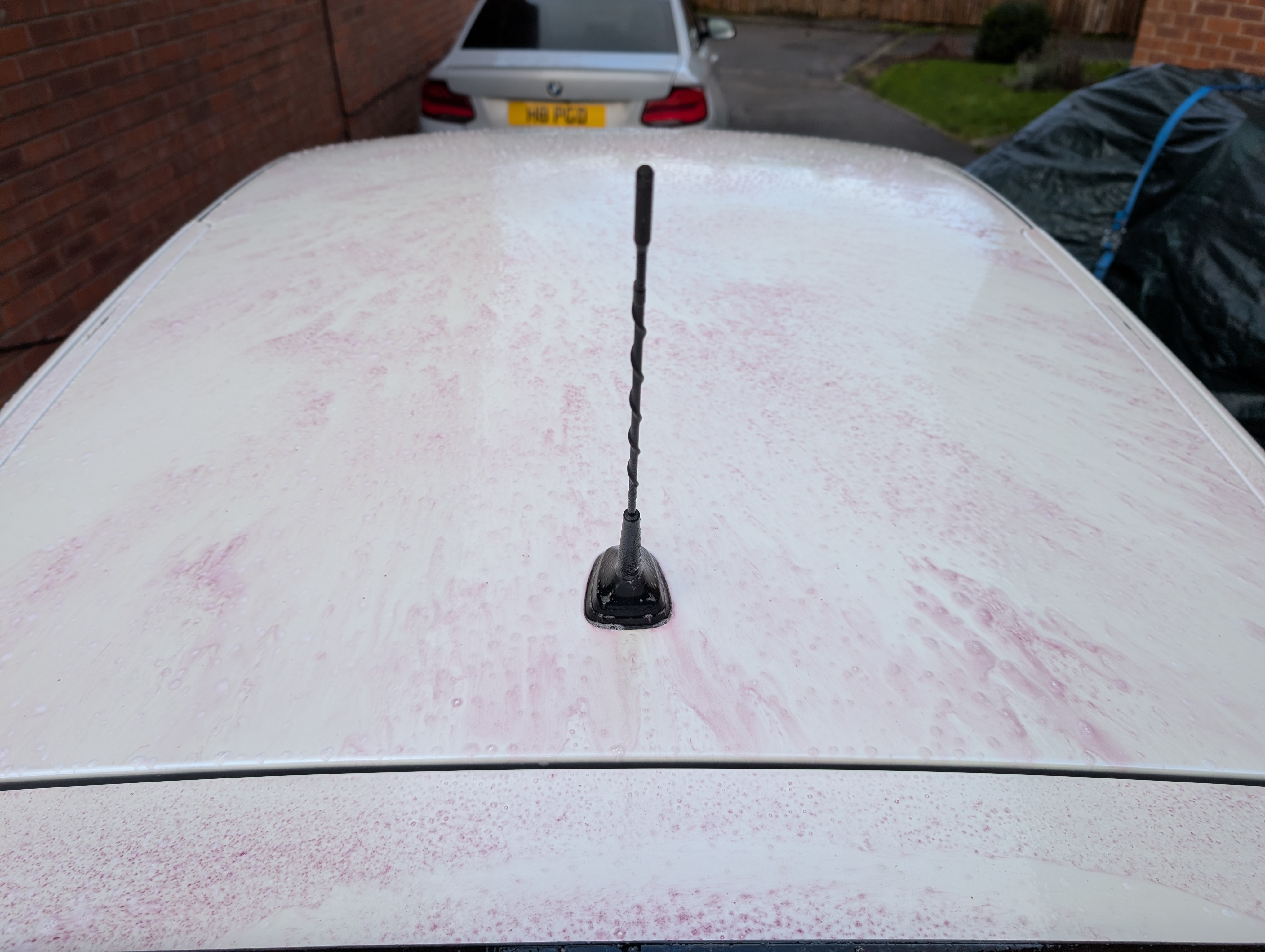

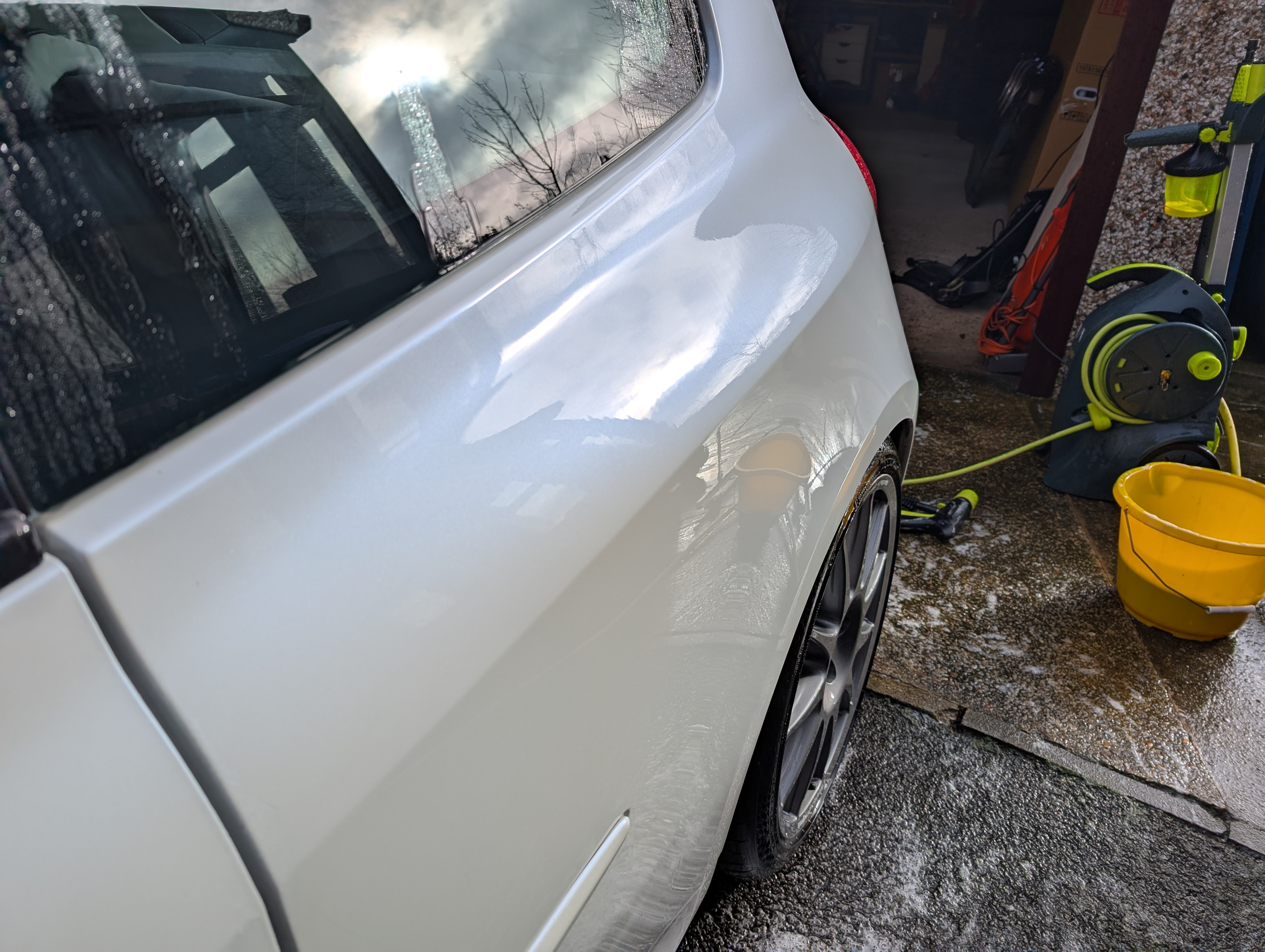

With a dry day today I decided to give it a wash, it's first since September 24! 😂 Twas mucky😞.
After washing the roof 3 times!
It's still covered in spots of god knows what. It'll need as good decontamination when the weather is better. Still it looks a bit cleaner 😊.
Didn't have time to wash both so might take the M2 to the immigrants on Monday 😂.

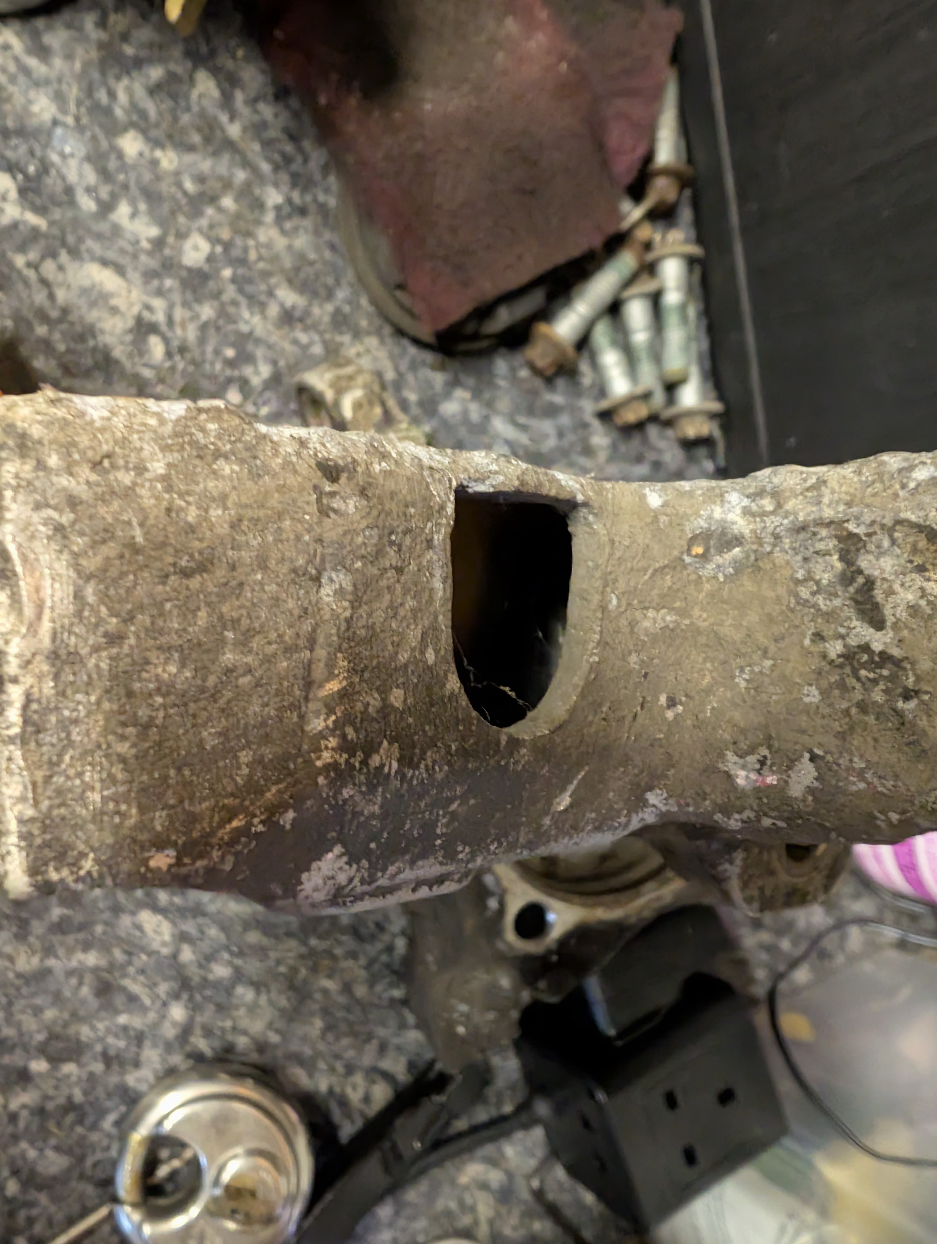

Definitely looks like something has broken or worked loose.
Probably the stabiliser link or front bushing on the wishbone.
Are you able to steer the wheel over to have a look?
RAC man is minutes away now and it's blowing a gale and I've been awake since 2pm yesterday so I'm not feeling inclined to crawl on the floor at the moment 😂.
RAC man says looks like lower arm is loose/fucked. There was lots of wobbling about when he jacked it up. No attempt to do anything else and it can't go on his bogey because the wheel might fall off so now I'm waiting for a flatbed. f**k me.

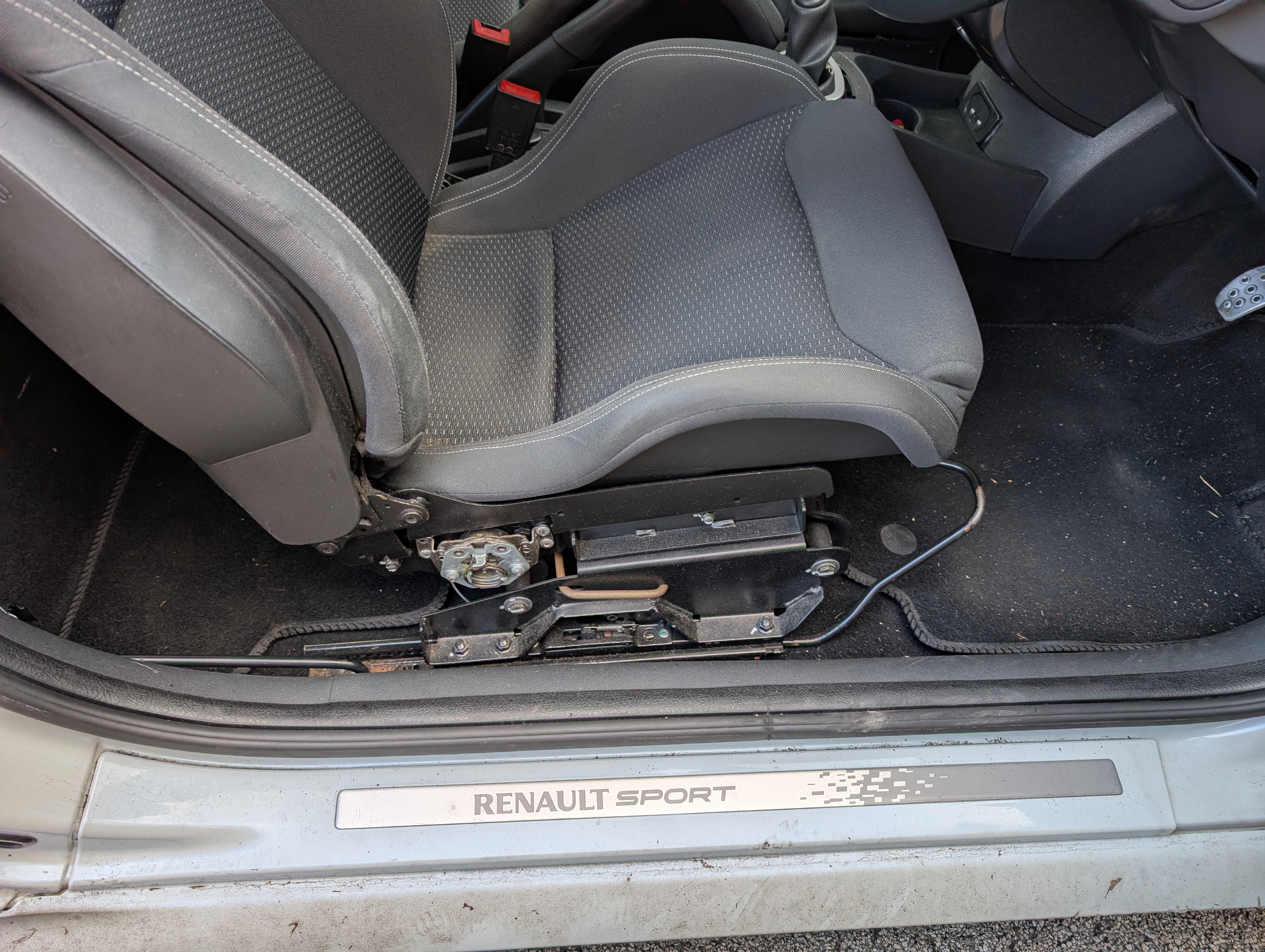

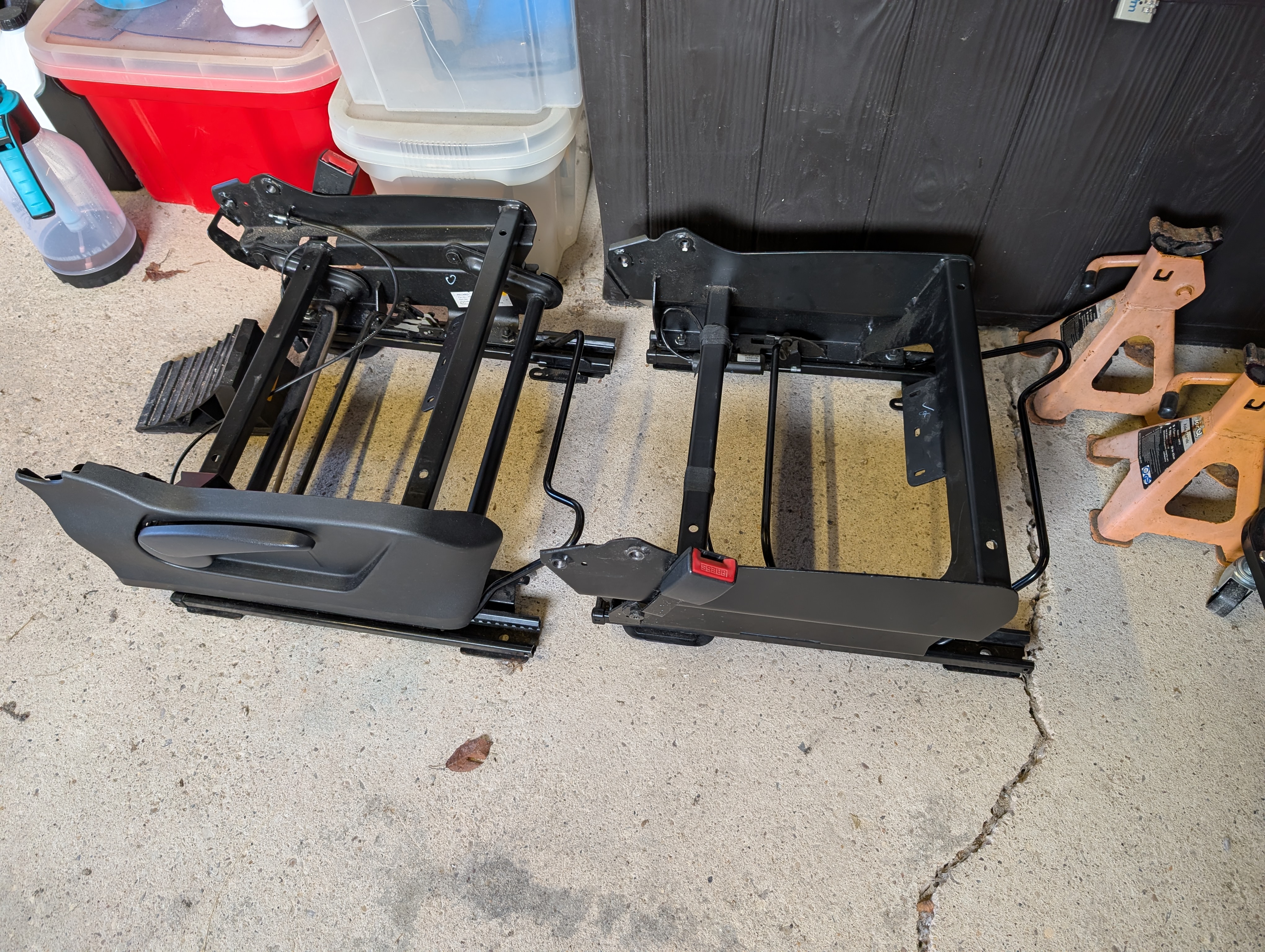

I also bought some tidy oe recaro bases. The drivers side runner on mine is a mess and I don't have the trim on the drivers base either. A guy on the M2 Facebook page bough some clio recaros to go in his M2 so I offered him a few quid for the bases which are in much better condition. I'll fit them when the weather is better and they will make the cabin a bit more presentable as well as restoring the tilt/slide feature of the seats.

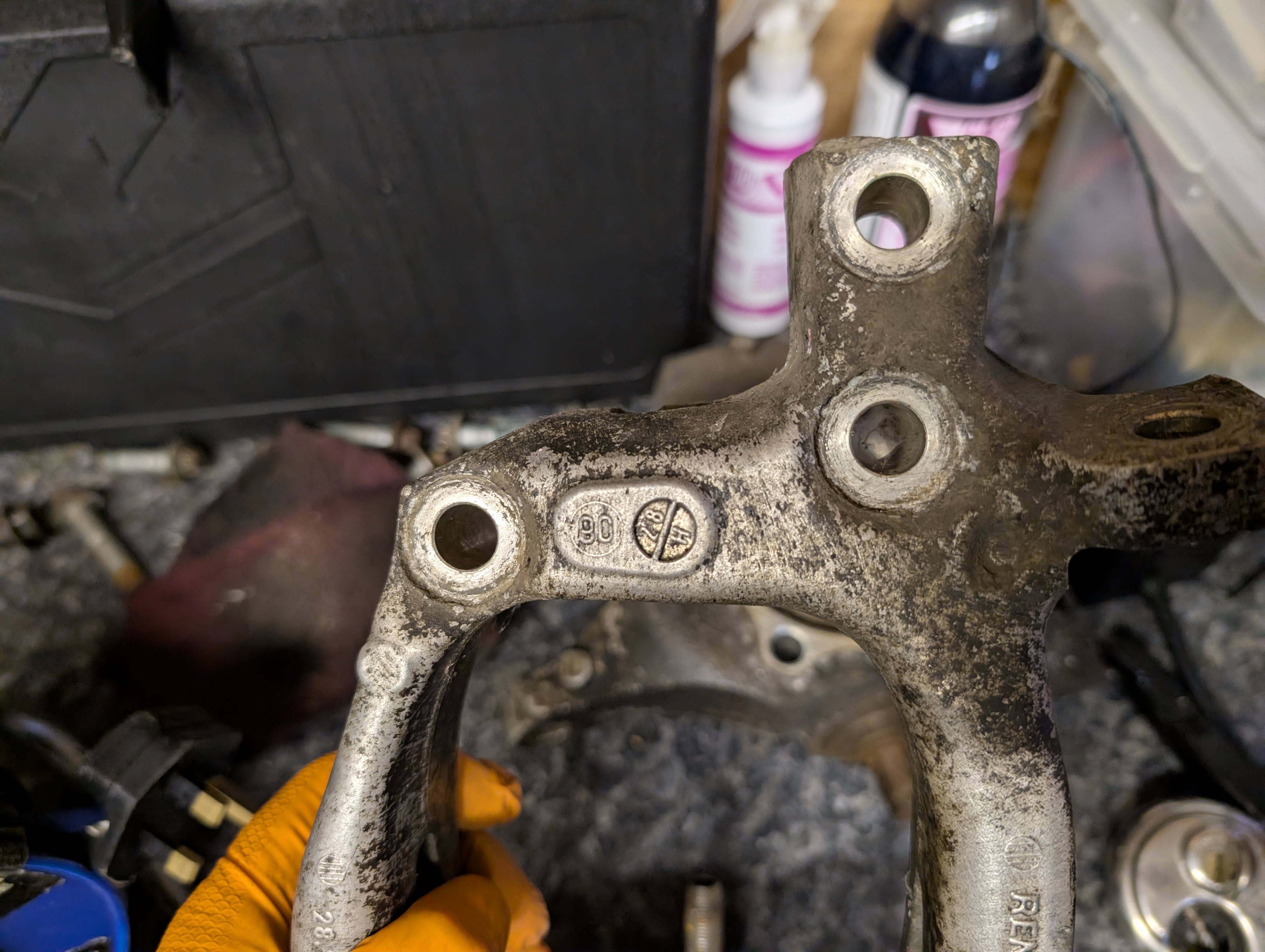

Right that's everything upto the tw@ breaking yesterday. I was on my way to work and I heard a series of clunks. It was clear that it was something escaping rather than something thrown up off the road. At work I had a good look under the car and under the bonnet but couldn't see anything obviously missing. So get home and look at the weekend was the plan. After navigating the bumpy s**t show that is Aldwark Lane in Rotherham something else made it's escape and after very slowly navigating the roundabout my steering wheel was off centre when I was going straight. I parked it and rang the RAC. Now I know breakdown companies get bad rap and sometimes it's well deserved. This time it's well deserved. I couldn't report through the app so had to ring and speak to a person. So after explaining that there's a problem with my suspension and or steering why would you send a pleb in a van who's unable to fix it and tow it instead of just sending a flatbed to recover me? 2 hours after I finished my 13 hour nightshift he was on his after having jacked the car up and decided something was loose. That's all he did. Half an hour later I got a notification that id be recovered between 1 and 4pm. 40 mins later I was on a truck on my way home that I'd arranged myself. Useless c***s. The clio is now in my garage awaiting inspection. It may happen tomorrow or it may be next year, I'm undecided atm. Suspicion is the bottom arm bolt has either escaped or broken, dunno where I'm going to find another that's the case?
Update next year...

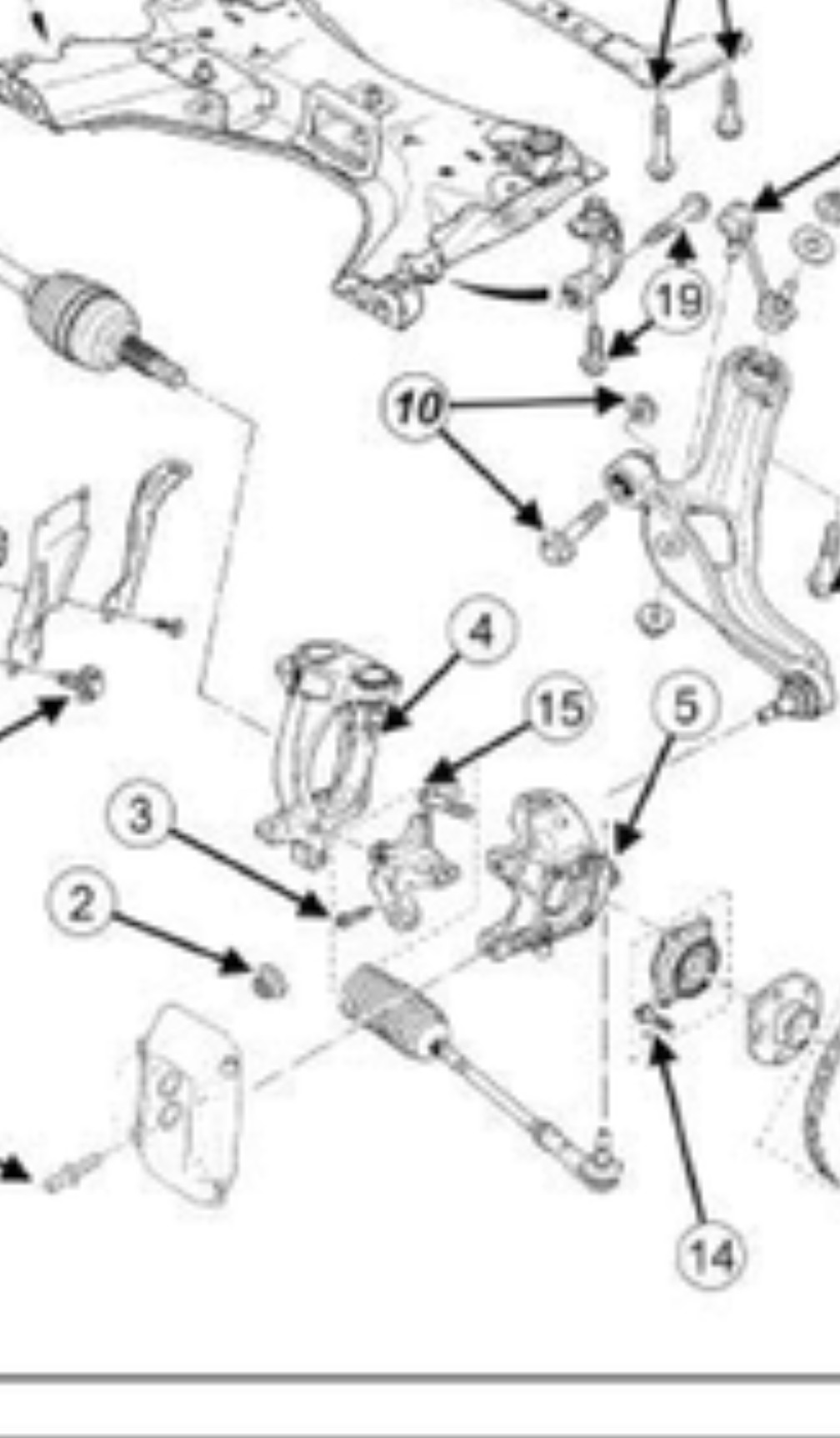

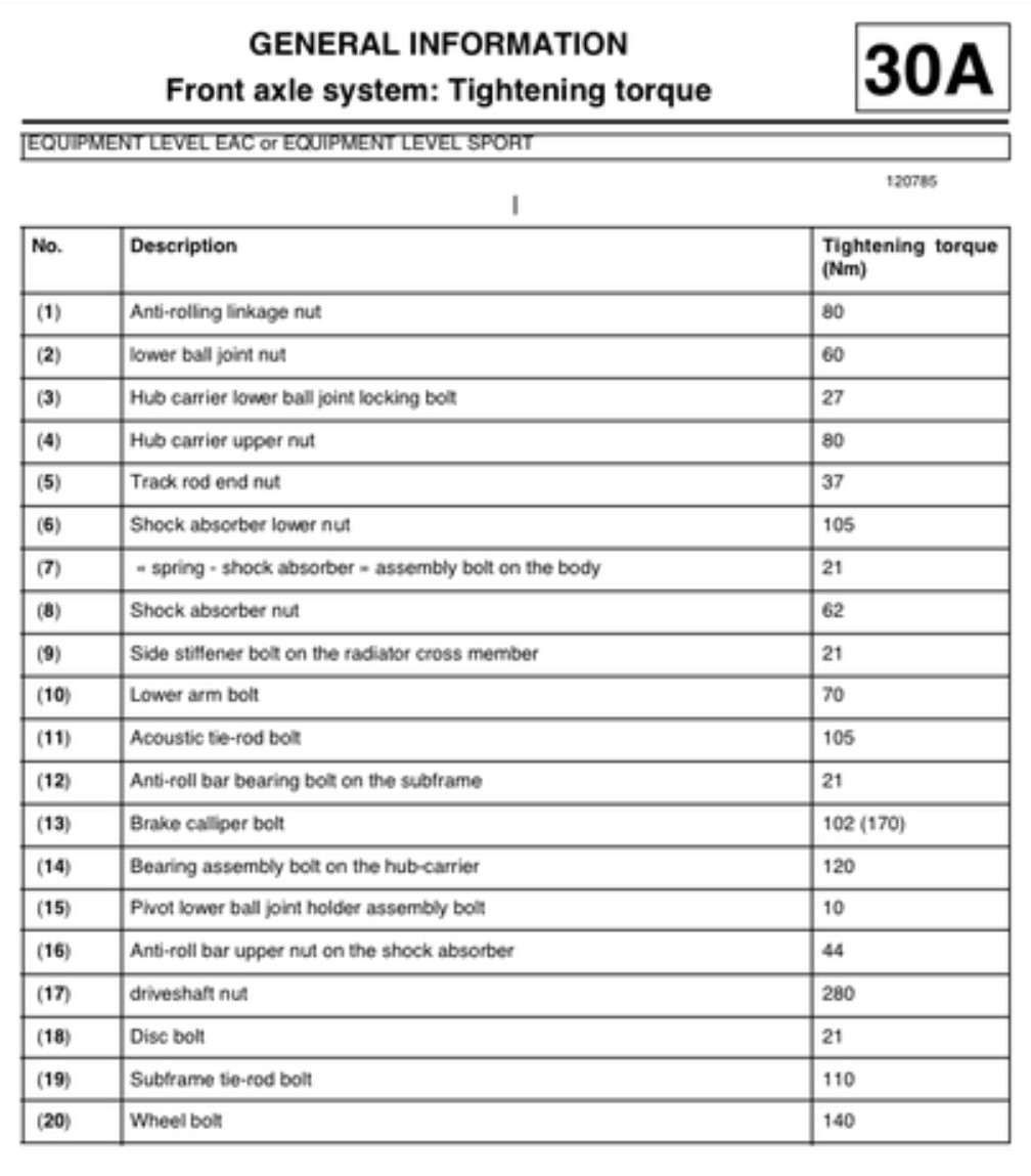

Yep that's not right. What could be causing it🤔. At first glance all the nuts and bolts seem to be there still. But then...
Oh dear. The third one holding that on was loose too. There's a good chance that this is the side I had new swivel bearings fitted to and was fully stripped down 🙄. Now correct me if I'm wrong but those bolts are no 15 and that does say 10nm!
They are bolted through an aluminium casting and it's not solid and I definitely did them tighter than 10nm because that's what you do the milk bottle lid upto.
Anyway as I have spare hubs I had a couple of bolts laying around so it's back together and everything is done up ftbh and nobody died. Phew 😁. I'm going to test it on the M1 later so stay away from Sheffield southbound 😂.
