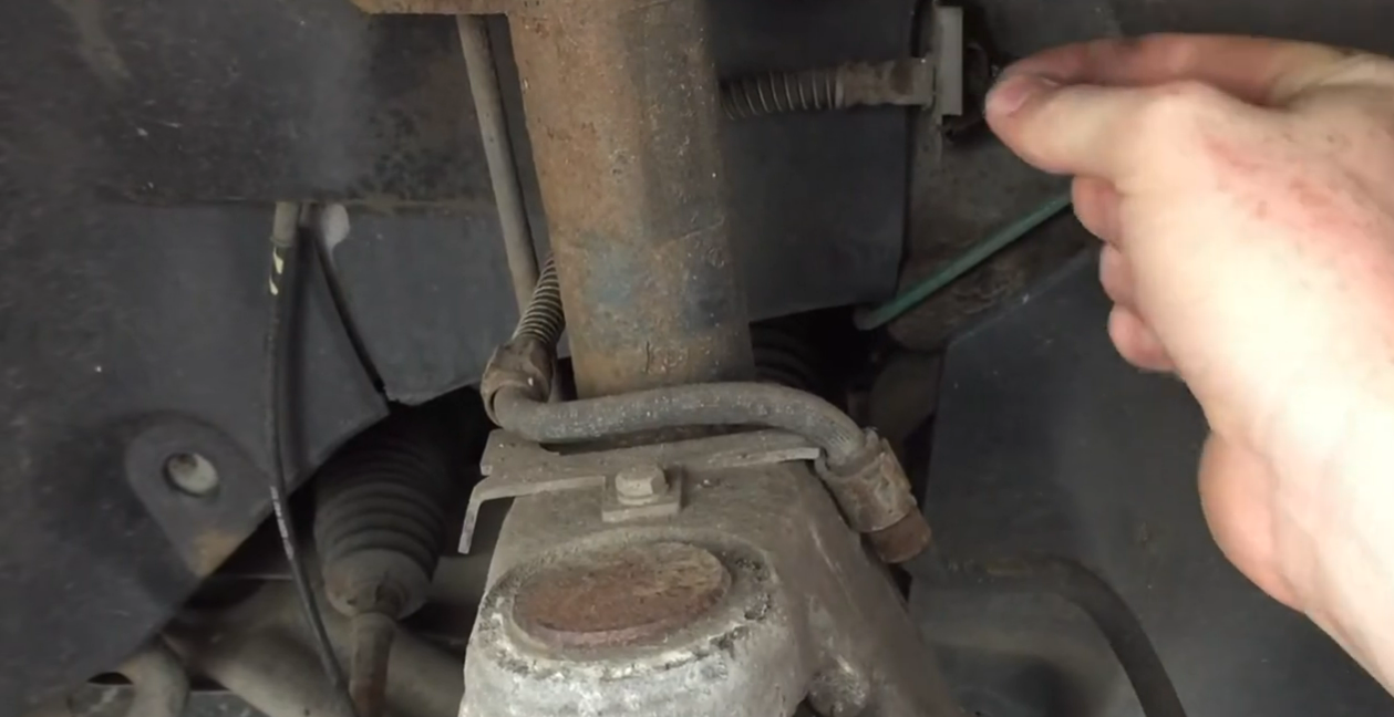

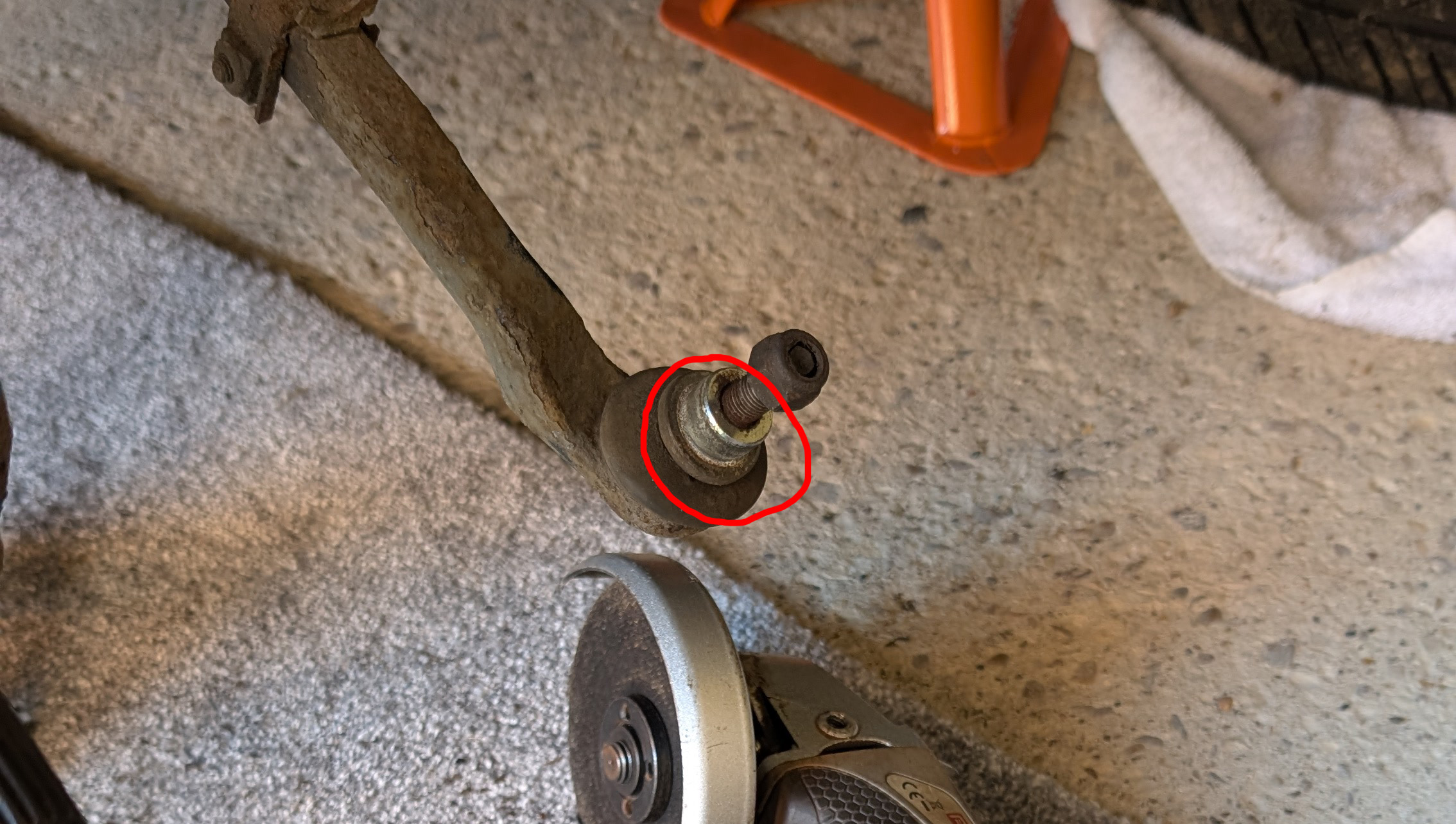

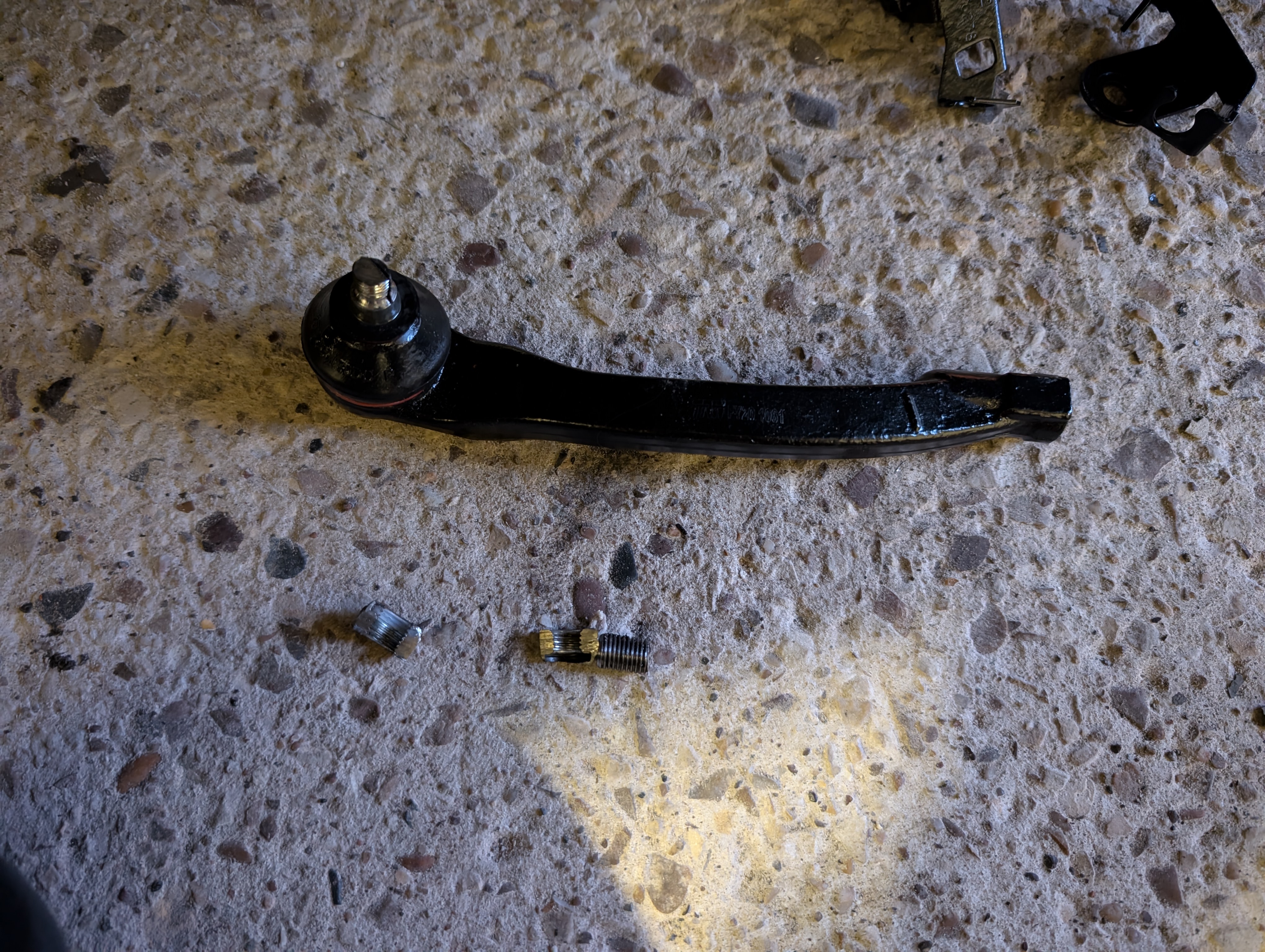

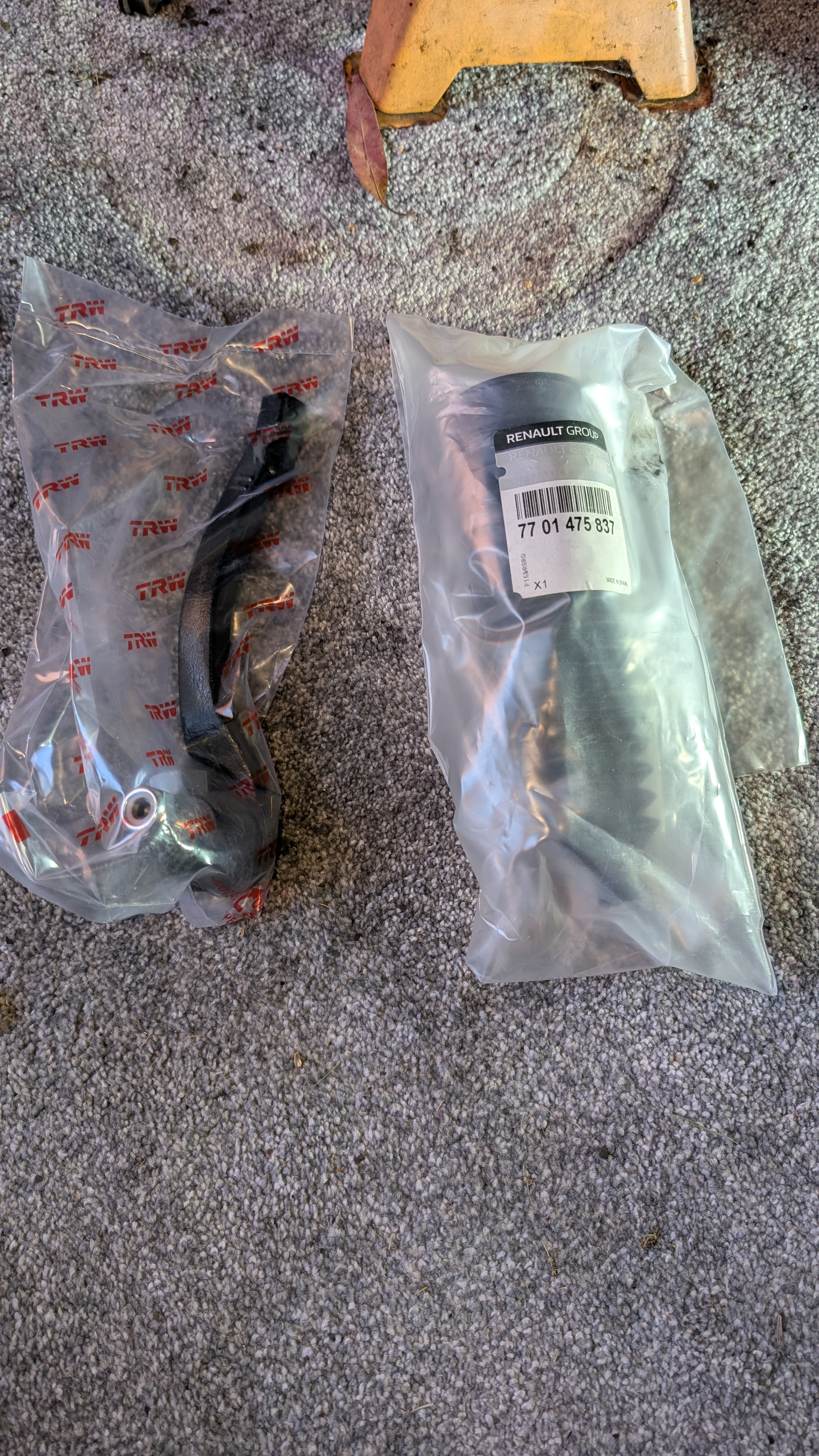

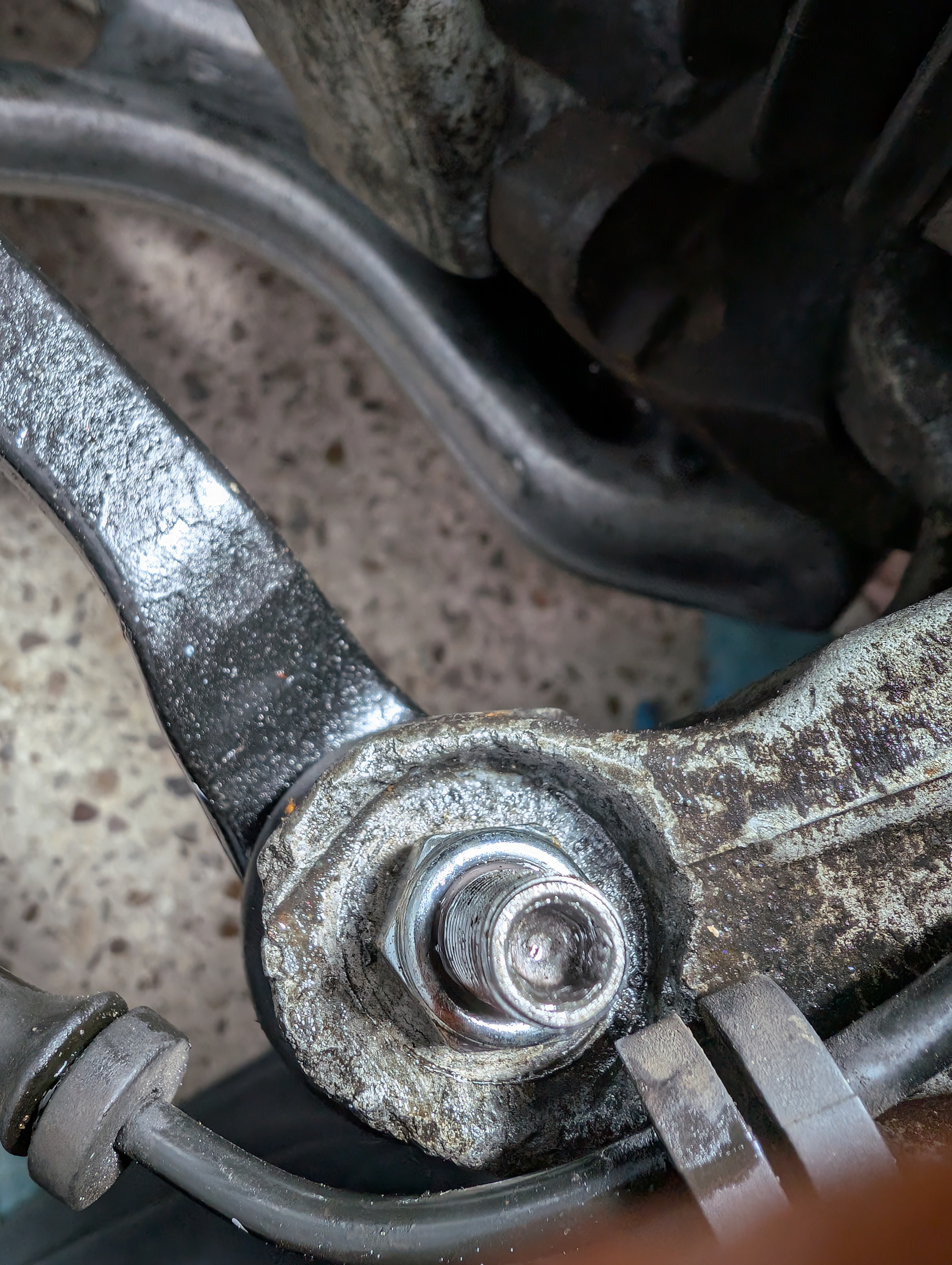

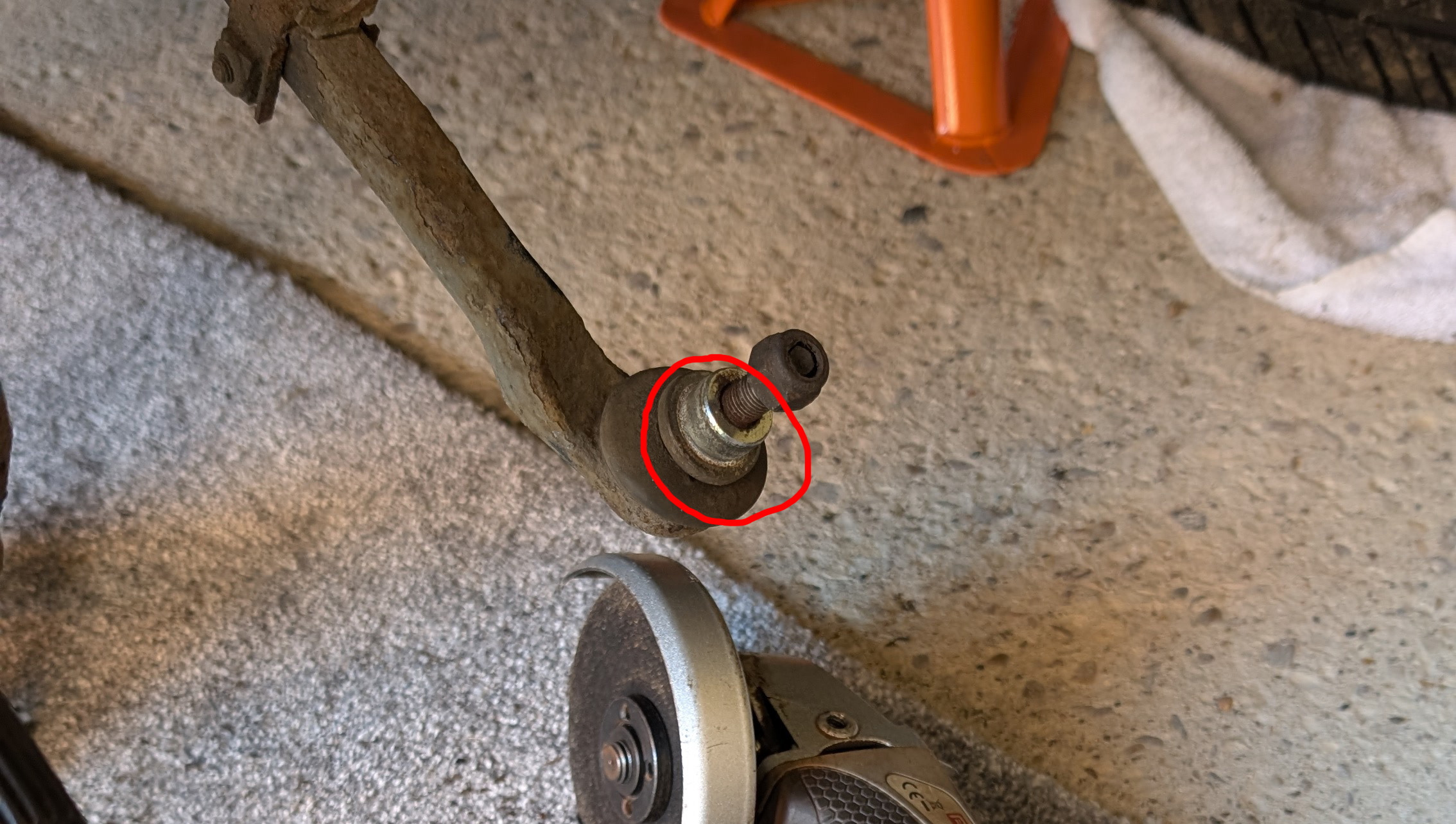

Don't forget to remove the hub insert from the track rod end before you bin them 😅

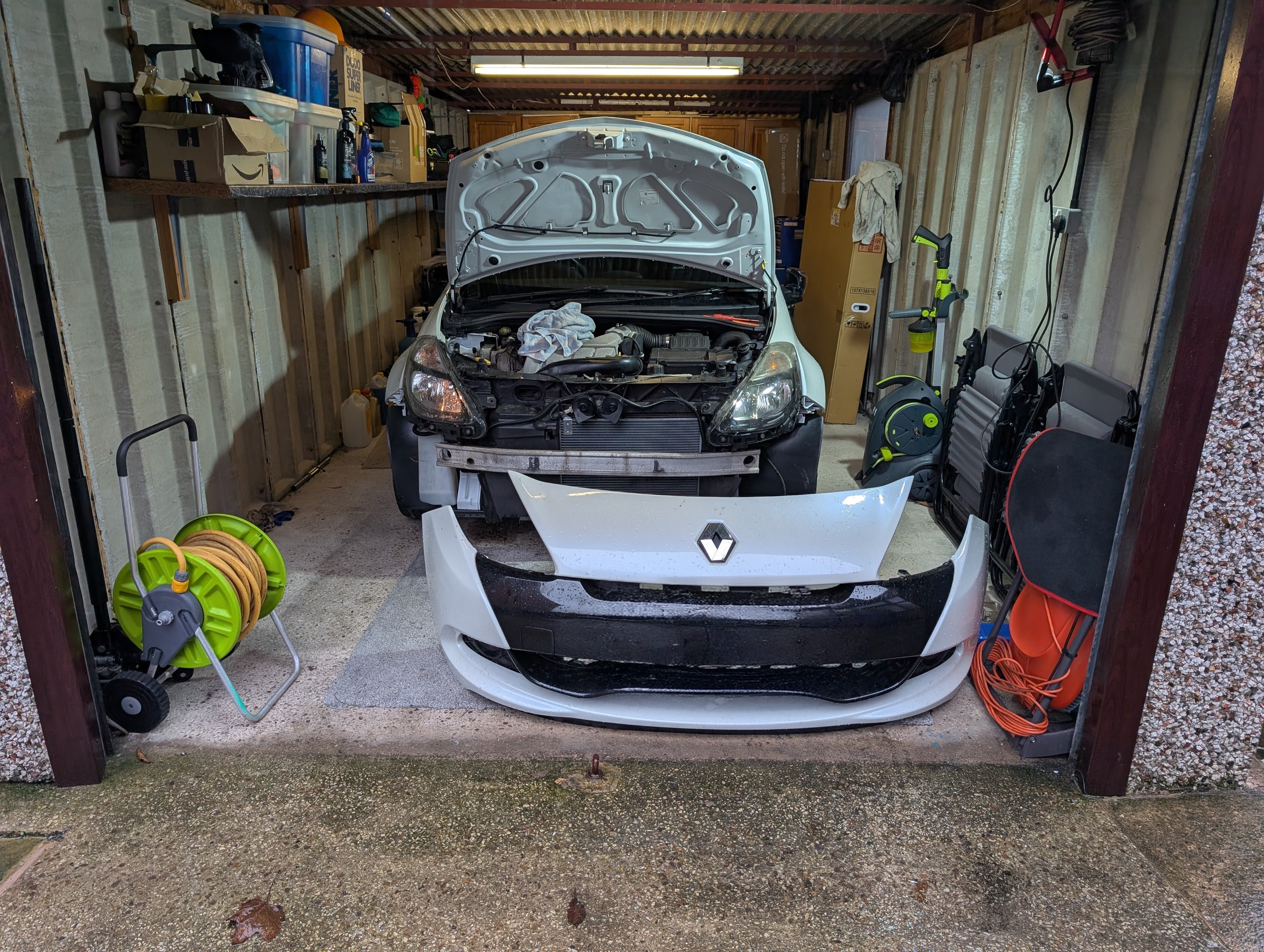

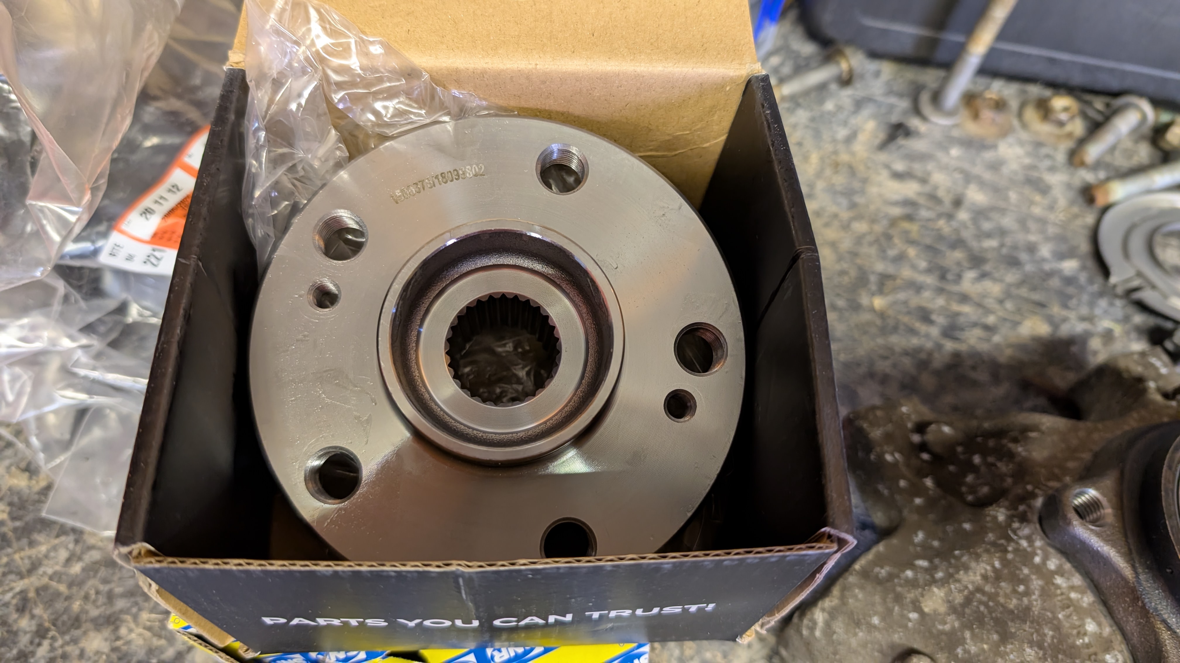

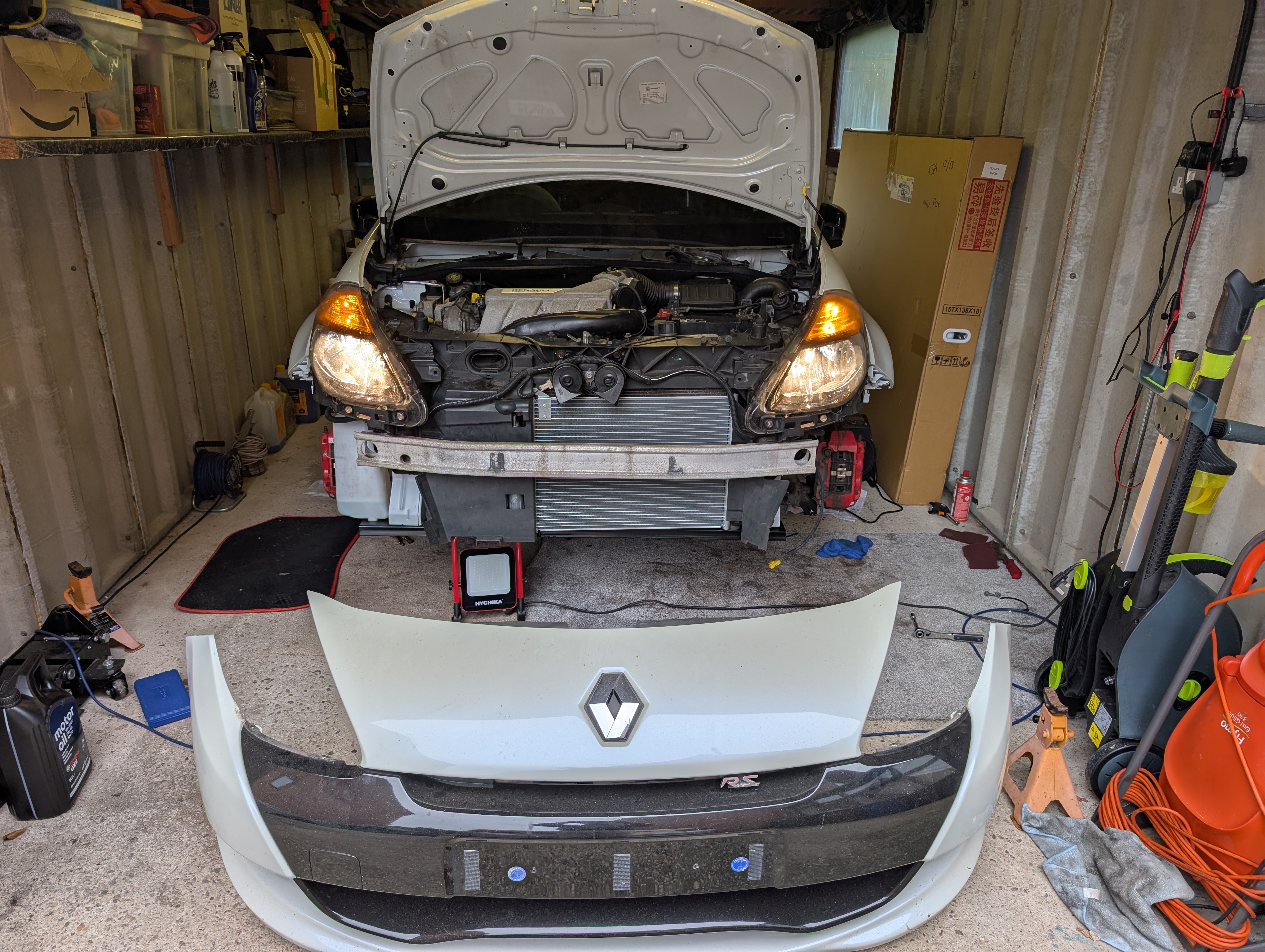

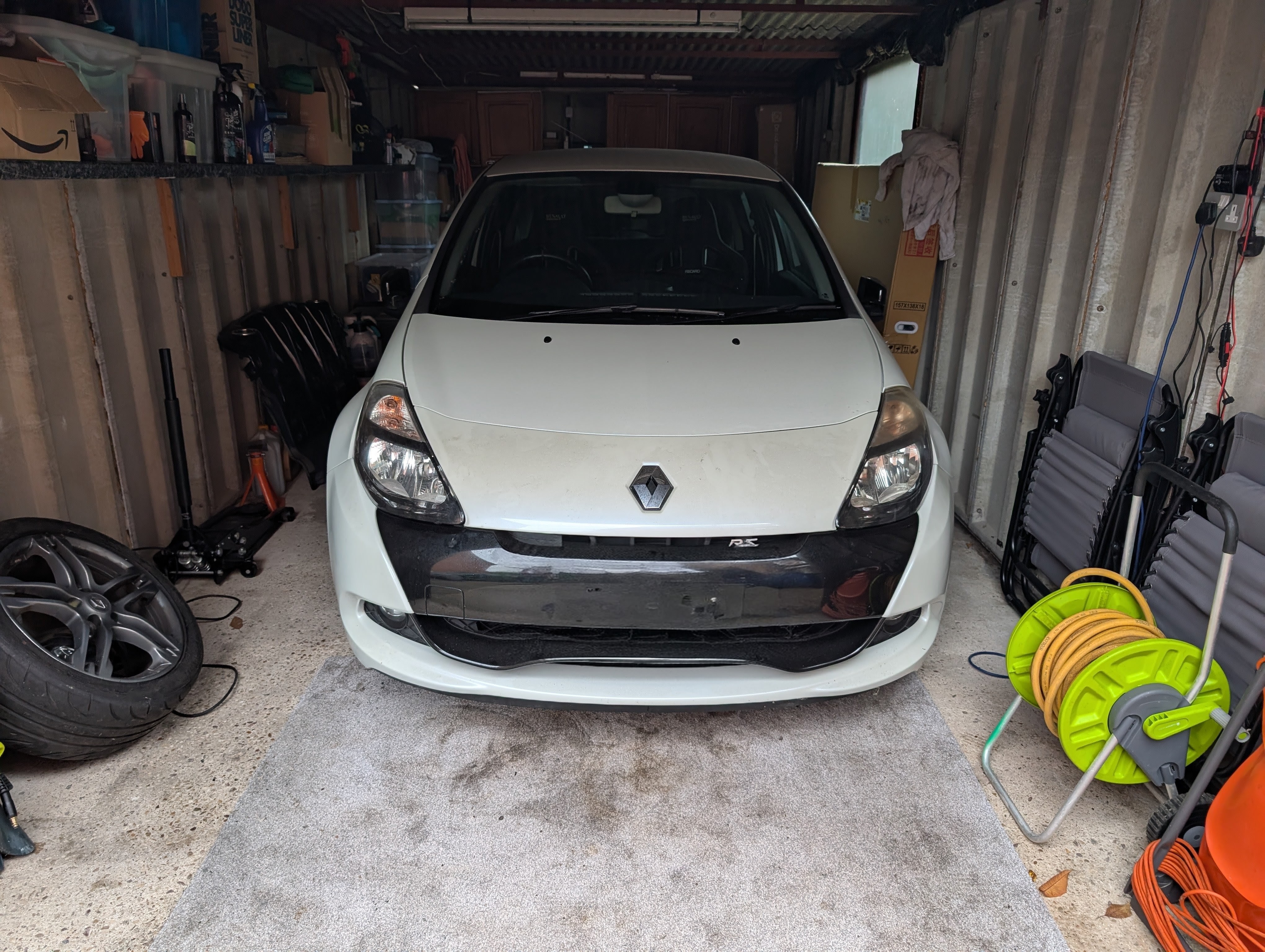

Finally it was time to start putting it all back together and all the pics I took while dismantling it became priceless. New parts fitted:

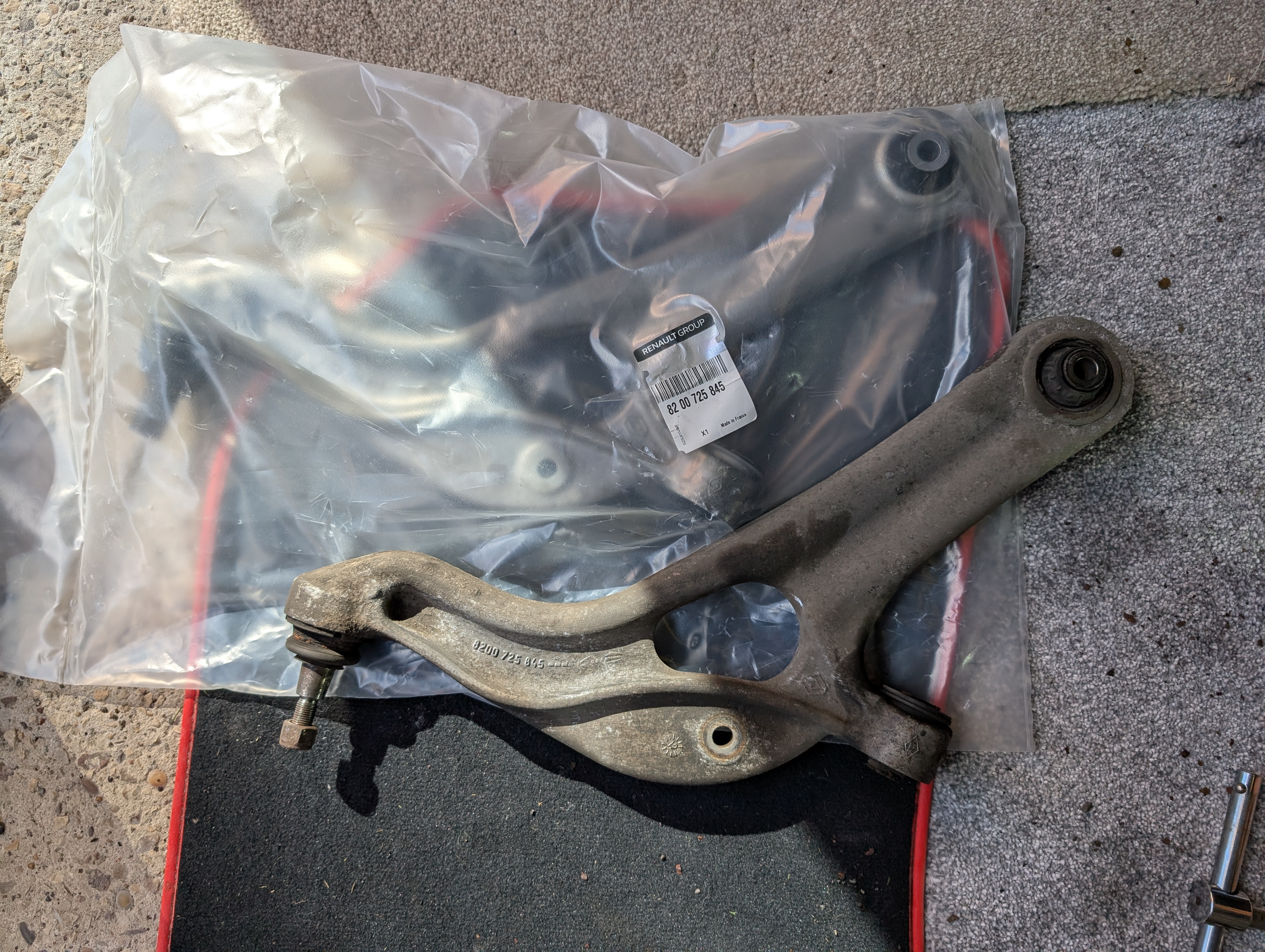

Genuine Renault bottom arms.
Genuine Renault tie rods.
Trw track rod ends.

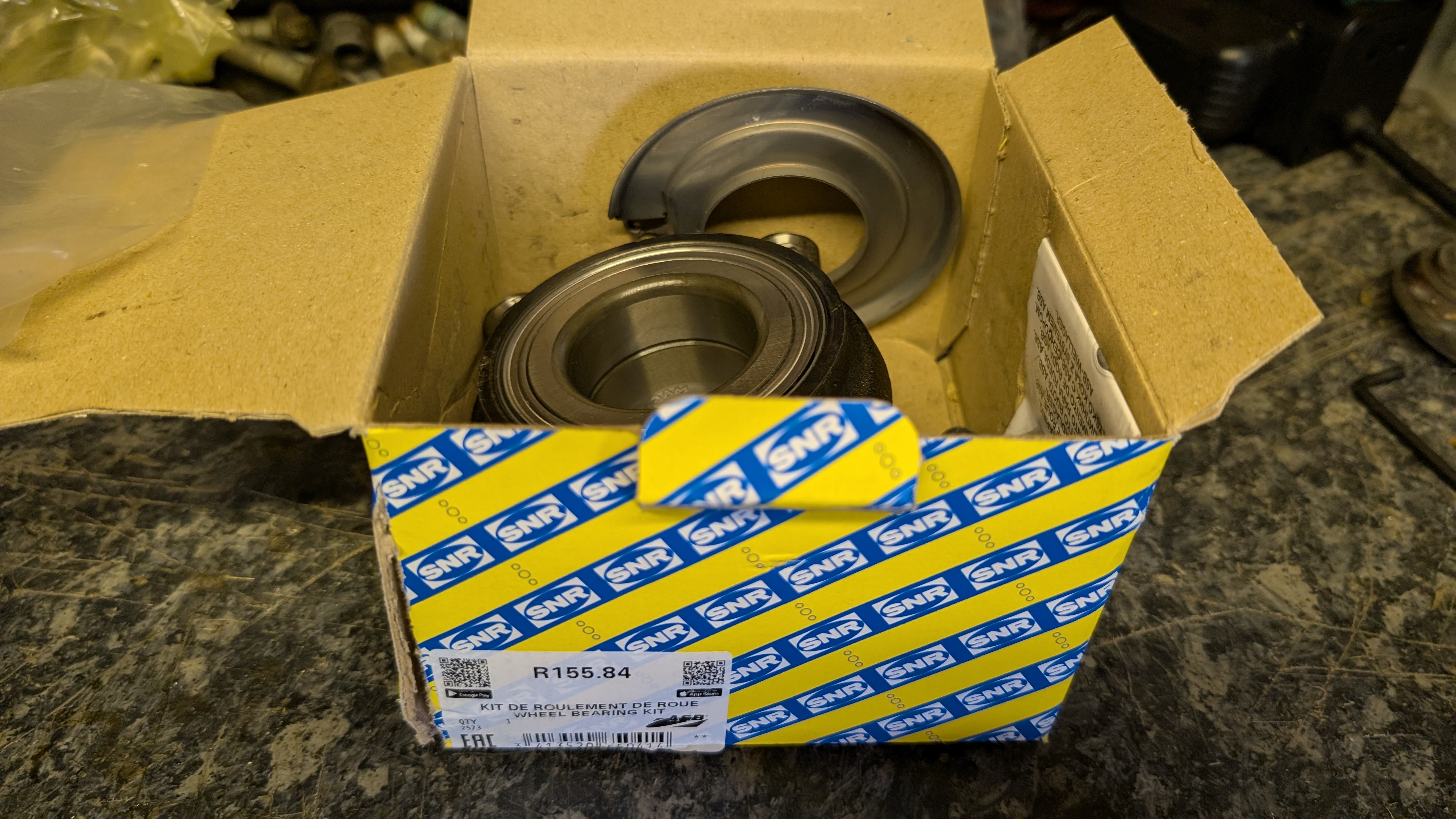

SNR wheel bearings.
New wheel hubs.

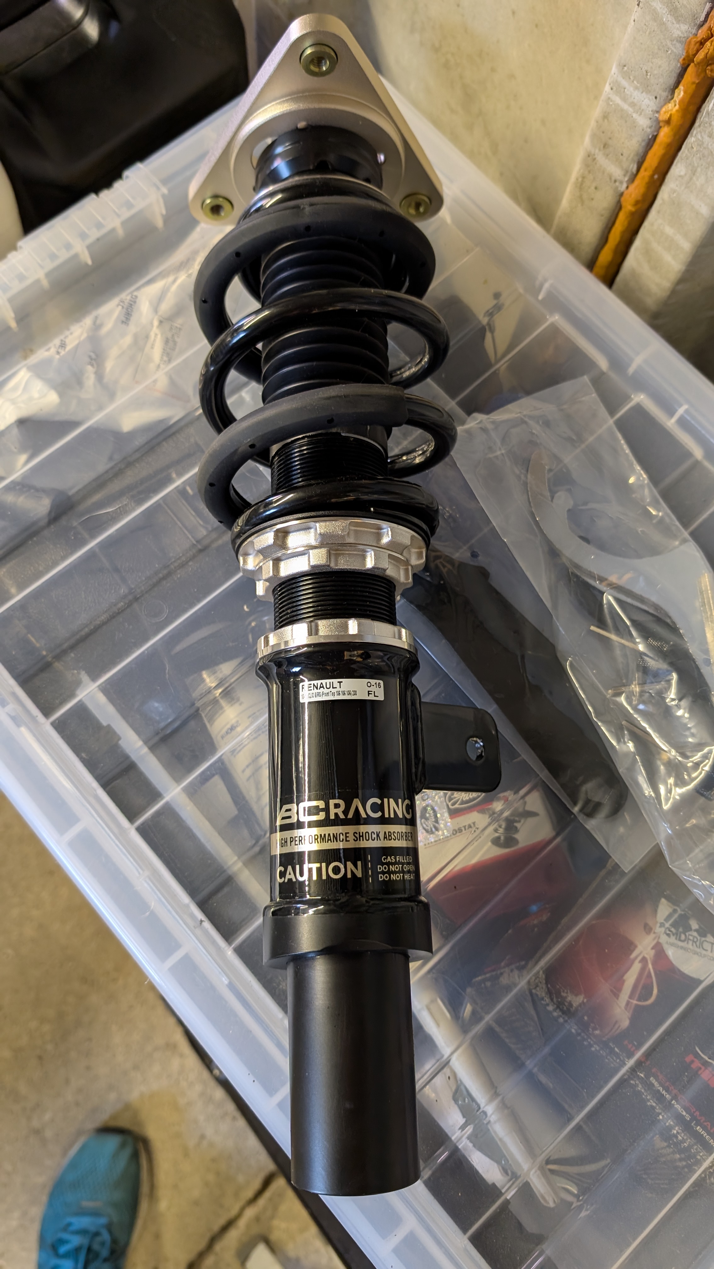

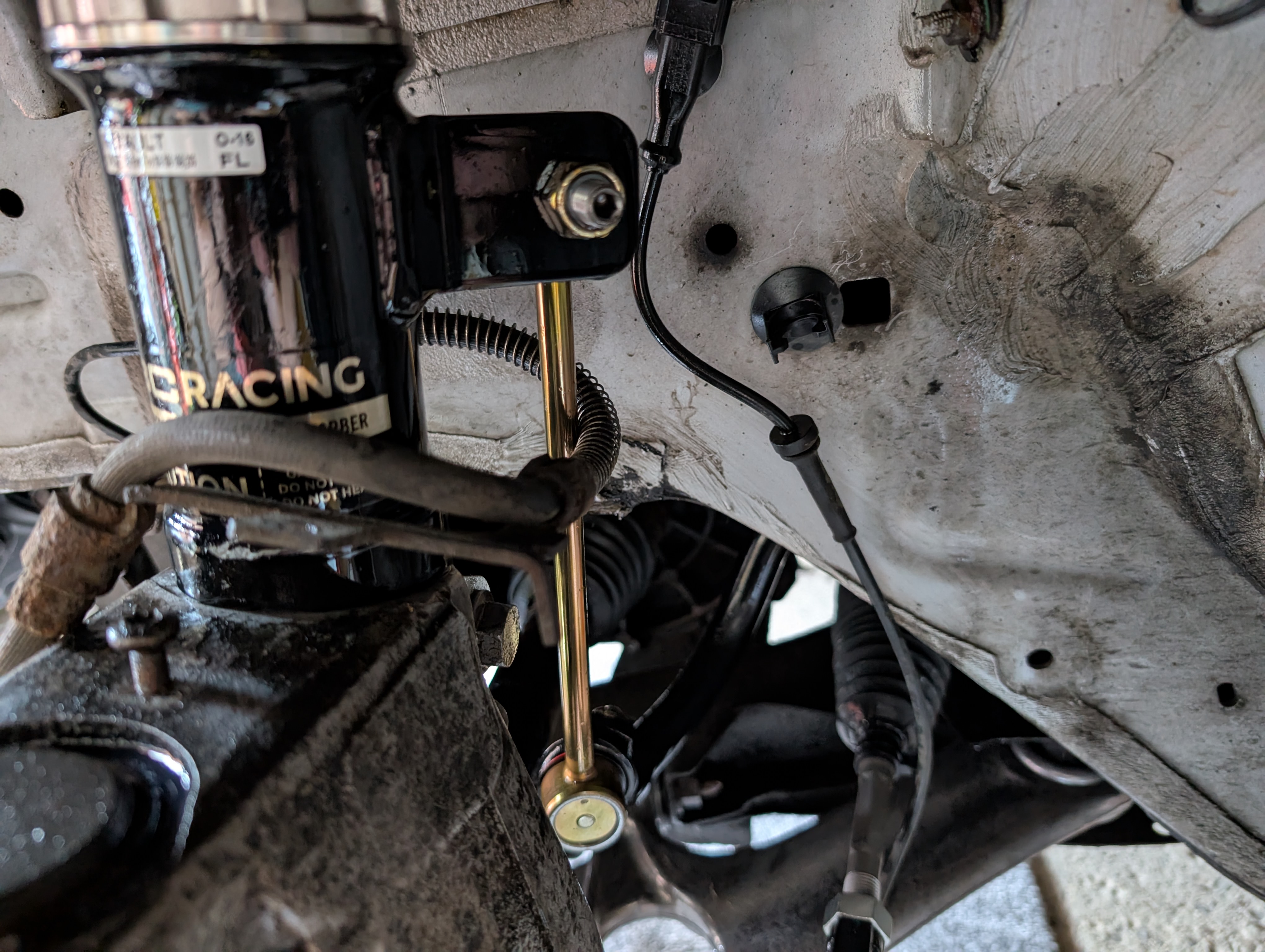

BC Racing BR coilovers including new arb links.
Ocap swivel hub bearings.

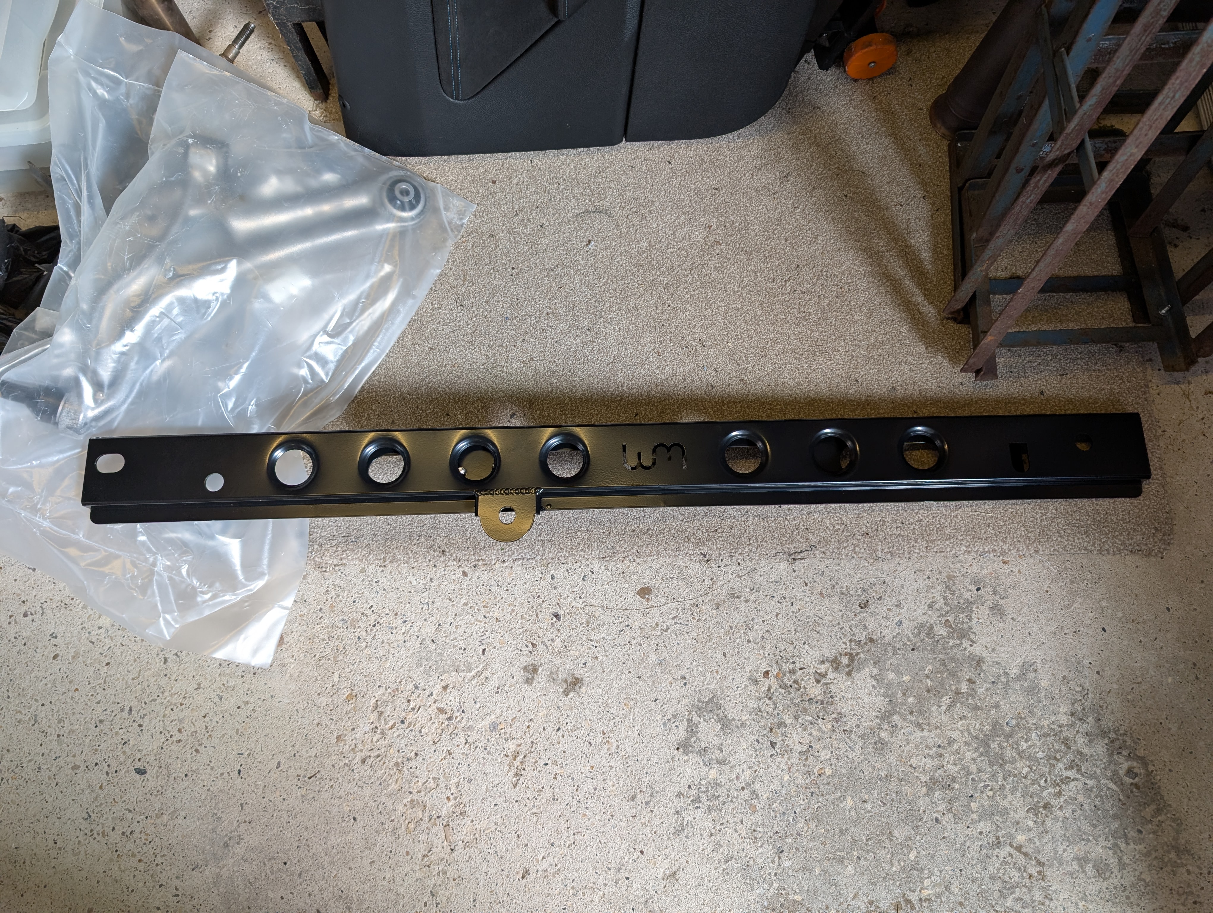

Plus line ac condenser with Renault seals.
Some very expensive Renault nuts.
New radiator support.

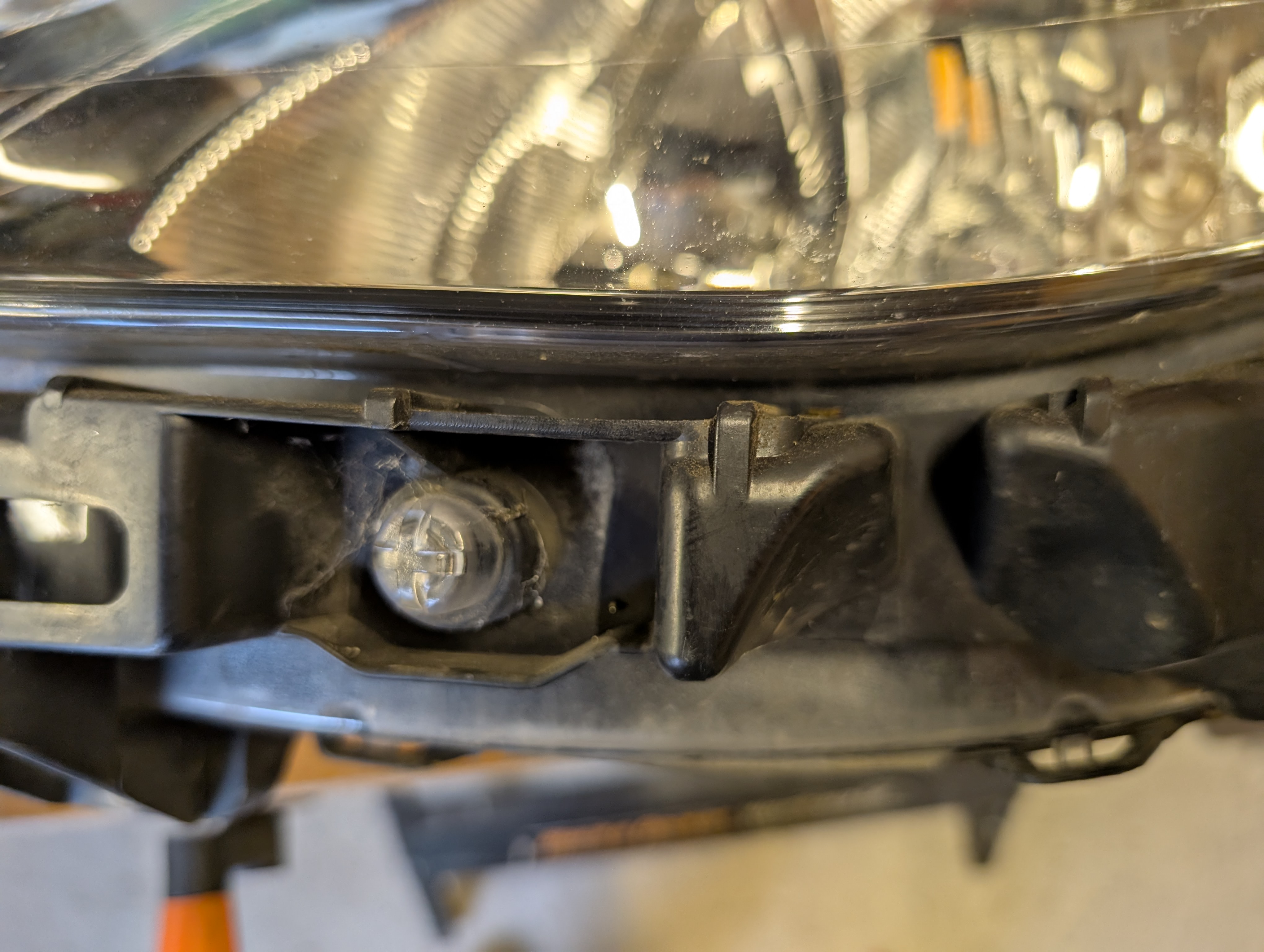

Used nearside headlamp.
Service kit from RPD.

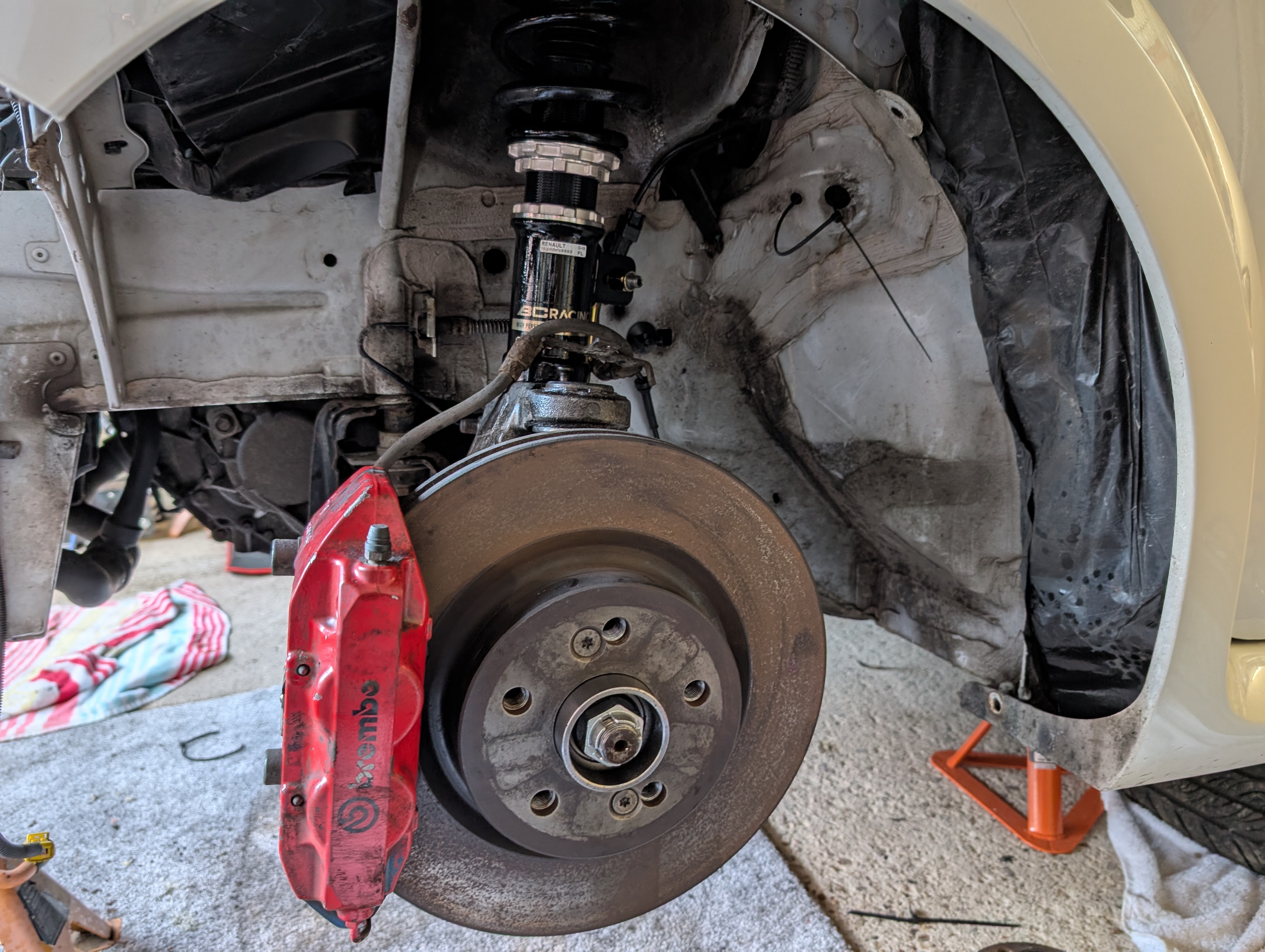

Putting it all back together was pretty straightforward but still had a few hiccups.

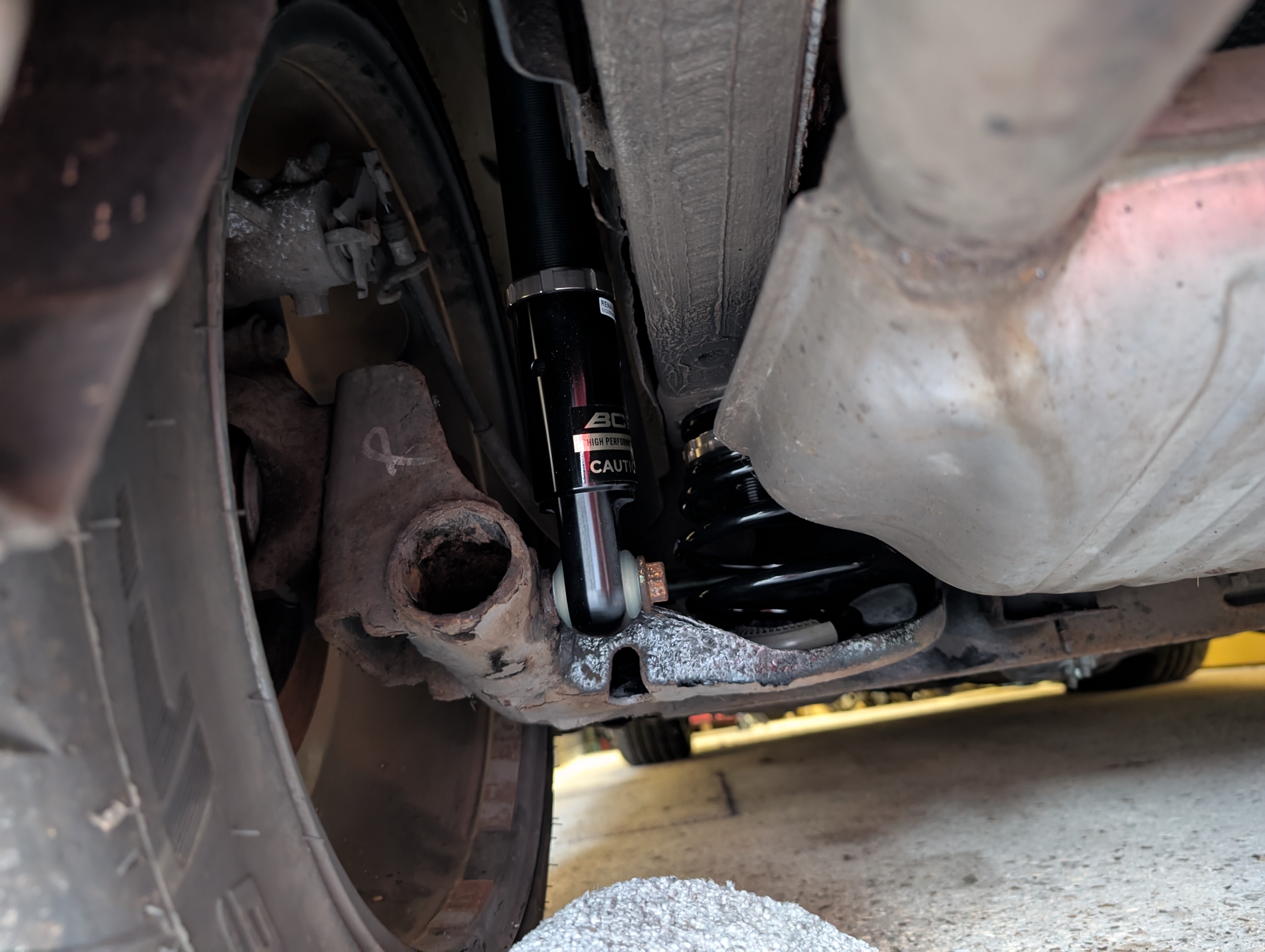

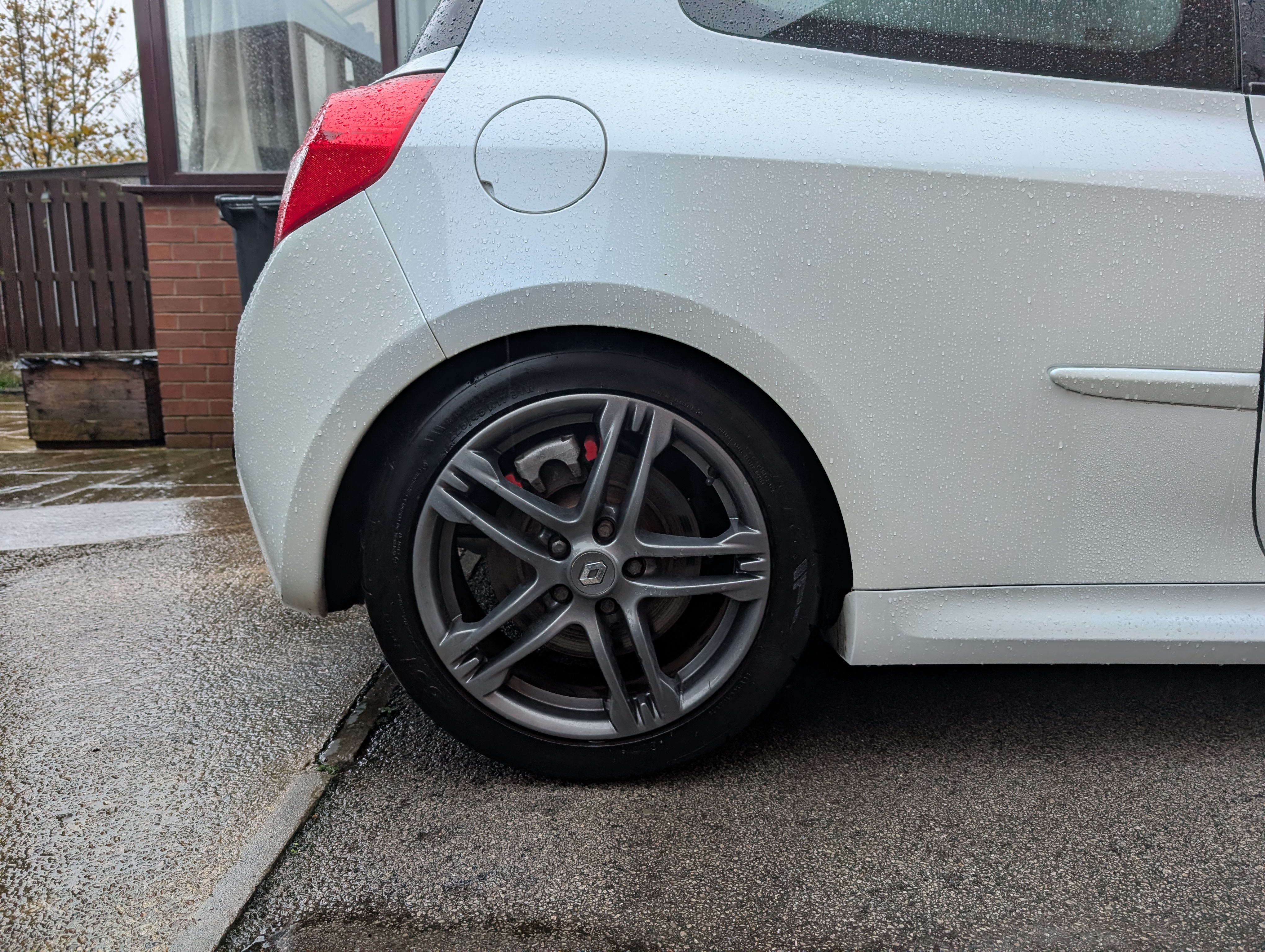

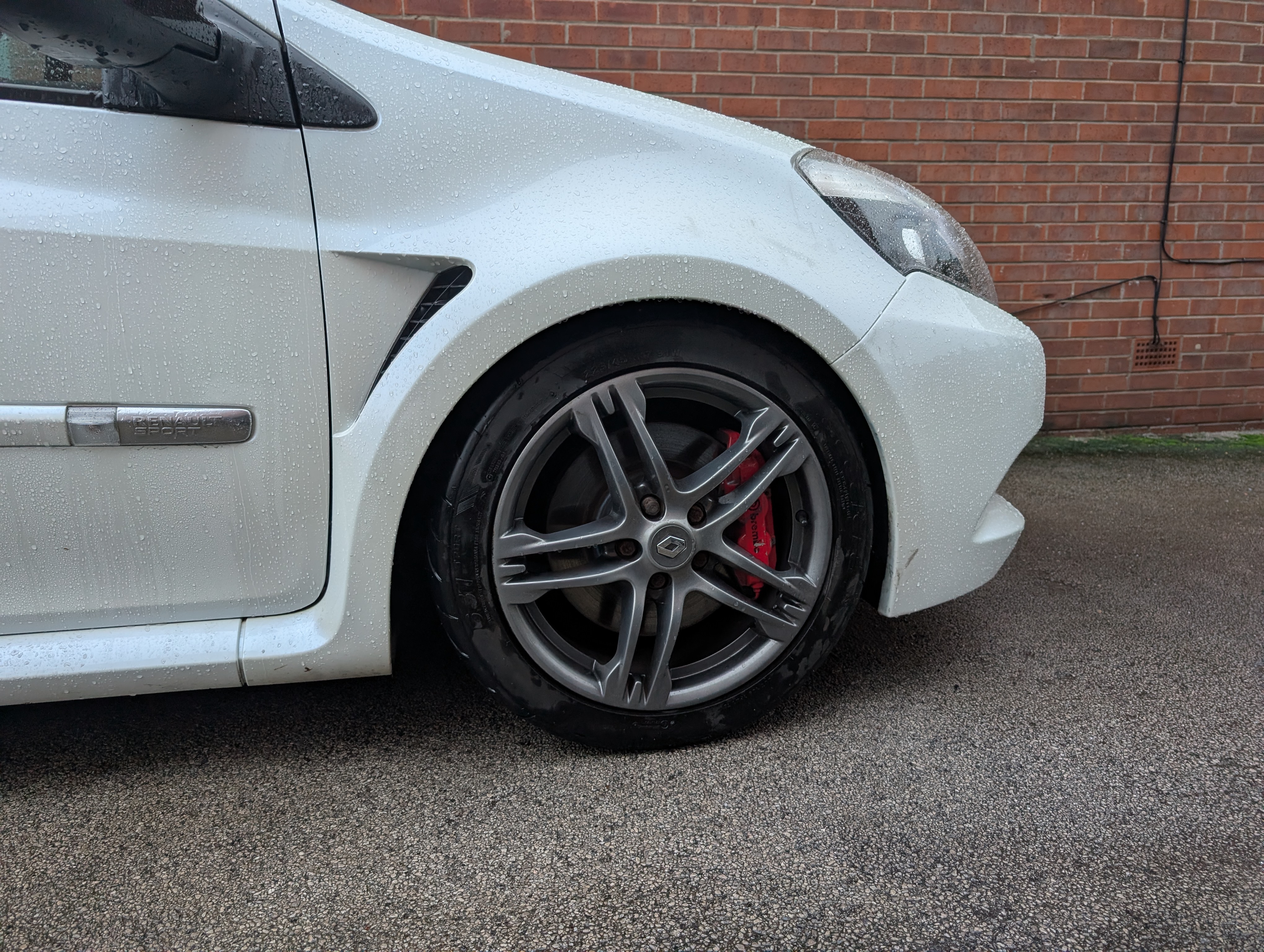

Ta-da! Suspension all refitted.

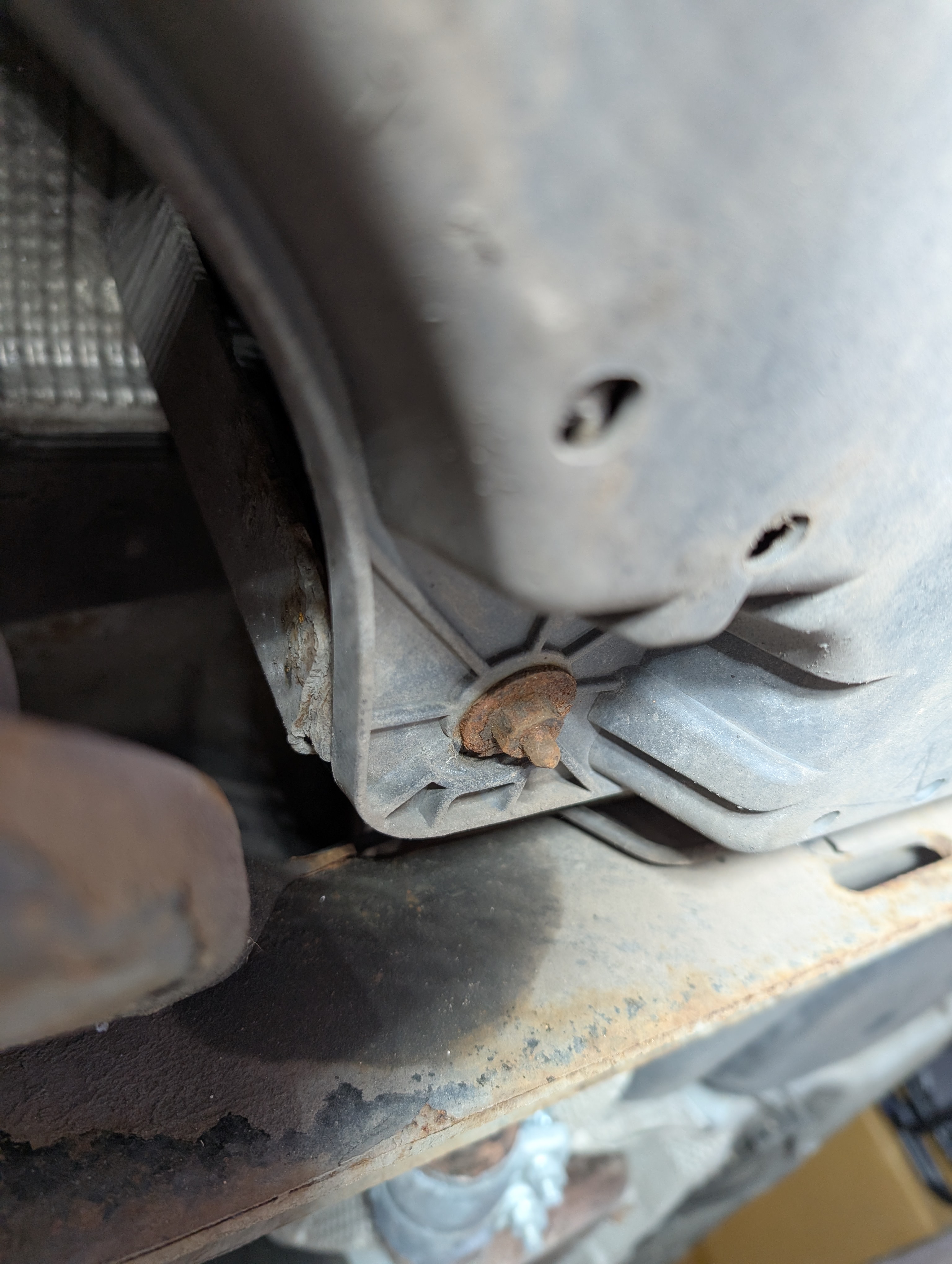

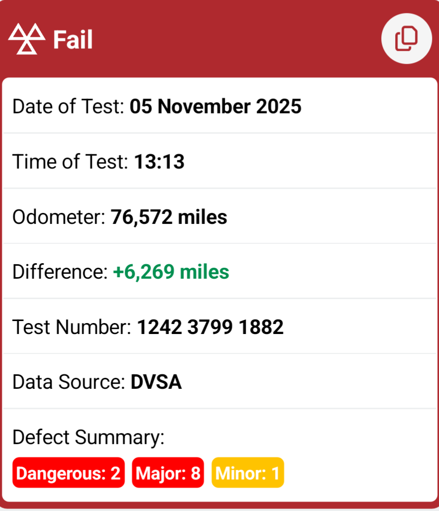

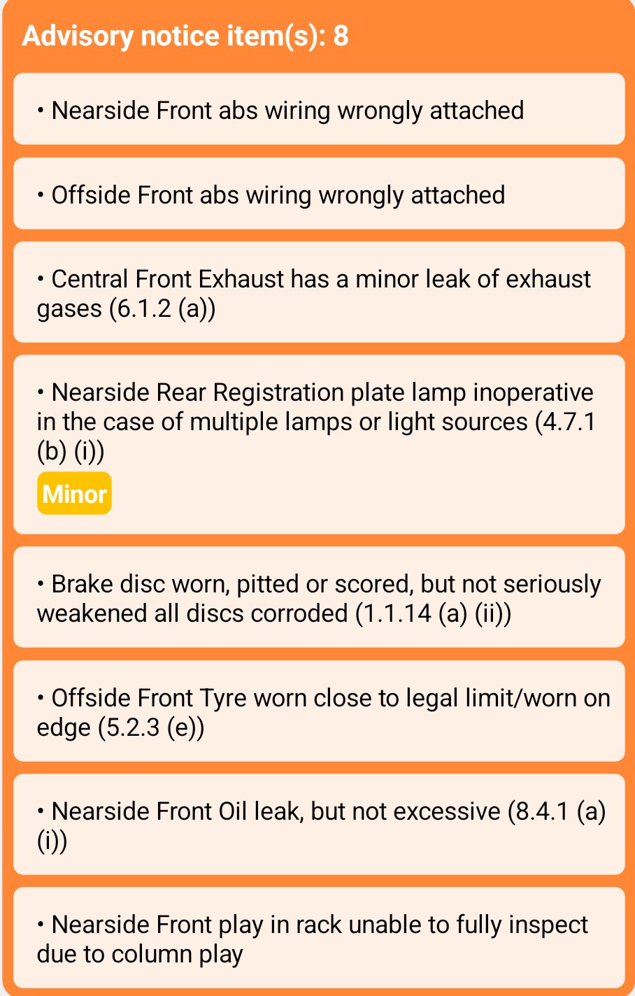

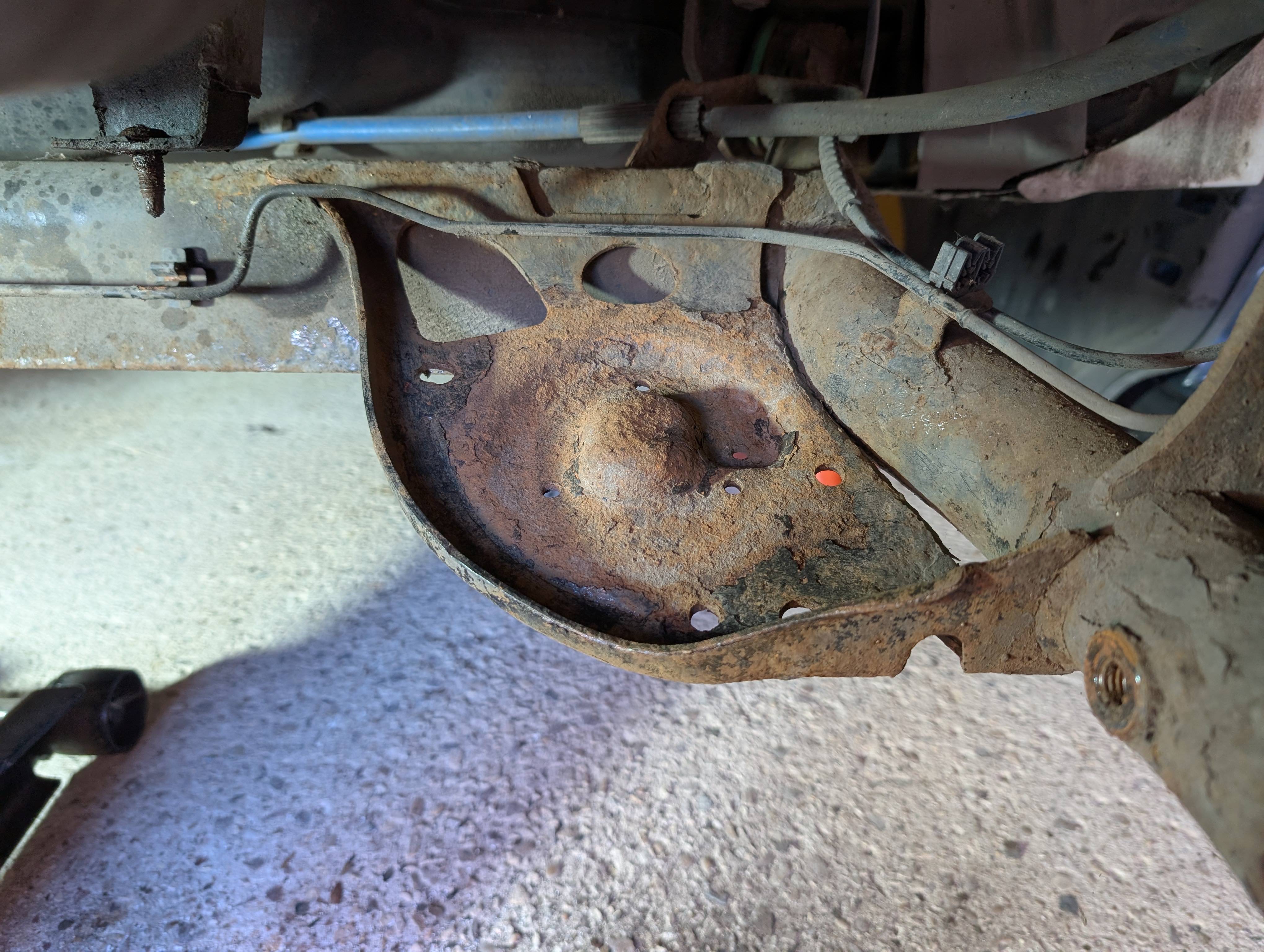

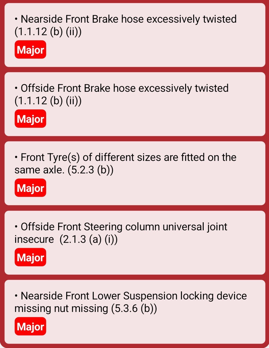

Obviously the discs needed a quick de rust with a wire wheel and the arches and other parts you never see got a bit of a clean. Looks easy but what went wrong?...
