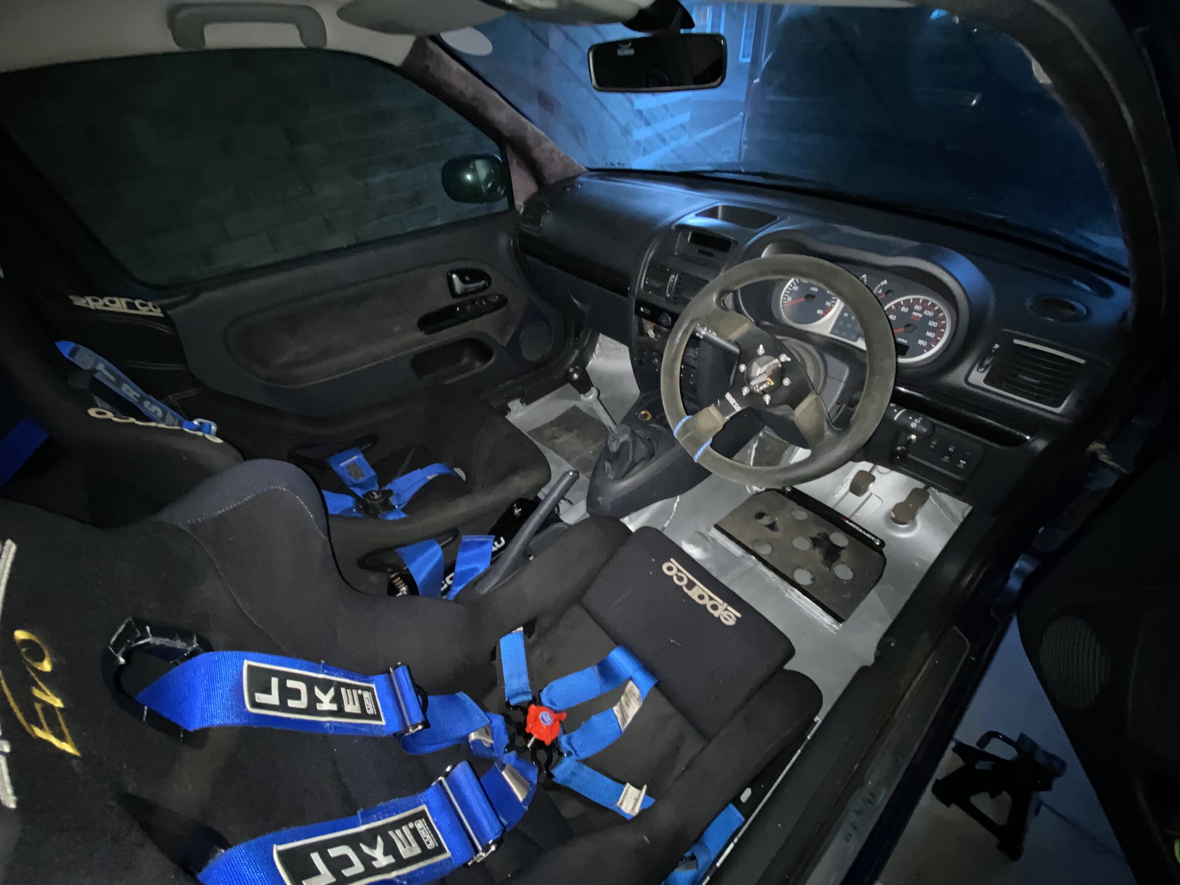

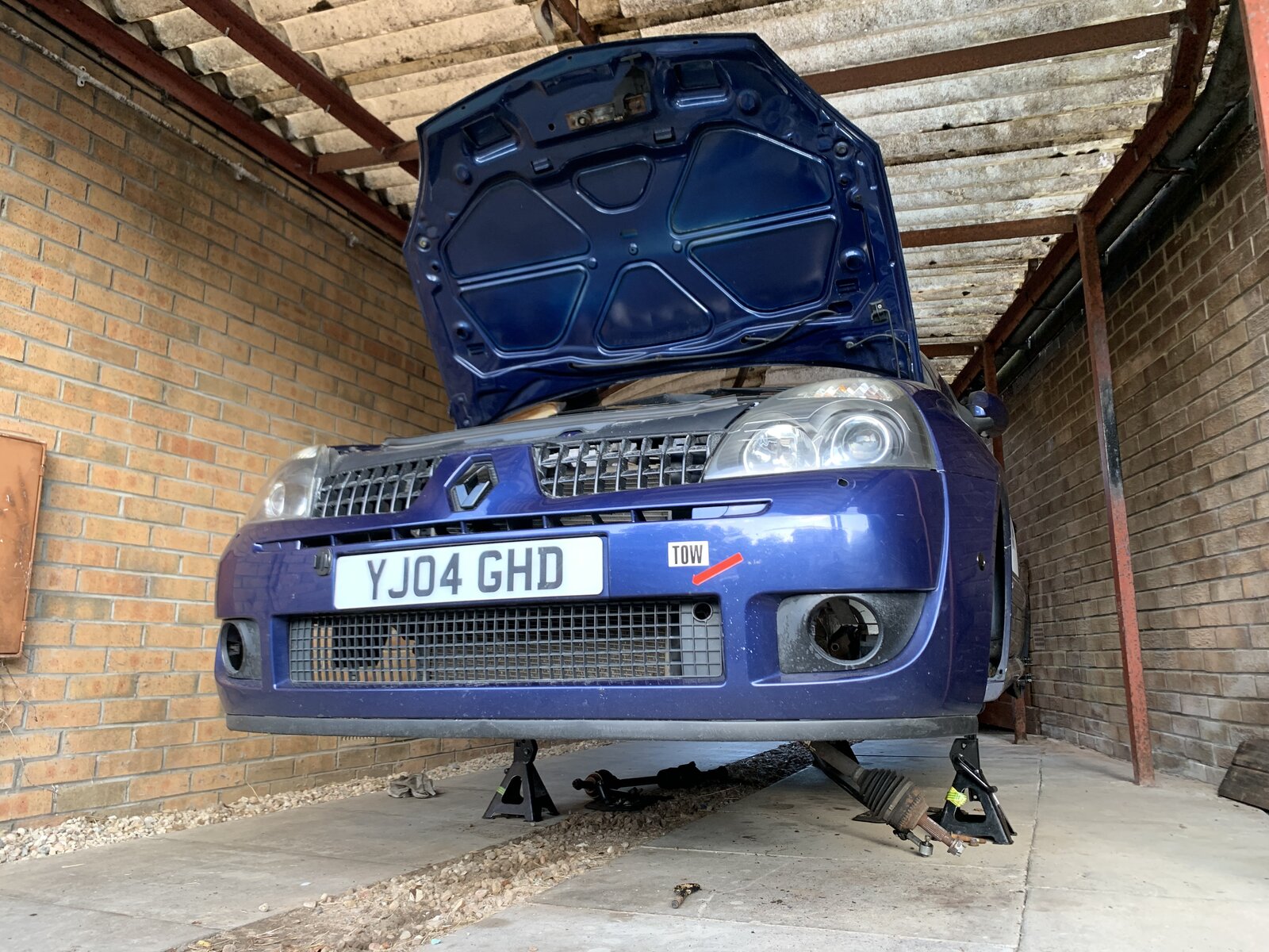

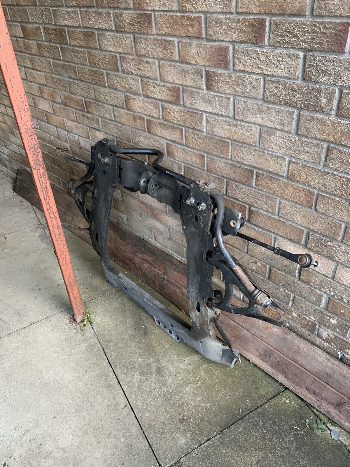

And now it’s in a 1000 bits! 😂 subframe off for new arms, hubs off for new bearings, new ARB bushes on both ends and gearbox coming out for a refresh also! Hopefully get the subframe powdercoated when it’s off just to neaten everything up!
about 20kg’s of factory and aftermarket sound deadening removed also! Hopefully make a difference to the performance!

Lightening is obviously the cheapest mod.
Any metal brackets that arent used anymore get them off.
Theres a huge chunk of steel underneath drivers side engine mount that can go. Rear wiper delete.
All airbags out, stereo, speakers, wiring.
I'm guessing your in road going production class so have to keep your interior but what about headlight blanks? The hid's are quite heavy.
  172, Fiesta S1600
Got all the extra weight out I can at the minute. Pretty sure I can’t use light blanks due to it having to be road legal. Going to swap to non xennons and maybe a cup heater box and rear seat setup. I have a new set of wishbones planned but still waiting on the MSA to confirm or shelve the new regulations as I may go custom arms.

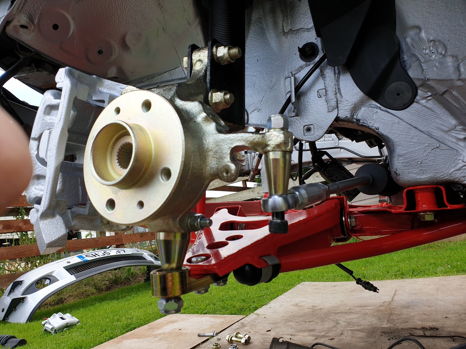

The winter development continues...

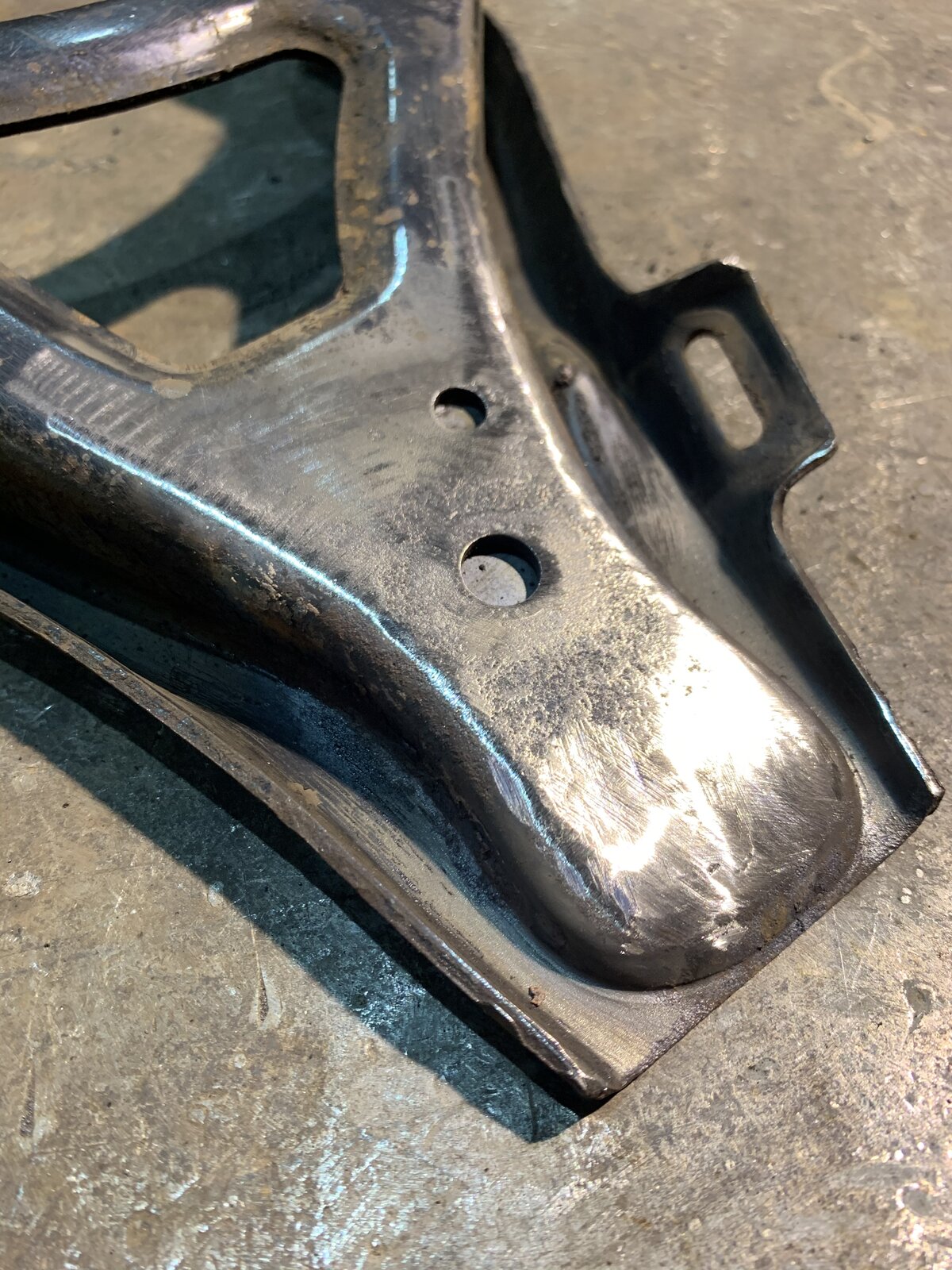

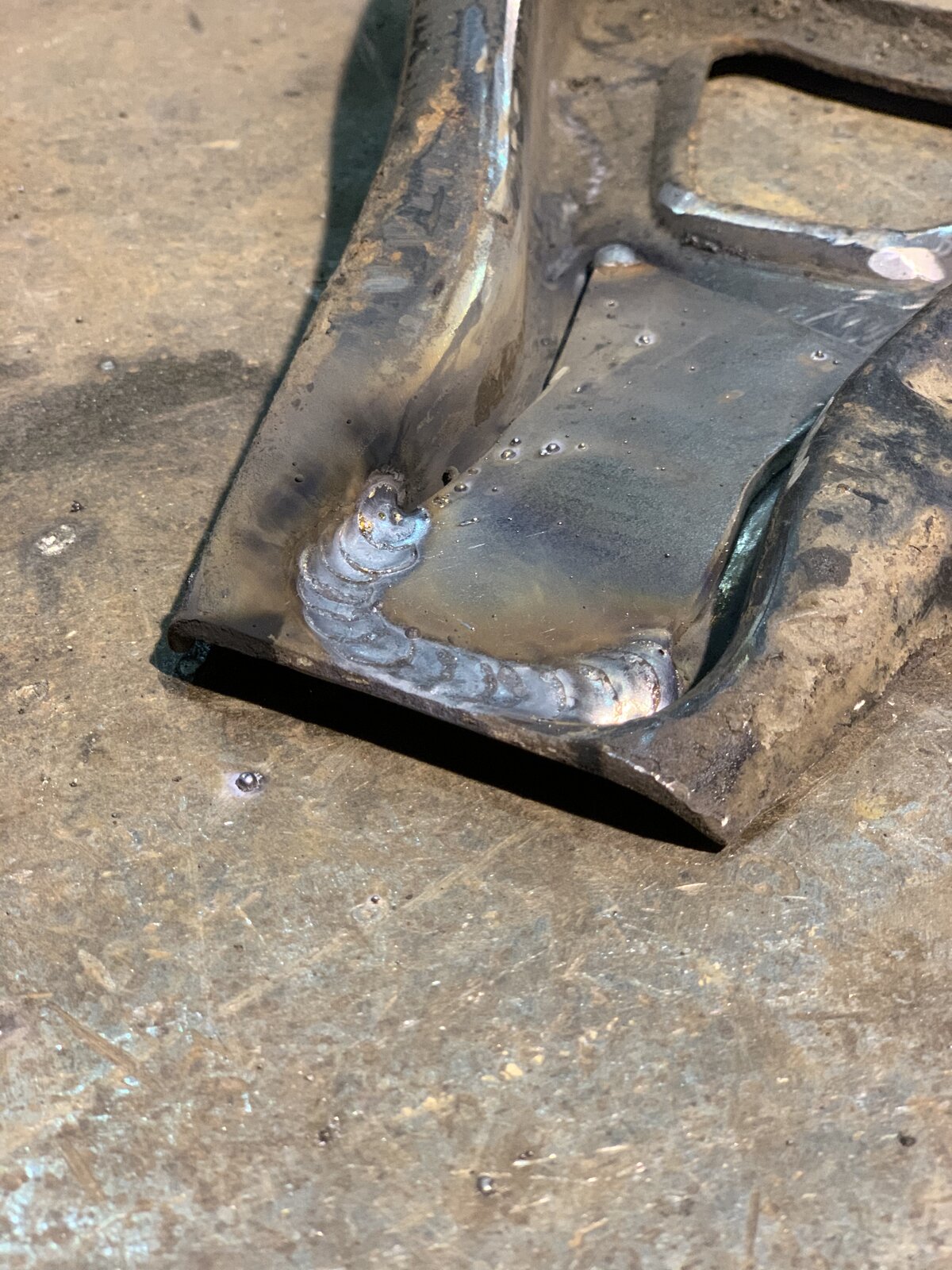

Some lower arm modifications that I naively thought I had came up with on my own until I spoke to one of our fellow competitors and he had already done it to his many years before. I then done a search on here after doing the fabrication and found it had been done also! Pretty certain I’ll have some tyre rub but I’ll remove the spring and go to full bump with the damper and see where it catches. This can then be modified to suit.
Gearbox is out, it seems someone has been using ATF in it which apparently these boxes don’t like. I’ll strip that one and see what is the cause of the whining. I’ll source a good box and get it sent to Nick at PMS as I have a plate diff to go in. All just needs paid for! 😩
Got a parts list as long as my arm just to replace as precaution for the next season.

What's the plan? Redrill the hole further forward for more castor?
NorthloopCup
Nothing against Mark but the guy I’m getting the diff from uses Nick for his box builds and it’s kinda in with the price so I’ll be sending it over to him.
Yeah going to try and eek some more caster out of the arms.

How much caster are you aiming for?
Whatever the holes in that position give me tbh! I don’t want to have to go too mental with chopping bits out here and there on the body so probably more than cup. There will be a bit of tweaking to get it right both sides once I get the car back together.

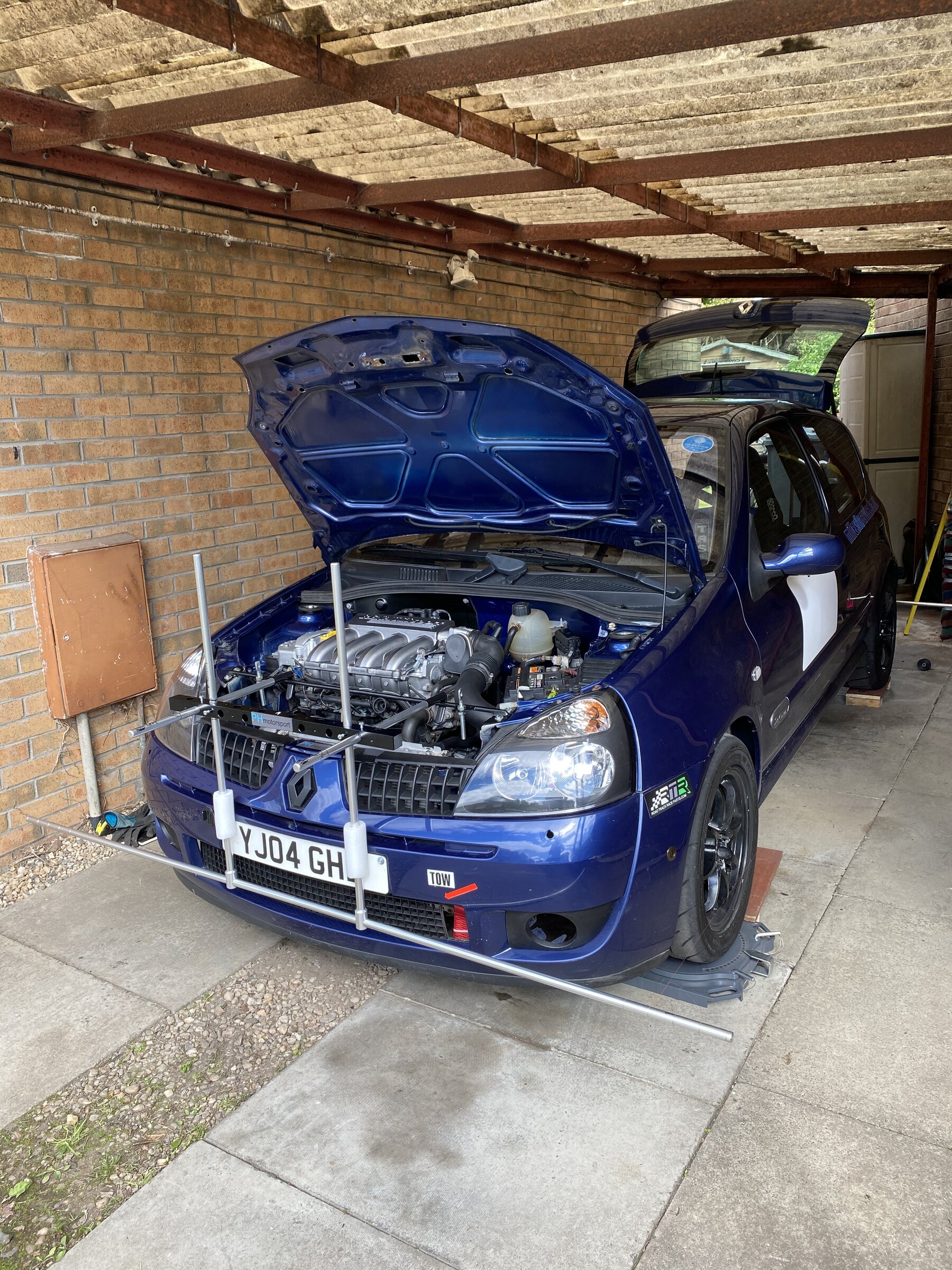

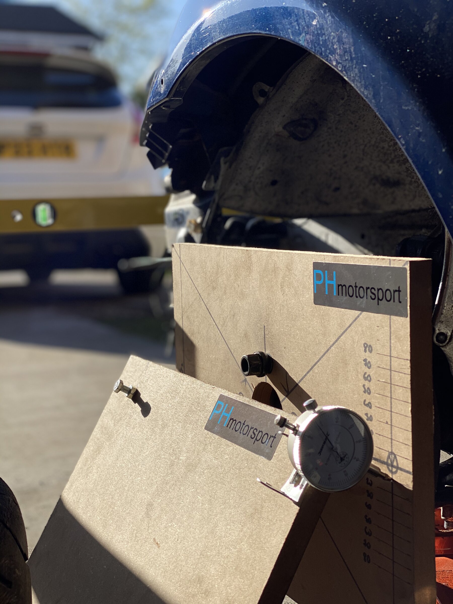

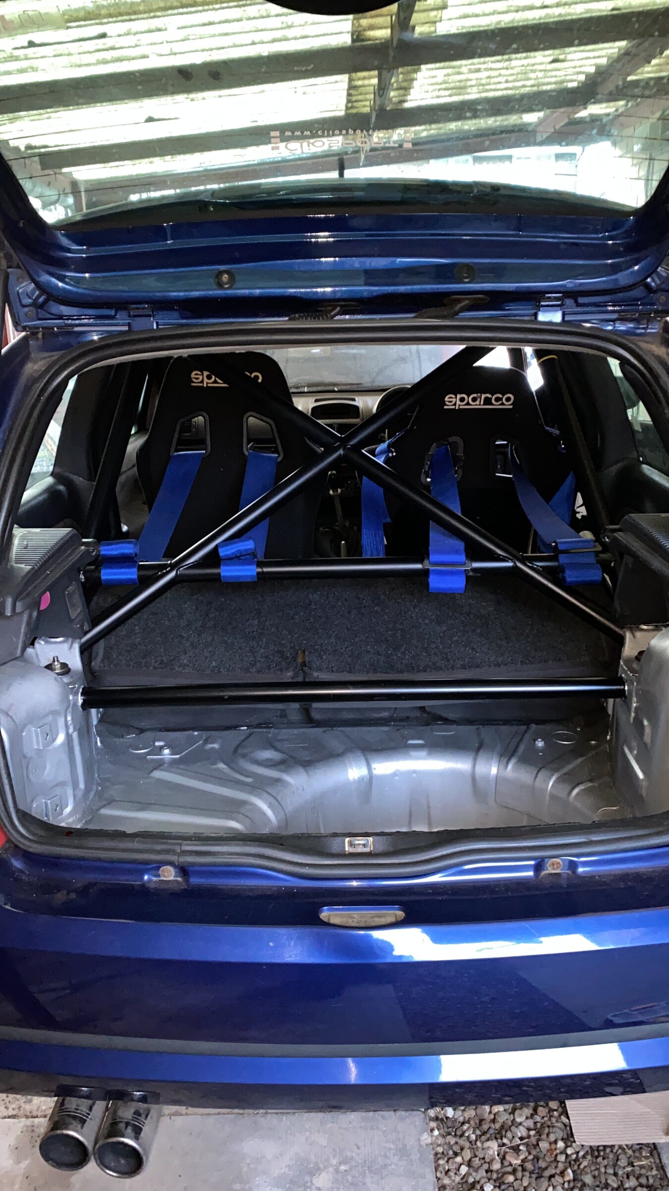

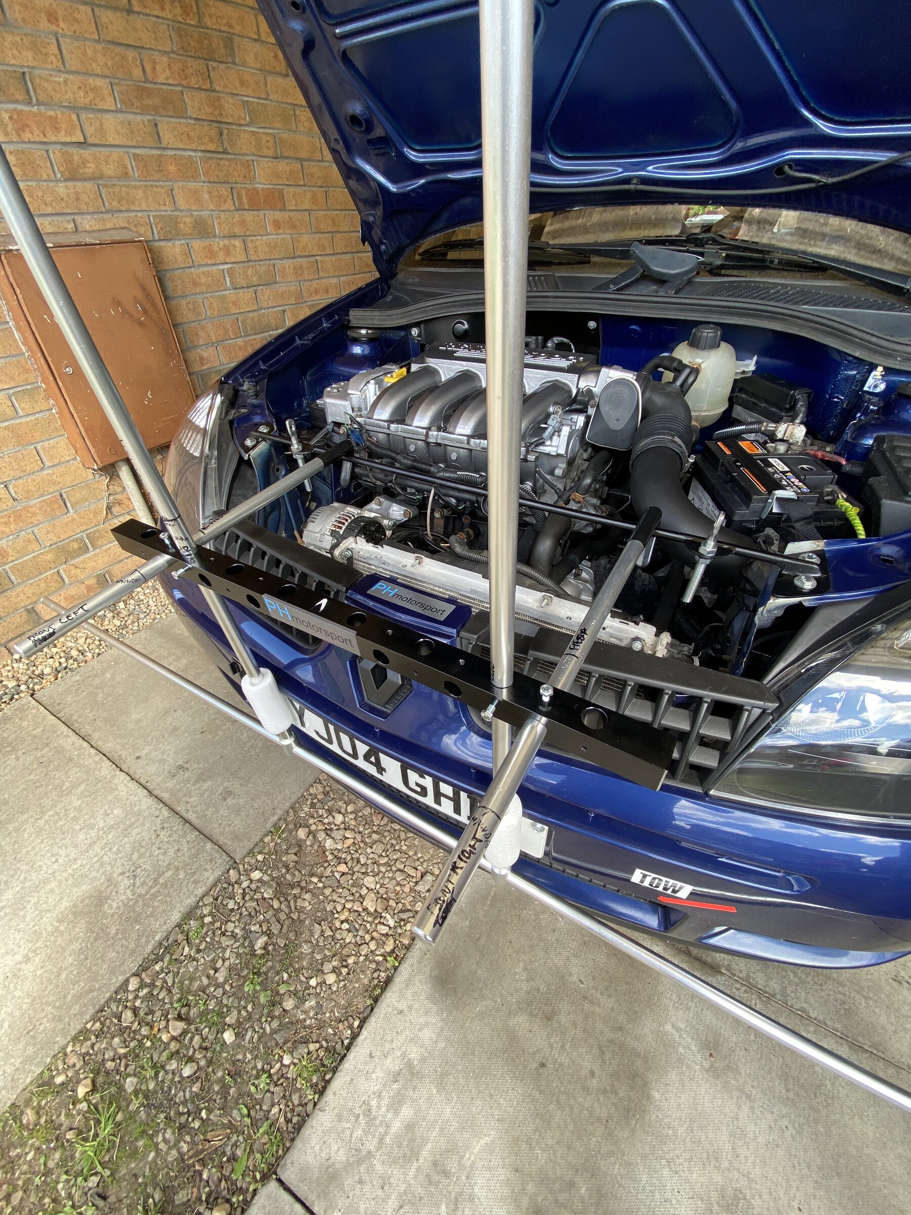

Update on how the car looks now! Headlights swapped to non xennon 1kg saved there. Rear Safety devices cage fitted! AST’s away to Cornering Force for rebuild. Bought a set of B14 bilstein for it to sit on for now! Rear Gaz will be going for rebuild shortly too! 182 manifold also fitted which meant a bit of exhaust fabrication as I sold the 172 cat for moon money.
Slam panel removed and lightweight bonnet pin mount fitted in its place. Inlets port matched by myself and painted by Brayon Classic Engineering near Loch Lomond. Various other bits painted on the engine like alternator brackets, cam cover and the block just to tidy it all up a bit.
Rear powerflex black series fitted. New bushes fitted to front increased castor arms. Bump steer measured and ride heights altered to see what the difference was, this is still ongoing and hopefully I’ll work out a solution soon. Oil temperature gauge fitted and wired. Shame I won’t be able to use the car this year competitively.
Diff and gearbox refresh still on the cards but having to source parts from abroad.
