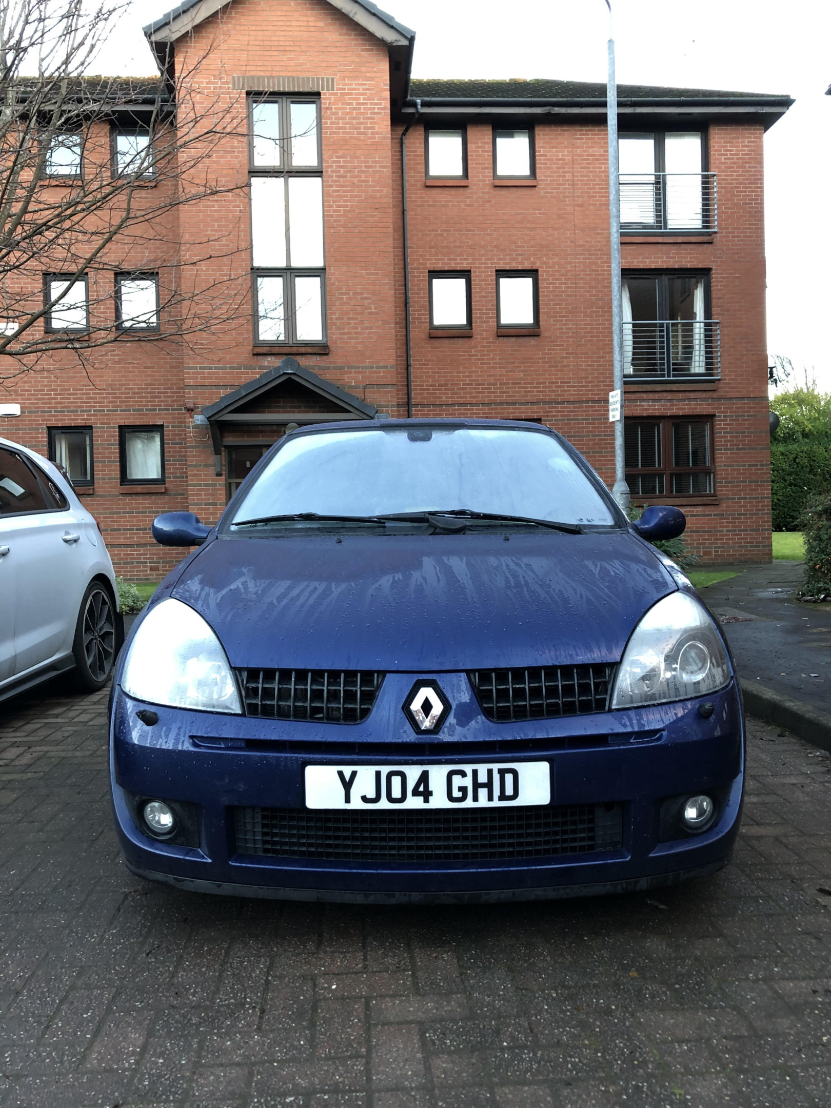

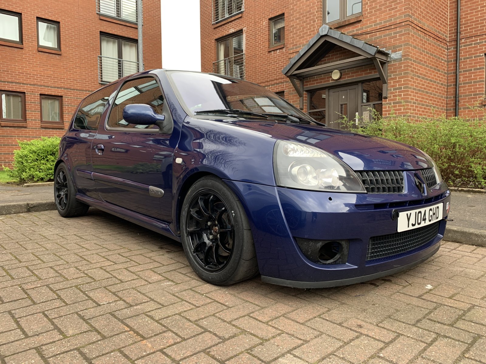

Fairly new here! Recently bought a 172 ph2 non cup in Monaco Blue!
Seen the car on Facebook marketplace and made the trip to somewhere near Morpeth from Glasgow to pick it up! Took my trolley jack and some basic tools along just in case. When we go there I jacked it up and noticed play in both tie rods and the rear arched have been repaired at some point with a bit of rust coming back through so bartered a bit on the price and got it for £700. No MOT but brought it up the road and went to a pre booked MOT where it failed on a ball joint, emissions from a hole in the backbox at the mounting bracket, a bald tyre on very inside edge and the dreaded numberplate light issues!
I rectified this all on the street outside the garage, luckilly the spare was a continental with full tread. There was a motor factors around the corner so got and fitted 2 ball joints and sorted the bulb and pasted the exhaust blow. PASS!
Since then I've washed it, cleaned the inside (disgustingly dirty) got some lowering springs and shocks fitted (for now) as I had a feeling the front springs might have been standard Clio items... Still have the inner tie rods, gaiters and track rod ends to fit when I get home from this work trip.

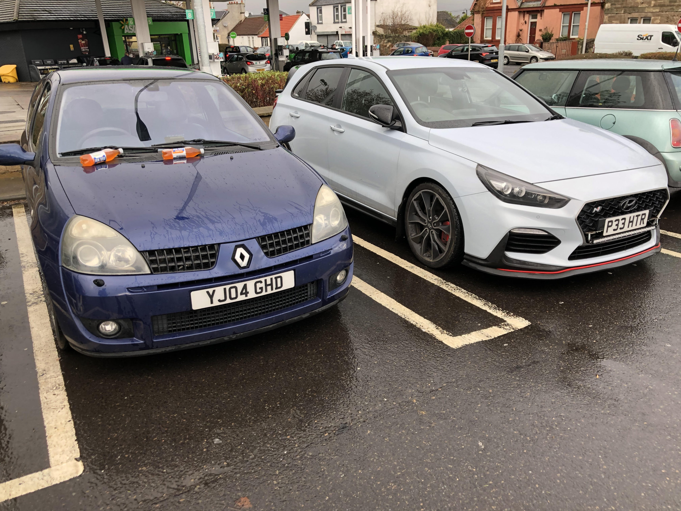

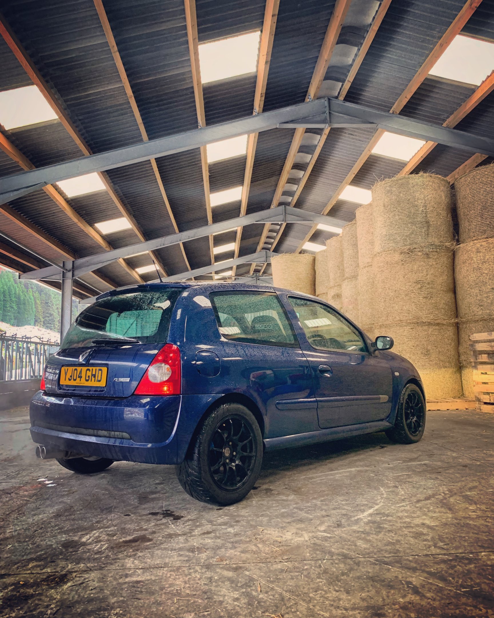

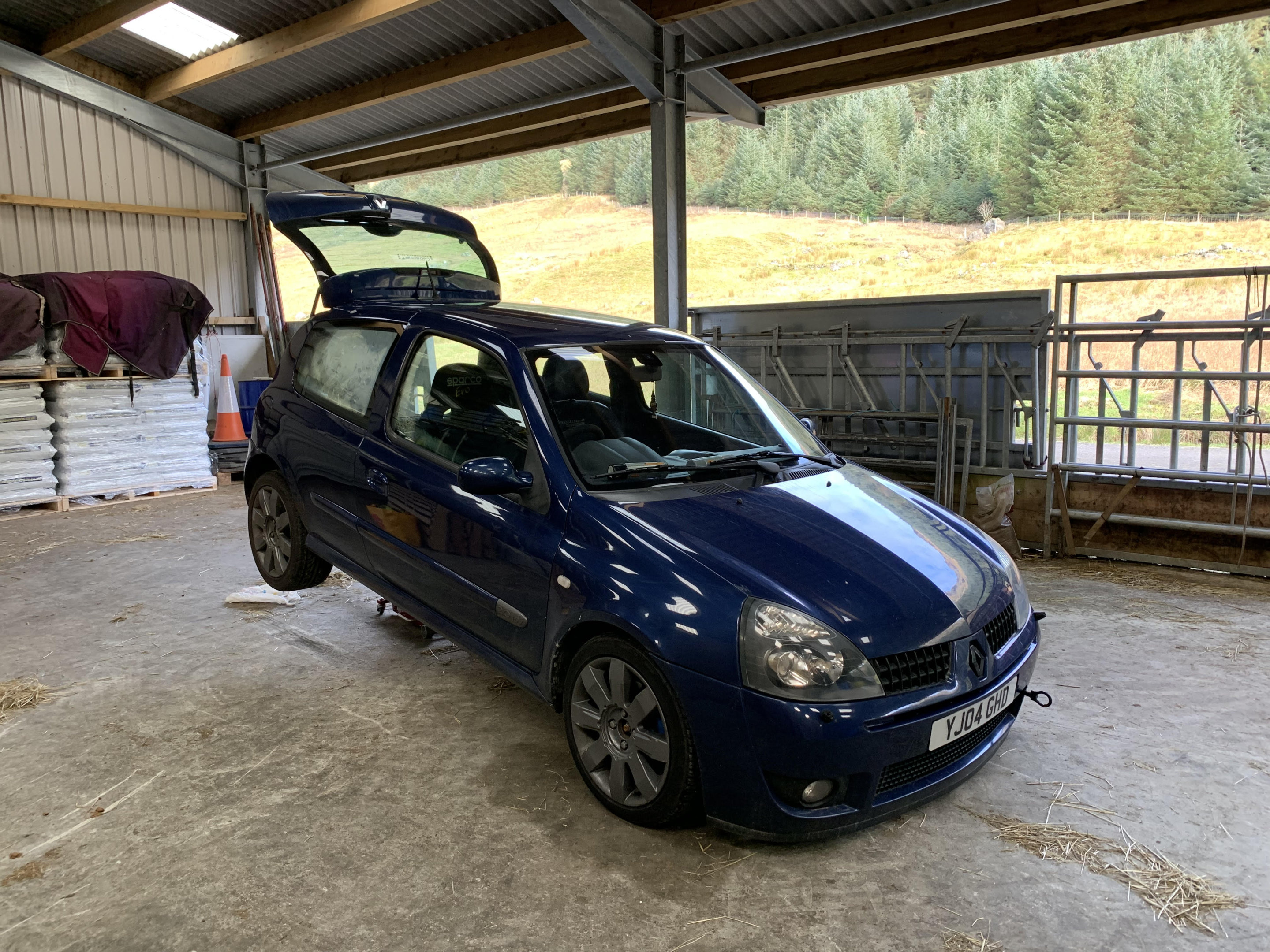

This was a pit stop on the way home for fuel and snacks!

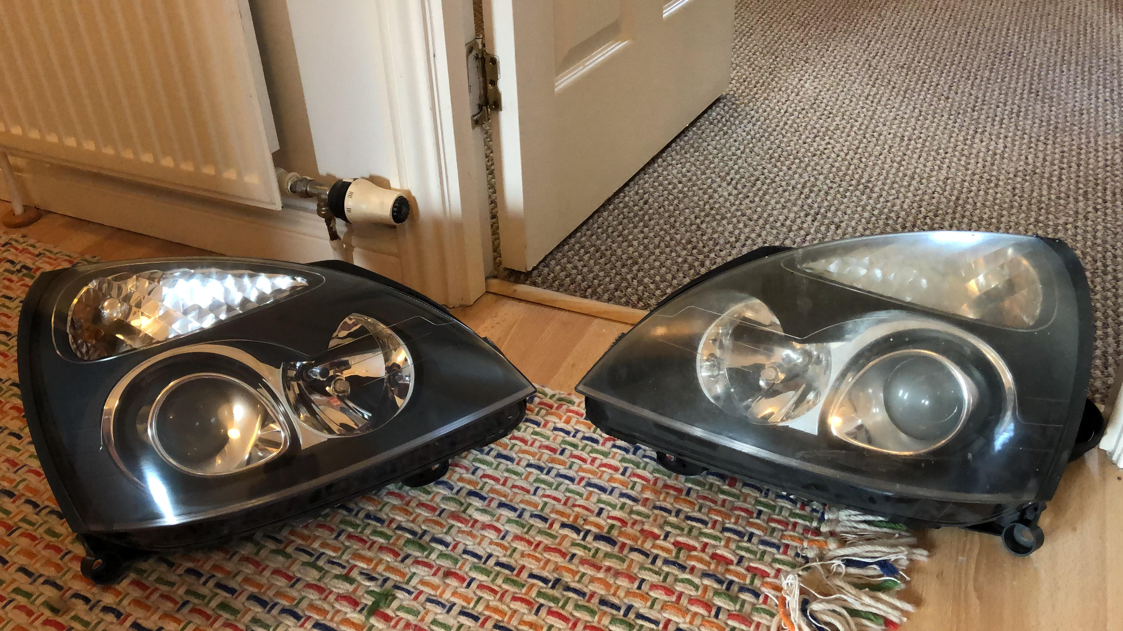

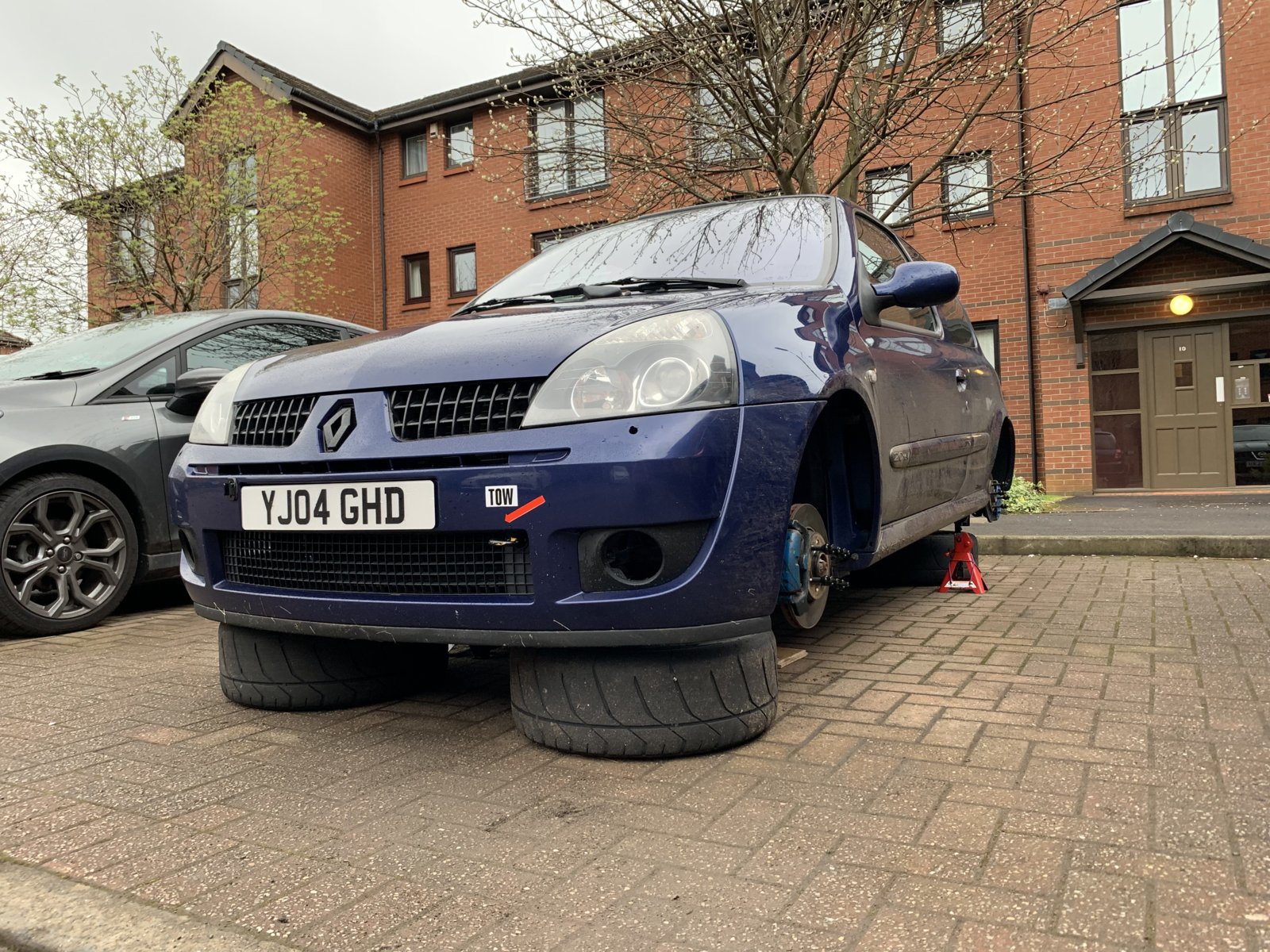

Quickly gave the headlights a rub down and polish, may need to do this again as I didn't have 3000 grit paper so still have some sanding marks.

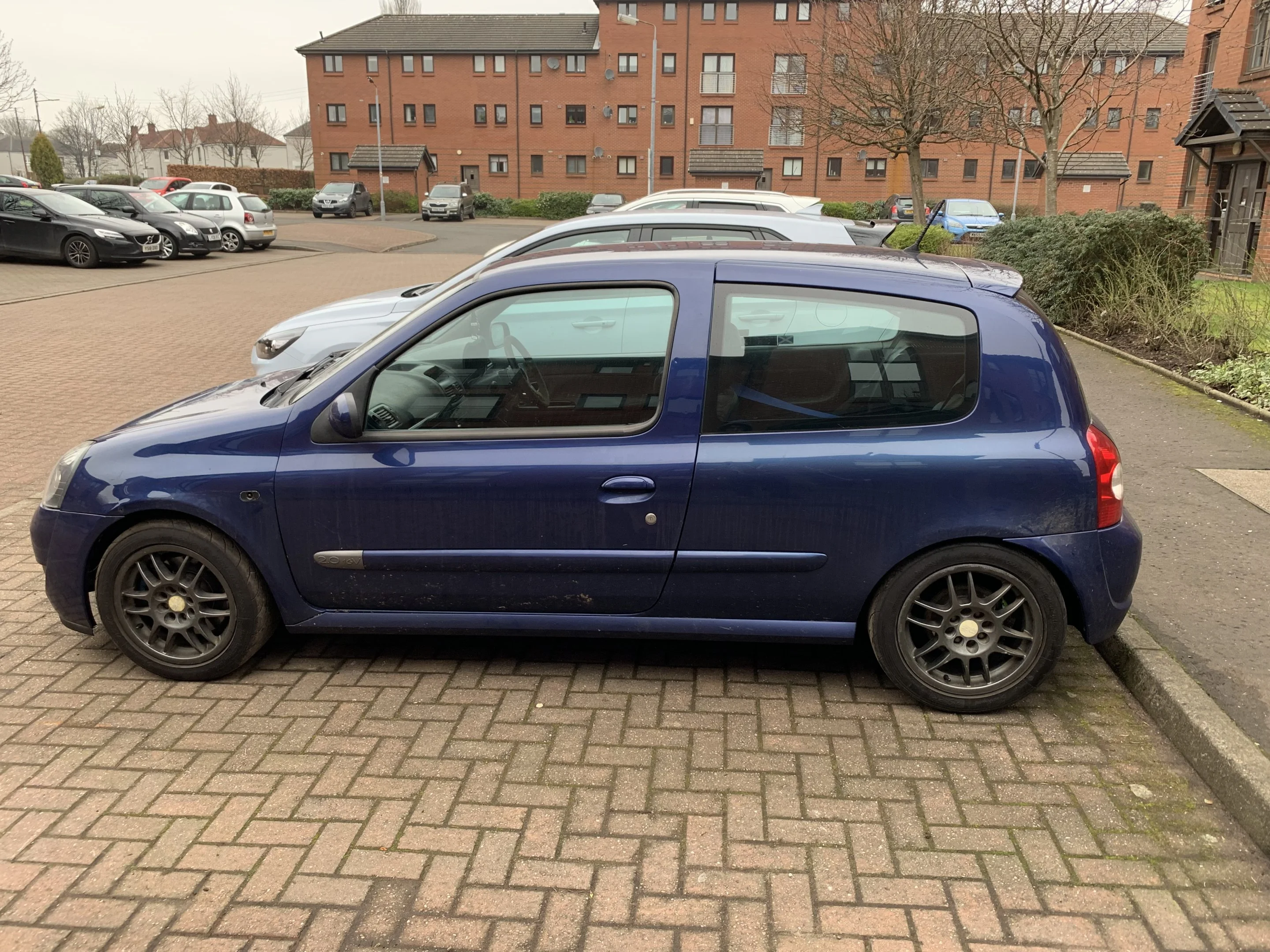

As it sits now with the lowering springs. Really looking forward to getting it driving as it should!

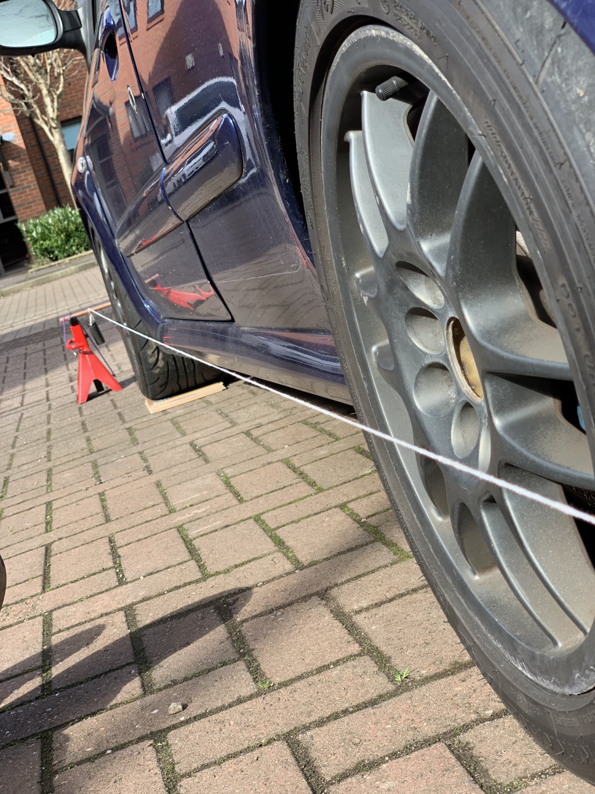

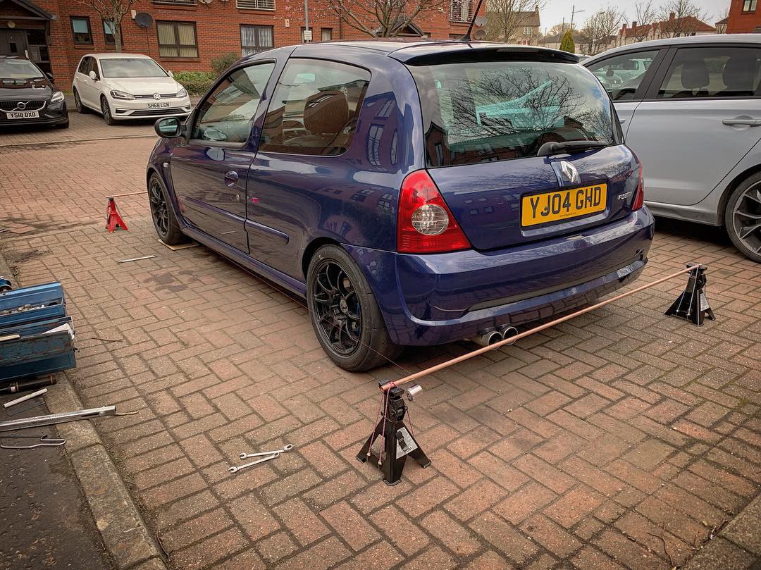

New inner tie rods in, new track rod ends and tracking done by string method but I’m not convinced. Going by the string there is quite a bit of rear toe in? Doing a longer drive tomorrow so I’ll see for sure then.
P.s those rack boots are a total nightmare to fit while on the car! ?

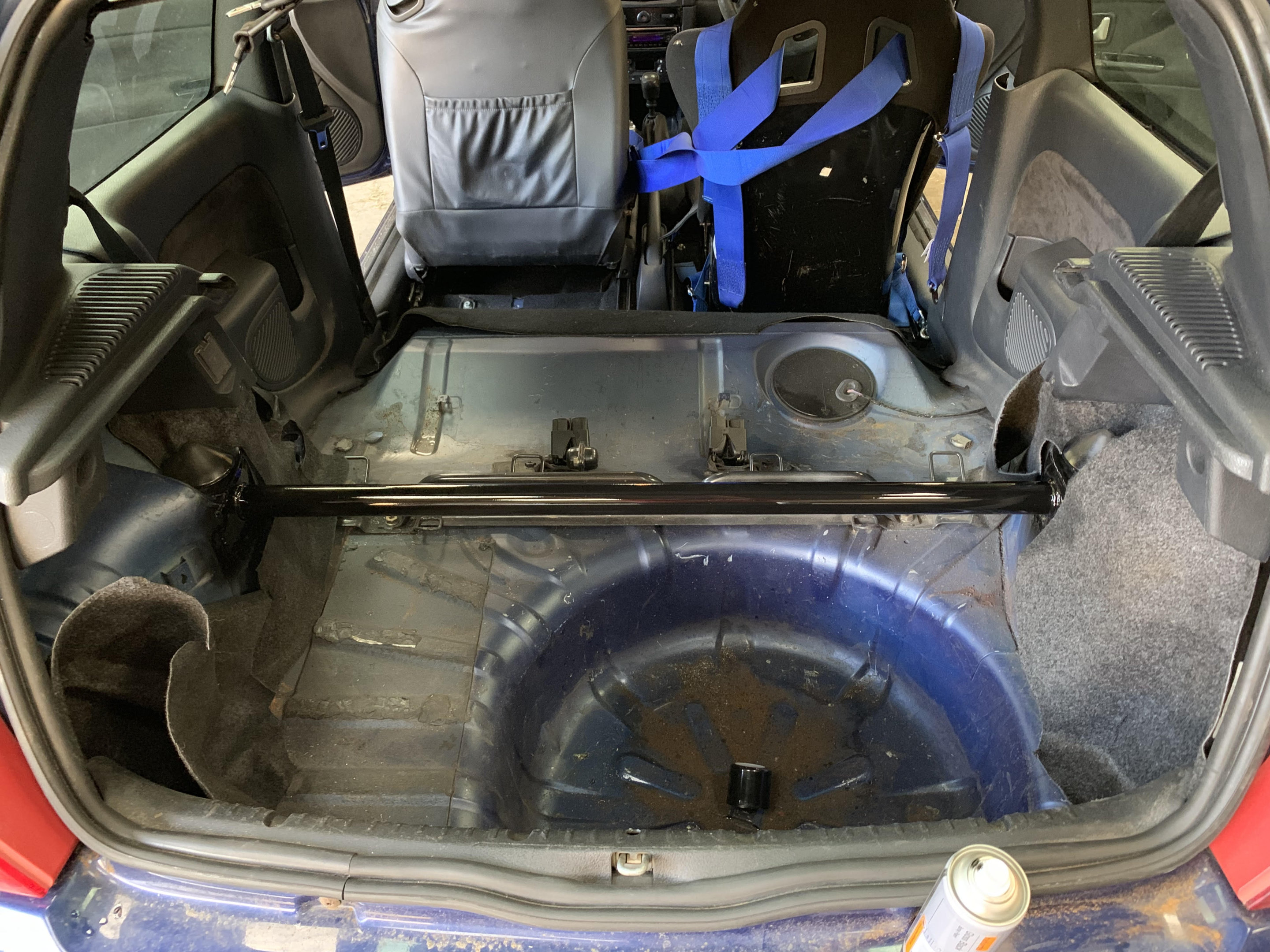

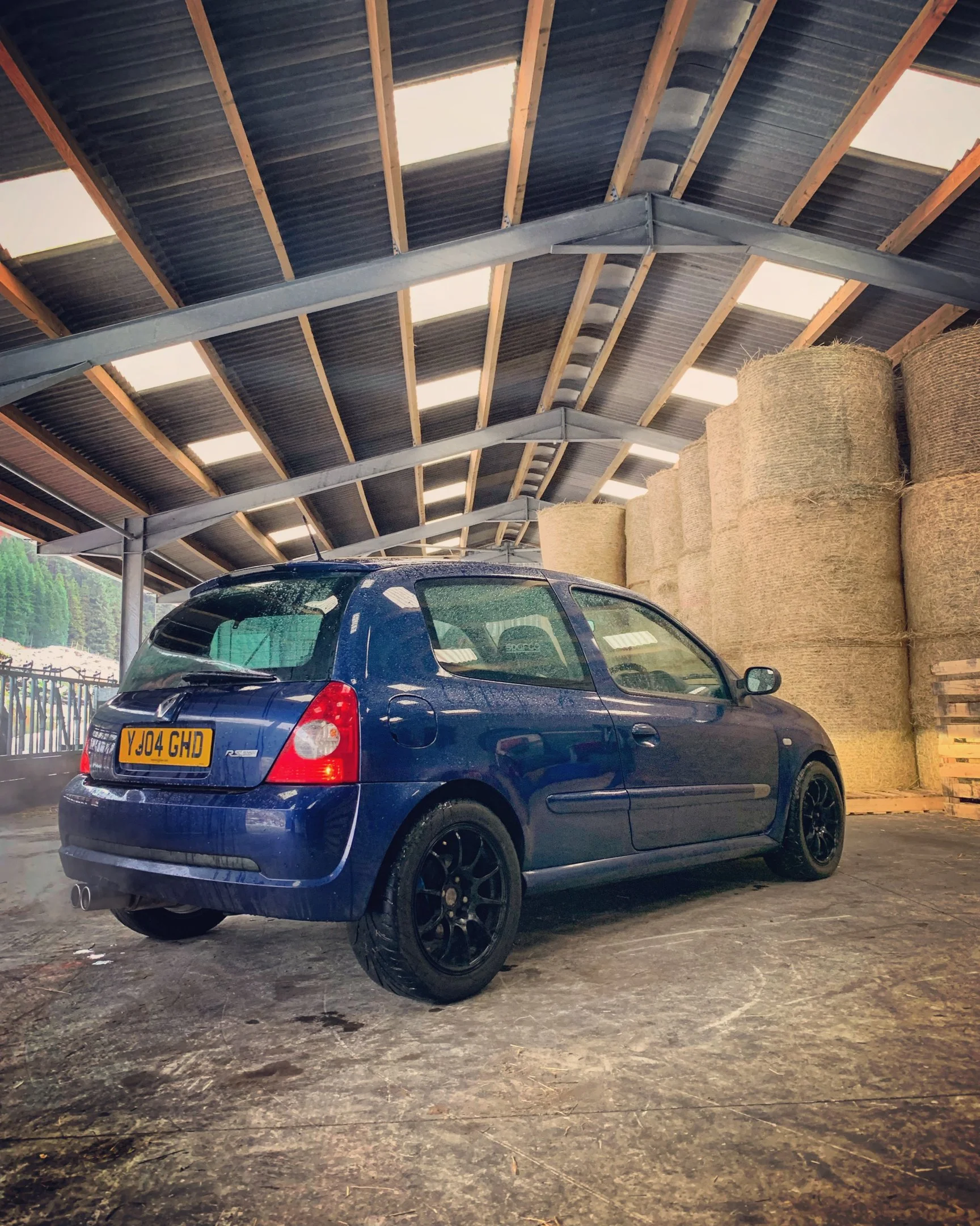

Some progress since last posting.

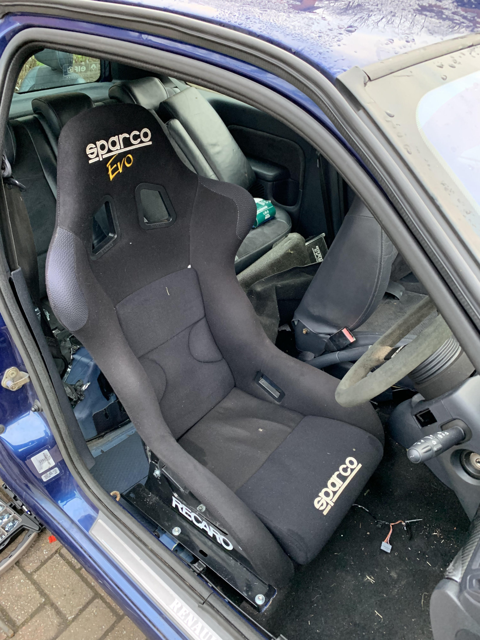

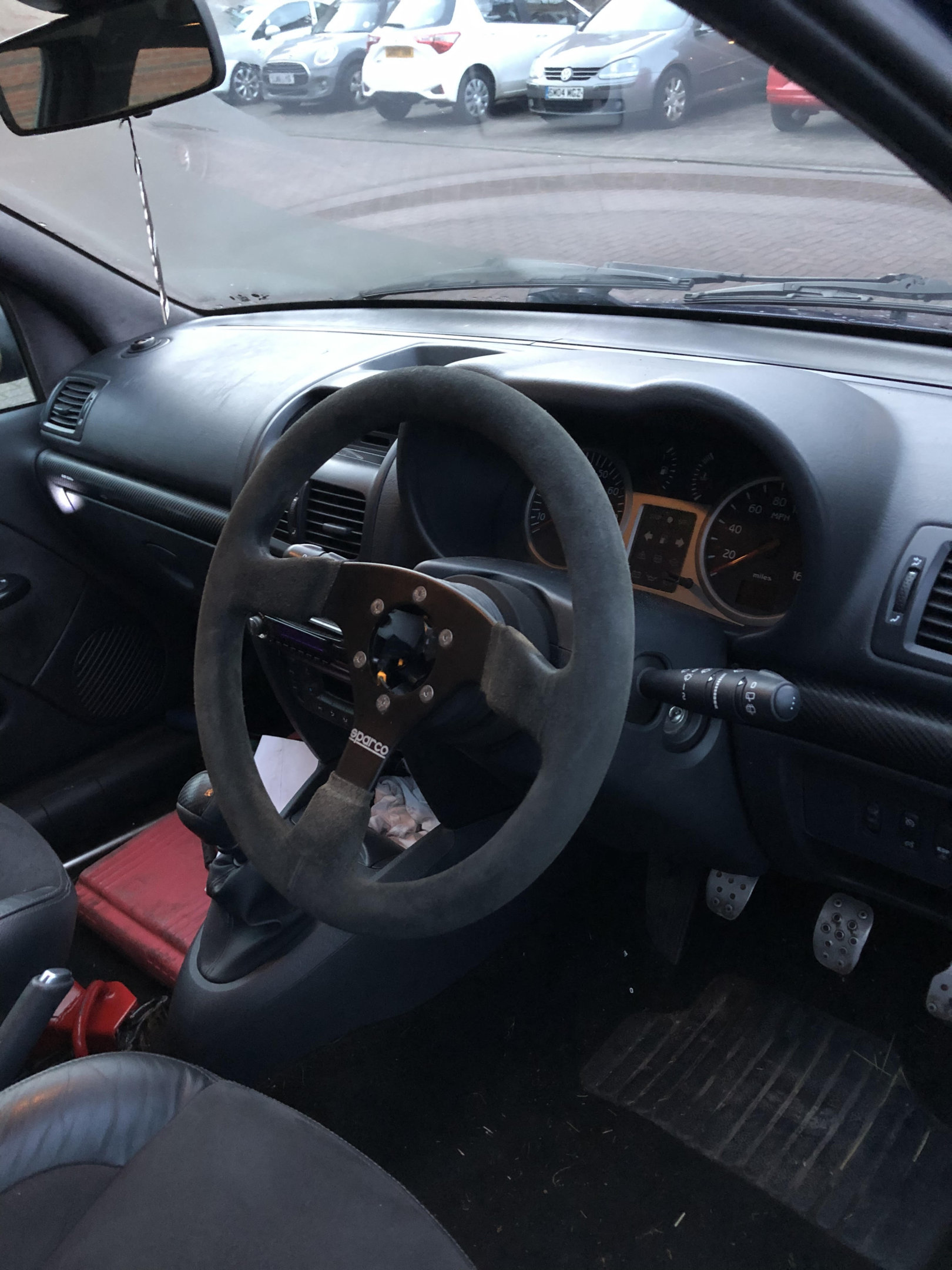

Sparco seat in on a Jon Foz mount (bolts to be changed to cap screws of 12.9 flavour)
6 point harness fitted
Harness bar welded in
Sparco wheel with MOMO boss fitted (resistors fitted also)

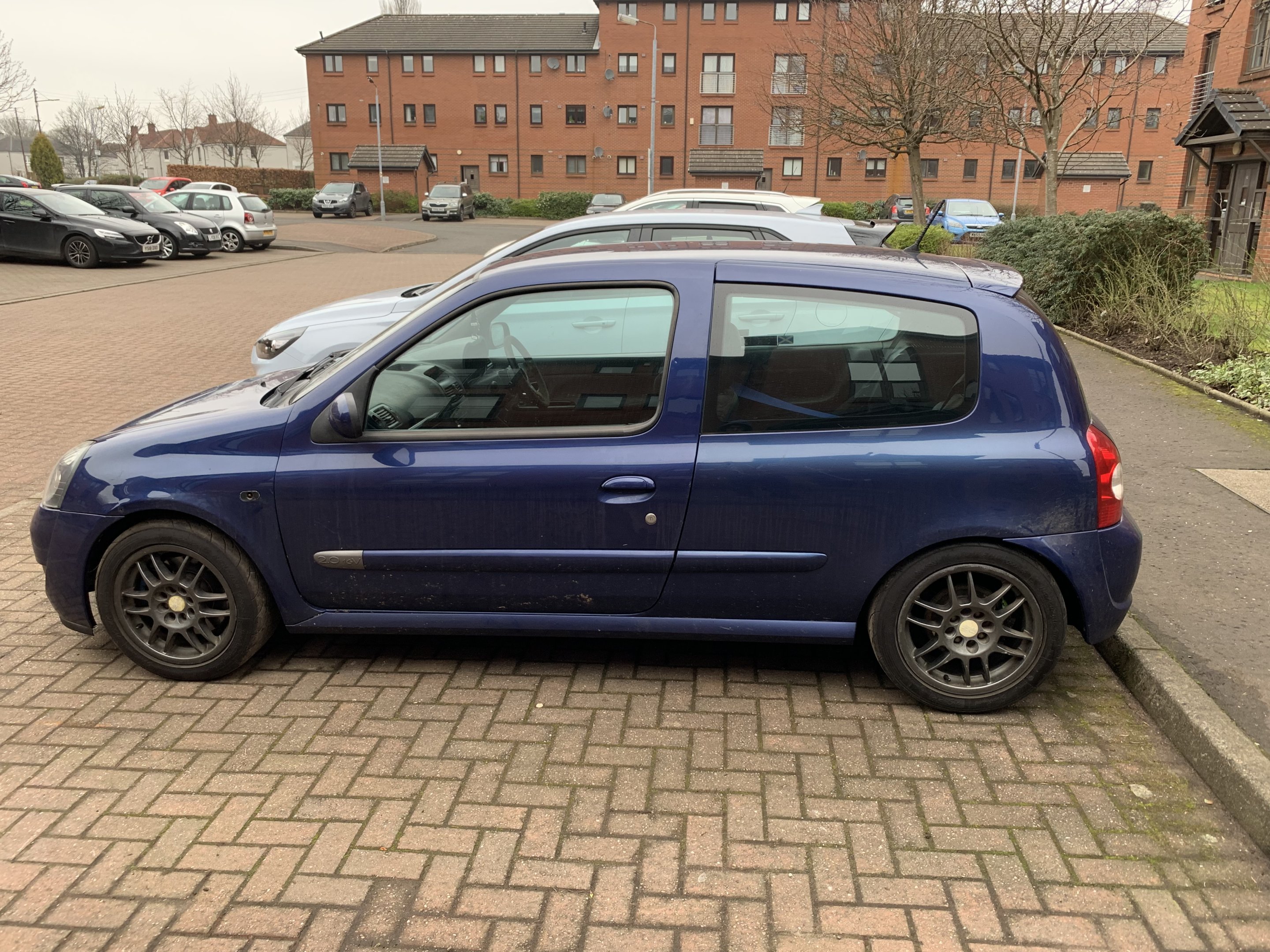

Now on 182 wheels with rain sport 3 on the front and ditchfinder's on the rear (will order 2 more rainsports as a wet setup)
Exhaust is badly needing replaced as its blowing at the centre section and back box now.
Ideally I'll have a set of 15's with some extreme VR2's before my first event with the car in April but now co-driving on the North West stages so that has taken a good chunk of my budget...

Wee update, bought a set of 15’s with worn out federal RSR’s, it was really just the wheels I was after.
Also bought a set of part worn Extreme VR2’s to try out before I get a full new set.
Then I bought a set of OZ F1 in 15” with Nankang NS2’s which will be no use to me for hillclimbing so May use them up on a track day or whatever. Got a screw in one right on the shoulder and was dreading taking it out but it was literally the shortest screw I’ve ever seen and only went in to the tread block! Lucky

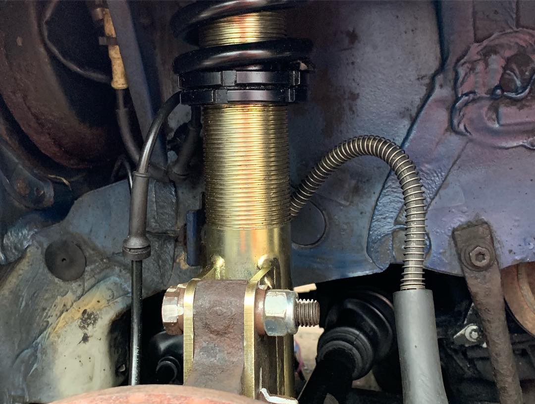

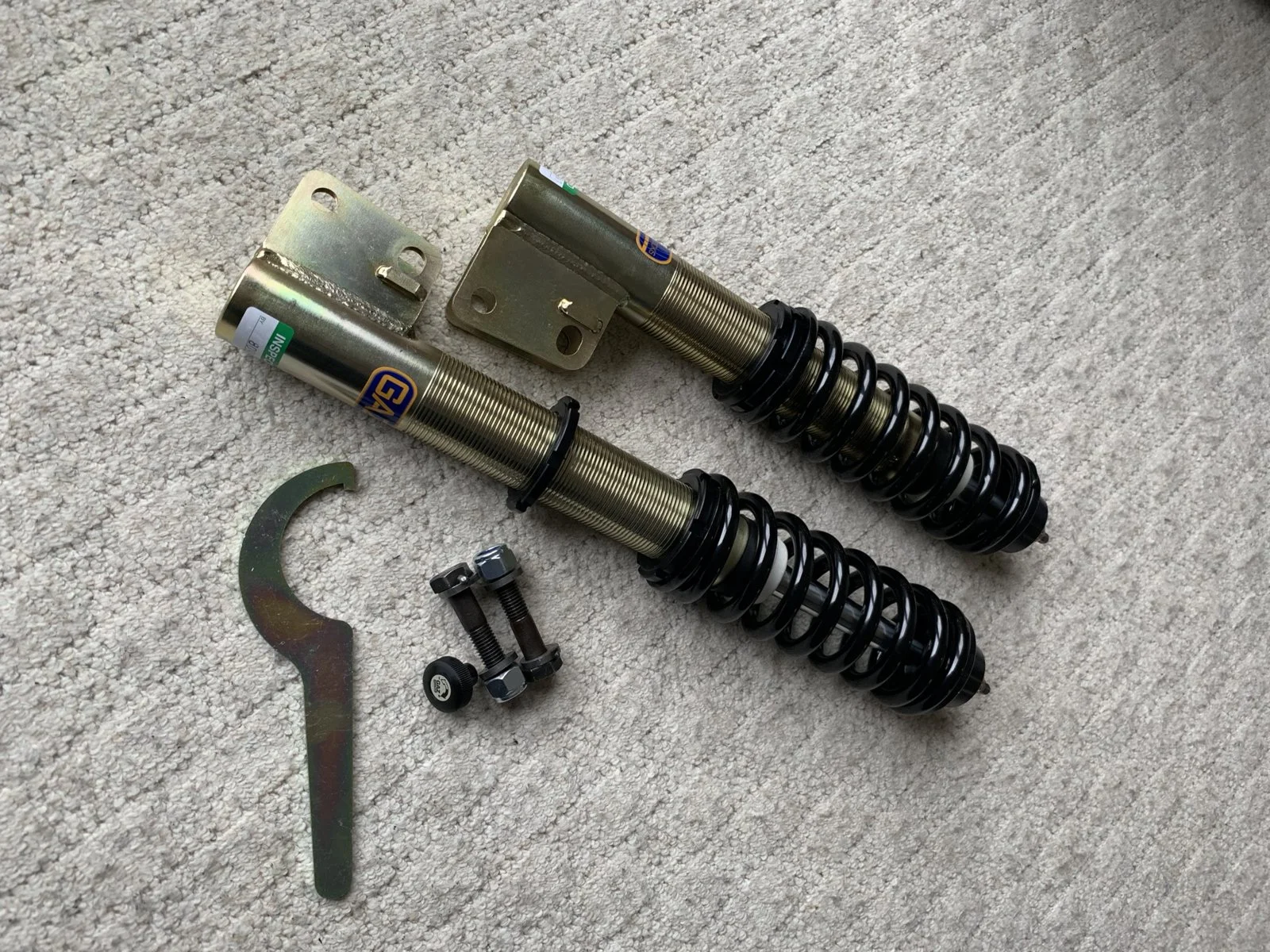

Also got some rear Gaz GHA coilovers and fitted those.
Stickers for tow point and ignition added to satisfy the Regs
Timing strut sorted out also.
Took it to an autosolo and managed to come 7th out of 25+ and managed a joint fastest test time on the day also! All that with a pretty nasty migraine! ?
Still looking for front Gaz GHA as I’m still on Eibach and standard struts! ?

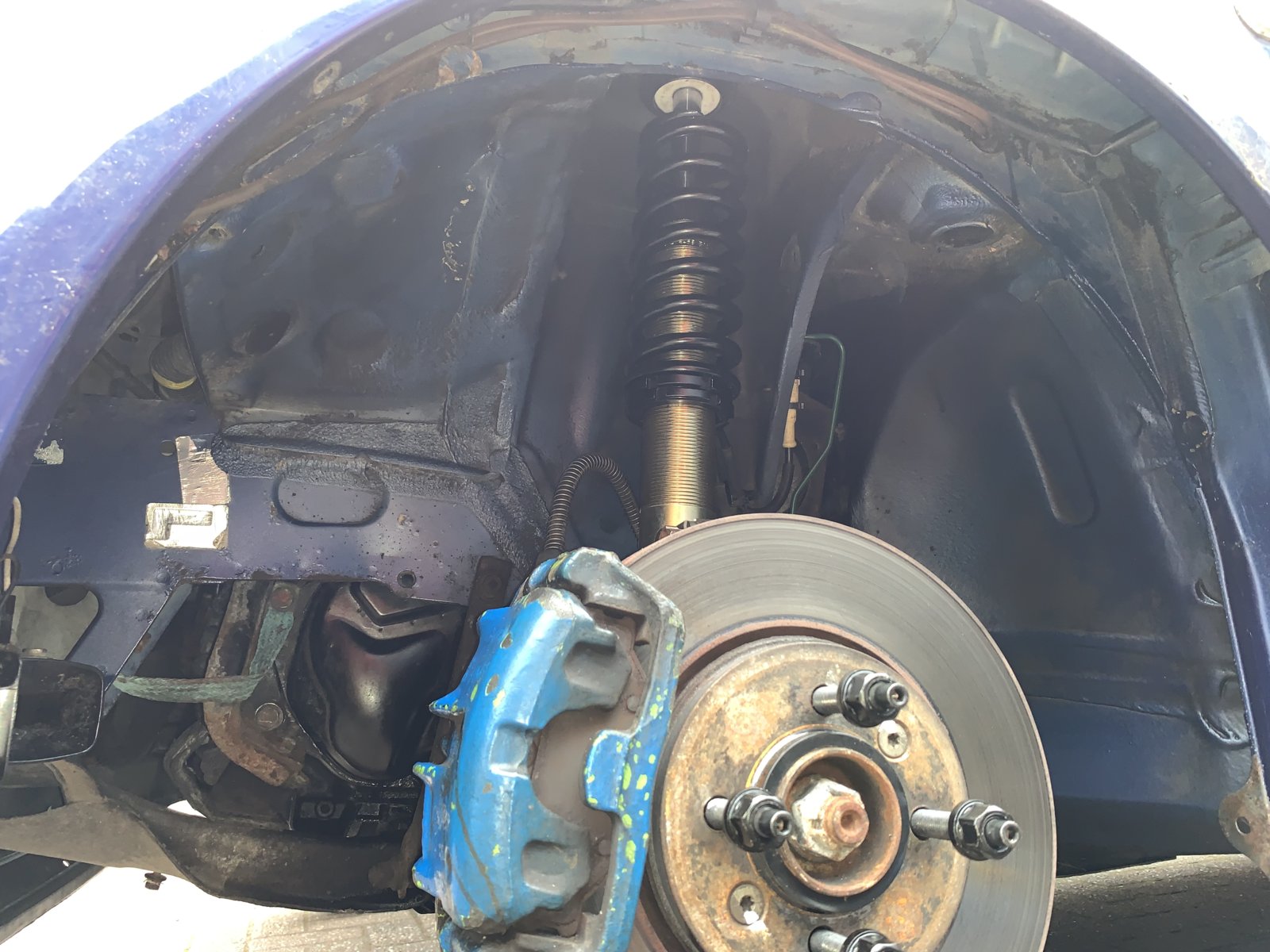

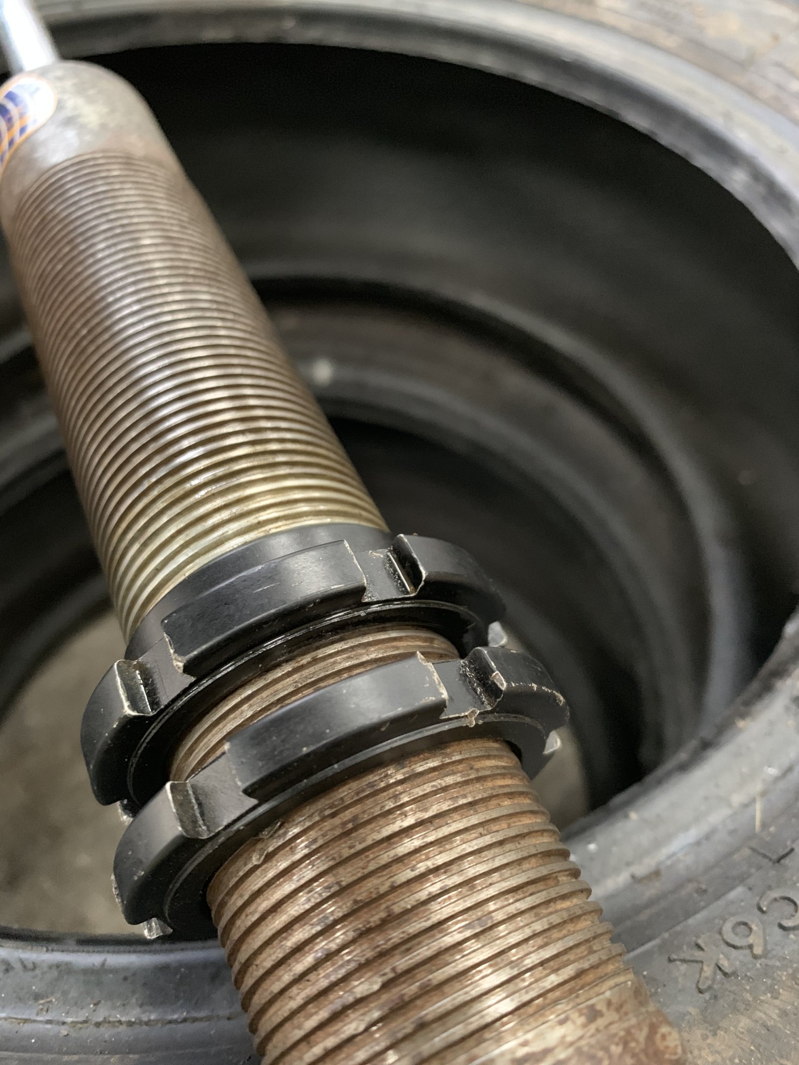

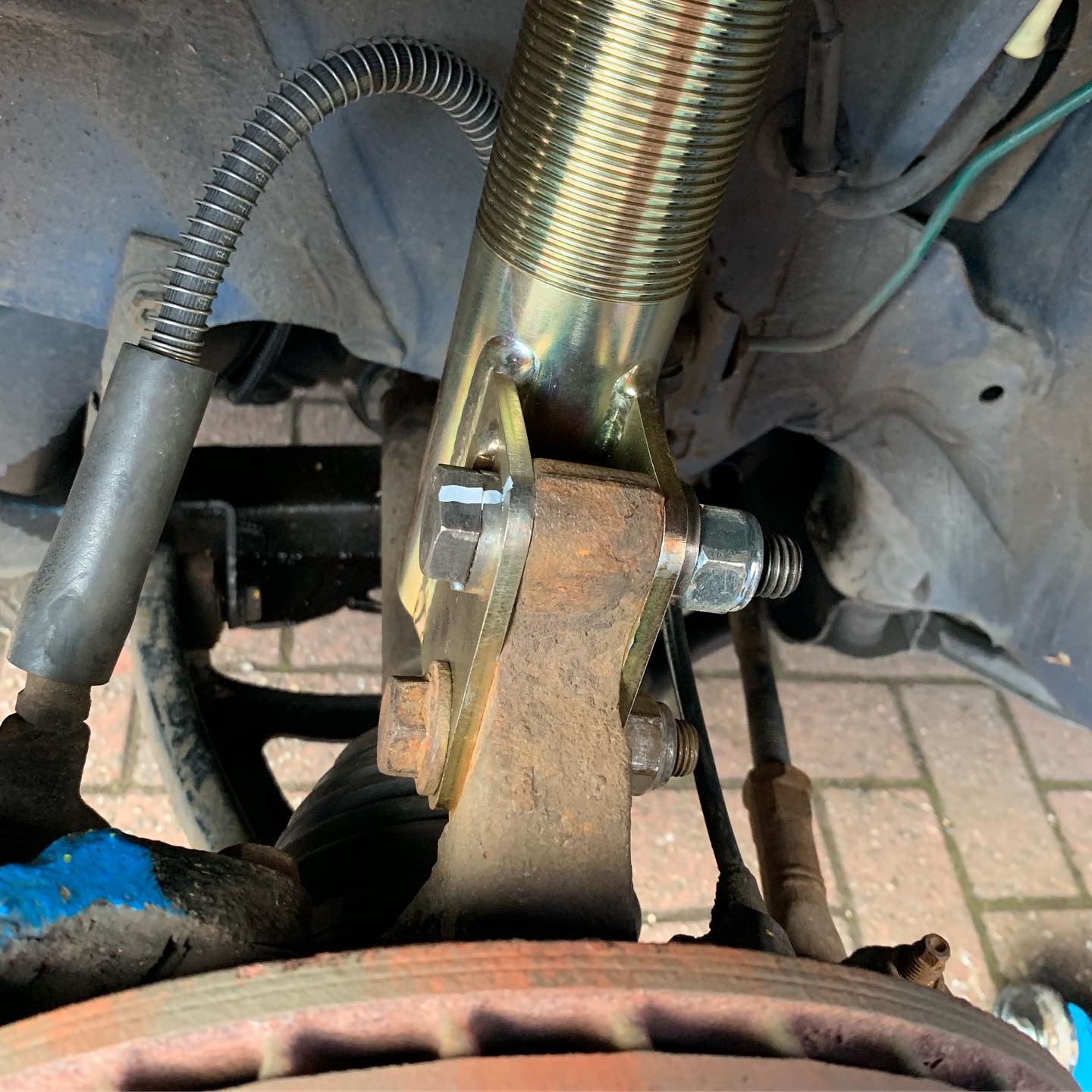

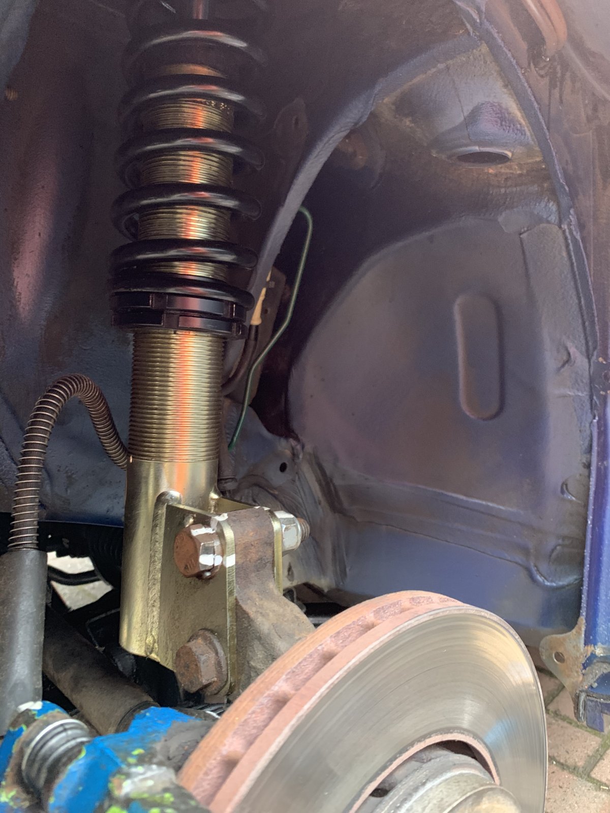

Some more progress on the old dog! Ordered some brand new GHA on 475lb springs for the front. Set up the camber and done a quick string alignment, going to revisit that today and double check all is as it should be. Got my extreme VR2’s fitted into my Traklite wheels. Got a stud and nut kit to fit today also. Just need to wrap my battery negative in Yellow tape and for my rear helper springs into the original spring location to satisfy the MUK Blue Book regulations so I’m hoping they arrive today.
Here’s a couple of pictures
Hillclimb at Doune next weekend so very much looking forward to that!

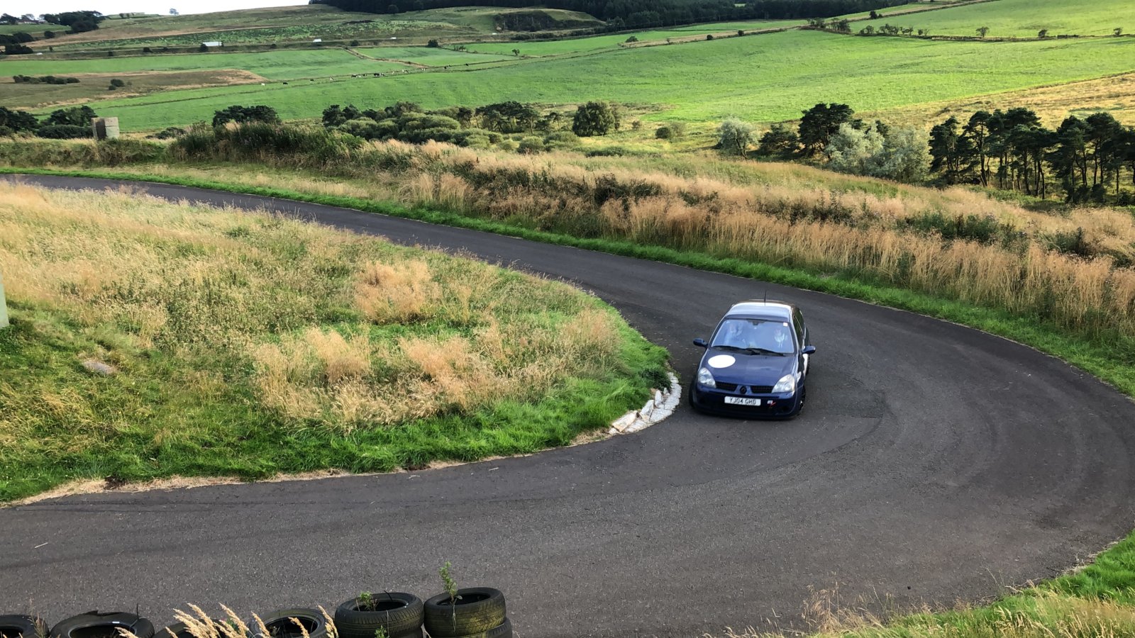

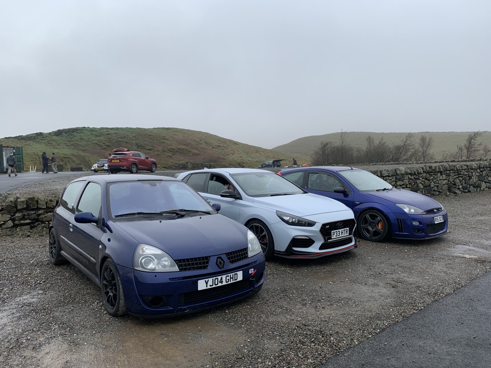

Small update on this, got a last minute slot to test on Sunday at Forrestburn Hillclimb on a track day. Final alignment was done on the Saturday and I was all set! Headed over to the venue on Sunday (40 mins from my house) and it was wet. Very wet. Perfect test for the Extreme VR2’s which for a predominantly slick tyre performed way above my expectations. The car ran well and I got a base wet setup that I think I can rely upon as fairly safe on wet events. I had a few wee moments caused by me pushing over the limits to learn how the VR2’s react but nothing too major.
Got the car home on Sunday and set about re-preparing it for this weekend as I am away at work all week. On the way home I felt a bit of front end wandering which was investigated on the re-prep and found to be a worn ball joint. Less than 1000 miles on it. These were replaced on Monday before work with some Lemforder ones. Just got the geo to check again as the wheel was off centre on the test drive after fitting so that’s friday mornings job.
My i30N as service vehicle! ? and my mates Mk1 RS.
Cleaned up after it’s test

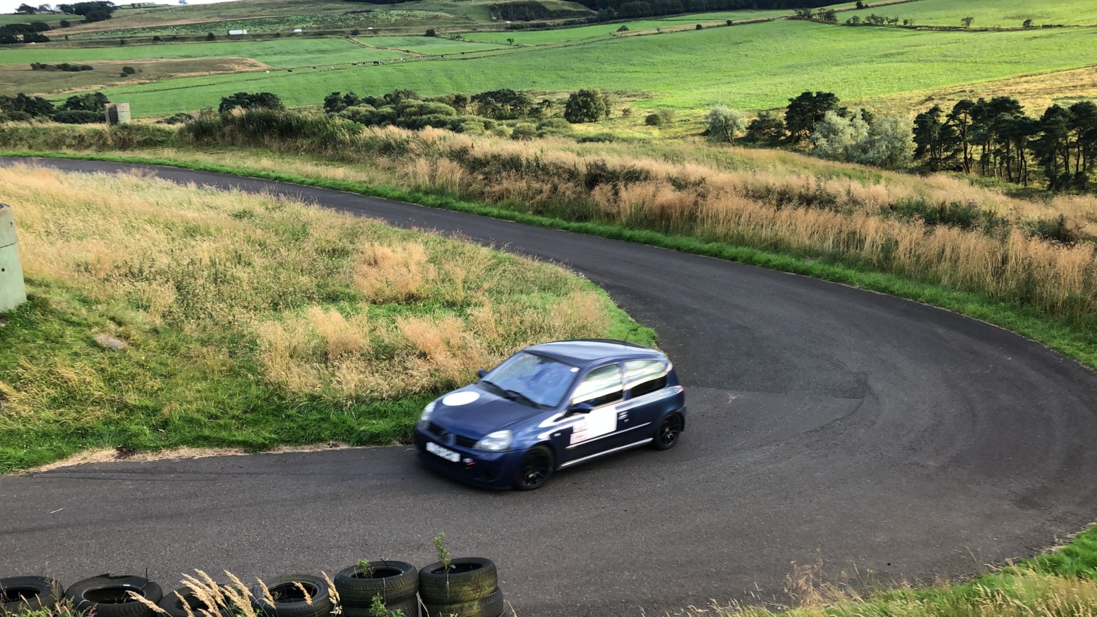

Post Doune Hillclimb update,

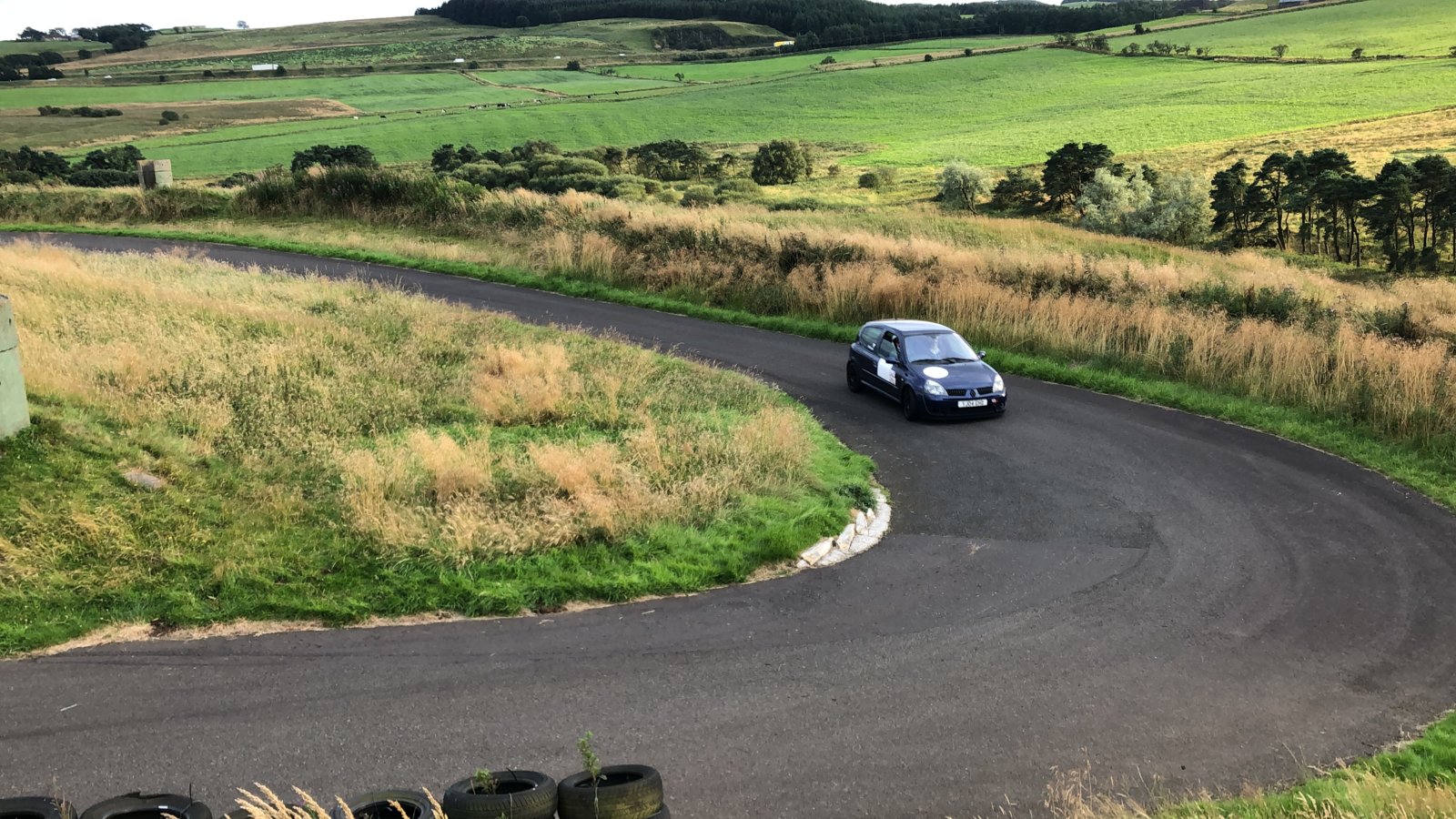

Having only driven the hill on one other event this was my second competitive visit to the venue. Saturday started off well with beating my previous PB by exactly a second with a 55.01. Albeit that time was set in a 1400 Metro GTi in full rally trim!
First competitive run on Saturday saw me across the line in 54.08 which I was absolutely delighted with! On further investigation the in car showed there was a lot of time lost being in the wrong place on the track.
Sunday came and first practice was all about putting the things I had learned from the in car to use and I toodled up the hill in a lowly 56.21 but more importantly I was in the right place on track more often than I had been on Saturday.
Second practice went well and I cracked the 53 second barrier with a time of 53.74!! ? Cue lots of shouting in the car as I was seriously happy with the time!
First timed run saw my fastest time of the entire weekend with a 53.51and my second timed run being a 53.59! Again absolutely delighted!

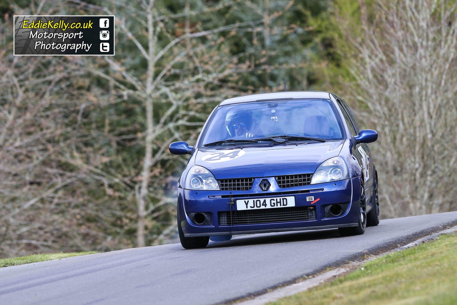

Bit of an update as I have since done 2 events in the car!
June Doune hillclimb,
New Extreme VR2 R5 tyres fitted, heavy passenger seat and airbag removed and replaced with another Sparco Evo. Cup alternator setup fitted and an EPAS column and controller fitted also. Two days hillclimbing with 4 practice on the Saturday and 2 timed on the Sunday. The car was being double driven with a friend which when the alternator decided to pack in on the first run wasn't ideal...
Charging the car from my road car between runs was very frustrating. However, we had a very varied day with rain coming and going. Best practice time of 53.87 was achieved which was only 2 tenths or so slower than my previous run done in the bone dry!
Sunday meant timed runs of which there was 2 of, firstly I managed a 53.02, a full half second quicker than my PB with which I was obviously delighted! Second timed run I managed to do a 52.49!! Chopping that amount of time off means I can probably get down there or below again should the conditions on the day be good. This was enough to put me 3rd in class against some very quick drivers and cars. 1st in class was a Lotus 2Eleven and 2nd was a Subaru Impreza!! Due to it being a british championship round this meant that all roadgoing cars complying with S11 were in the same class and i managed to get 3rd Fastest Time of the Day which I was obviously over the moon with.
June Forrestburn Hillclimb
Another hillclimb at a venue I had tested at before. Although this time completely dry... Total re-learn of the hill was required and off I went.
Fastest time on Saturdays timed runs - 52.20
Just could not replicate this on the Sunday with a time of 52.37 fighting hard with the class leader who managed a 51.77 in a seriously well specced 182.
