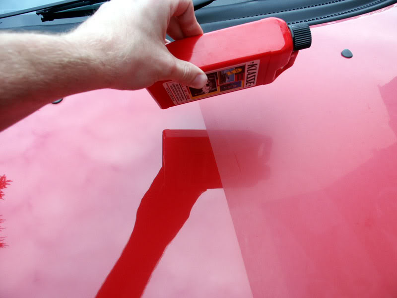

I did a back to back test of AIO and AG SRP on an oxidised bonnet.
The Klasse gets the job done alot quicker.
Interesting, shows klasse is a much stronger paint cleaner!
