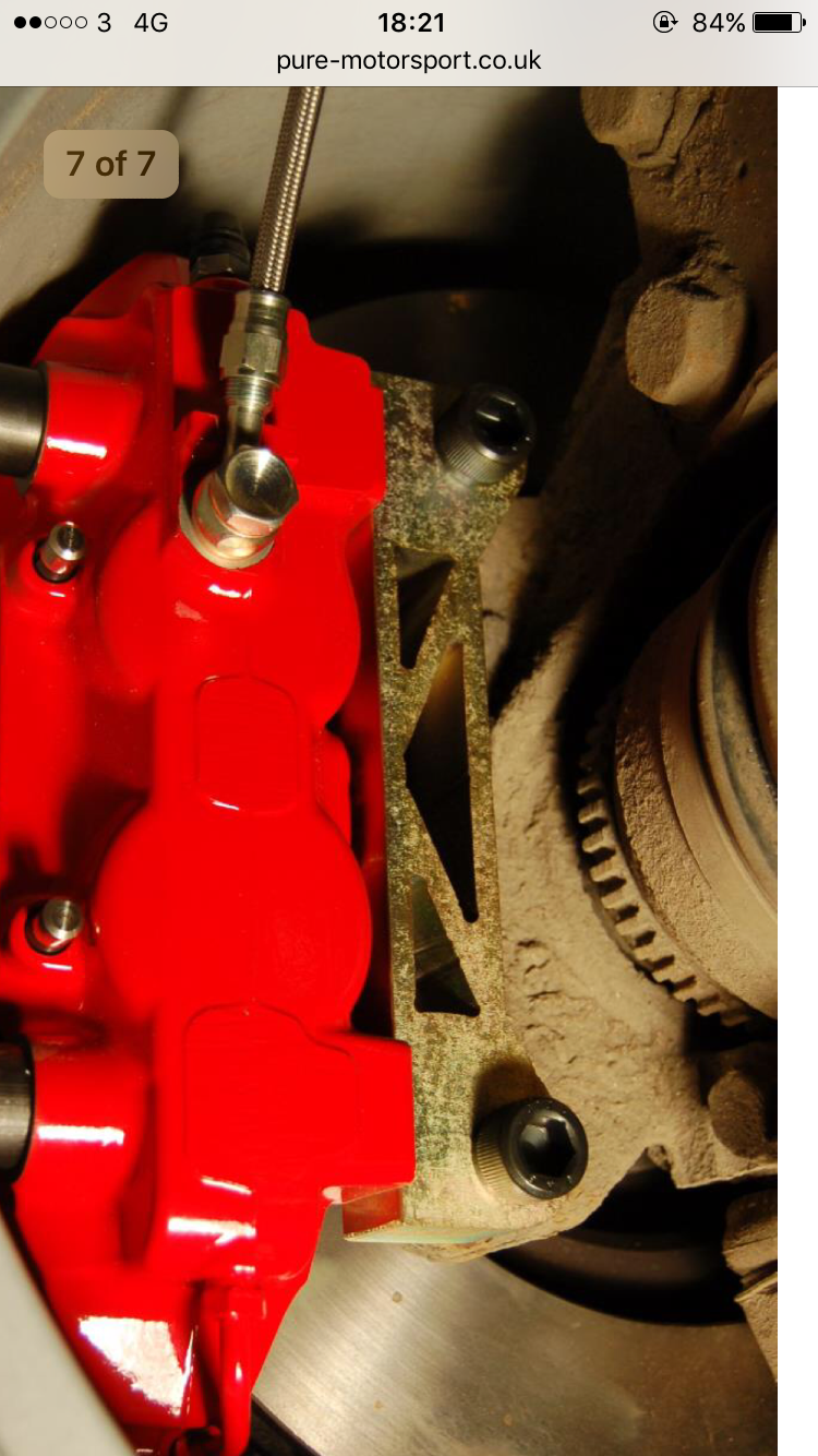

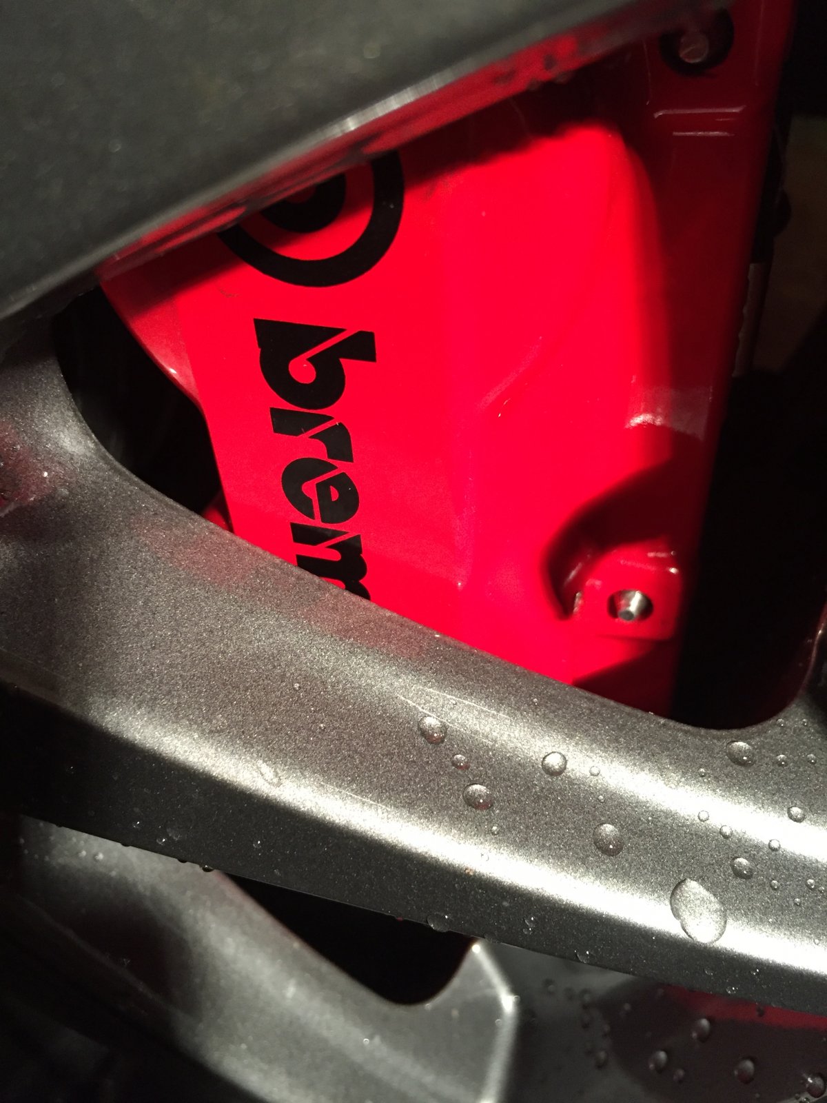

Also another thing which I would do If i could go back is to spray the bolt head of the caliper securing bolts. Although they are coated in some sort of black coating they do rust quite quickly. They are hex cap bolts so can easily spray just the head. let me get you a pic so you can see for yourself.

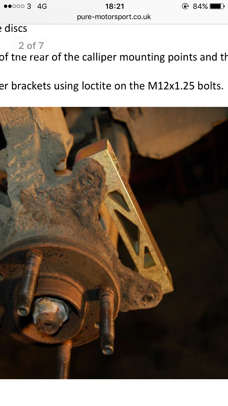

Thanks mate. Just fitting them now, do the washers go on each side of the brackets?
No worries mate. :up:

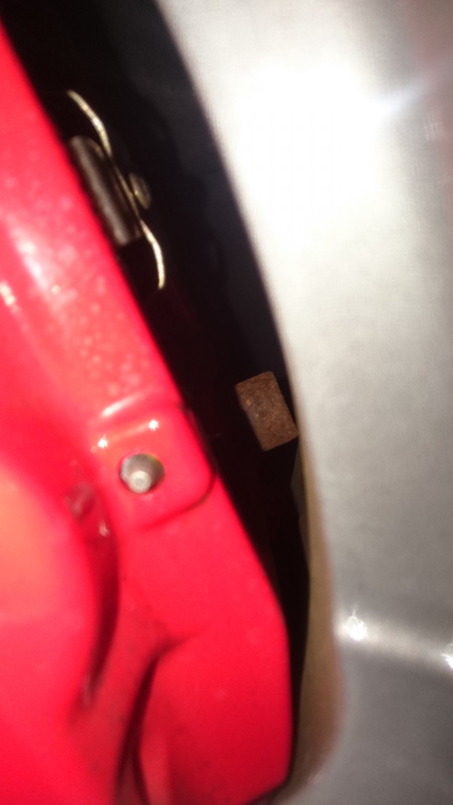

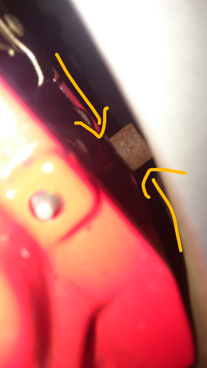

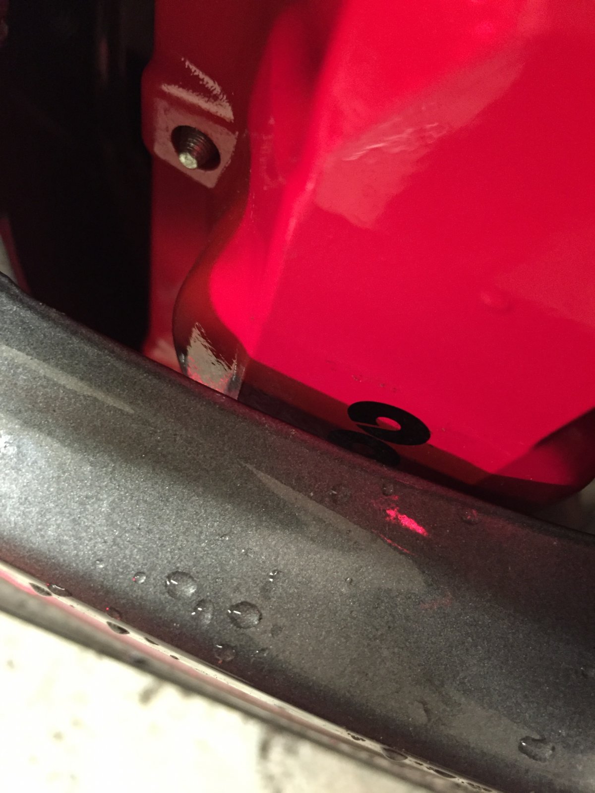

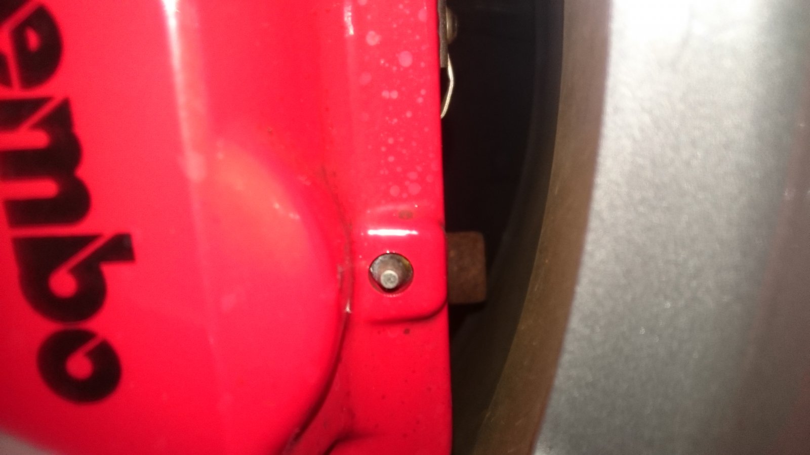

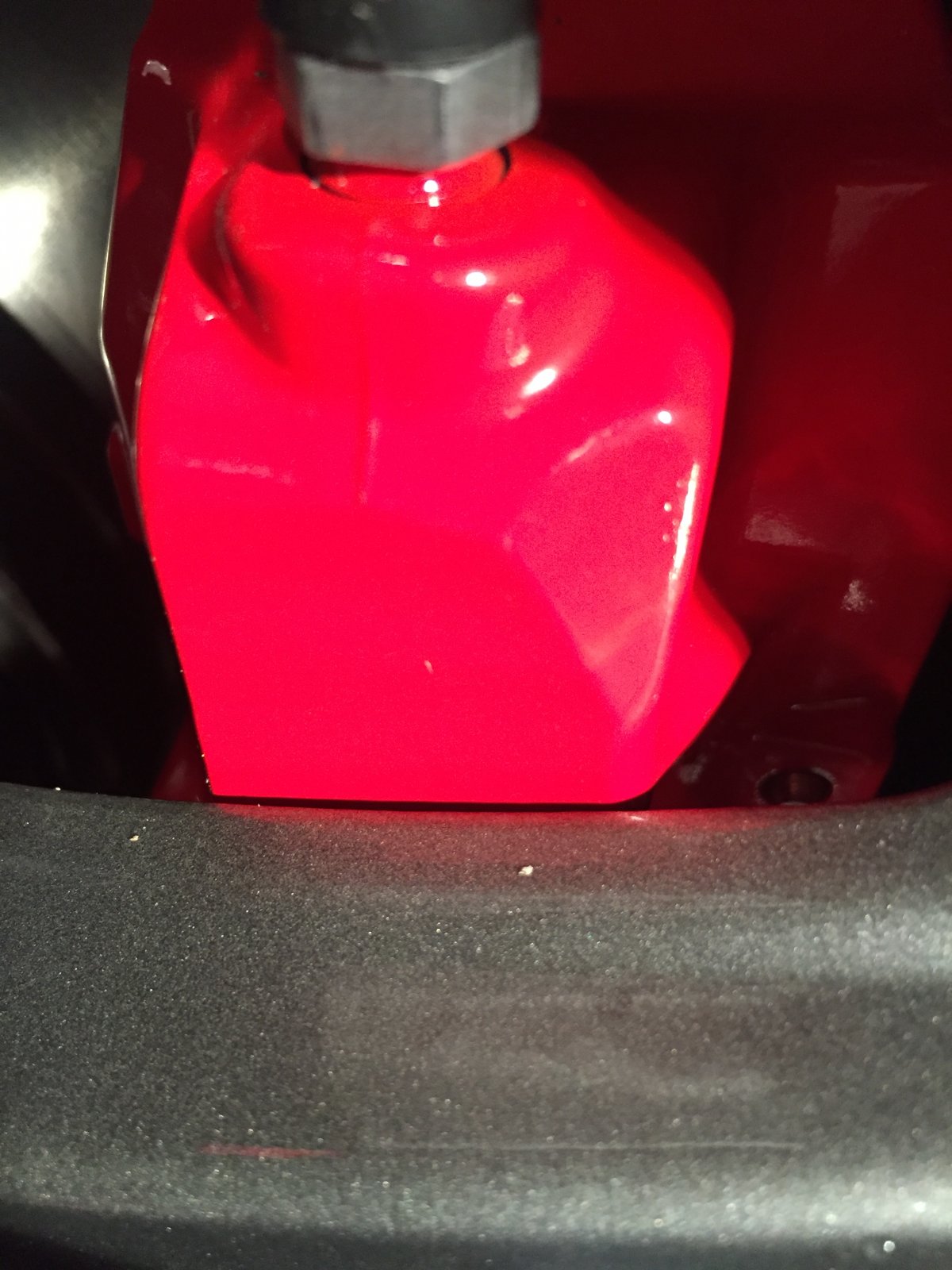

I'm having real trouble with my O/S front wheel. It won't give the same clearance as the N/S one and it's touching the face of the caliper when it's screwed in and the wheel won't turn. The N/S one is fine with about 1mm clearance. They are both fitted the same with the washers in the same place etc. so I'm a little bit stumped. Have you got any ideas or did anyone else have a similar problem?
The last photo is the N/S which has some clearance and isn't catching. I need a quick fix because it's using space we don't have in my mates unit!
As above.
Its probably down to the manufactured tolerances rather than something you've done if its only 1mm difference.
