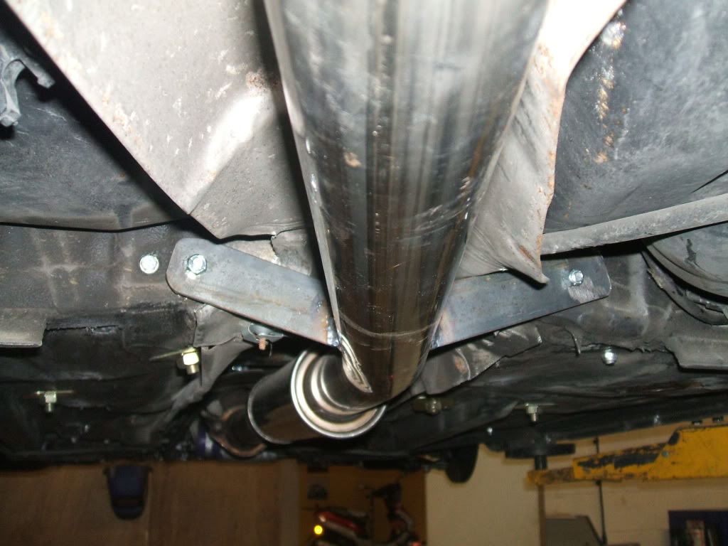

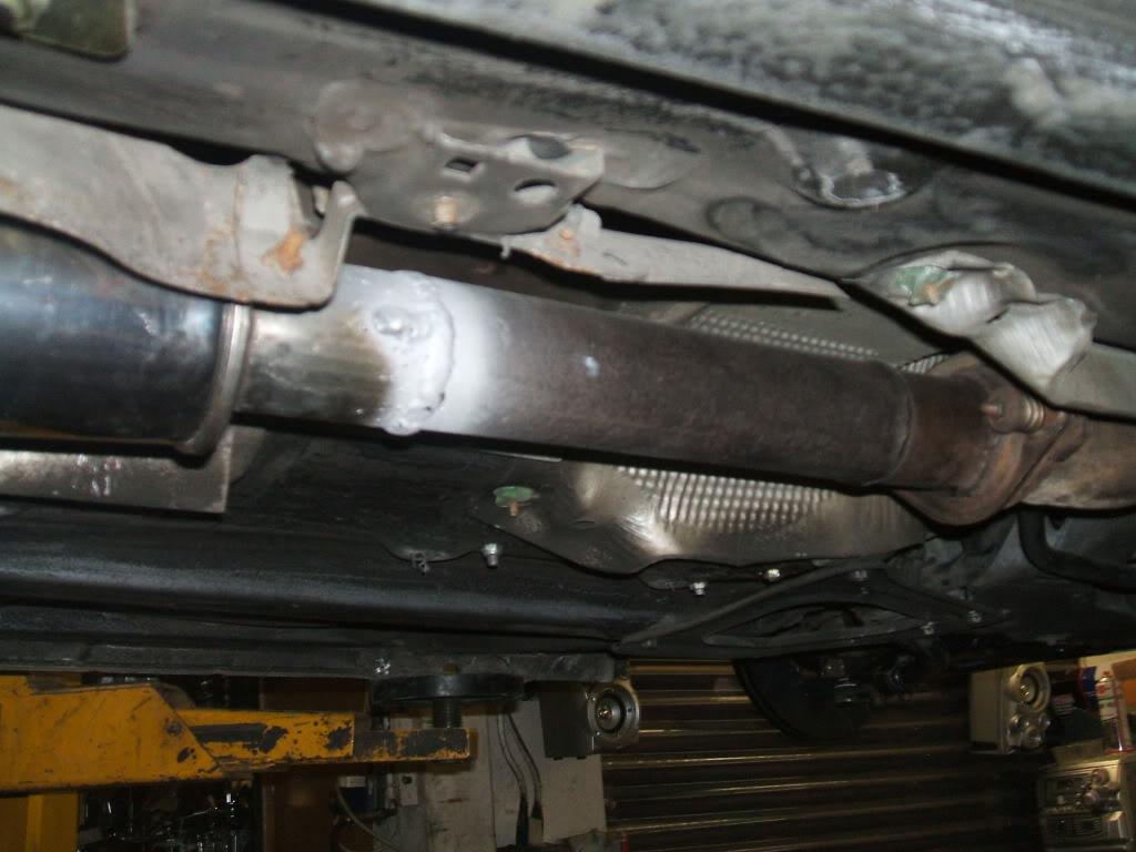

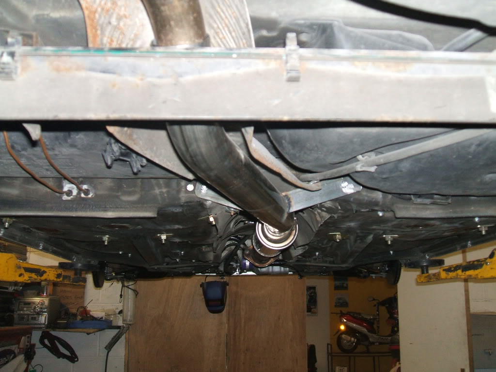

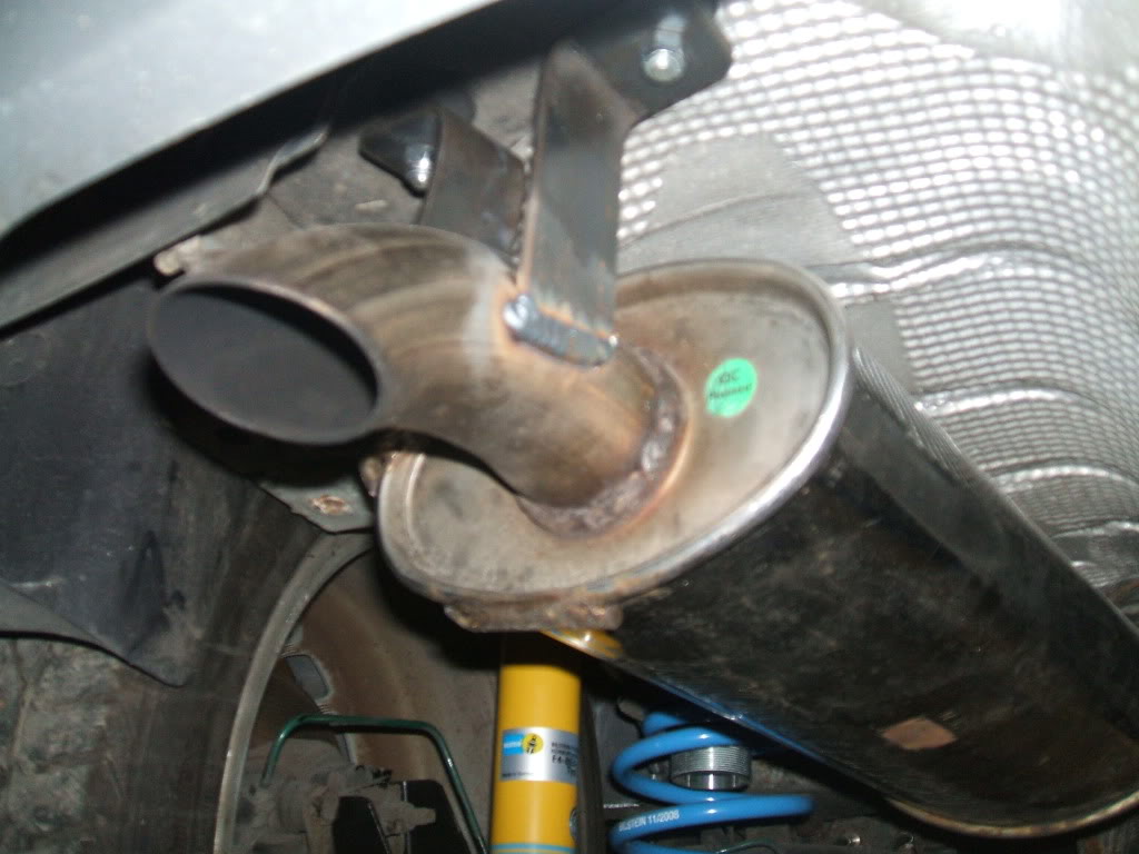

Firstly I spent a day under the car and fitted the exhaust, and adjusted it to fit the 182 manifold. We also removed the crap Renault exhaust mounts and came up with something a little sturdier!

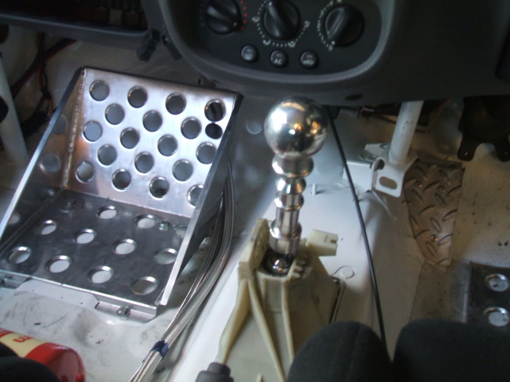

Whilst the exhaust was off, I fitted the quickshift:
Looks a bit Max Power, but the feel is loads better than the worn out standard part.

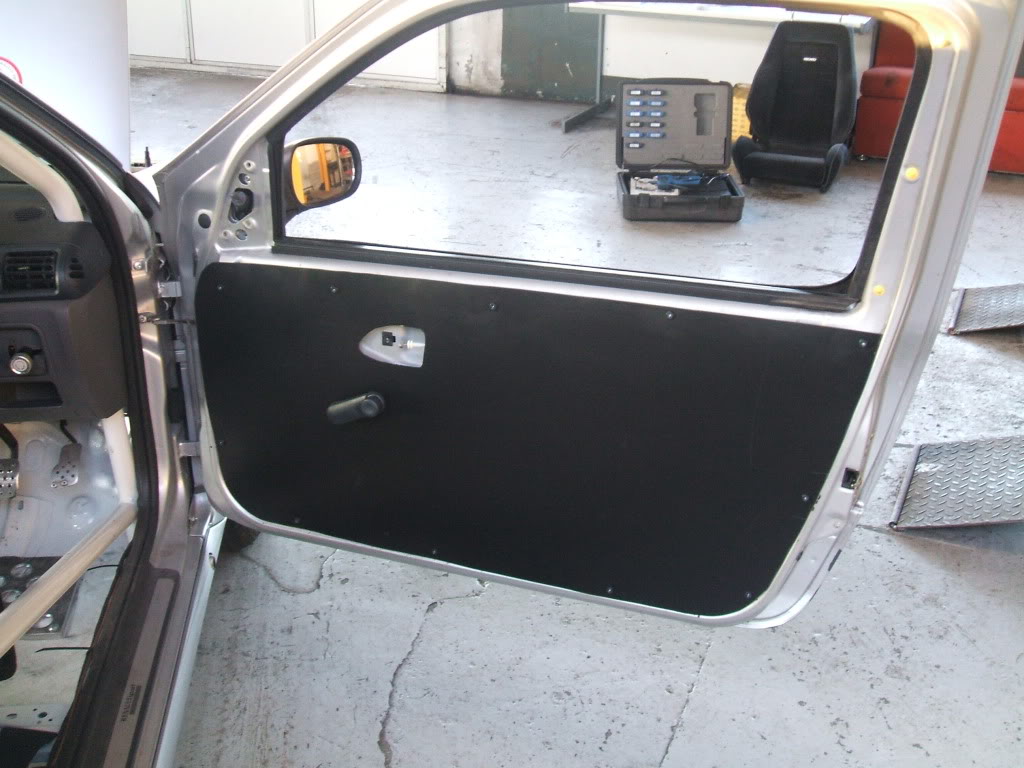

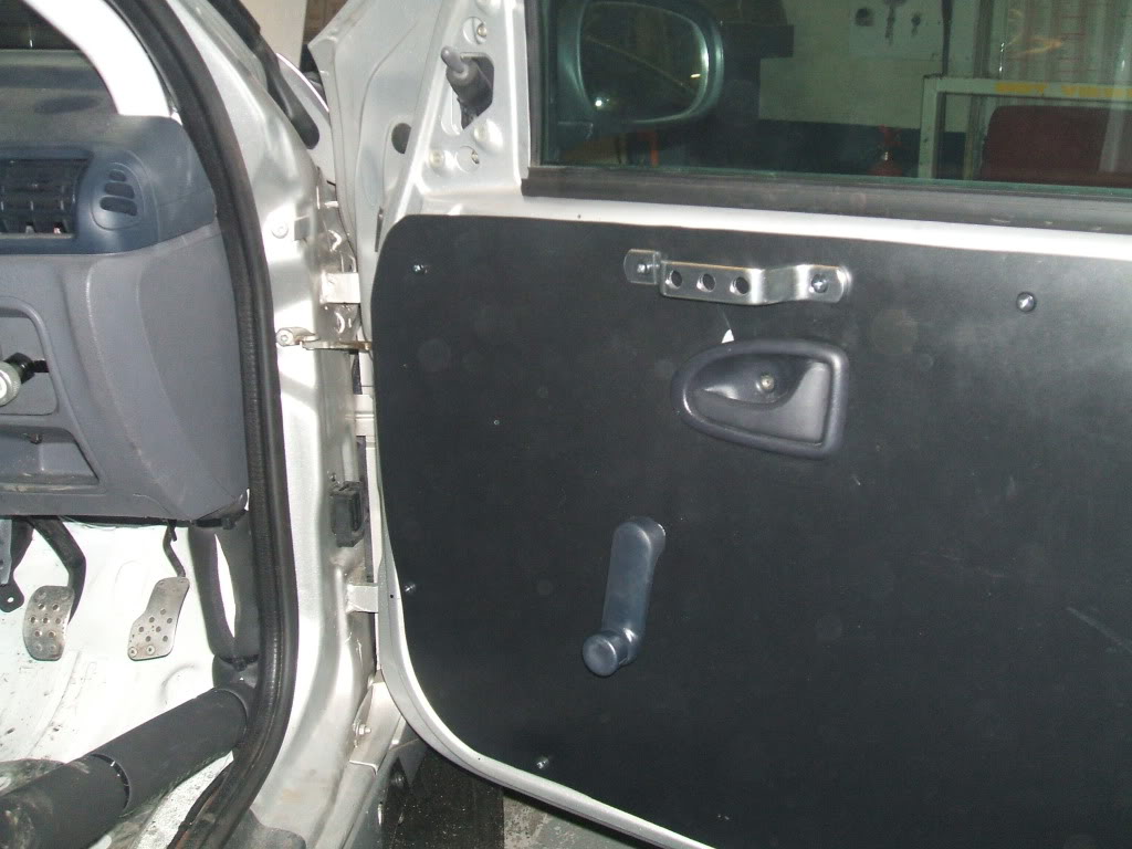

Also finished off the door cards and fitted them:

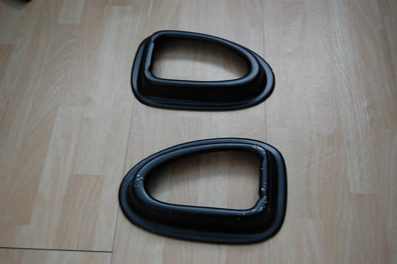

Got some Clio Cup door handle spacers on order from Renault Sport, but they are taking ages to come through. :(

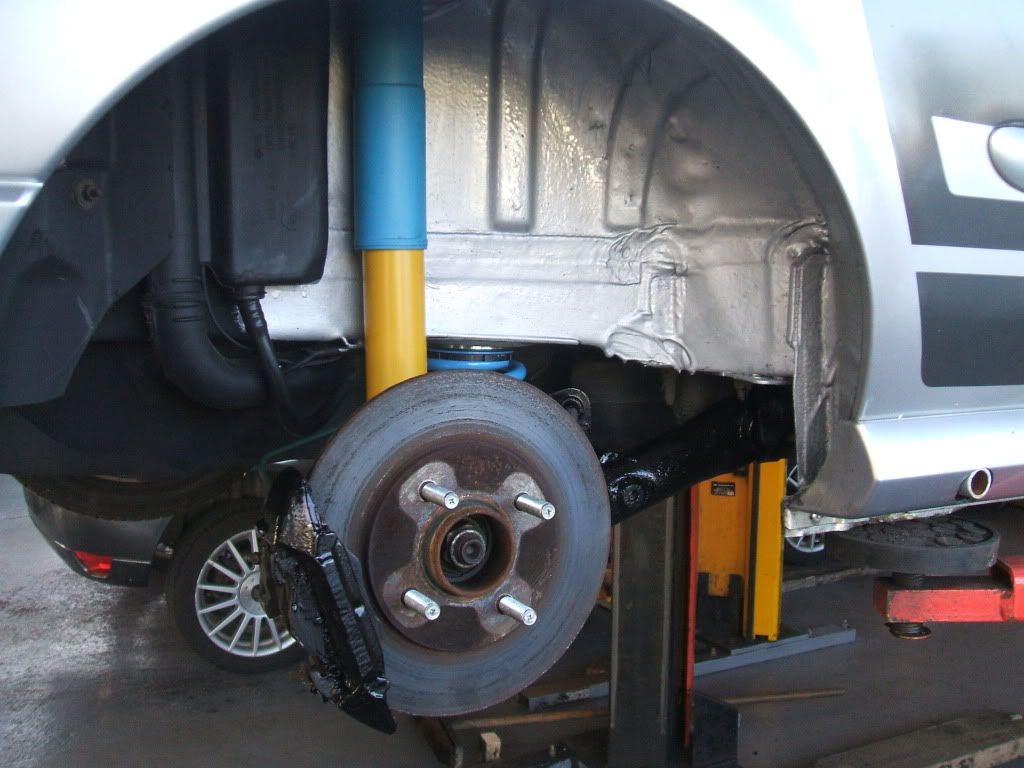

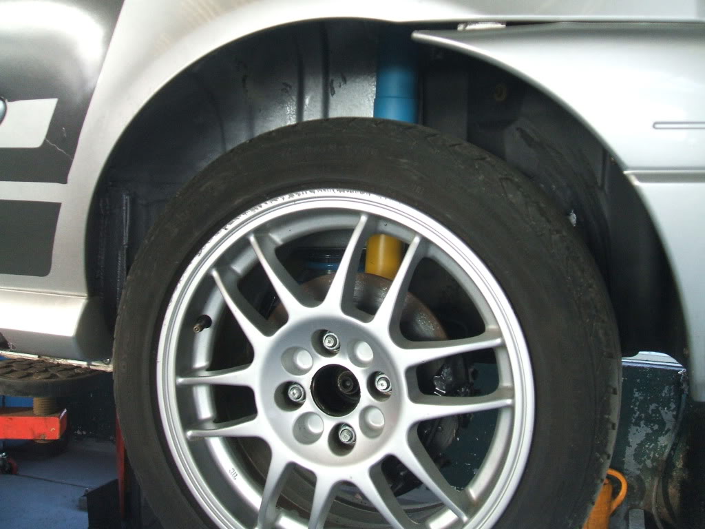

I then turned my attention to the rear suspension, and removed the Bilsteins to paint the wheel arches and rear beams, then refitted along with a stud conversion kit. Need new rear pads though, and keep forgetting to order some!

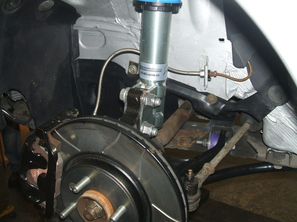

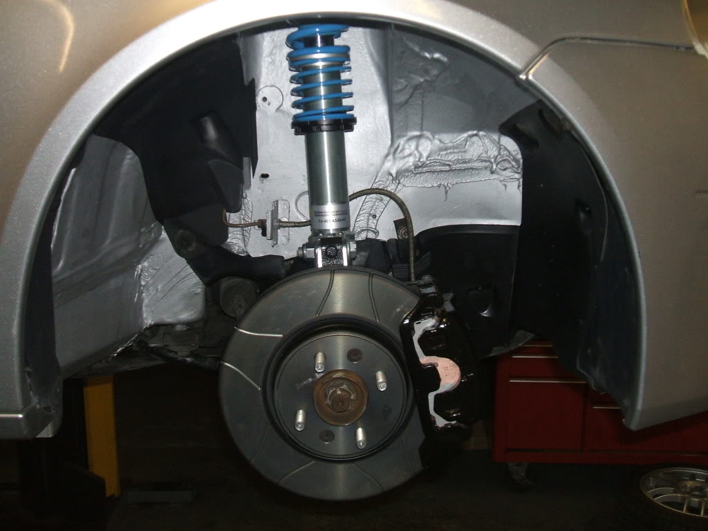

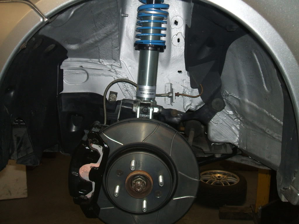

And then onto the fronts. Stripped the whole lot down, and fitted Brembo Sport Max discs, Carbon Lorraine Pads, refurbed lower wishbones with Polybushes and Gp N ball joints, Stud conversion, Billies, K-tec solid top mounts and painted the arches and hub carrier for good measure! Spent LOADS more than I should have, but it all looks shiney! ;)

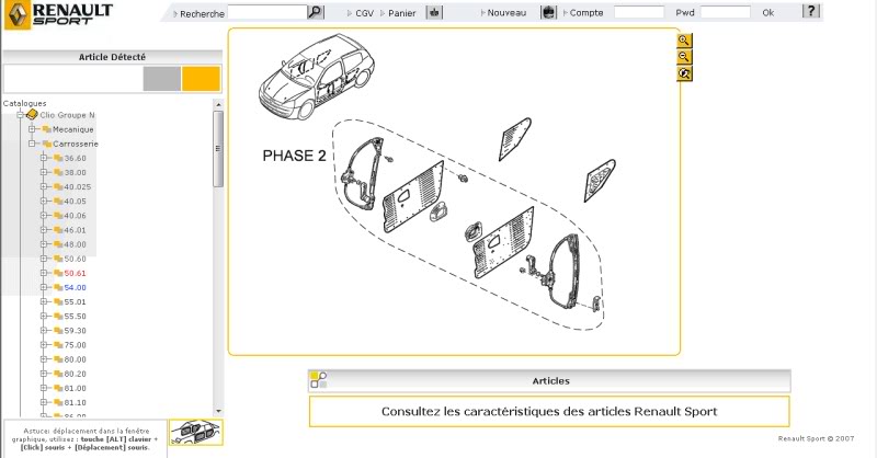

Top work! Out of interest how much where the internal door handle spacers, there something I need to order.
Those "solid" exhaust mounts look interesting... The exhaust is meant to move with the engine and will ultimately expand and contract slightly with the heat?!
Looks pretty solid there :S

The cup racer door handle surrounds are 55 quid delivered for the pair from R sport. It's depressing knowing that they probably cost about 5 quid to make :( Think mine took around 3 weeks to arrive, R sport have to order them from France iirc.
That's why we had to have a little think with ours,first of all I did a solid 'L' bracket just to get it all in place then stood back and thought "that's going to expand",so now have re jigged it with a rod for it to slide back and forth,hope it works should be some pic's on the build site if its been updated.

that much...hell, anyone got any pics of what they look like? surely they can be made easy enough
  340i
FYI....
part no's for the door spacers
7711156255
7711156256
Can these parts only be ordered from R.sport, not a "normal" dealer?
  #174
Part numbers are 7711153103 and 7711153104 and can only be bought from R sport. I'll get some pics of mine up.

The exhaust is still bolted to the car using rubber "cotton reels" so that it will move and expand ok hopefully. Used a similar mounting method on my old XR2, and that worked ok. Not sure if they came out in the photos.
I actually ordered the spacers from the S1600 rally car rather than the cup ones as they were cheaper, but apparently exactly the same. Those are the part numbers Gray has listed. The Cup racer ones are 7711153103 & 7711153104. I've ordered them from a normal Renault dealer as the part numbers came up on their system, but they are on back order. I guess if Renaultsport don't have them in stock in Dieppe, then they are unlikely to make more. I have my fingers crossed! Barron and Bazzon have them in their track car:

Ffs don't say I've paid more than I should of! I actually wanted to cry when they arrived, I thought they were 45 delivered (which was bad enough) til I looked at the invoice!

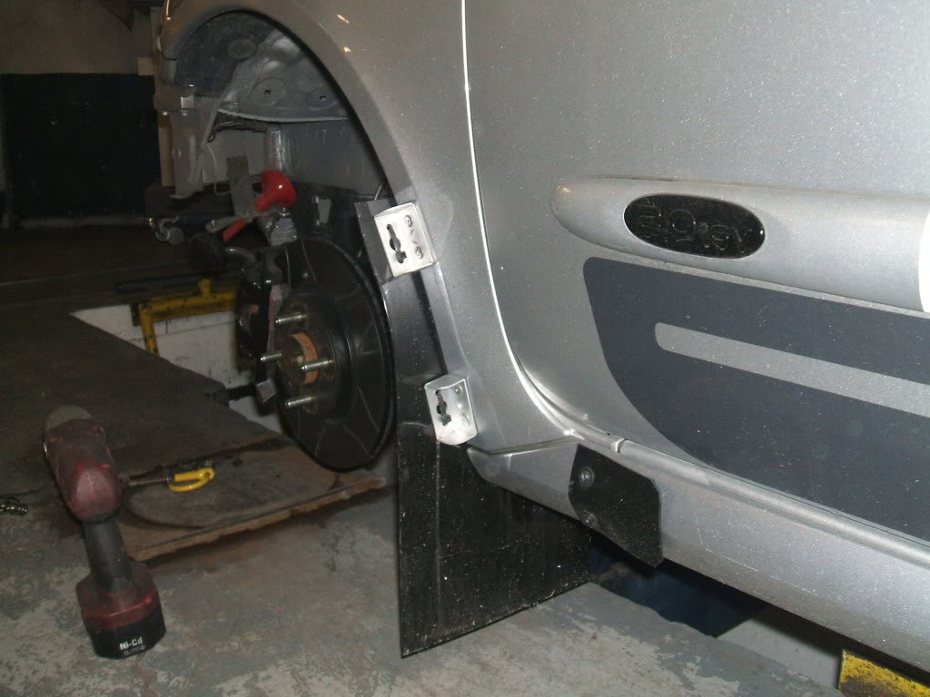

Made and fitted the mudflaps for the front and rear, and also the sill stand covers. These stop them filling up with mud and crap whilst driving.
I also fitted the interior door handles, using the Burp method of beeting the door in so that they fit flush. Unfortunately the Renault Sport spacers are no longer available apparently. :( I also fitted a pair of interior grab handles won from eBay, which look smart!

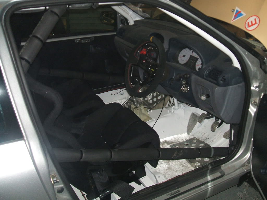

I have also finished off the roll cage padding, which took an age to look right!

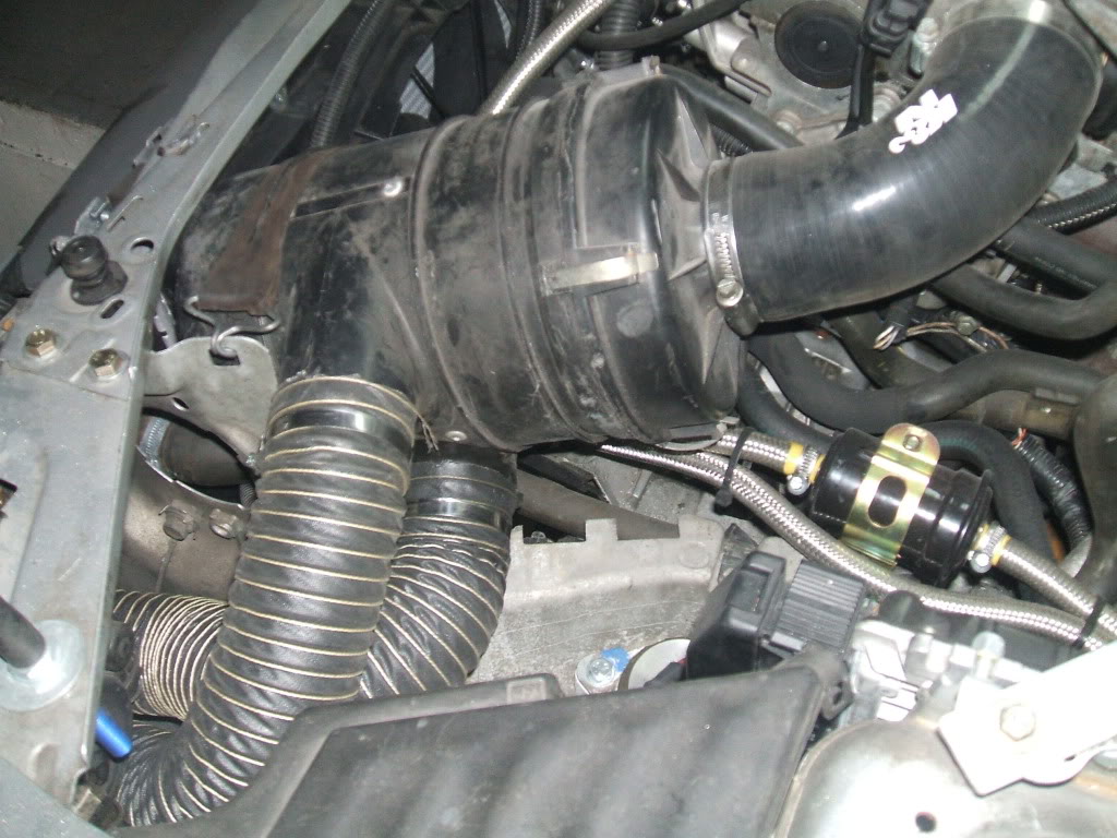

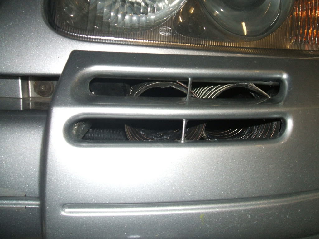

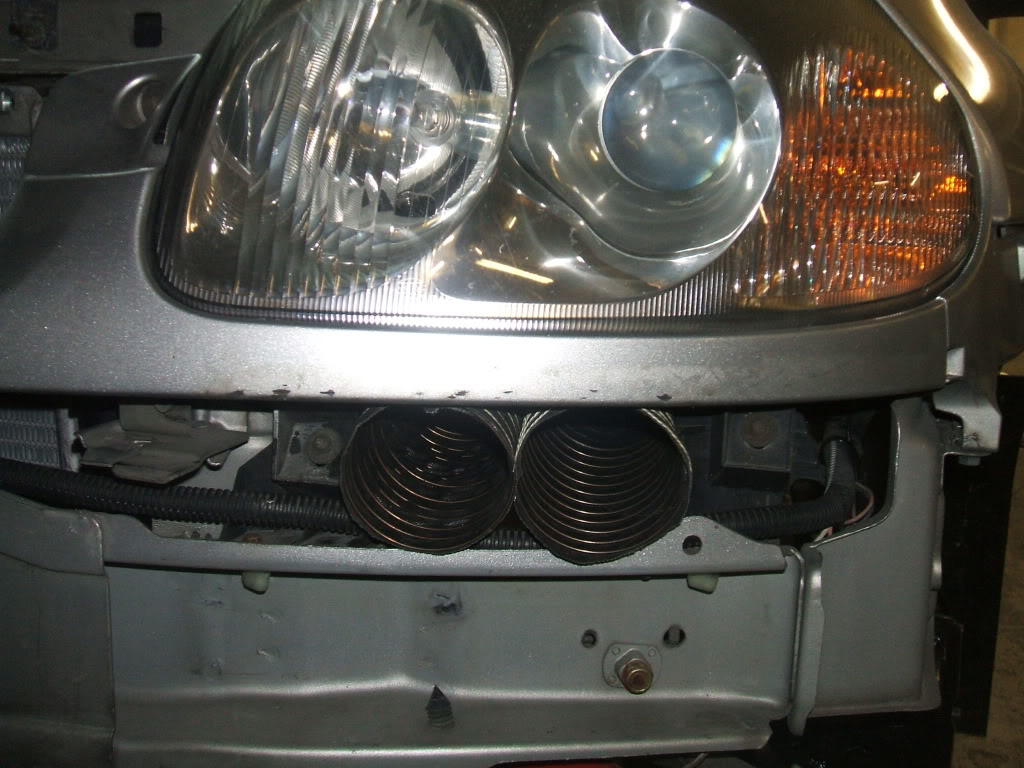

Then last night, I removed the front bumper and nearside headlight. A quick modification of the headlamp bracket made enough room for the cold air feed pipes to the standard airbox. I know it's the norm to feed this from the fog light holes, but I wanted to use these for the brake duct feeds. Instead the air box is fed from the grille below the bumper.

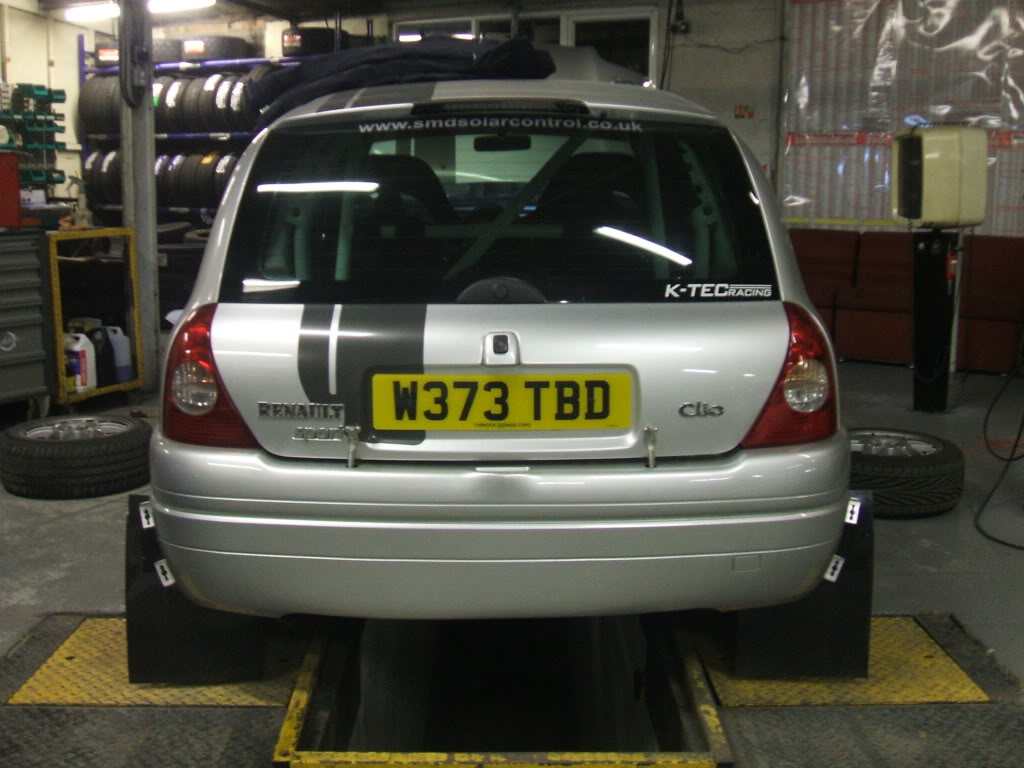

I've also sourced my tyres for the event, Kumho C03 moulded slicks. :cool: I've started fitting these to the rims, but forgot to take photos, so you'll have to make do with this for now:
Also with the no photos yet excuse are the front fog light blanks. As mentioned above, at a later date I will be fitting brake ducts to these.

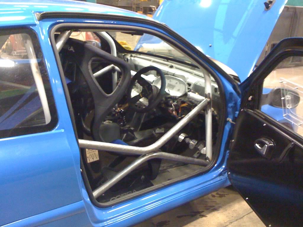

Looking really good mate, bet you cant wait to compete in it! I have a question about the dash top too, how did you manage to get it to fit with just the 2 small slots around the cage, looks really neat, i'm struggling with mine, have had to cut the corner right out to get it in around the cage.

I cut the dash top in half through the middle of the centre screw hole, as neatly as I could. I then cut the shapes out for the roll bars using a 50mm hole cutter and a jigsaw, then the dash top fits in in 2 halves with a bit of messing about. You can see that the dash is in 2 pieces in this shot, which is the best I've got at the moment:
