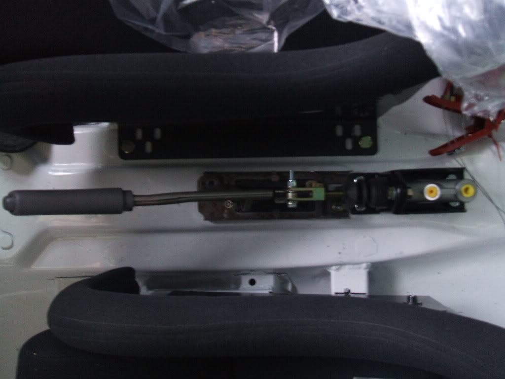

Got started by refitting the handbrake, making the cable look like it was doing something, to satisfy MOT testers and scrutineers. Then I fitted the hydraulic handbrake kit behind the original:

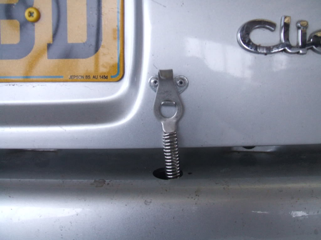

Then fitted the tailgate springs. Needed to remove the rear bumper to do this, but pleased with the neat result!:

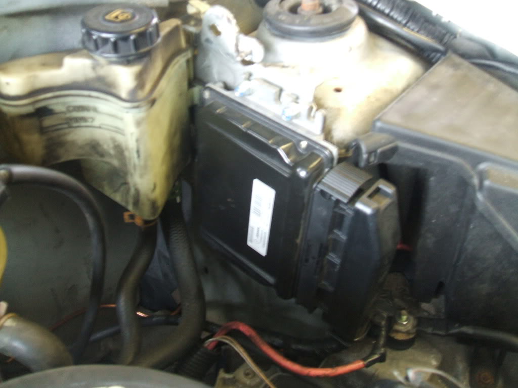

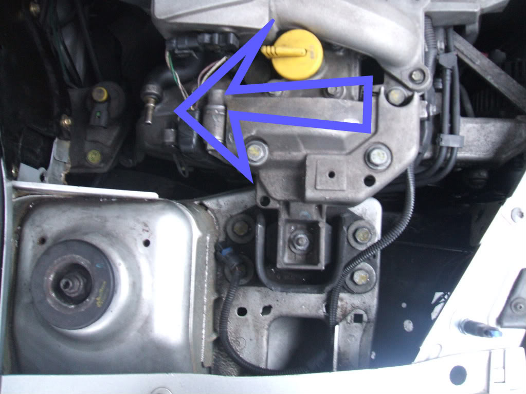

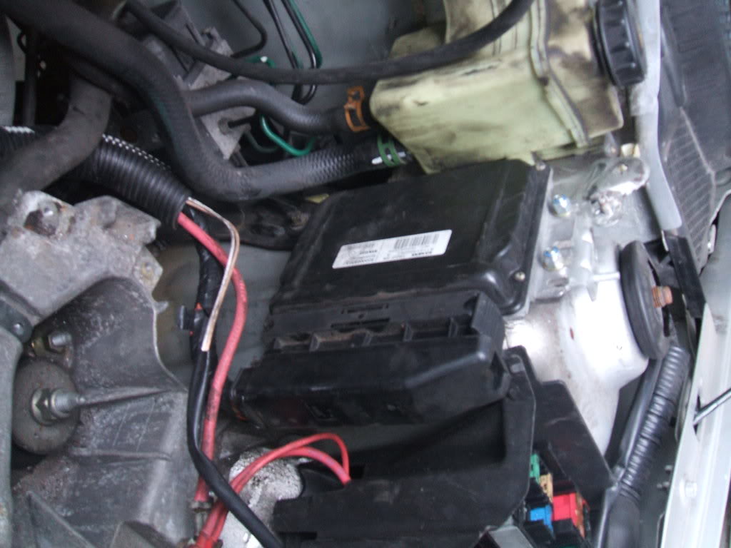

Next task was to remove the air box (will be refitted), battery (going in the boot), ECU anti-theft shield and bracket (in the bin), ABS wiring (for sale soon), and then remount the ECU on the inner wing.

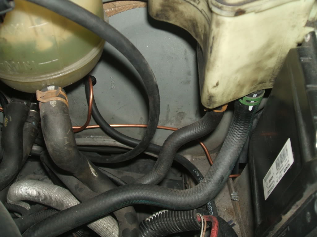

Also removed the carbon canister. For those that have done the same, what do you do with this pipe? Blank it off, or leave it to vent? I think its a breather from the rocker cover?
The pipe from the tank, I have cut short, letting it vent near the tank.

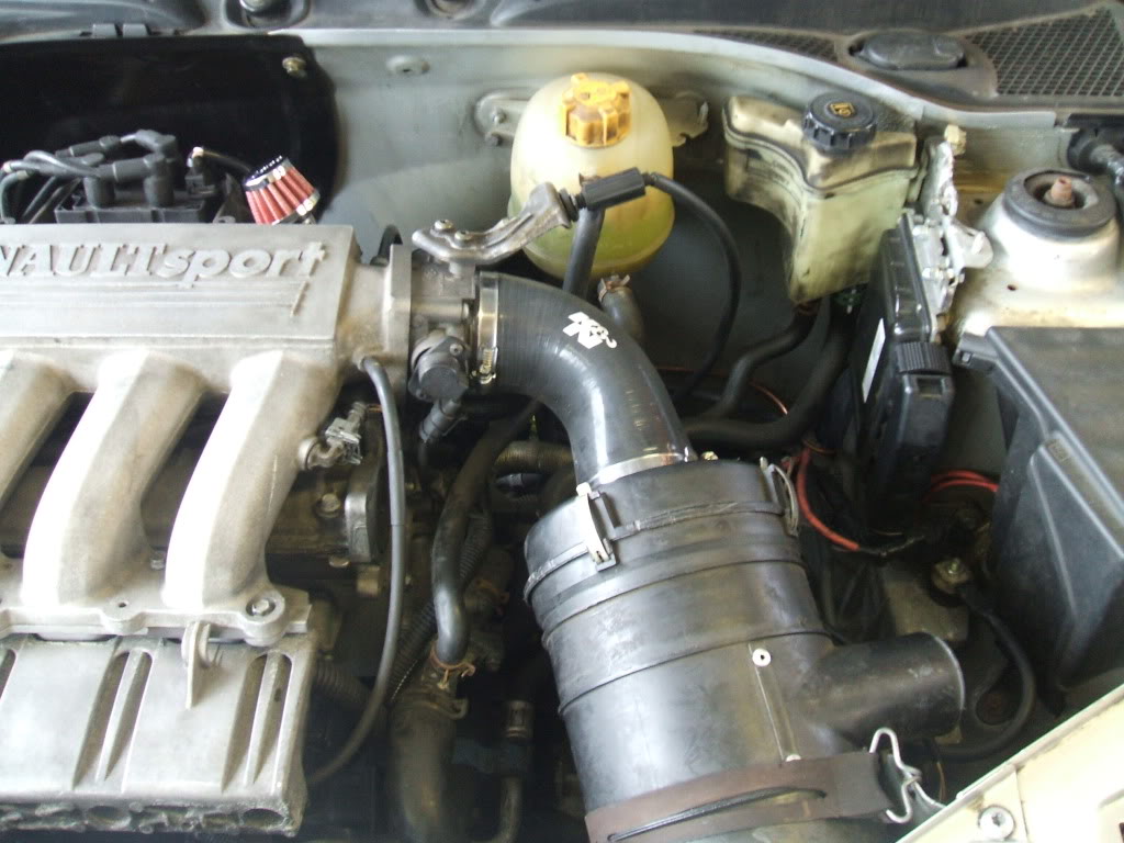

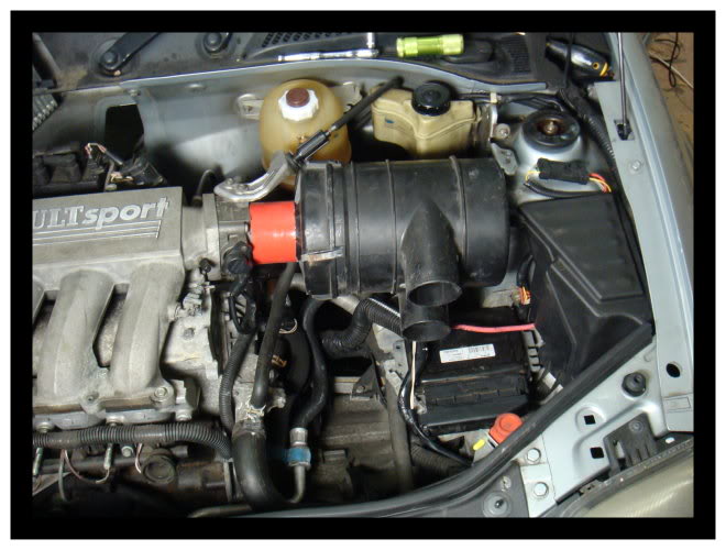

Also, while I'm after a bit of help, I have procured a Samco 90 degree elbow that I was going to use when I refit the airbox. On a Ph1, what have others done withe the pipe that goes to the air idle valve?

you have to block that pipe off otherwise the engine will idle at 3000rpm (sucks in air via the plenum from memory)

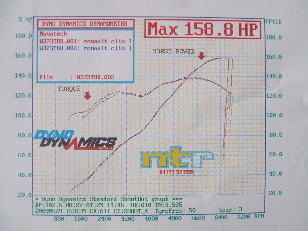

We had an open day at work on the 30th, and had a mobile rolling road booked for the day, so wanted to get the Clio to the point where it would run so that I could get it on the rollers...

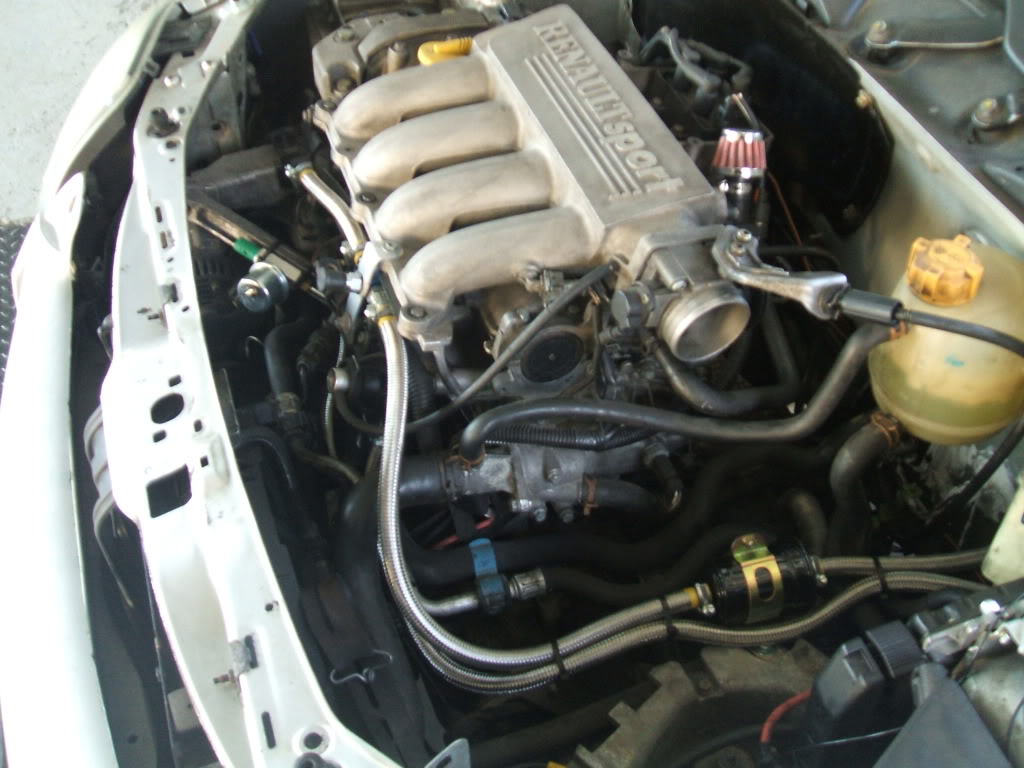

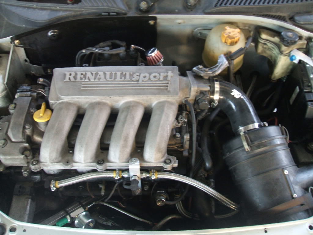

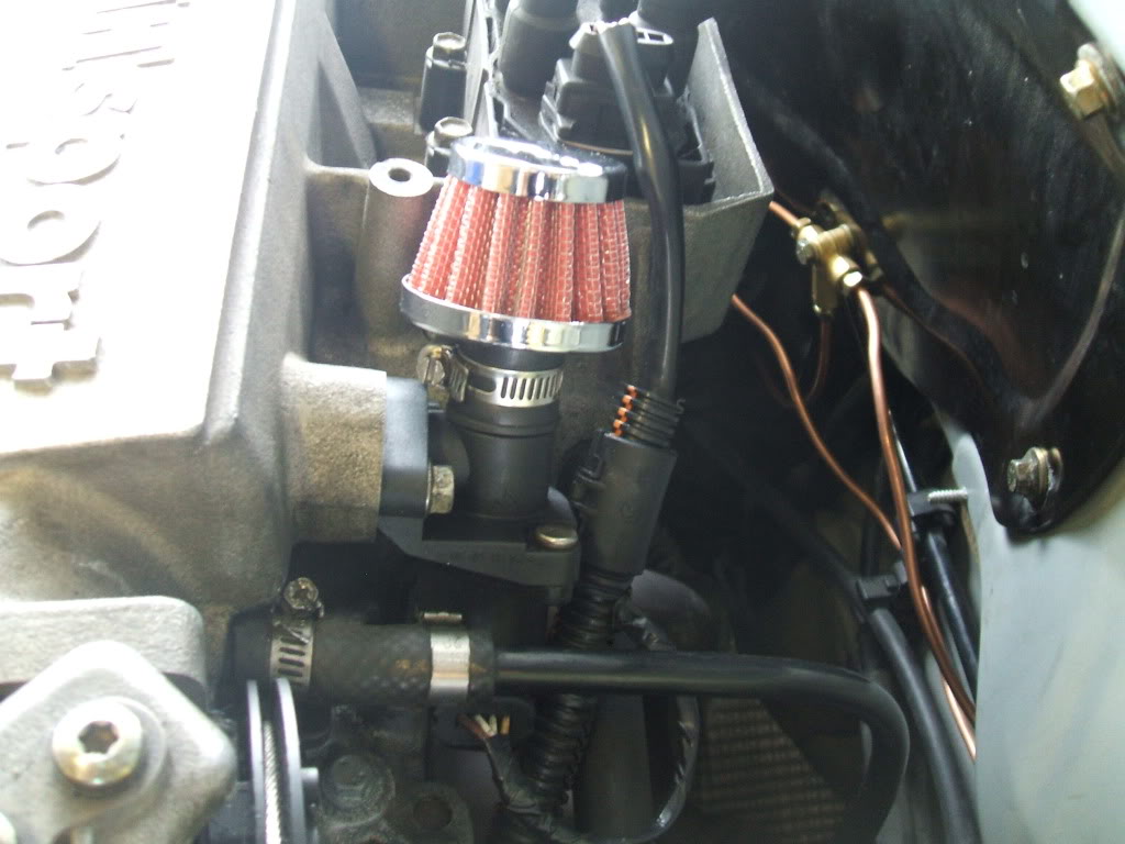

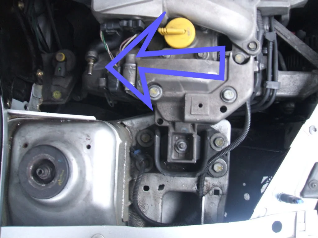

Firstly I modified Burps idea for the air idle valve and bought a little breather filter off the bay. Its supposed to be for a mini moto, but works well enough. I didn't fancy running a length of hose to mount the filter elsewhere, so took the air idle valve off, turned it upside down and fitted the filter directly to the inlet:

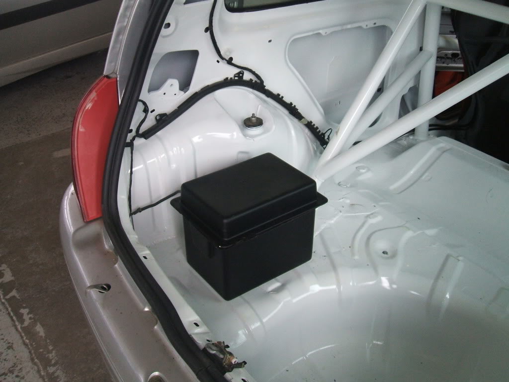

Next up, get the battery box mounted in the boot and make up new battery cables:
Got it running just in time to get it on the rollers as the last car of the day. And the result:
I was a little dissapointed in the results, but it was VERY hot that day (inlet temp is at the bottom of the graph at 46 degrees!). The engine is standard except for an RS Tuner Gp N remap, an ITG filter in the standard Ph1 air box and a prospeed exhaust. Desperatly trying to find a decat at a reasonable price, which should help.

Nice work mate, was your RR result from the fly or wheels?

Graph shows power at the fly. Would have beenchuffed to bits if that was at the wheels! ;) Might have to try and get along to the next Powerstation rolling road day.
Great work on the isc valve filter, nice idea turning it upside down.

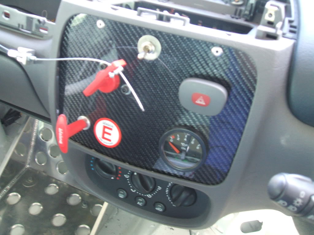

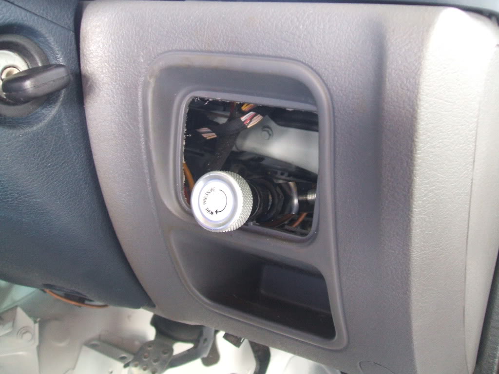

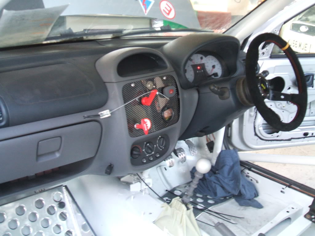

Battery master switch now completely wired in and now cuts the engine. I've also fitted an overide switch (top of the panel) incase the cut out switch fails on an event.

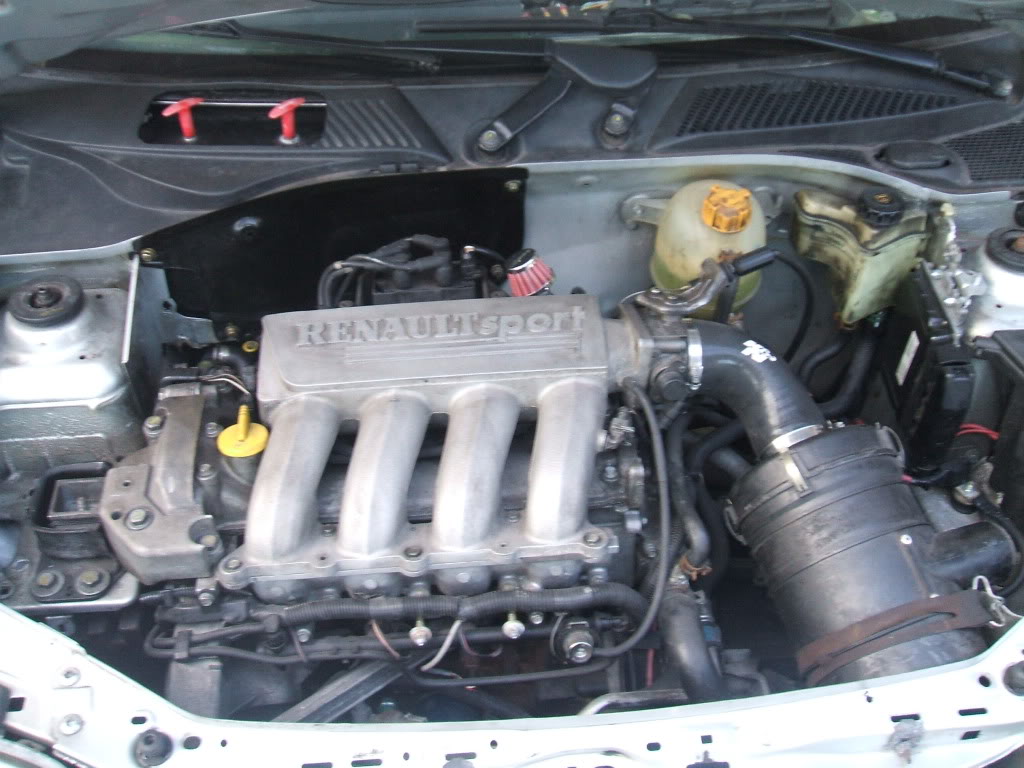

Engine bay coming togeather.

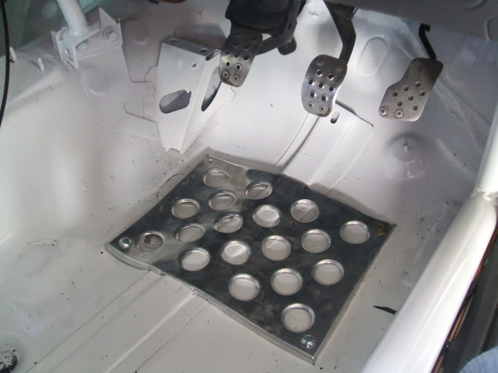

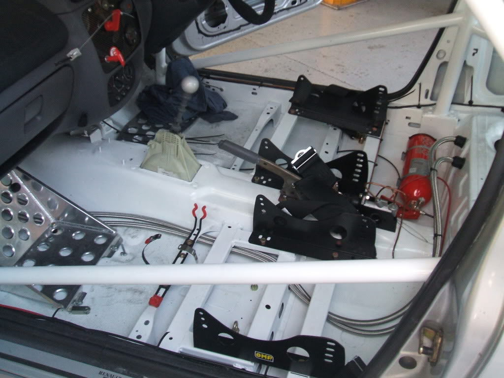

Drivers foot plate fitted. Not the neatest, but didn't want to fit a false floor. The rest of the floor on both sides has been fitted with clear grip tape, both to be non slip and to protect the paint underneath. Really pleased with how it looks. :)

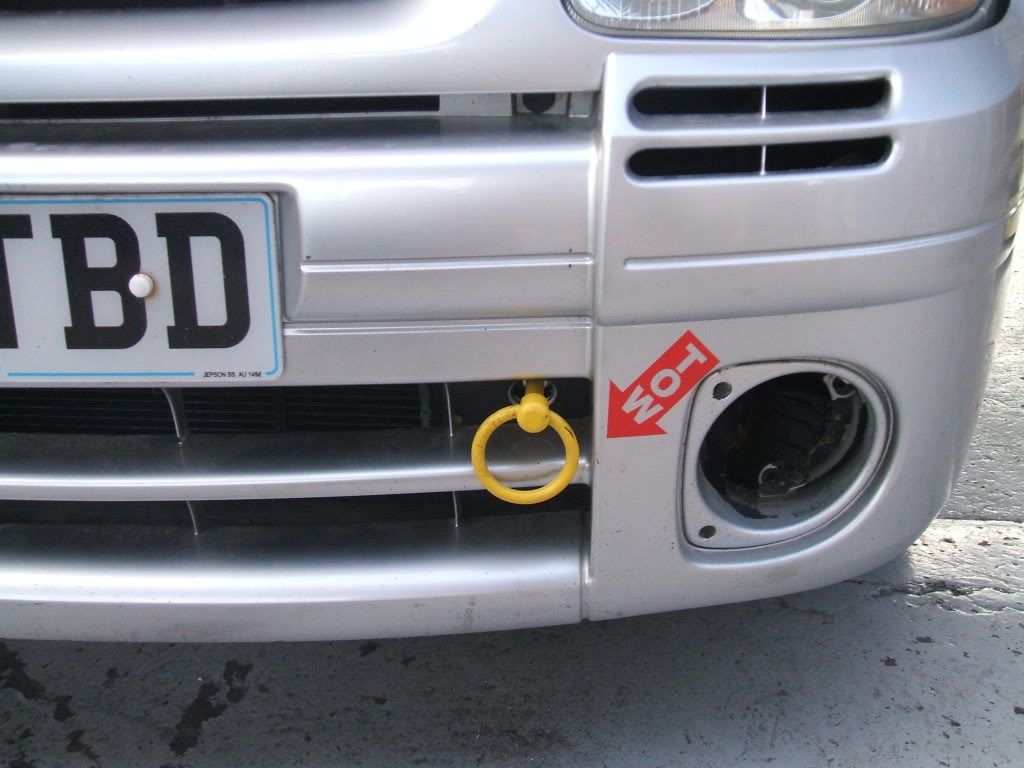

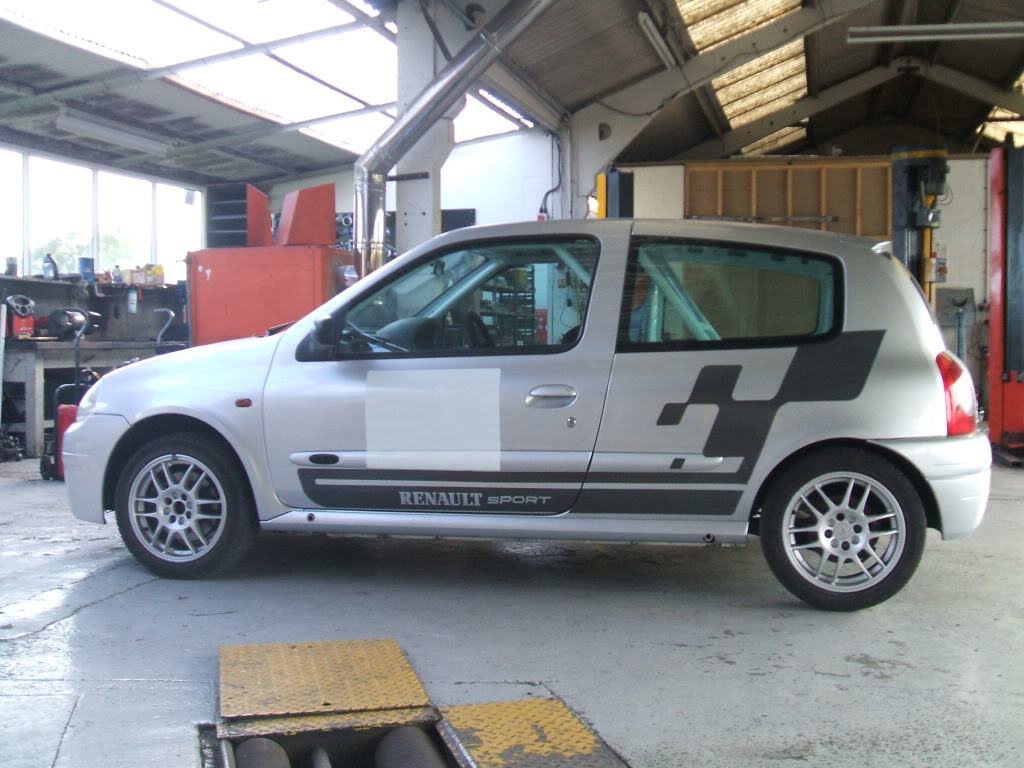

Tow eye and decal on. This is actually a requirement, and not done for show!
As it stands at the moment.
Other jobs completed... Bought a new set of Titon harnesses in black, and fitted. I'm pretty much ready for an MOT now. Might get that done next week. Made up templates and cut new door cards. Made from FlexiFoam board thats normally used for signage. Just as light as carbon, but a hundreth of the price. I've had the windows taken out and clear security film applied for FIA and MSA regulations. Decided to go this route rather than fitting perspex windows as they scratch really easily, and the sliders leak!

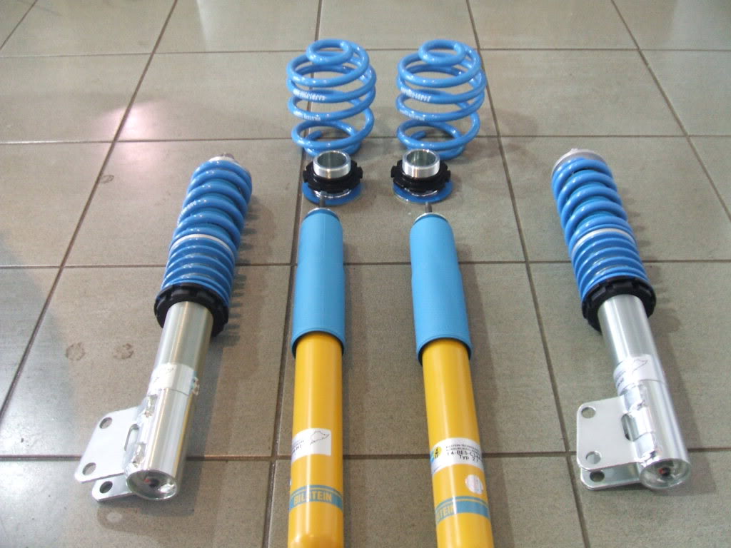

I had a re think on the suspension, got a good price for a quantity, and tried to arrange a group buy for Bilstein coilovers. The GB nearly didn't happen but me and Martin_172 went for it, and saved loads on the kit. Awesome quality, and really looking forward to getting them on. Need to buy a few more bits first: Poly bushes for the wishbones, solid top mounts, new bottom ball joints and track rod ends, then I can do a corner at a time and finish it as I go.

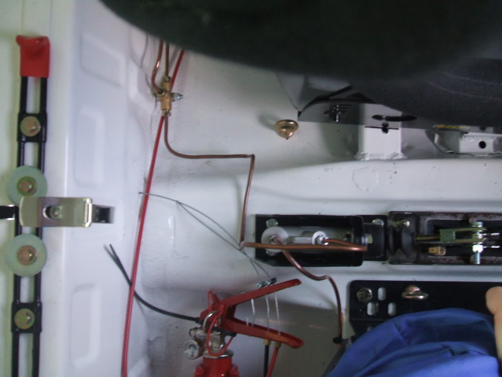

Tomorrows tasks will be to finish the dash wiring, so that I can get the dash top on for good. Also want to fit the lines for the plumbed in fire extinguisher, so that its another thing I can cross off my list. Also think I am going to have to move the hand held extinguisher so that my new helmet box fits. :( Finally, if I have time, I need to start running the braided stainless steel fuel lines down the inside of the car, and fit the FIA fuel sampling drain. Then get it MOT'd and probably taxed for the start of September to run up a few road miles to make sure its not going to fall to bits the first time I get it on a stage! In that vain, I have booked a shake down test with the motor club, hence the push to get it back on the road. Oh, and the first proper event will be the Brean stages rally in February. Can't wait! :D

Im gonna pinch your idea for the isc valve I think, quite a neat solution :D

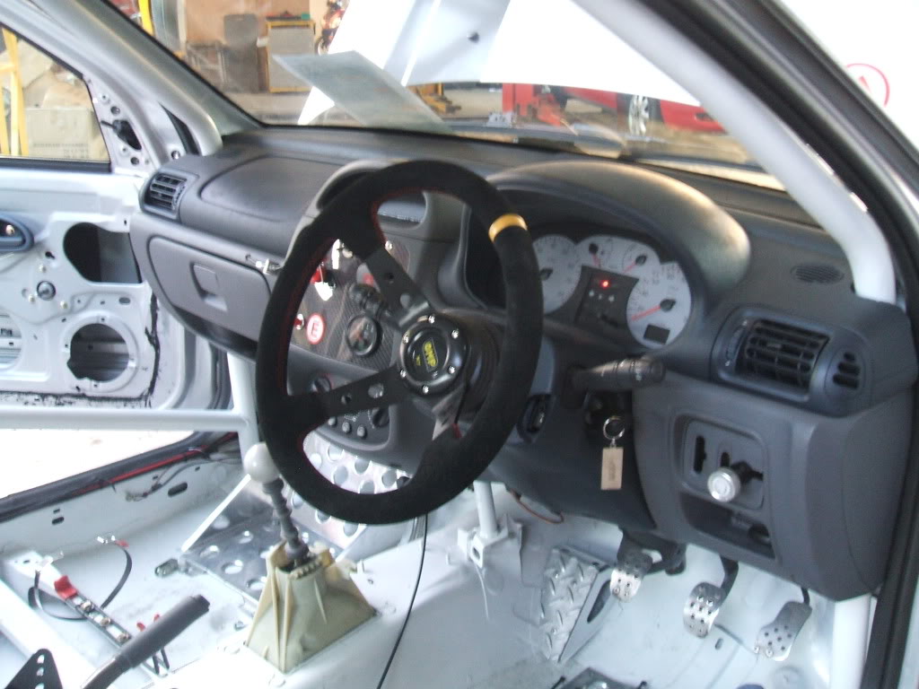

Previously I finished off the dash wiring, and put the dash top back on. Again, really pleased with this. I might of said before, but I don't like cars with no dashboards, hence retaining mine. However, the cage goes through it and I wanted to make it look as professional as possible. What do you reckon?
Also moved the hand held extinguisher so that my new helmet box would be in a better location. Not an ideal location in the cab, but no where else to put it so its accessable. Going to get another clip for it as Rally Design only supply one. :mad:
Handheld bracket in the foreground, and the seats out as I was in the middle of fitting the fuel lines when I took the photo.
