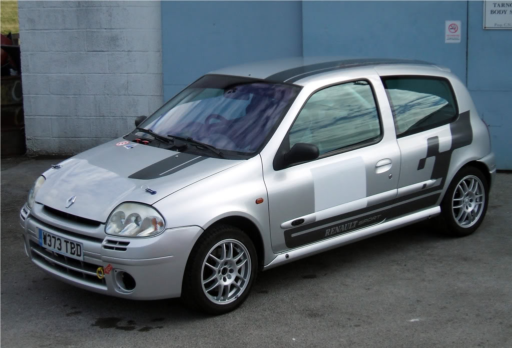

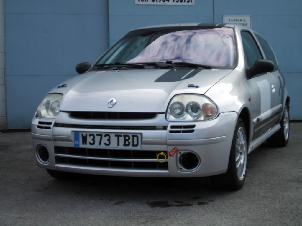

Past the MOT now so thought I'd drag it out into the sunlight, wash it and take a few pics. I noticed when transfering my posts here onto the blog that there aren't many exterior pics.
Oh, and today, my Grp N ball joints turned up earlier than expected. :D

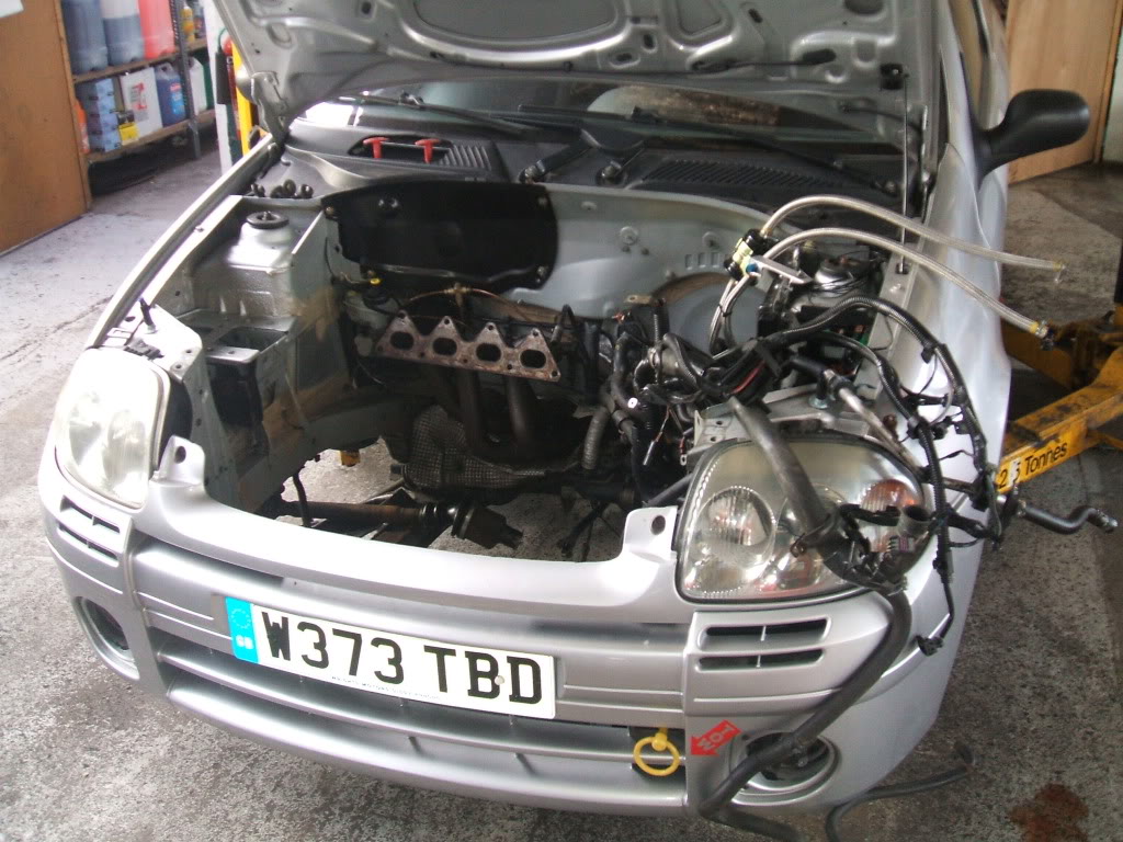

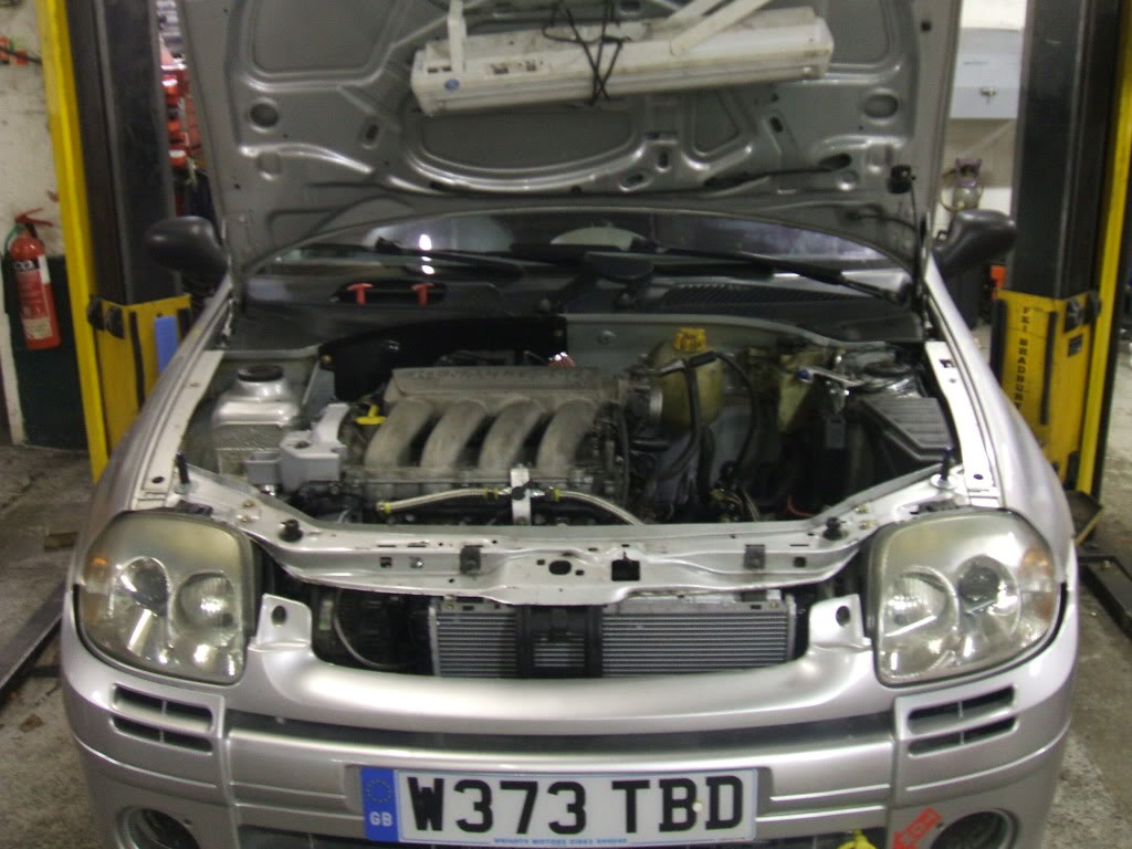

Decided a few weeks ago that I'd fit a paddle clutch before I start competing. Fells like a real backward step to be pulling the engine out after initially repairing the engine in situ, but hindsite is a wonderful thing!

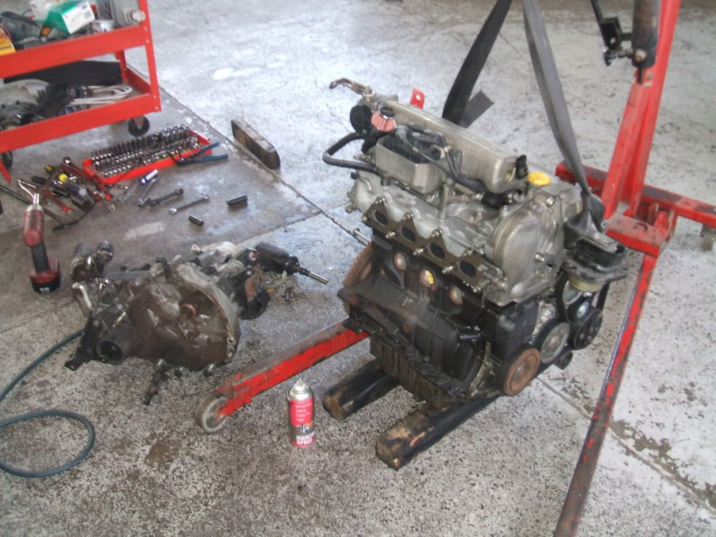

Anyway, started bright and early yesterday and by lunch time the engine was on the floor.
I then spent the rest of the day cleaning up the engine bay, and the engine ready to go back in. Unfortunately the paddle clutch didn't turn up, so it's all in bits again. :(
There was a bit of bronze swarf in the N'S drive shaft boot, so to be on the safe side (and because I've come this far) we are going to open the box up, and check and replace any worn syncros or selectors. I've also put my name down as a possible for the current slippy diff group buy. :eek:

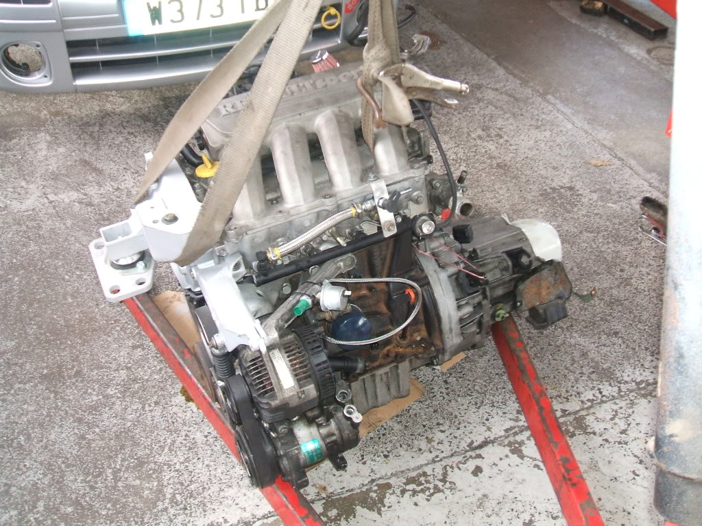

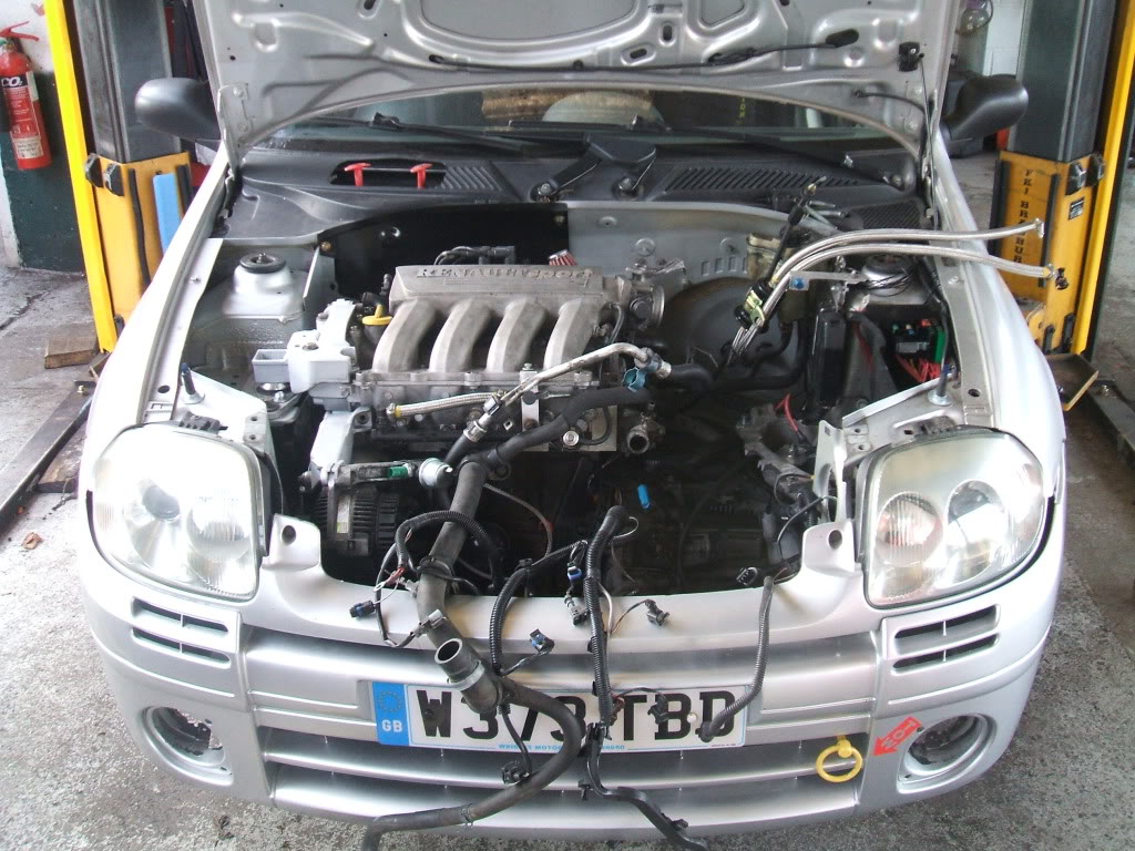

Another day spent on the car today, and I've vowed to take more photos to liven the thread up!
Firstly a bit of an update... The box was stripped by one of the guys in the workshop (20+ years of Renault experience, and I'm pretty sure he can strip and rebuild a JB or JC box down in his sleep! ;)
Anyway, we found some wear in the box, but nothing like it should at 76k miles. There were paint marks on some of the gears in the cluster, so we think that it's a service exchange box and definately no wear to worry about. How many events it lasts remains to be seen, as these boxes aren't the strongest! :S In an effort to keep the diff where Renault intended, I got another of the techs to weld up the gap in the circlip. Fingers crossed! I intend to do 4 or 5 rallies next year, and hopefully the box will cope. Meanwhile I plan on getting a 172 Cup box and rebuilding it with all new parts and a slippy diff, ready for 2011.
So, my Helix paddle clutch turned up after a 3 week wait. :( I bolted on the flywheel during the week, so that this morning my first job was to bolt the gearbox back onto the engine. With the engine on the crane (about 3 inches off the ground) I was wriggling the box onto the block when disaster struck. the webbing strap slipped on its knot and the engine made the short journey to the floor. Unfortunately this has put a crack in the sump, so I now need to replace it. :cry: On the bright side, it provides me with a good excuse to replace the big end bolts with ARP's.

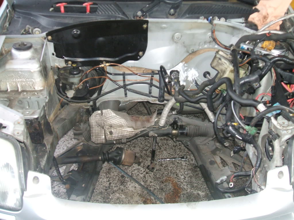

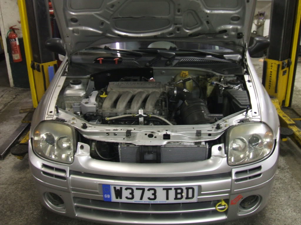

I decided to plough on, and get the lump back in the hole!
Lump:
Hole:

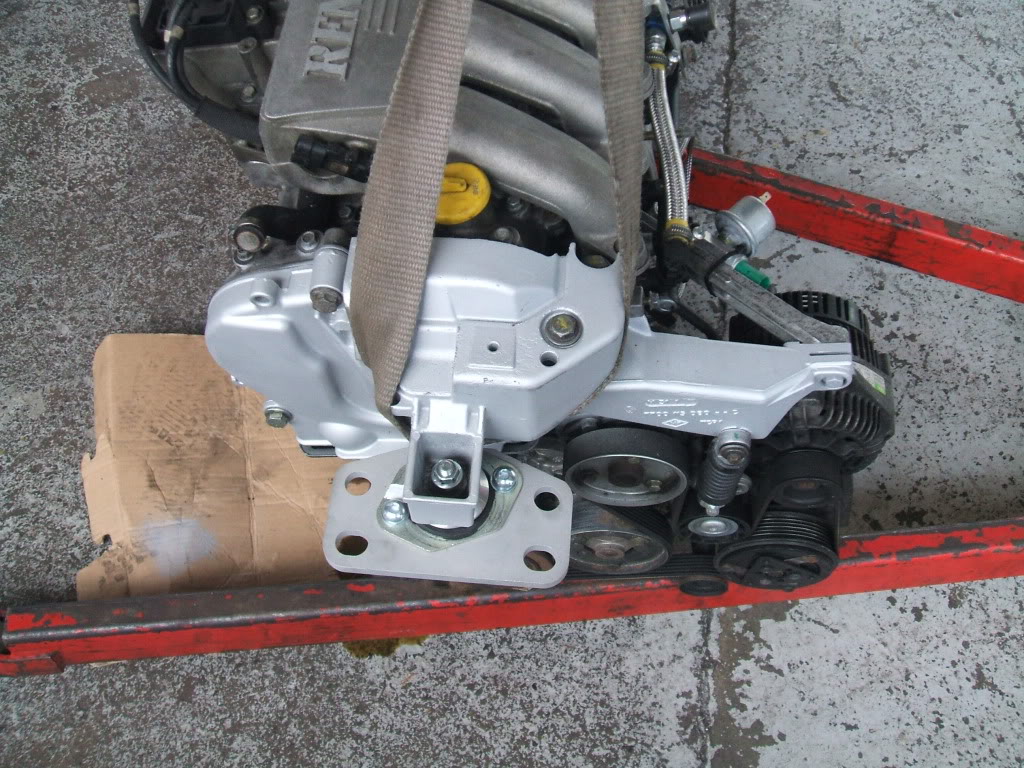

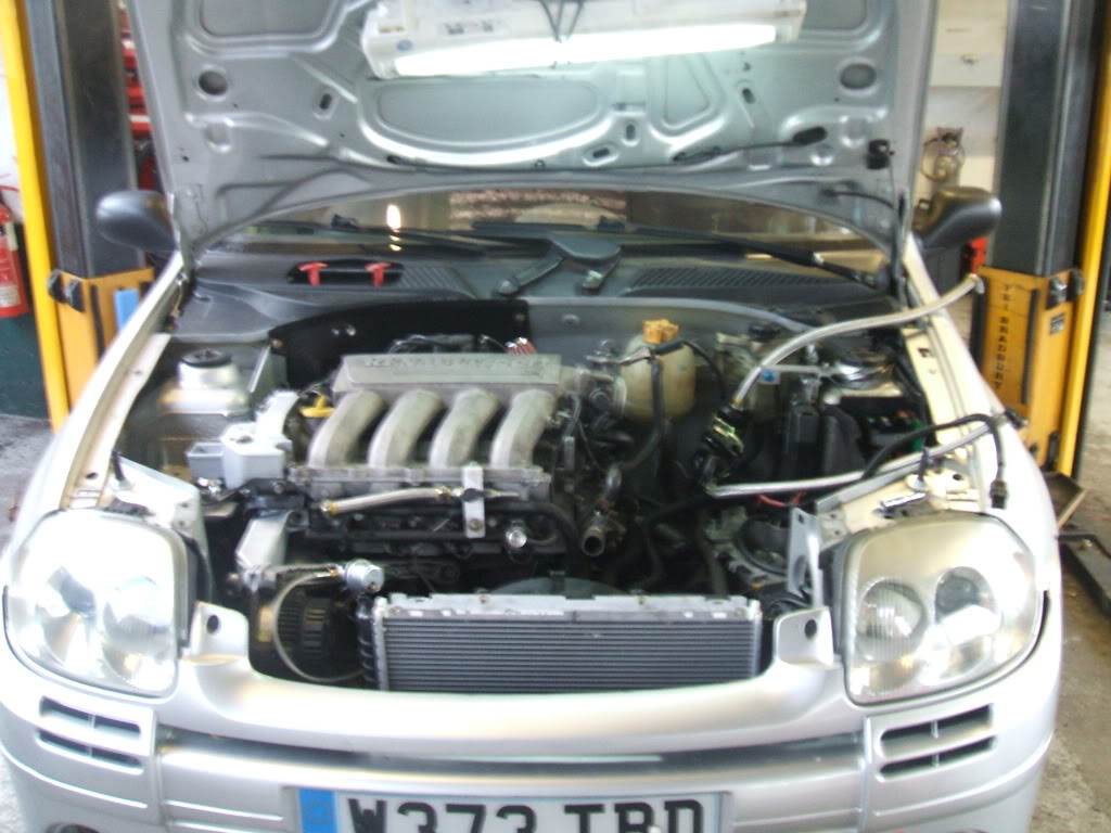

I'd already slotted my 182 Manifold into place, and replaced the standard engine mounts with the K-tec Grp N ones bought int the group buy.
I managed to drop it in without further drama.
It was then just a case of sorting out all the spaghetti like hoses and looms, and run them round the bay in the right place and connecting everything back up. Also fitted was a new ali rad.
And all done:

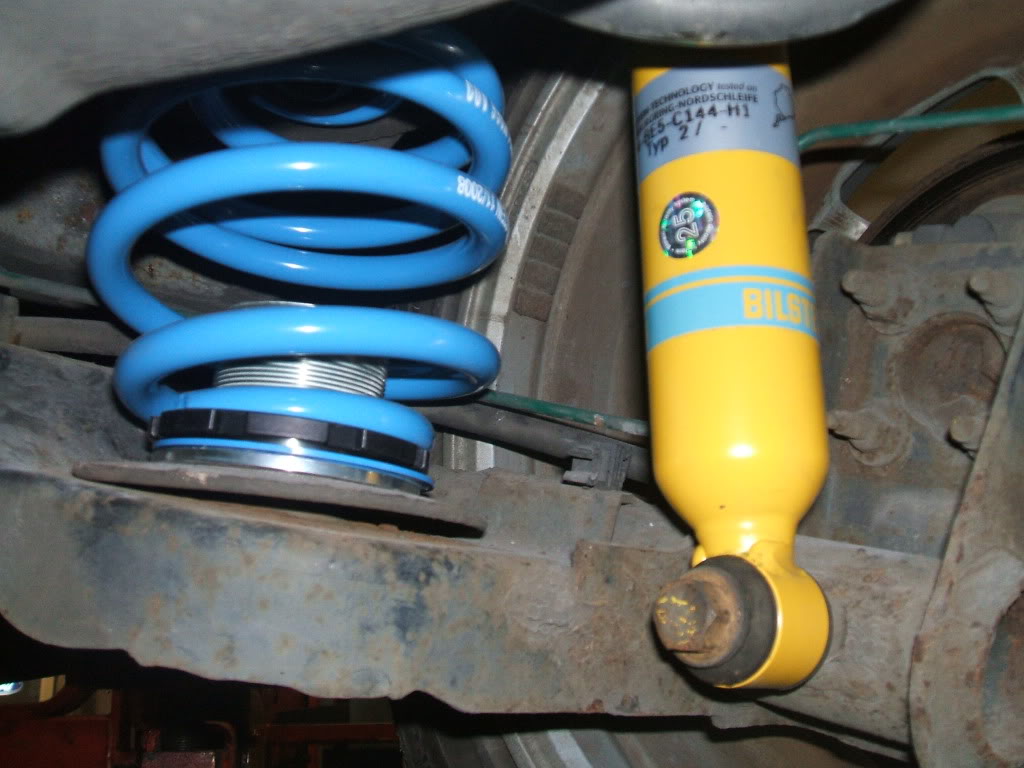

Mr Burp wanted my old shockers to keep his old project 172 rolling, so I had to bring my Bilstein fitting forward. It has let me sell the apex springs though, so I've managed to release some funds. Good job too as I have been spending! ;)
Anyway, just the rears fitted at the moment:
Don't worry though, they'll be coming off again when I paint the arches and rear beam

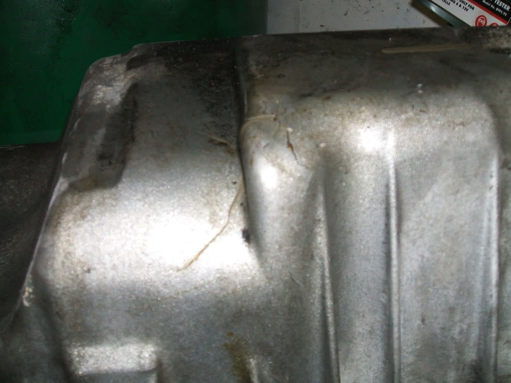

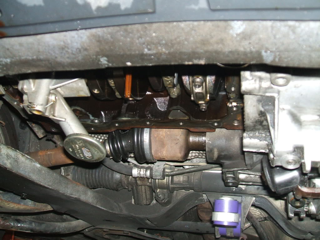

Been busy at work, so not had time to do anything with them until today. Removing the sump with the engine inplace was fine. Sideways Danny was right! However, top tip if you have searched for sump removal and found this thread / post: Don't jack from the bell housing, but from the A/C compressor mounting point. Much easier! Took just over an hour to do this lot...
Whipped the sump off:
And the crack :(
Fitted the ARP bolts as per the supplied info, and bolted the new clean sump on with fresh gasket. Filled with oil, and tried to start it.

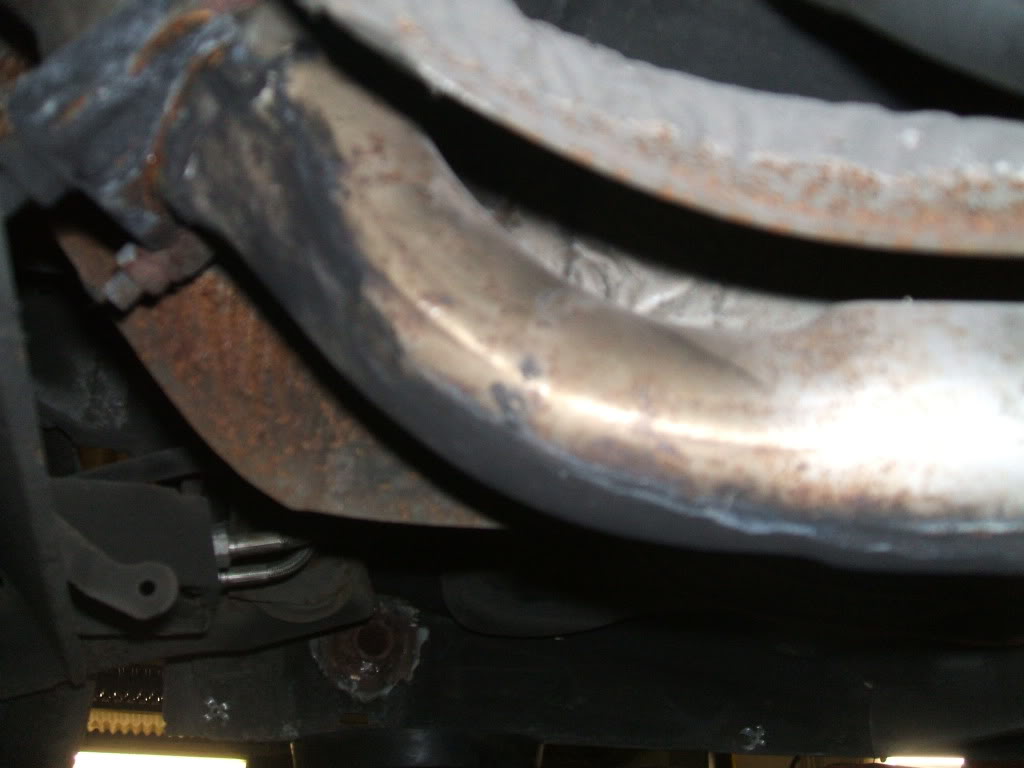

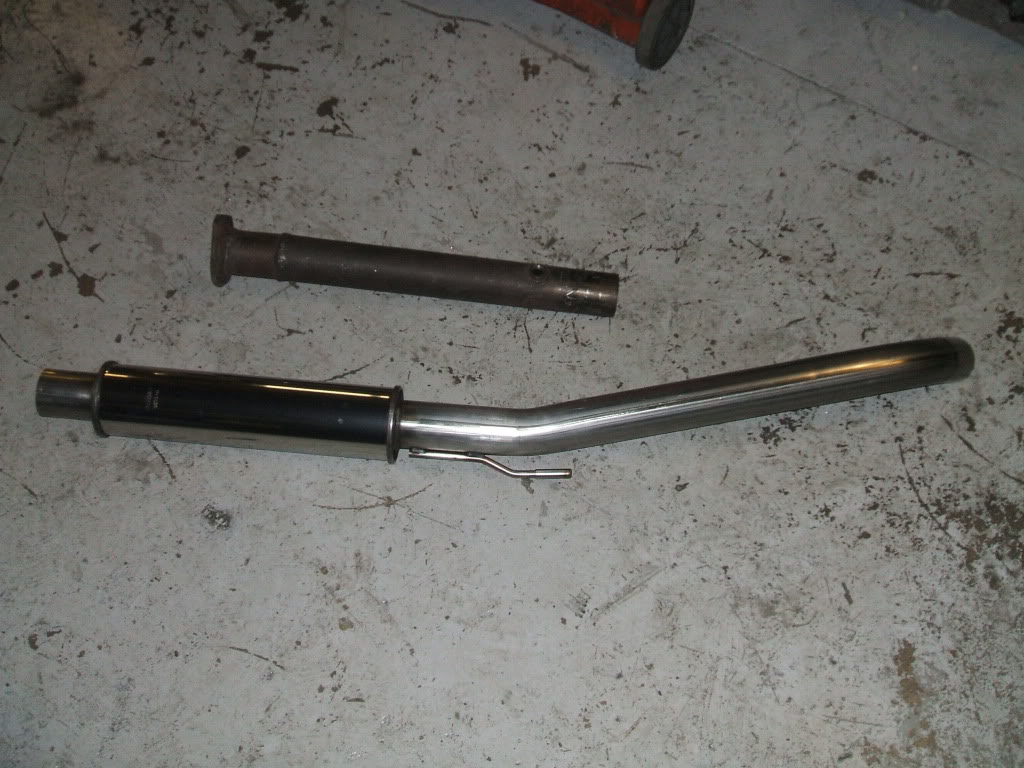

Last time I worked on the car, I noticed that the Powerflow exhaust mid section (that was on the car when I bought it) had a very restrictive bend up over the rear beam:
Difficult to tell in this shoddy photo, but it's only just over an inch diameter, so must be robbing me of some power. Anyway it looked cobbled together, and was blowing, so rather than fit my newly aquired 182 decat to a reducer, I bought a new centre section. The back box was fine, so is staying for now.
We deal with Mongoose alot with work (for the Focus ST's) so I called them up, and they did me a storming deal on the centre section on it's own and got it too me in double quick time. :D If any one is interested, the quality is top notch and I can get the full 172 exhaust with a sizeable discount. PM me for details.
