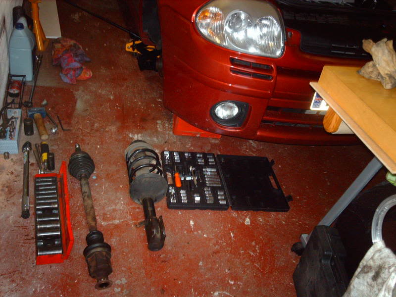

can't for the life of me get the driveshaft nut off... its much smaller and deeper than the ph2 one.... got a breaker bar on it and its not moving a bit.... ive put tons of wd40 on it.... got the blowtorch on it... fresh out of ideas???

managed to do it... breaker bar with a 1.5 metre pole on the end... the above looks like my garage lol... same colour worn out floor... incidently.. the car is also a flame ph quick..
