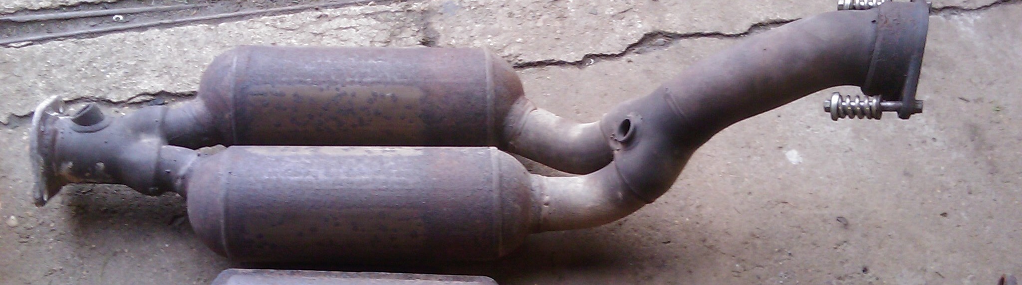

Get under the car and see how many lambda's it has they changed the cat mid production on the phase 1 172

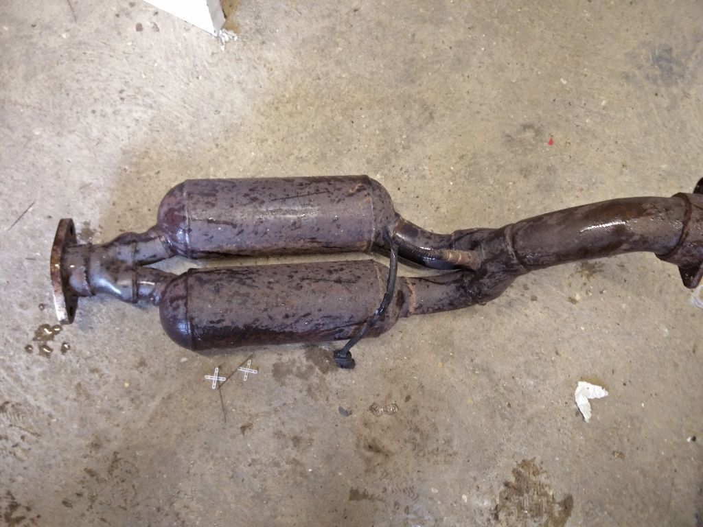

Early phase 1s have a twin cat so have a pre and post O2 sensor. The PRE is the one that needs changing if fooked.
Later phase 1s have same cat with one sensor.
Twin sensor
Single sensor

All mine are twins, two of them 2000 and the other 2001.
