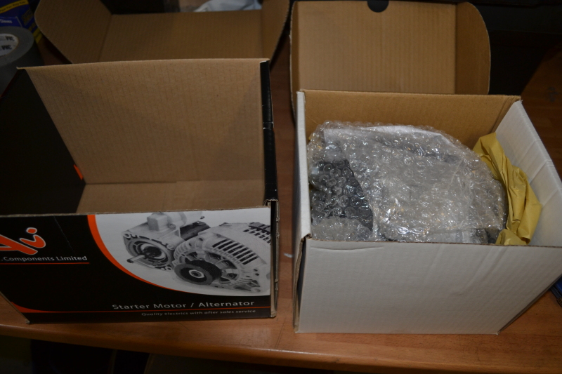

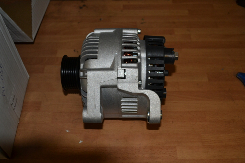

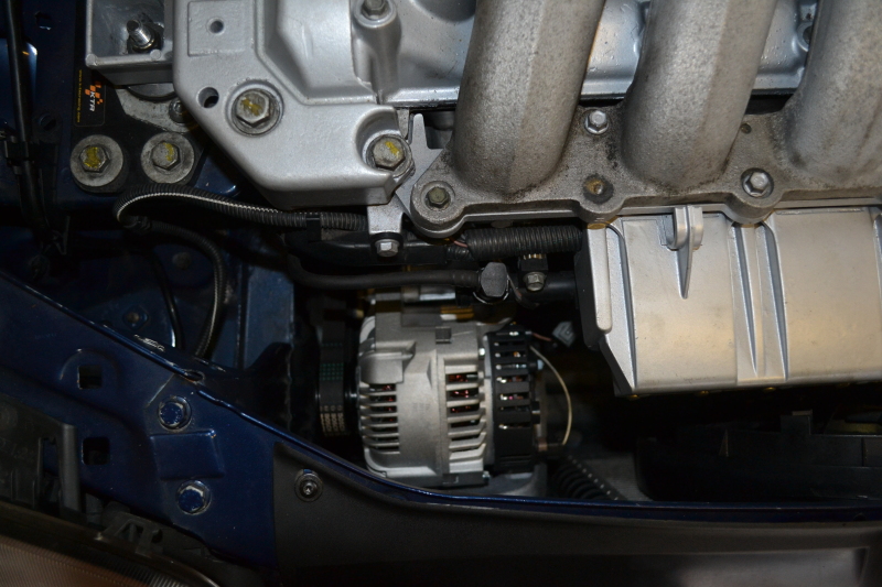

New alternator arrived yesterday. It is apparently a brand new unit not refurbished, has a 2 year warranty, and all for the sum of £44.
It was very well packaged.

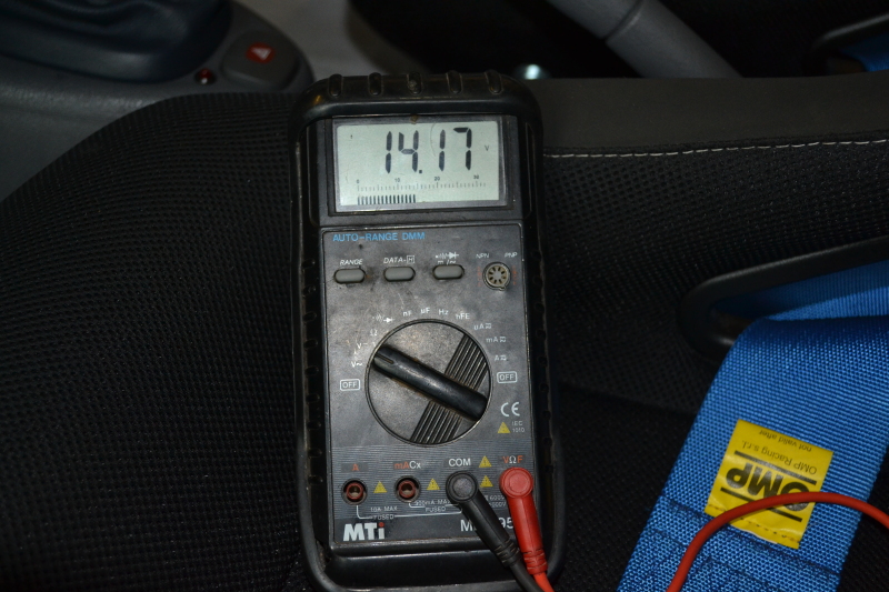

All fitted, nice easy job to do with the cup setup.
And outputting the correct voltage, better than the old one that was struggling to even output 12v at times.

Yes it does have one but it's not in the right place as it's next to the battery behind the passenger seat.
It's one of the jobs I have got to do, I 'm going to move it to the centre console, along with the fire extinguisher pull cord when I install it.
It's also not wired correctly at the moment as it doesn't have a resistor to protect the alternator (might be why the alternator cooked itself) so I'm going to wire it correctly when I move it.
