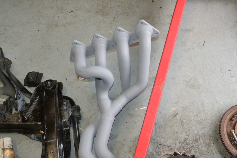

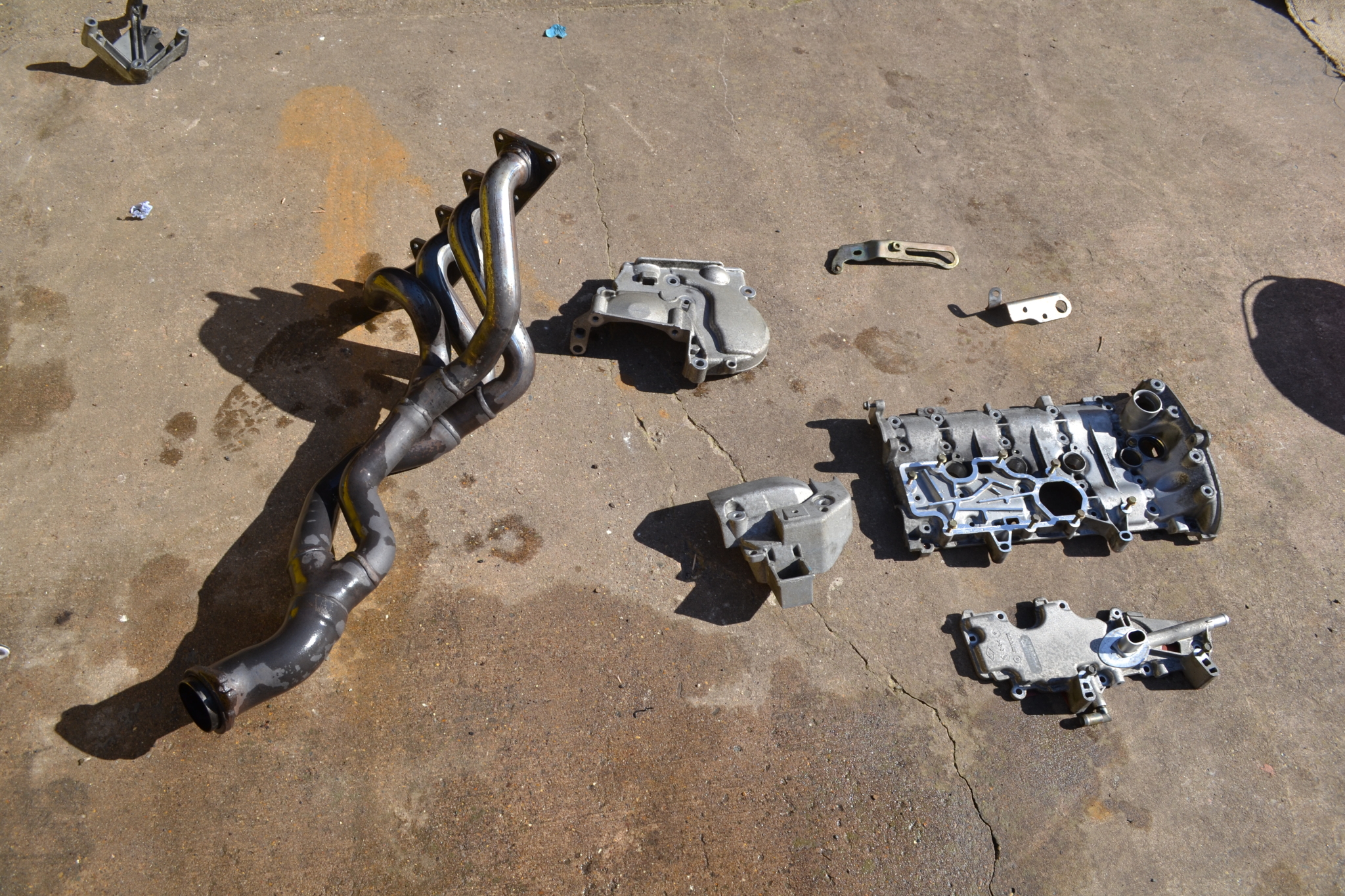

Clio 182 manifold

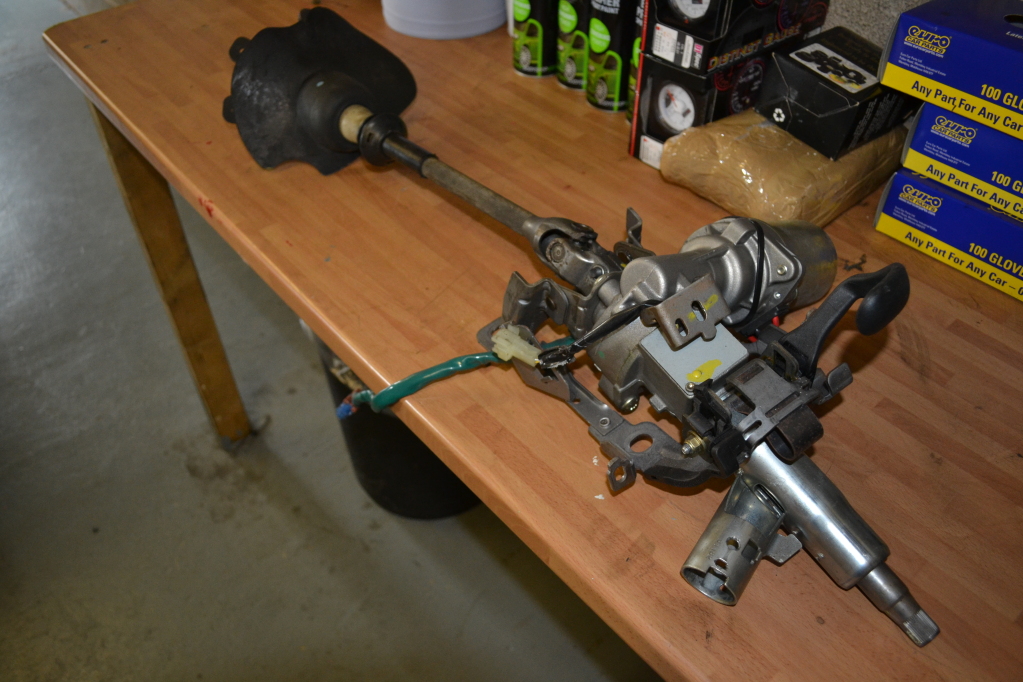

Electric steering column for EPAS conversion

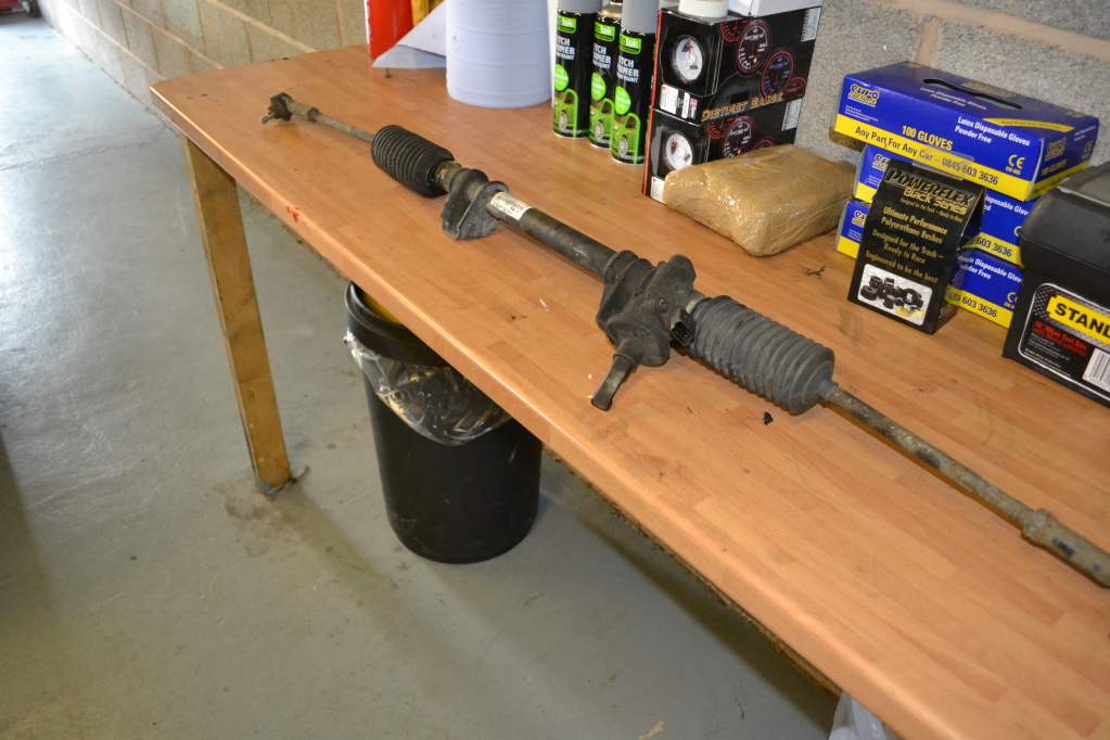

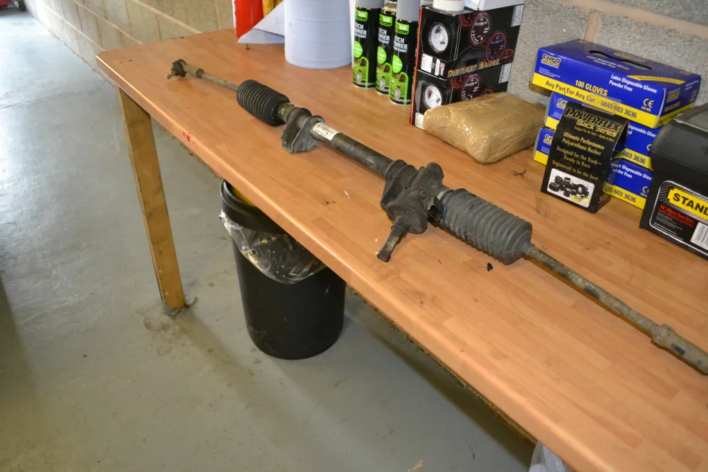

Steering rack from a Dci I confirmed that it is exactly the same turns lock to lock as the 172 rack.

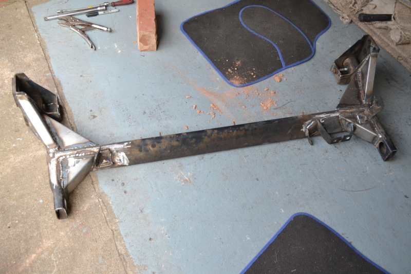

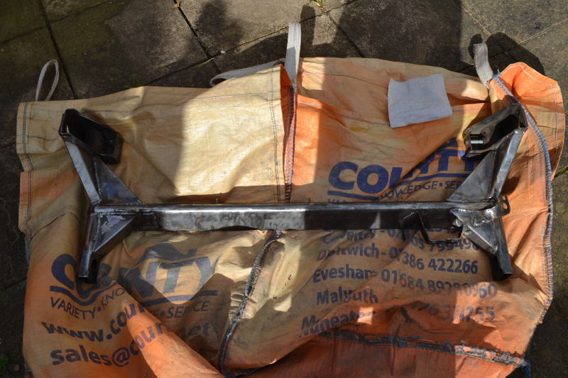

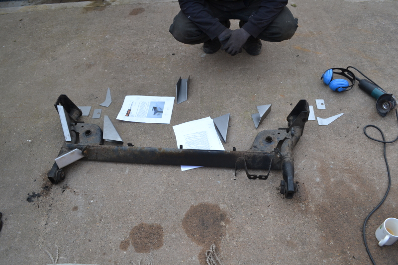

Pure motor sport rear beam strengthening kit. Got this half price from Nick at PMS as apparently they are seconds but look fine to me.

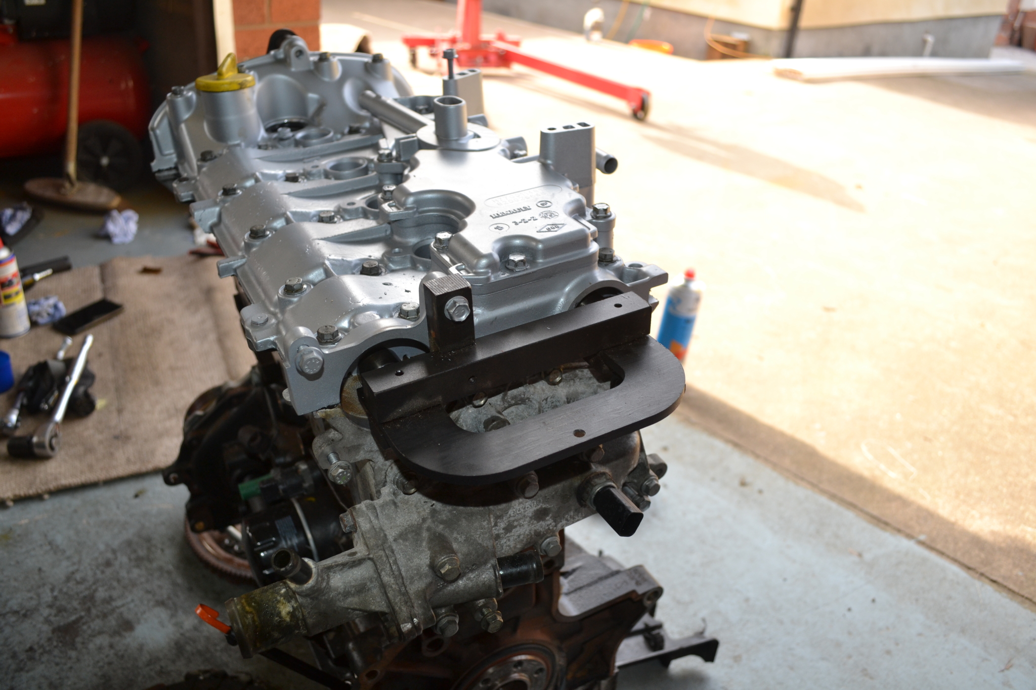

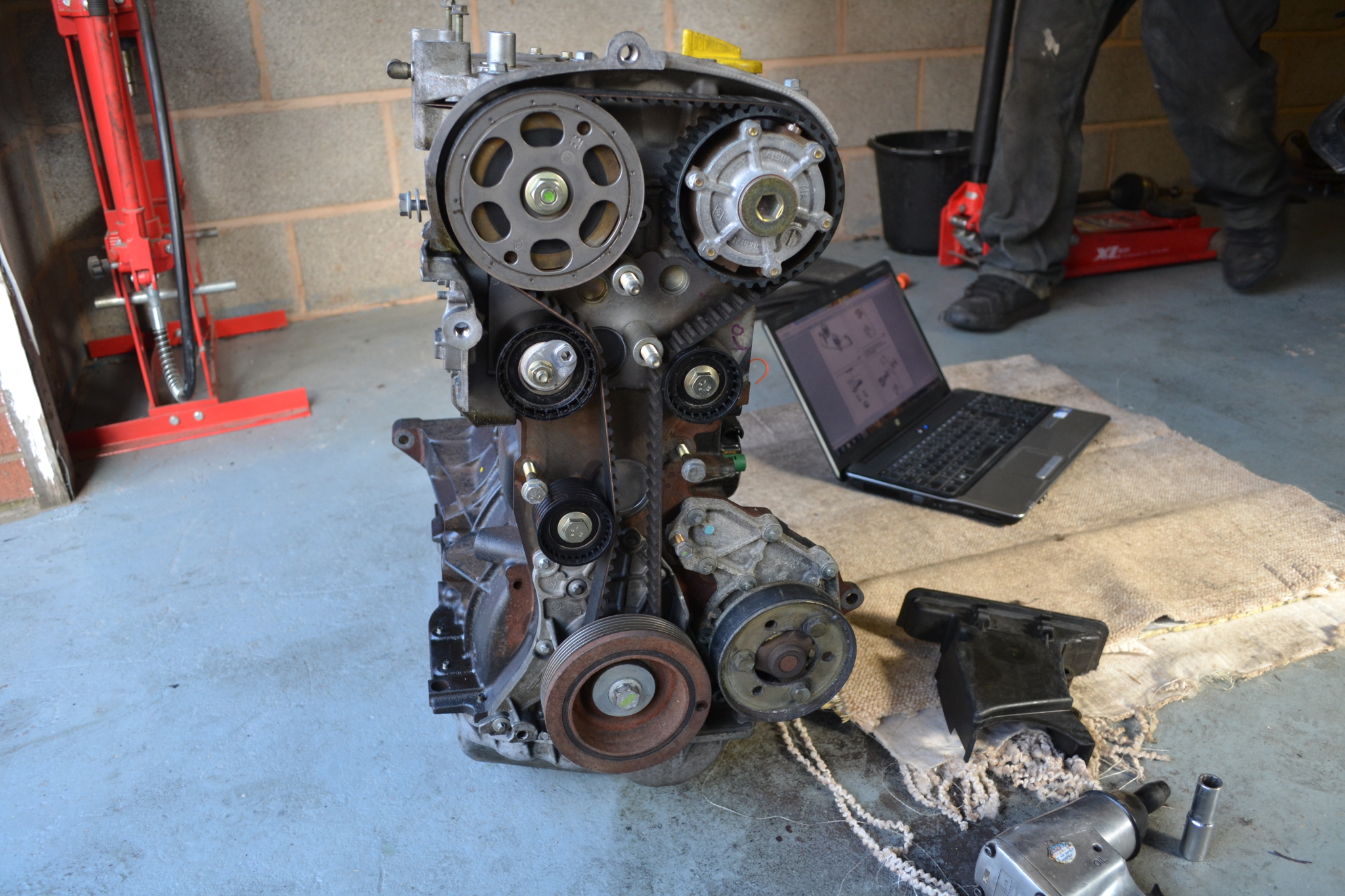

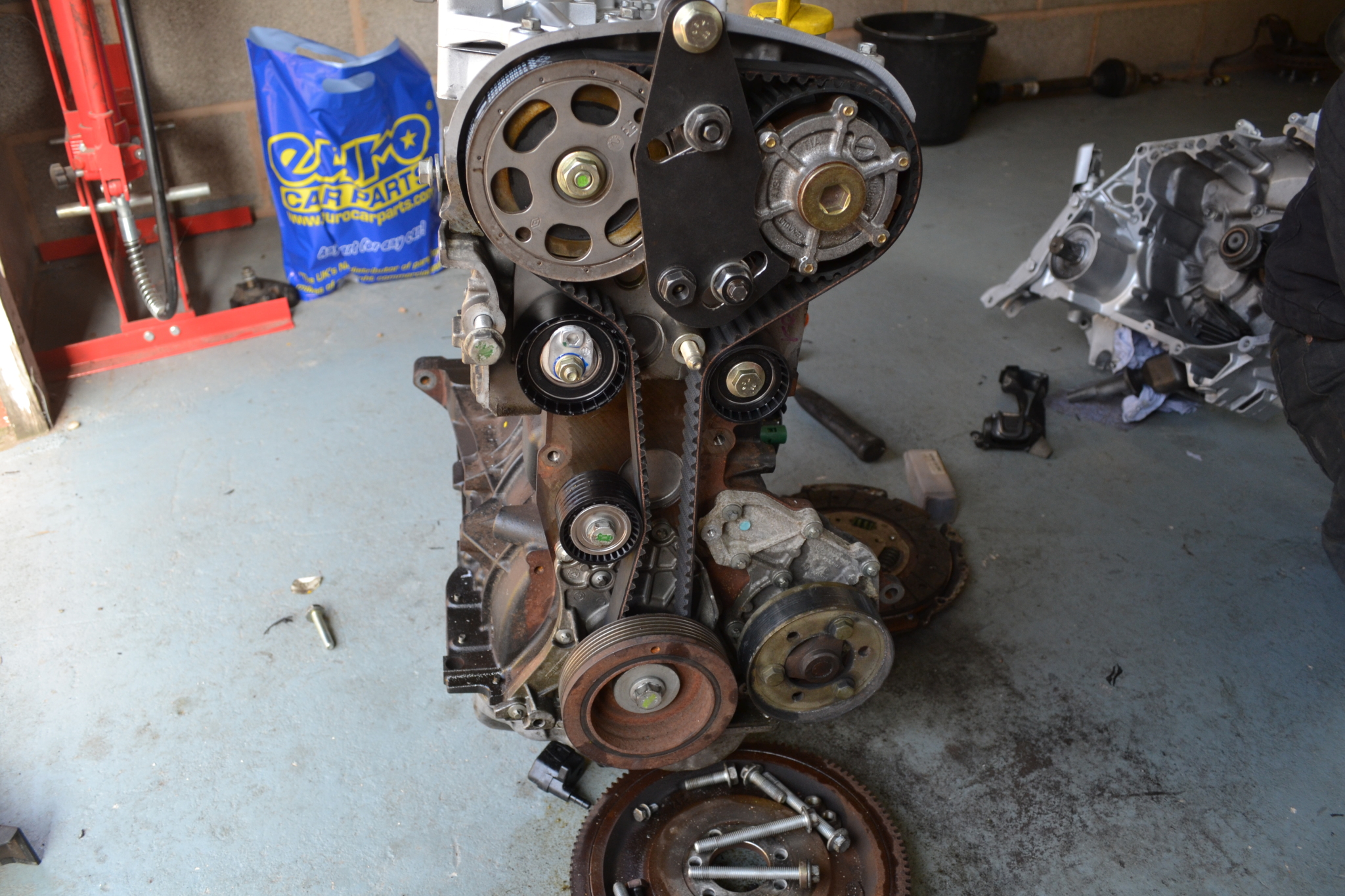

While the engine was out for other things it would be silly not to change the cambelt as well.

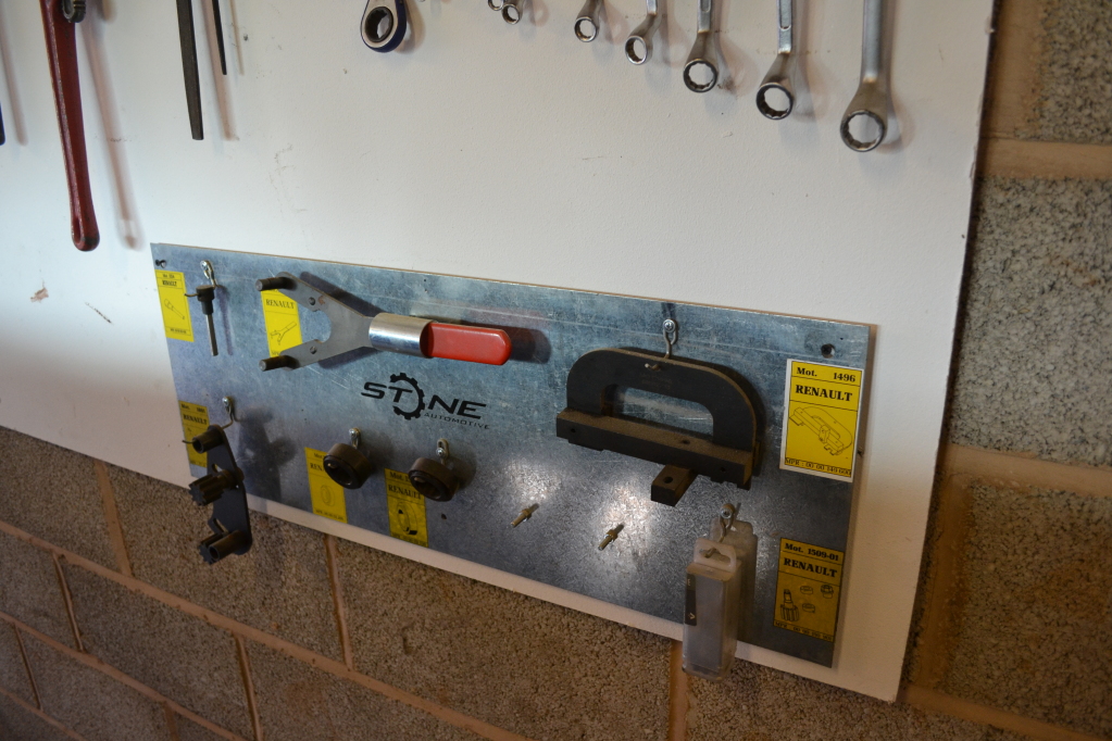

I have a set of genuine Renault timing tools that I bought a little while ago from Stone automotive. As I'm sure most of you know they are essential for accurately timing these engines.
Timing Tools
Old Belt on the engine

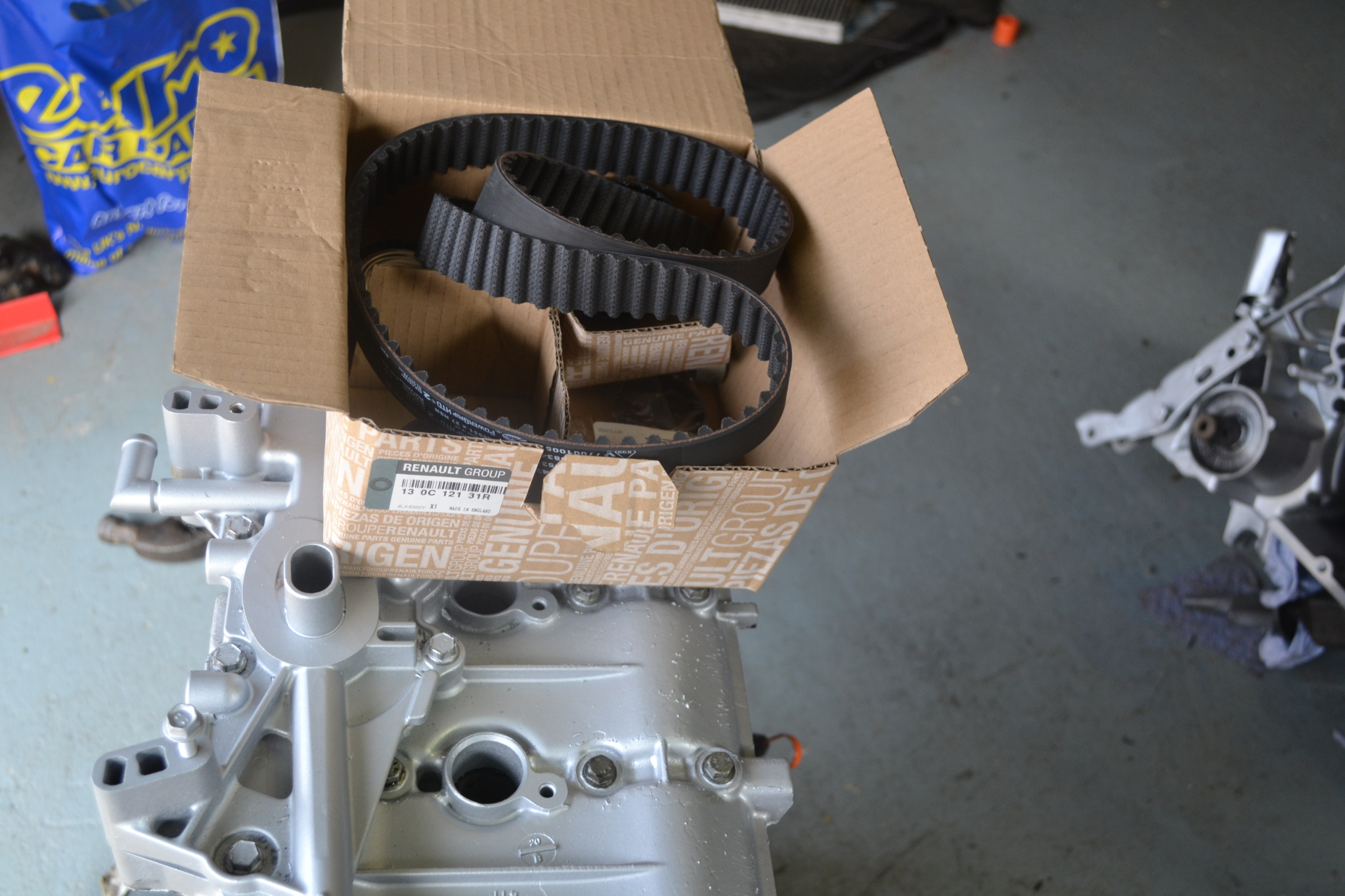

New genuine cambelt belt kit from Renault Wolverhampton

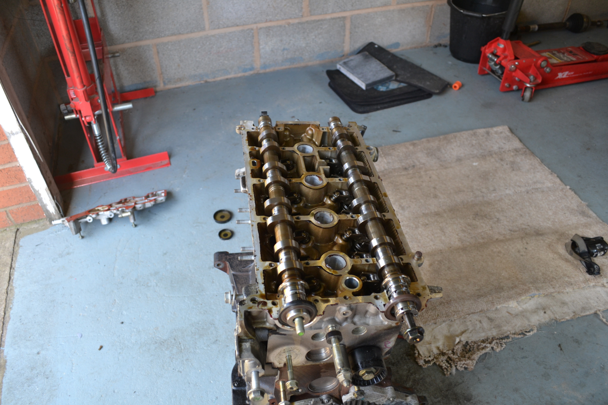

As suspected the timing was out, I forgot to take any pics of the cam slots to show this though.
I think there must be a lot of improperly timed F4R engines out there.

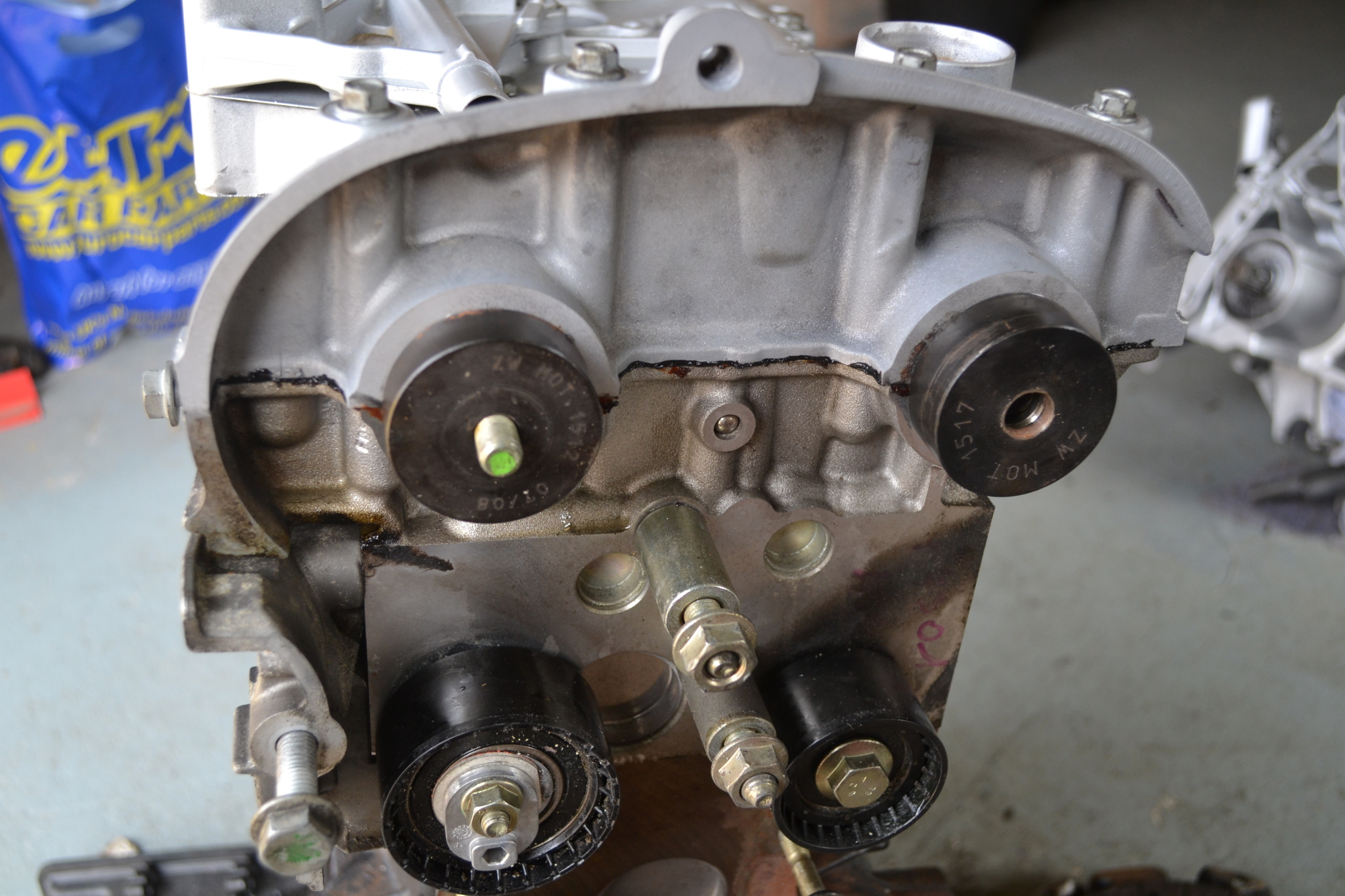

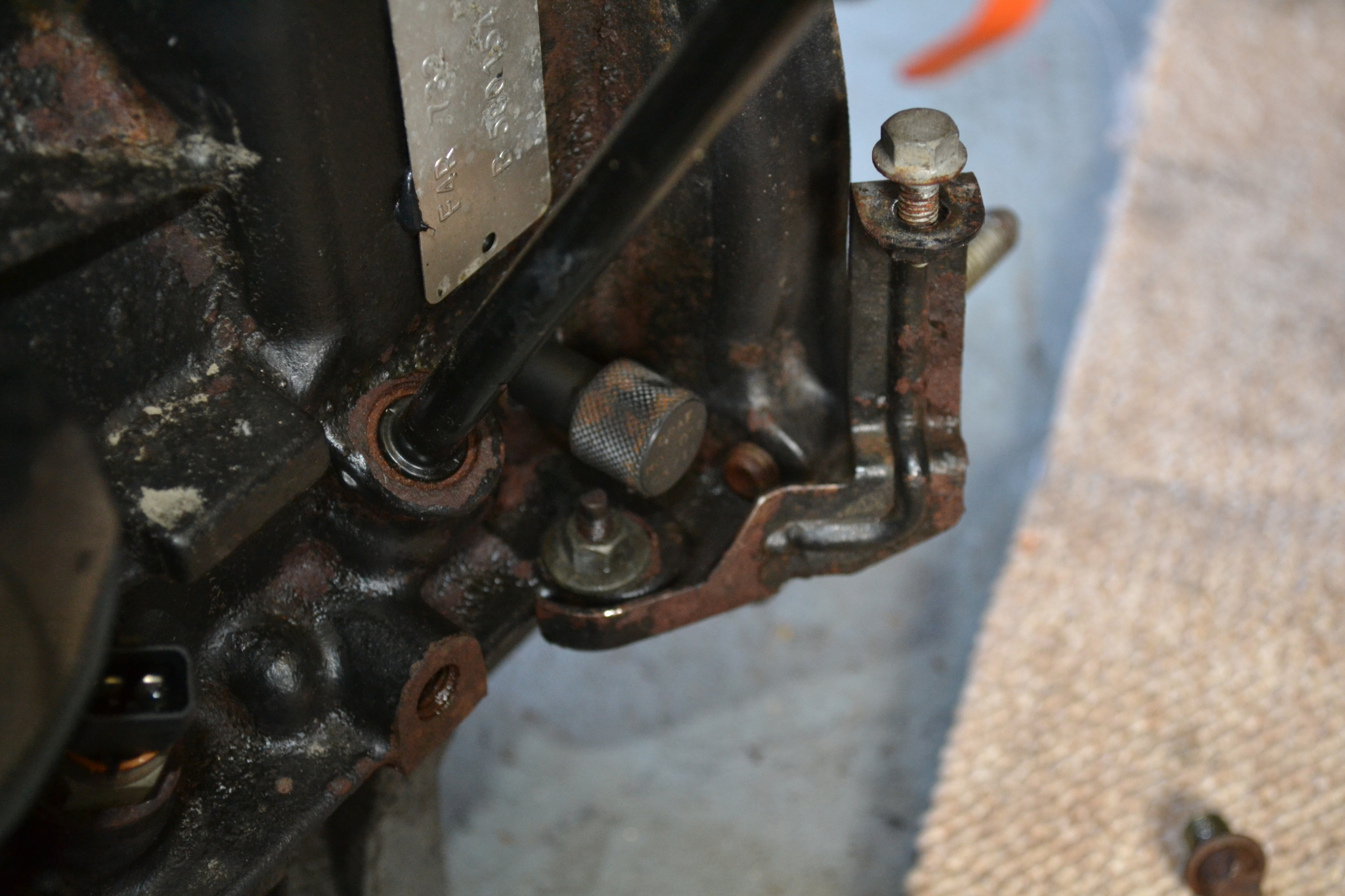

Rocker cover removed for painting and to fix a small oil leak
Some parts ready for cleaning and painting
New cambelt, idlers and tensioner
Timing checked, turned then checked again, perfect
Also new cam seals and cams caps. No pic of cam caps for some reason though
Not a particularly exiting update but a good job done.

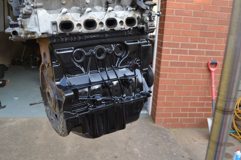

I have been cracking on with cleaning and painting various engine parts.

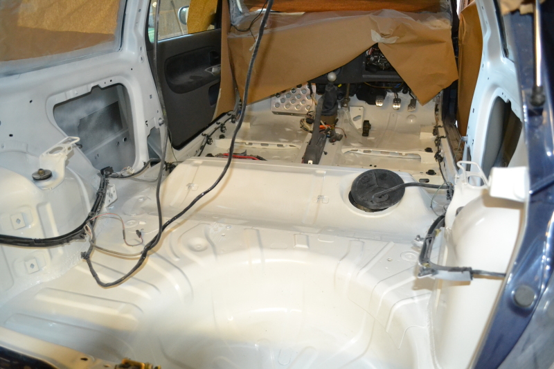

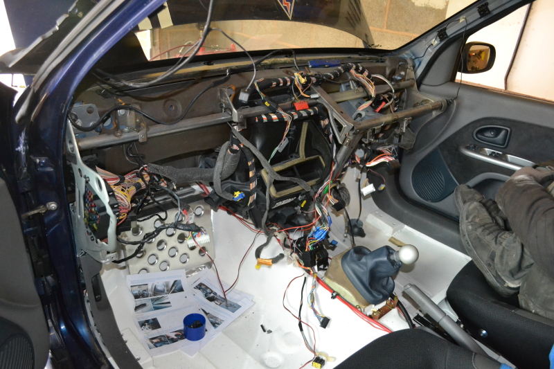

Had the dash out to remove all the sound deadening from behind it. Also to run the wiring for my oil temp and pressure gauges, the epas conversion, and to make installing the new steering column a bit easier.

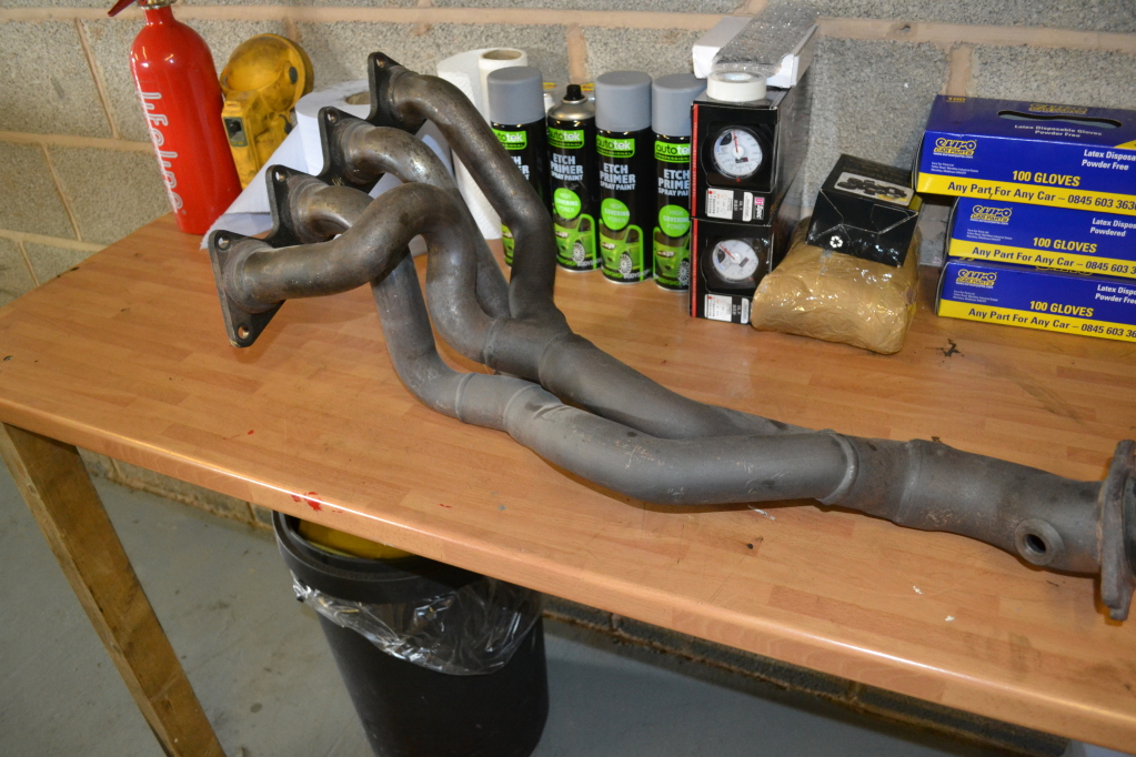

Cheers for that Mini182, I have a Ktec stealth system with a modified BTBcat atm so a link pipe would most definitely be needed.

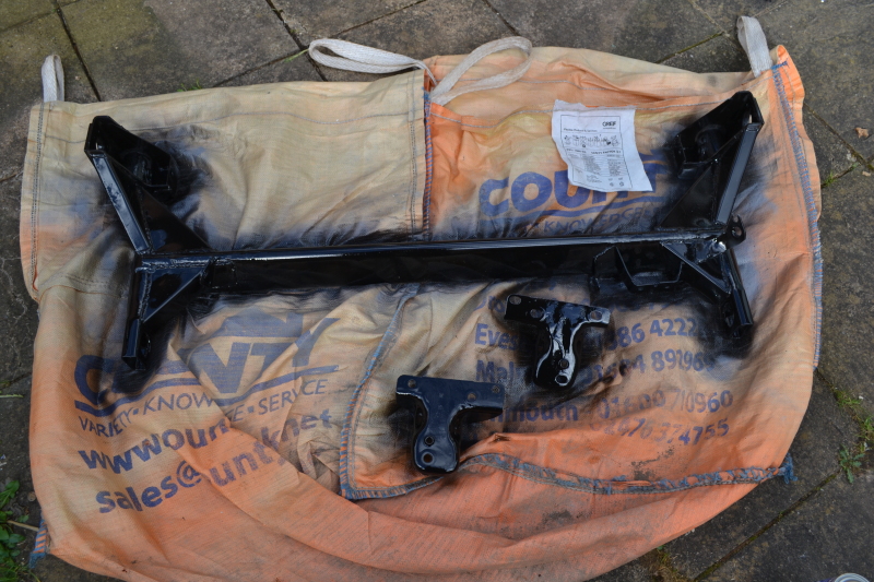

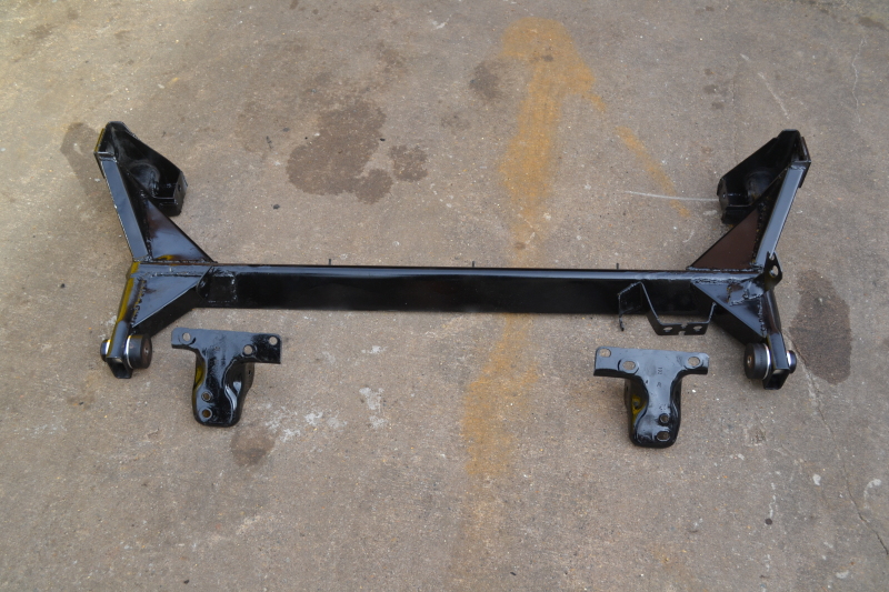

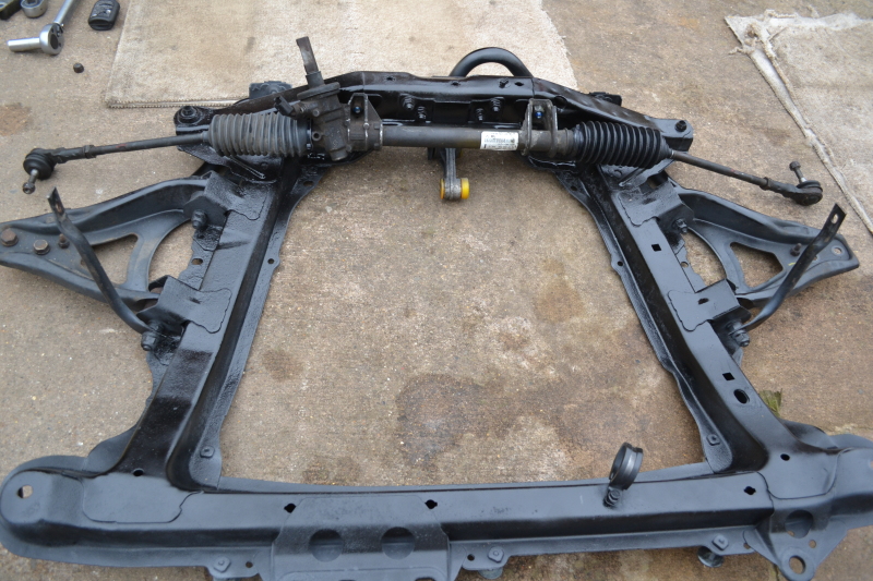

Subframe had a coat of satin black while it was out. Also new dci steering rack fitted.

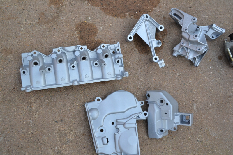

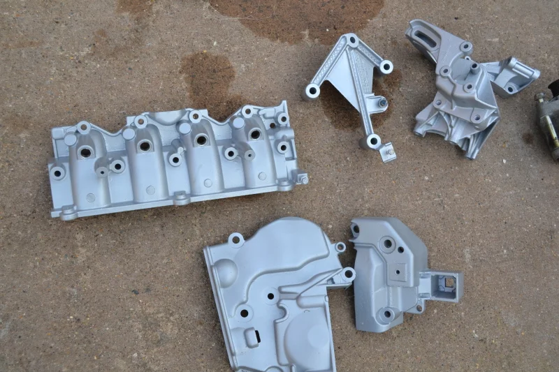

A few other engine bits painted silver enamel.

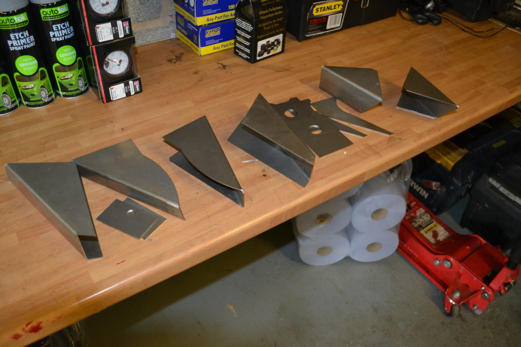

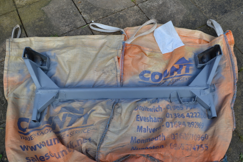

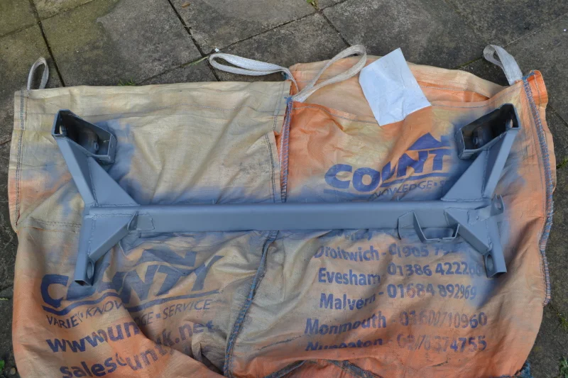

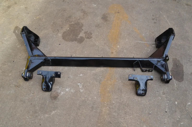

PMS Rear beam strengthening kit laid out.
Fitted with brake brackets repositioned.
Cleaned up.
Acid etched and then painted satin black.

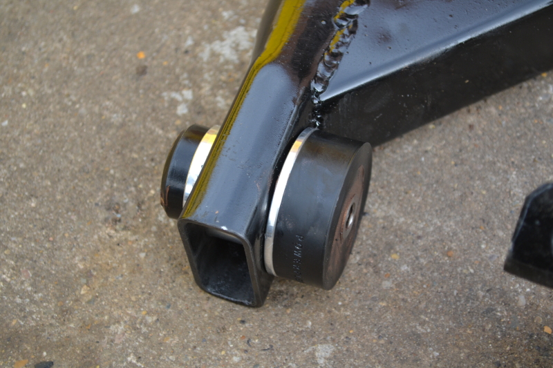

Finished with powerflex black series bushes fitted.

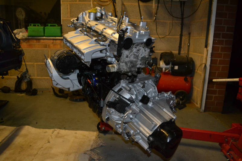

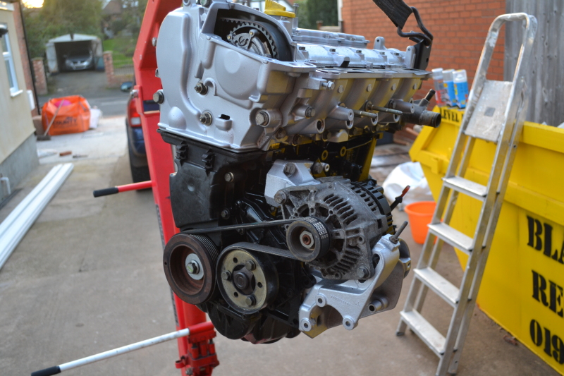

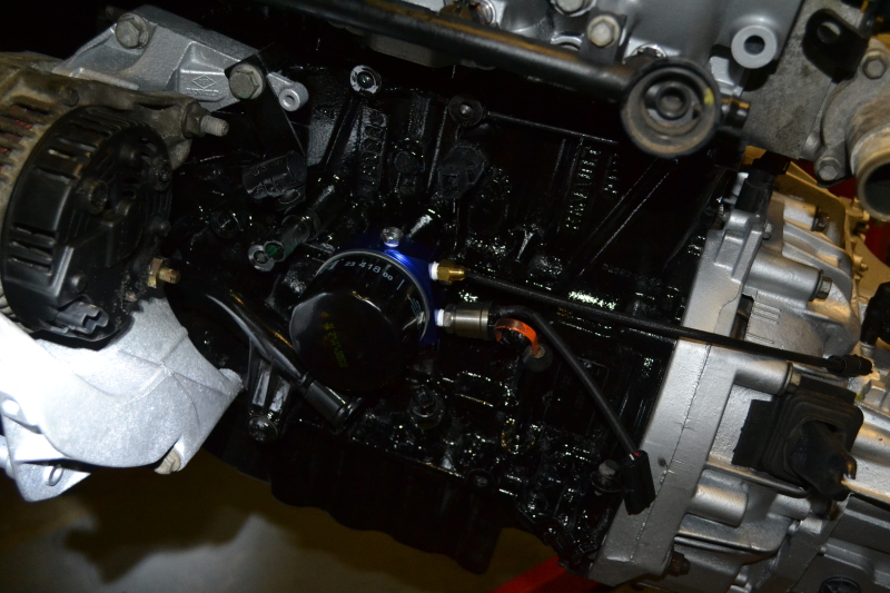

Engine and gearbox have now been painted and put back together.
Aircon and PAS delete with Cup alternator setup
Also fitted a sandwich plate ready for my oil temp and pressure gauges

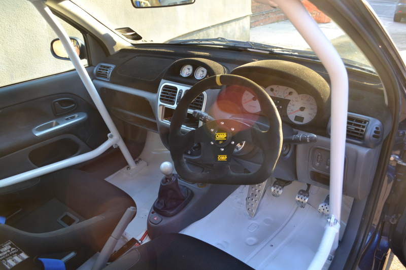

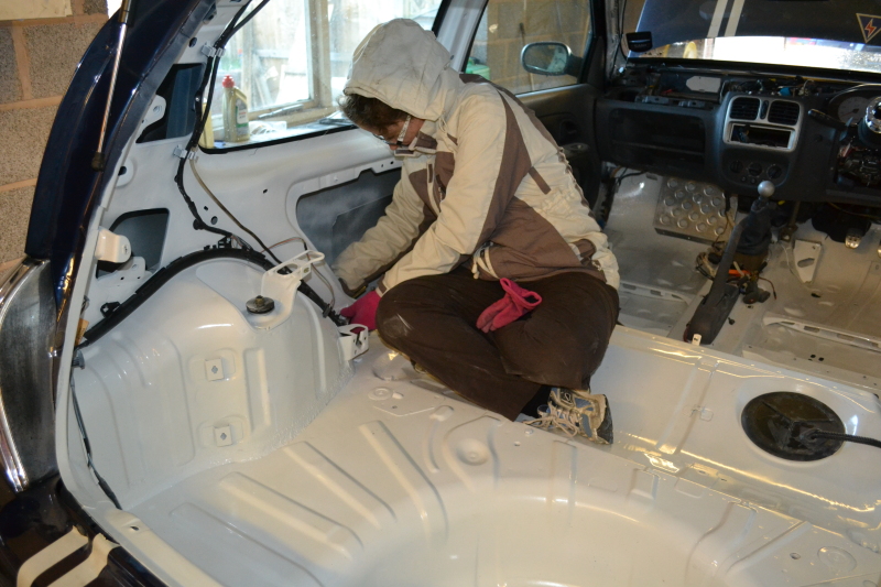

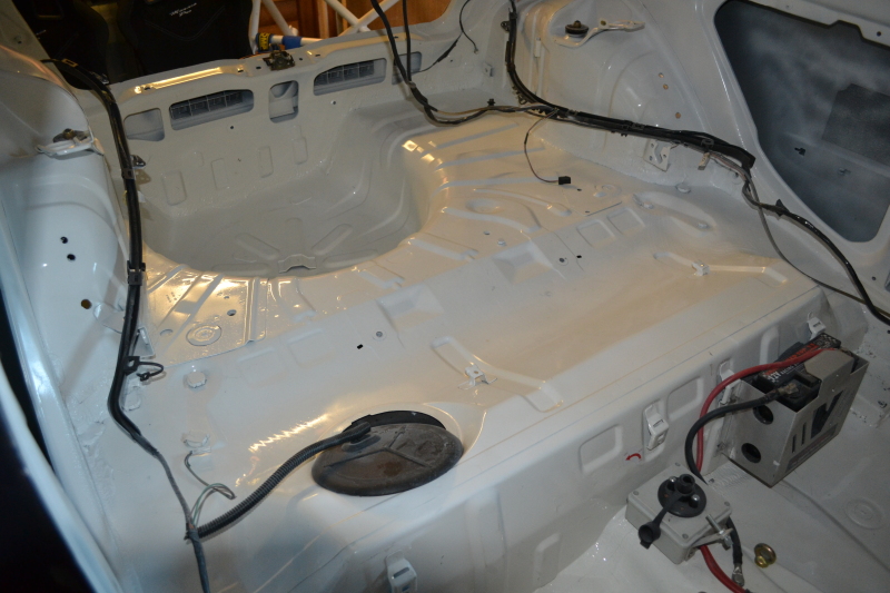

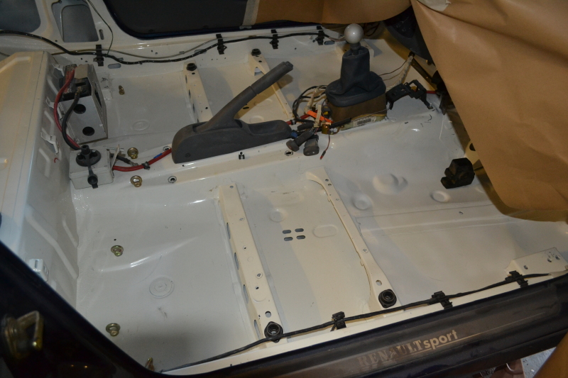

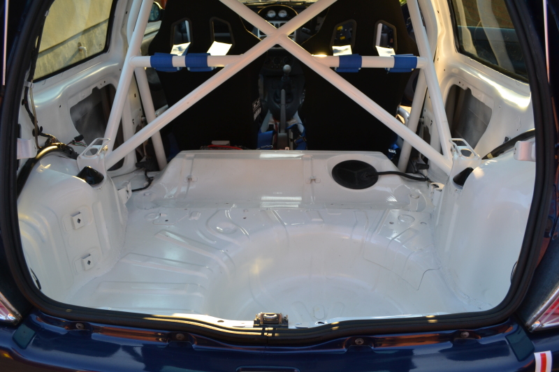

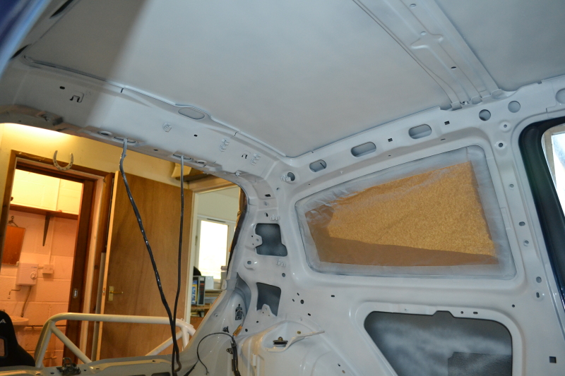

Decided to give the inside a bit of a refresh while the cage was out.
White interiors get messy quite quickly, a few coats of paint can make all the difference.
Even got the wife to help out a bit!

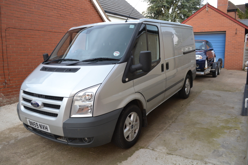

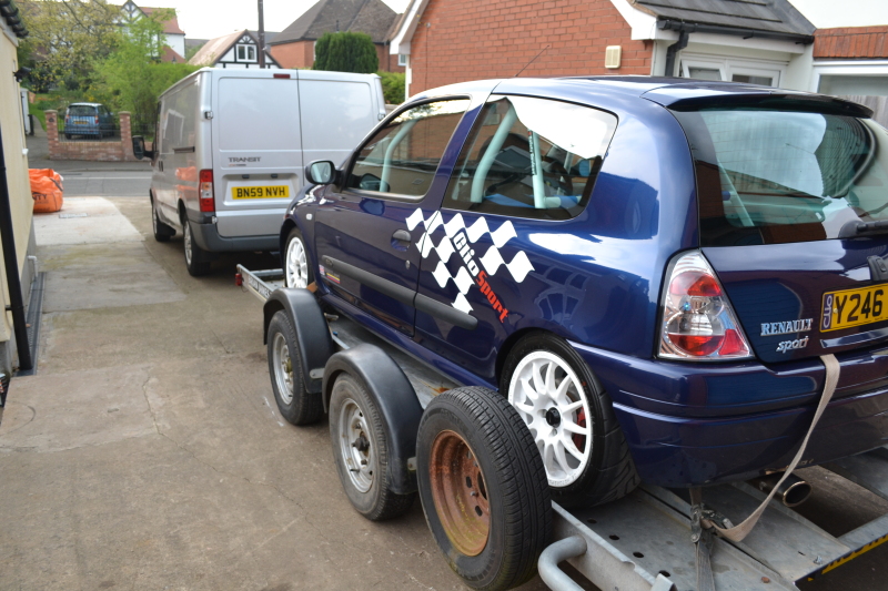

I have used a trailer in the past to tow the car around, but I was recently made aware of the law regarding towing. As I passed in 1999 I was just a little to late to have the B+E entitlement on my licence.
So today I passed my trailer test first time! So I can now legally tow the car around to track days etc.

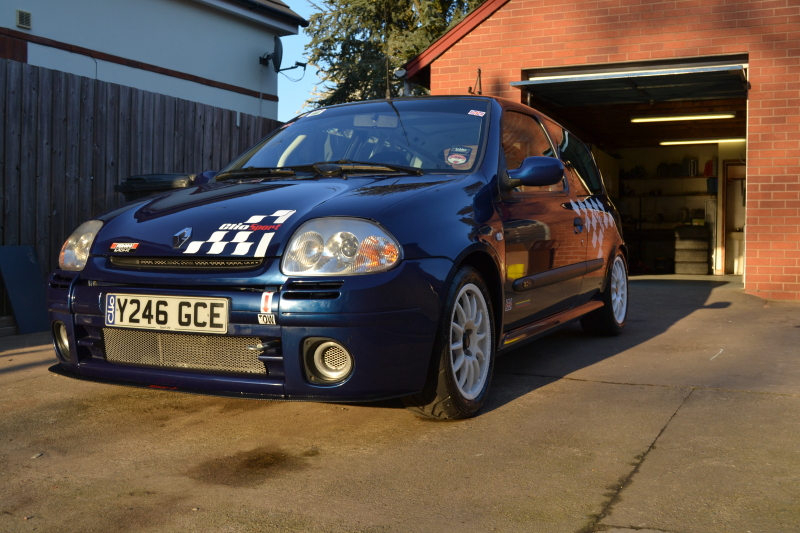

Car is all back together now ready for a few trackdays.
Really happy with the upgrades we have done to it especially the EPAS conversion which works a treat, and the PMS rear beam combined with the powerflex black series rear bushes tightens up the rear end a treat.

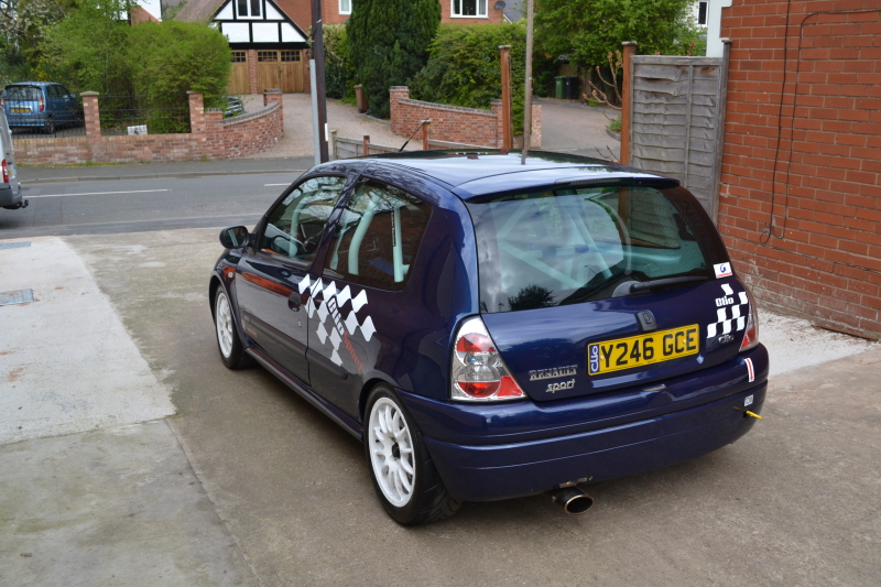

A few pics of it finished and ready to go.
