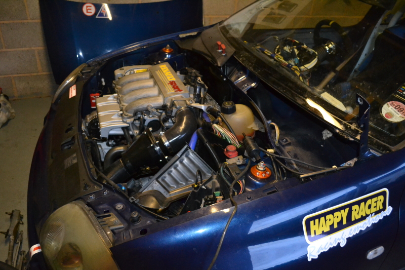

Thought I better update this. Been very busy recently and not had much time for the car, but with Silverstone round the corner I thought I better pull my finger out.
Even though I did really well at my first race at Donington - (much better than I expected to do). The main thing I noticed was a bit of a lack of pace down the straights.
I put this down to a few reason;-
1. Not carrying enough speed out of the corners due to my lack of talent.

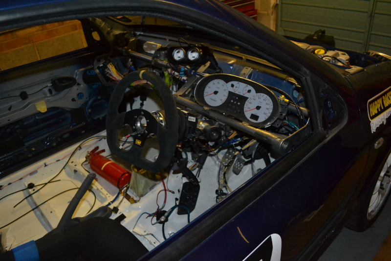

2. To much weight. Car still has elec mirrors, windows, central locking, standard door cards, wiring, etc.
3. Long gear ratio's. Car has standard Ph1 gear ratio's.
4. Not enough power. Engine is standard.
So I am setting about addressing points 1-3.
I am still going to leave the engine standard as I know if I start this it will be a slippery slope that my wallet can't take!
So I have removed the elec windows, mirrors and wiring. Also removed the standard door glass.
Poly carbonate windows to fit.
Bonnet removed as will be fitting alloy Ph1 bonnet.
And I am going to be removing the gearbox this weekend to fit a new CW+P and shorter 5th gear

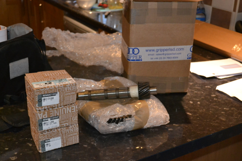

Picked up my gearbox from Martin at Agency yesterday.
Fully refurbed with new bearings, seals, syncro's etc. He also put a racing syncro on 3rd for me. I guess that is just a more heavy duty syncro ring as 3rd tends to get a lot of abuse on track.
Also had the gripper 4.60 CW+P installed along with 37/33 5th gear.
