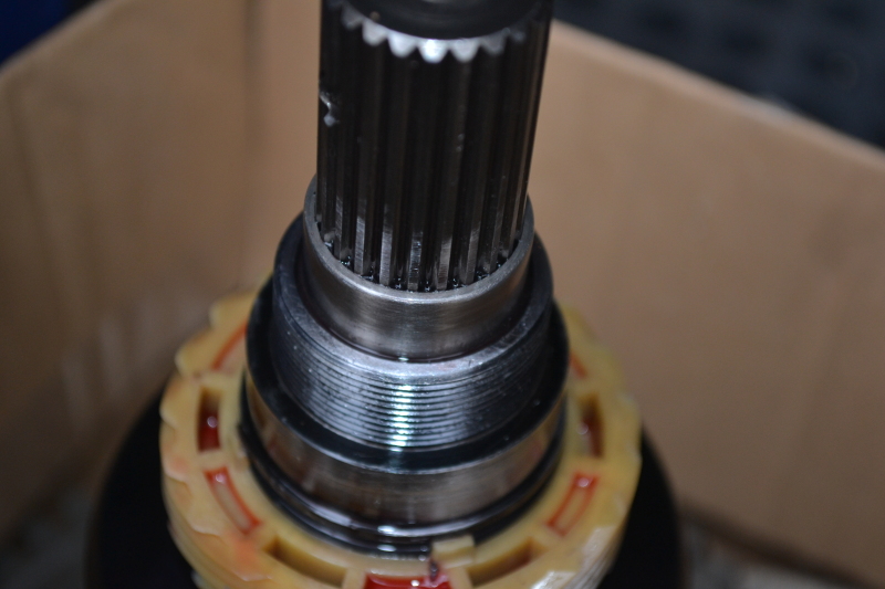

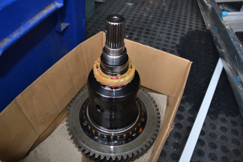

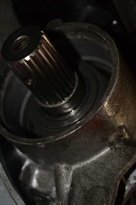

So I had noticed a patch of oil in the garage underneath the car. The car was basically parked up after Silverstone and left there.
It was gear oil and looked to be coming from the drivers side. I found this a bit strange as the gearbox had just been refurbed and shouldn't be leaking.
Changed the seal and it still leaked.
Long story short after messing around a fair bit it appears to be the gripper diff that is at fault. There is a sealing ring that goes over the splines and it appears to be leaking down the inside of some of the splines.
The top ring makes contact with the oil seal on the gearbox and it is locktited on at the factory. Not sure why it has started leaking now but I have the diff out of the car and will be making a trip to Coventry to tomorrow morning for them to put a new sealing ring on it.
Not a good situation to be in a few days before I am due to be racing.
Cheers mate.
No the O ring is really just a sort of dust shield. It's external to the gearbox so doesn't act as an oil seal at all. The only solution is to remove the old collar and fit a new one. Not a particularly difficult or expensive job, just annoying!

So just got back from gripper in Coventry. All I can say is what a helpful company they are.
Apparantly my diff was one of the last of the old design where the oil seal collar was glued onto the shaft. The glue tends 2 break down after a couple of years and so causes a leak.
I have had a complete new shaft fitted, the new shaft has a collar that is pressed on and so will never come off. The new shaft is normally £150+ VAT but as the diff has a lifetime warranty there was no charge for it :D
Also as the diff was to be taken apart they rebuilt it with new clutch plates and reset the preload for me. Essentially I now have a brand new diff and it only cost me a £65 labour charge.
Great customer service and a great product. All I need to do now is get the gearbox put back together, and then refit it to the car all by tomorrow morning! - I'm sure it will be fine!
