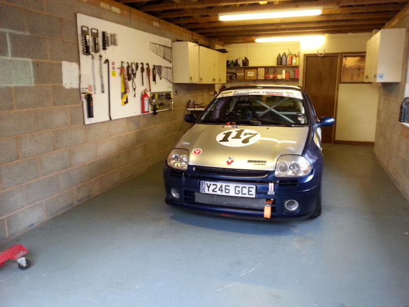

Tidied up the garage today and put the clio back to bed for a bit.
Not really got much planned for it really, which is probably a mistake when everyone else seems to be making upgrades.
I might get a better seat to hold in in place better, and maybe a higher spec cage. Nothing wrong with the one I have and it conforms to the regs. I am just thinking spending money on safety can never be a bad idea.

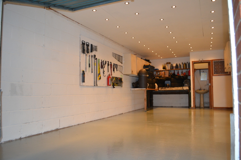

You could have put a few more spot on there mate :wink:

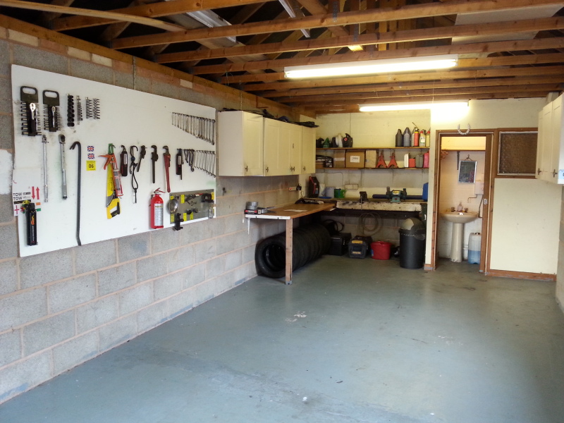

Do you rate those new LED downlight replacements?
Yep think there is over 40 of them in there!
LED spotlights are great if you get good ones, mains voltage ones are a simple retro fit into existing units as well. It's just low voltage where you need specific LED drivers.

it depends which ones you get. We have various ones around the house dependant on the room and the ambience desired. You can get various temperatures and either clear or opaque lenses which can soften the light. LED bulbs are better by far imo

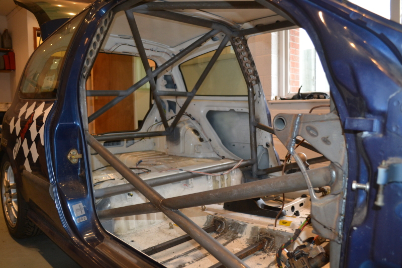

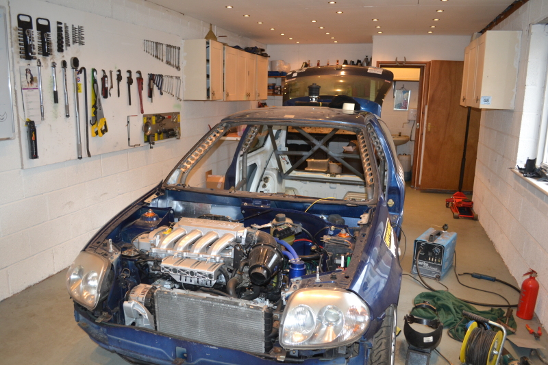

It's been a while since I have done anything to the car, in fact I haven't really touched it since Oulton last year.
I thought I better take a look at the old girl make sure everything is ok.

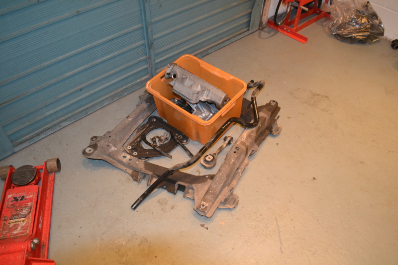

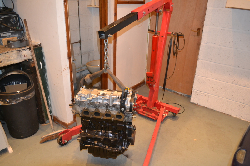

Engine and gearbox out for a bit of a check over.

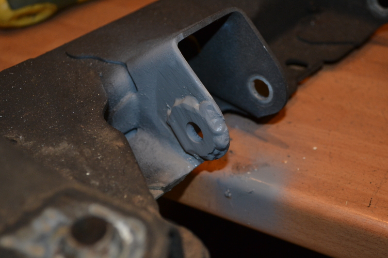

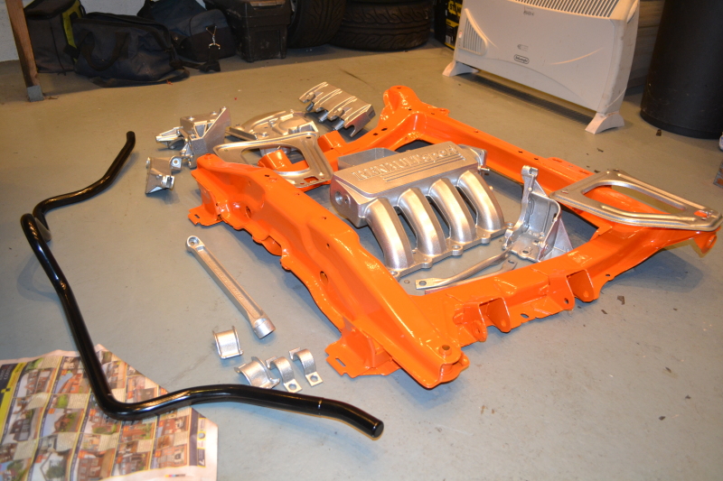

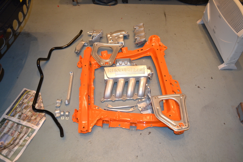

I got hold of a cup spec subframe (slightly wider track), this is being sent off for powder coating along with a few other brackets etc.

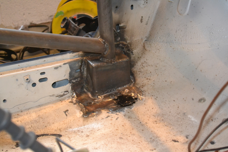

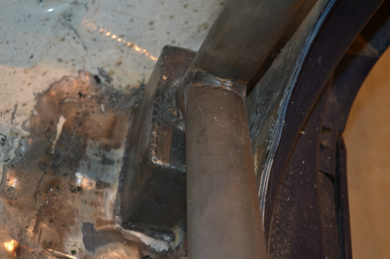

Decided to weld in some strengthening top hat washers first as the rear holes for the wishbones had worn, not my best welding as the gas was running out, but it will do fine. Not sure if the subframes come this way from the factory or not, but every subframe I've ever seen seems to have this issue with the rear hole being oversized.

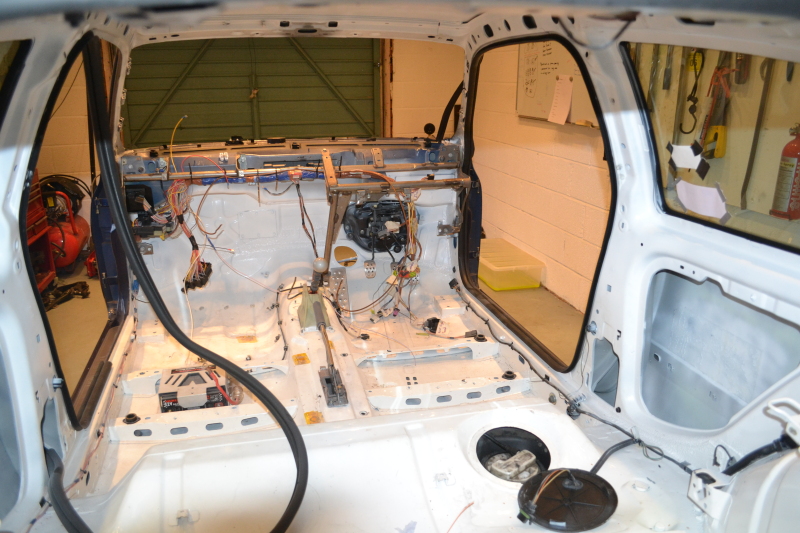

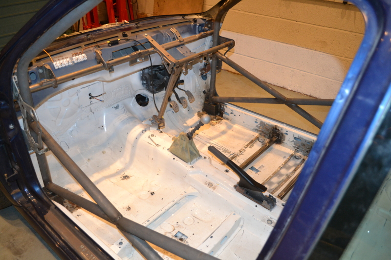

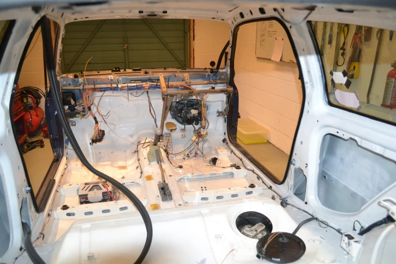

Also decided to remove the heater as I will be fitting a heated front screen instead.

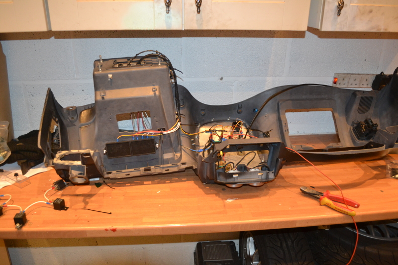

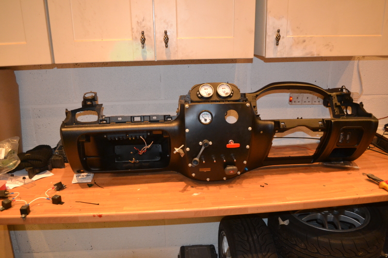

Remaking the dash with a some new gauges and switches.

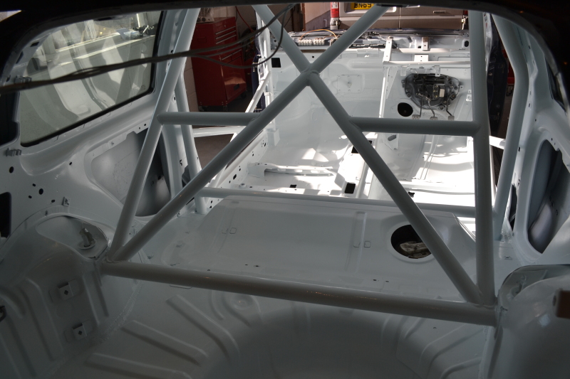

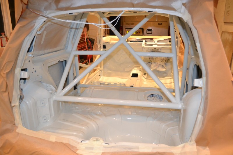

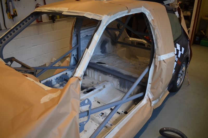

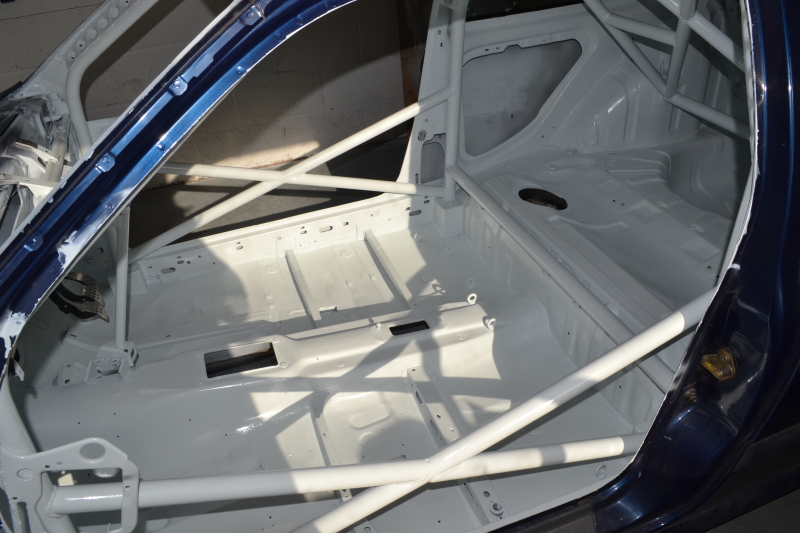

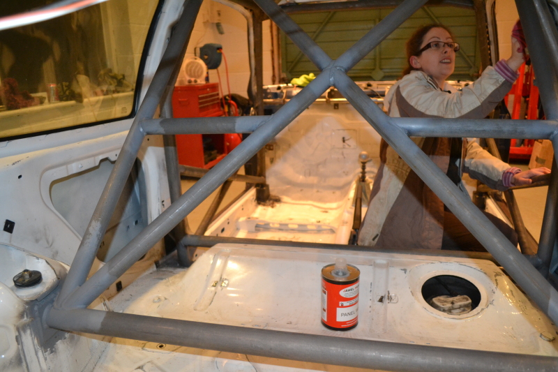

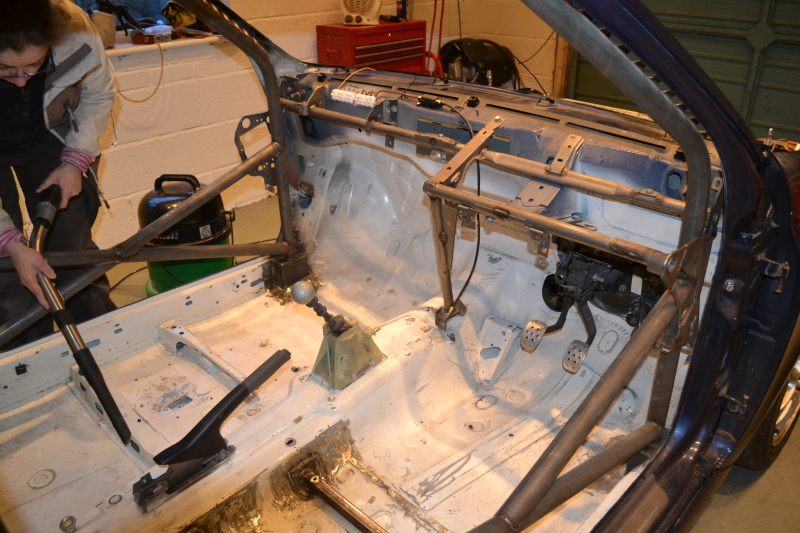

Rubbing down, cleaning and prepping ready for paint.
Got the wife to help out again with some of the prep work.

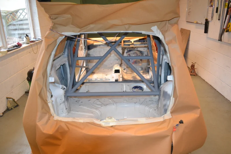

Masked off and ready to go!

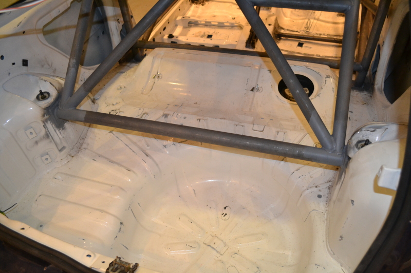

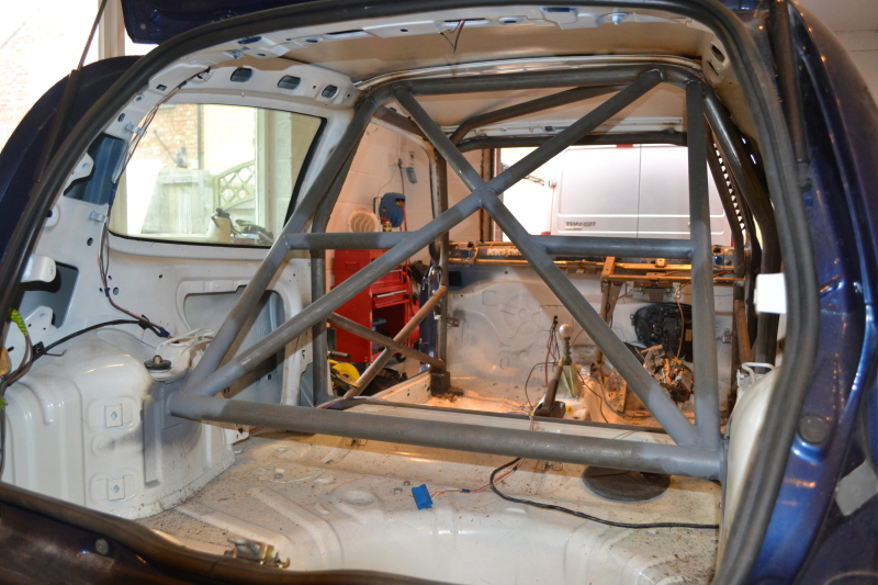

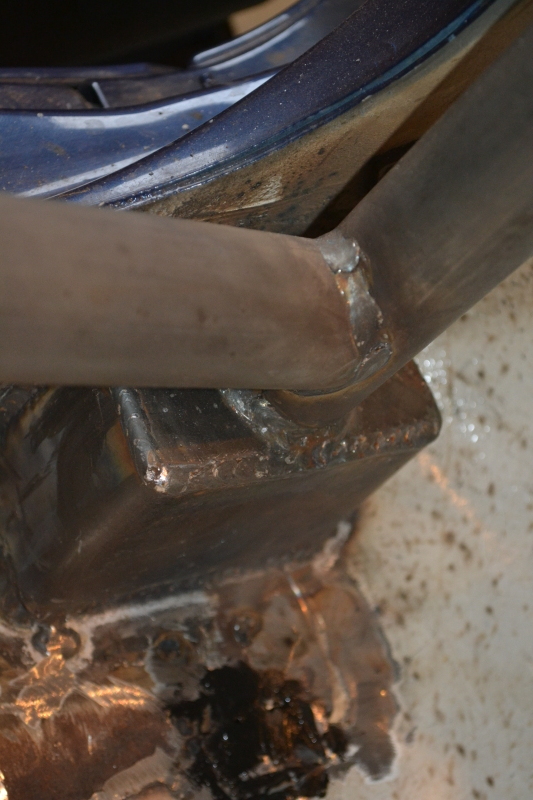

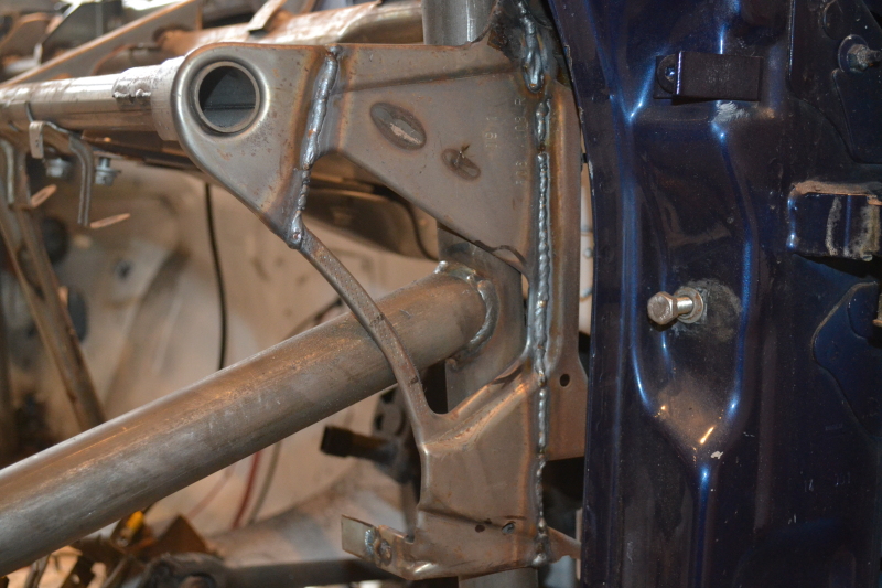

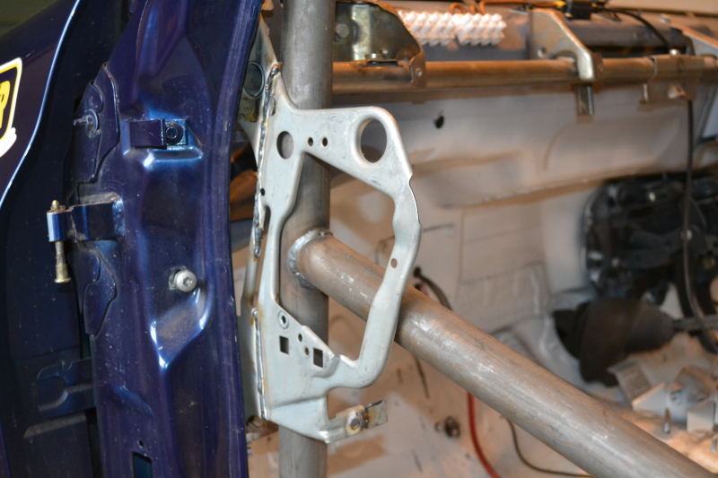

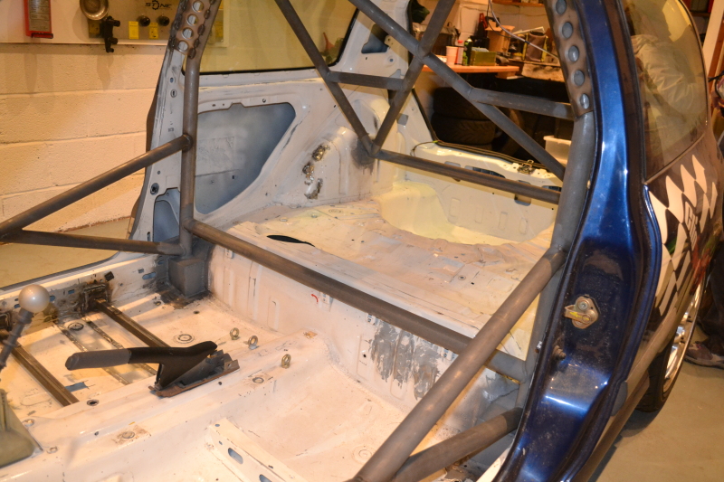

Looking good james, what cage is it out of interest?
Russ

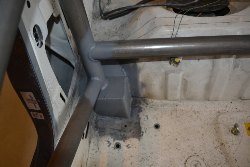

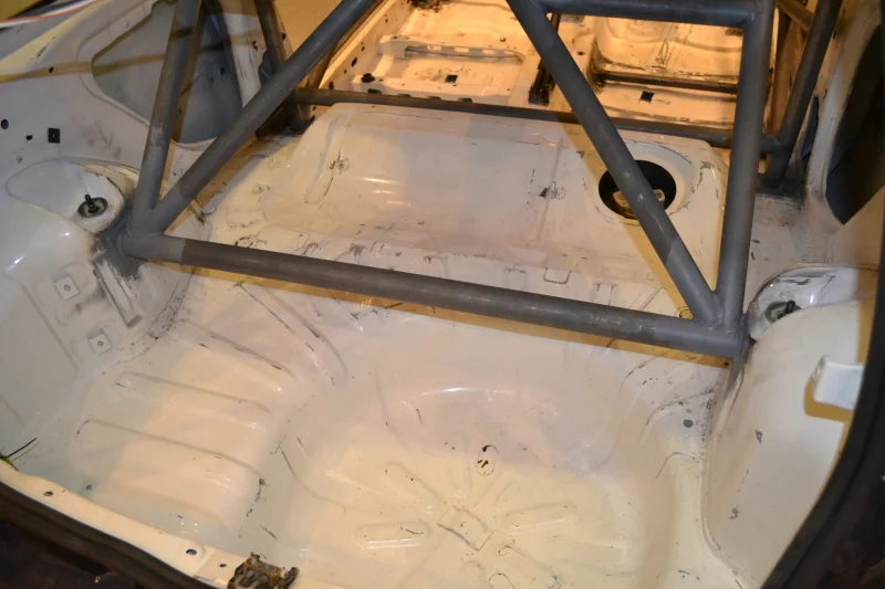

It's a complete custom job Russ, built to fit the car. It's done to msa regs and a bit beyond!
The SD cage was a good cage as bolt in dash dodger cages go. But I wanted something a bit safer, and one that was also tied into the cars shell.

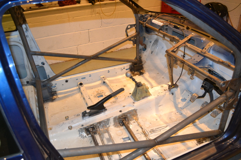

What with the handbrake? you going drifting?, lol
Cheers Dave. Believe it or not the car is still road legal and still has a valid mot!
I did think about ditching the handbrake, but for the sake of about 1/2kg I thought I would keep it. Anyway it will be handy when I am starting at the back of the grid at Oulton on the slope!

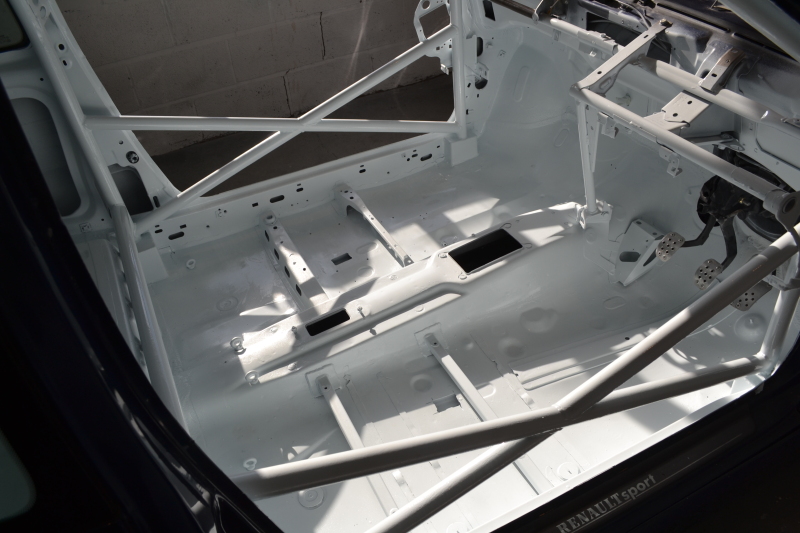

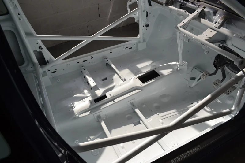

What did you use to spray the inside, was it rattle can, or proper spray gun job?
Just finished reading through and i'm really jealous :smile:
Cheers mate.
It was a proper spray job with 2k Ford Frozen White.
Did it myself, first time I have had a go at spraying and the finish is pretty good to be honest :smile:
Ph1 Tom
2 coats! More weight lol.
Looks good but I just couldn't live with white due to cleaning. I'd have gone for a silver/grey personally.
