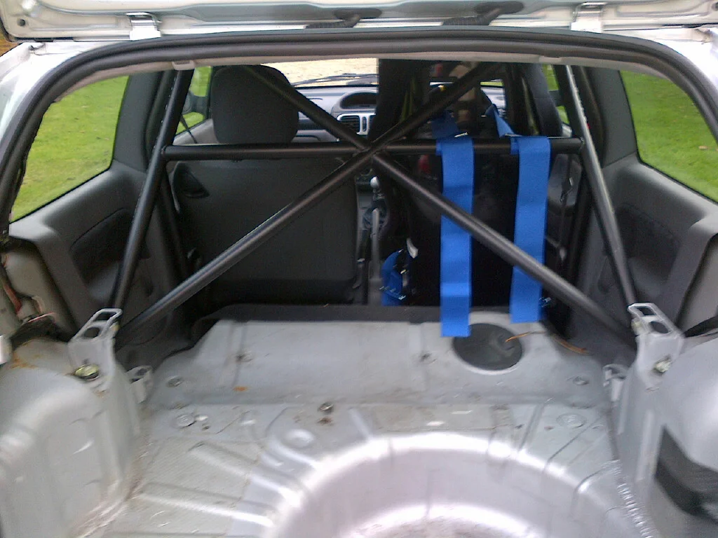

I bought this just before christmas, especialy for track days. Had a few goodies on it allready, but has now been caged and setup by Mark Fish.

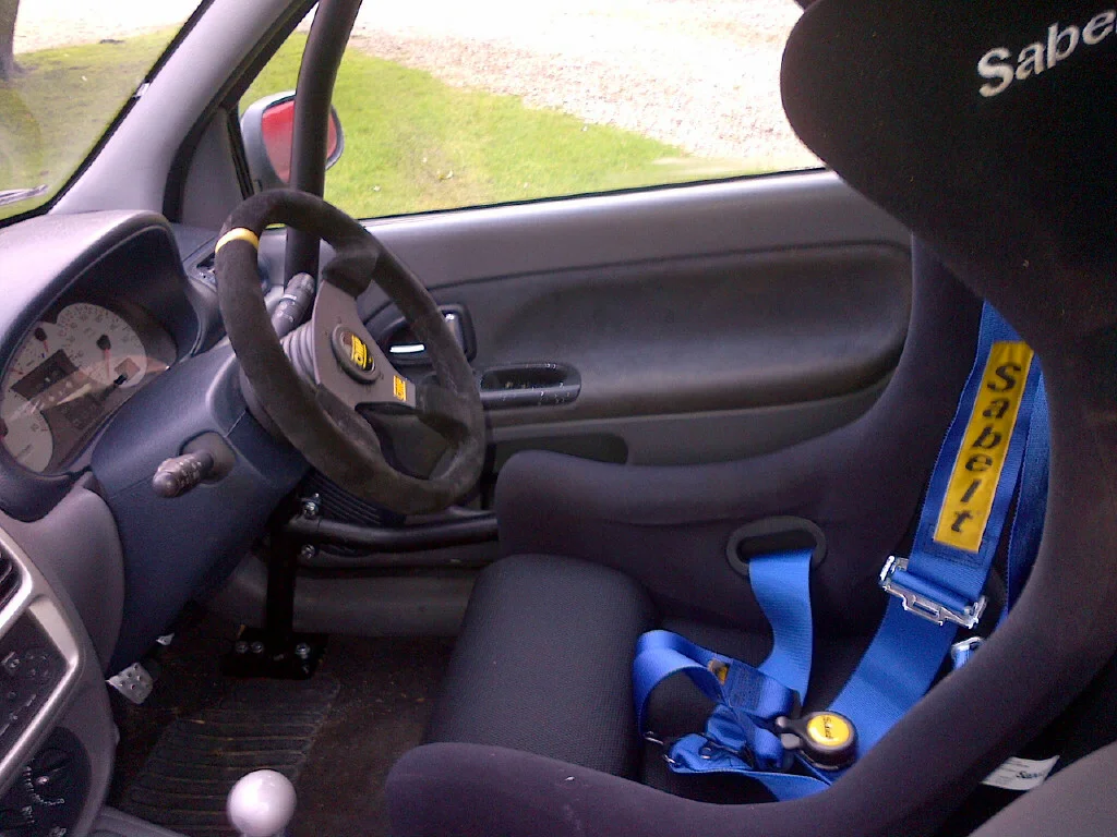

Yet to get on track, but otherwise it's a riot to drive. Think I may have made a bit of a mistake with the seat, comfortable, but visibilty isn't great!

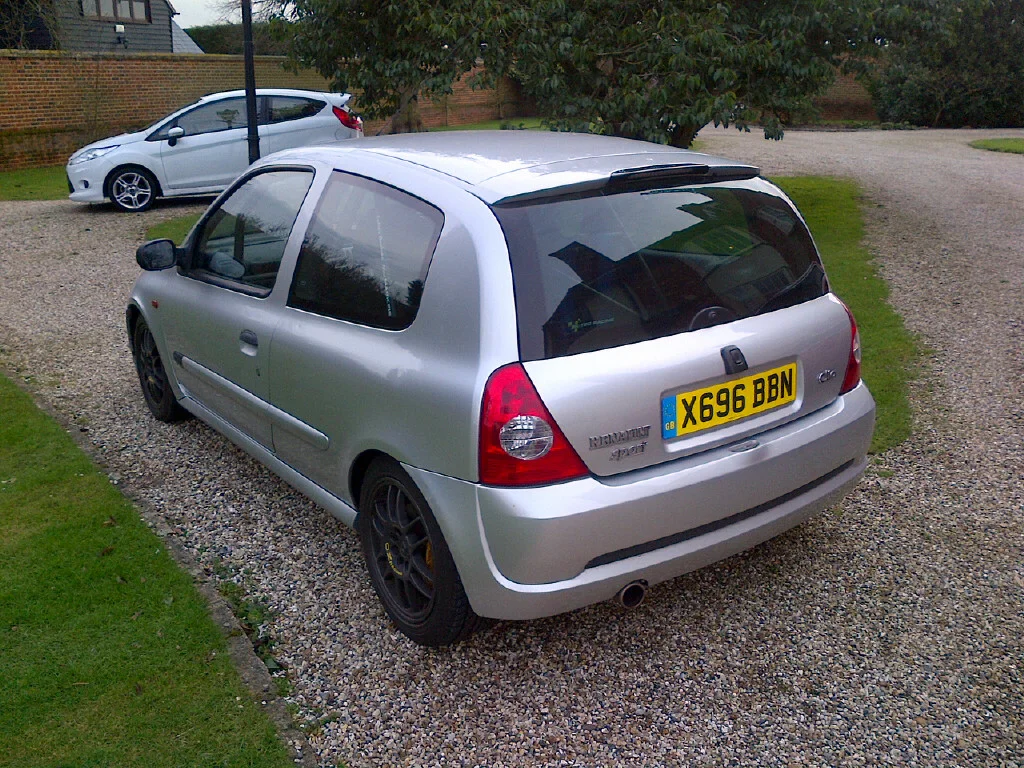

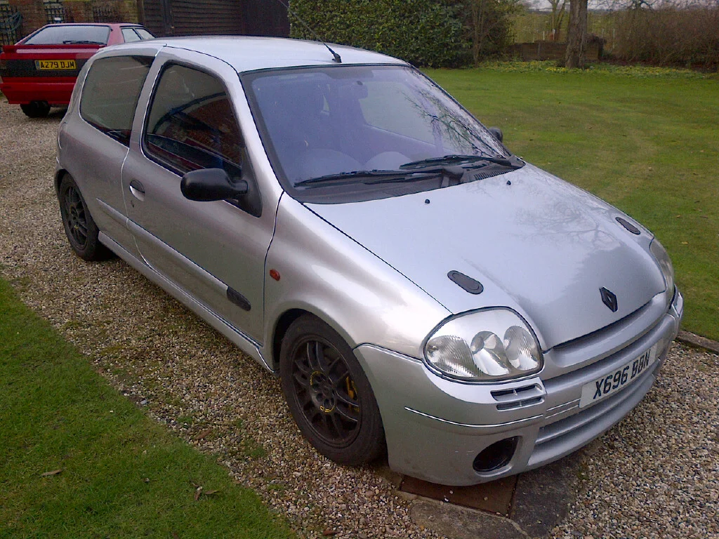

Looks like a decent start,
Not fan of ph2 rear on ph1, but I'm a bit of a purist.
Definitely needs some more strippage if its just for track :)

Thanks. Came with Ph2 rear end when I bought it.
Quite like it, almost wonder what ph1 lights and the ph2 rear bumper would look like?

Can't see how harness or seat would be a propblem, all bolted down to the floor with spreader plates etc.

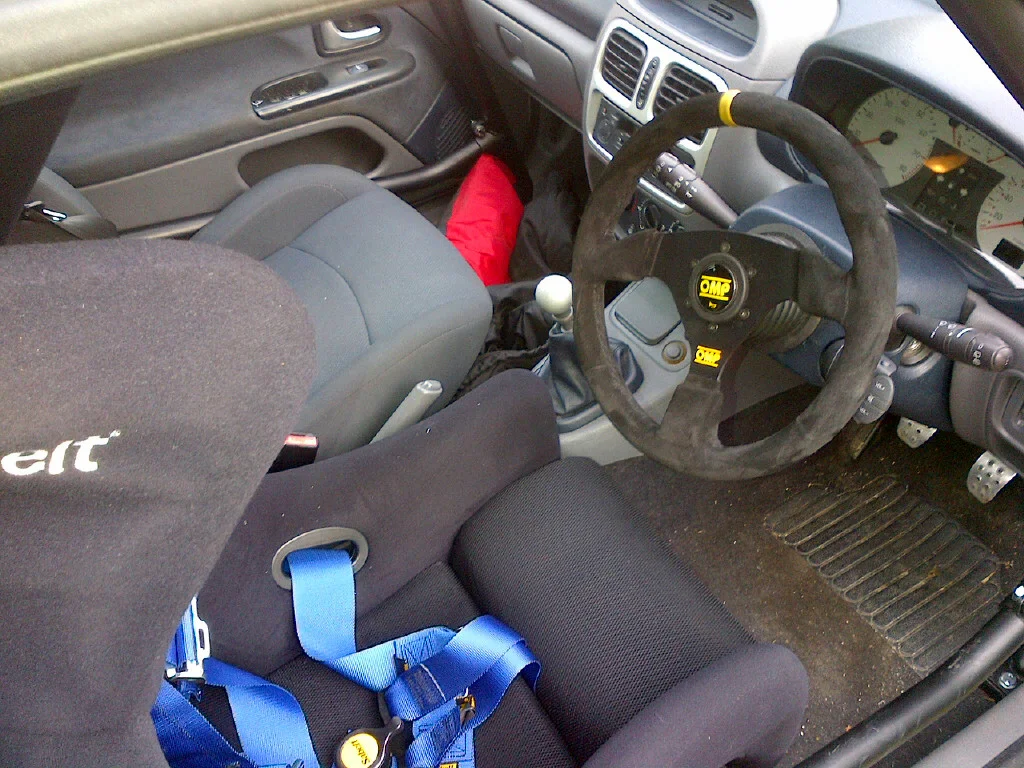

Get rid or that standard passenger seat for something more lightweight!

Fitted the Sabelt Titan without head reastraints, and it's perfect! Have another one on it's way to replace the standard passenger seat.
