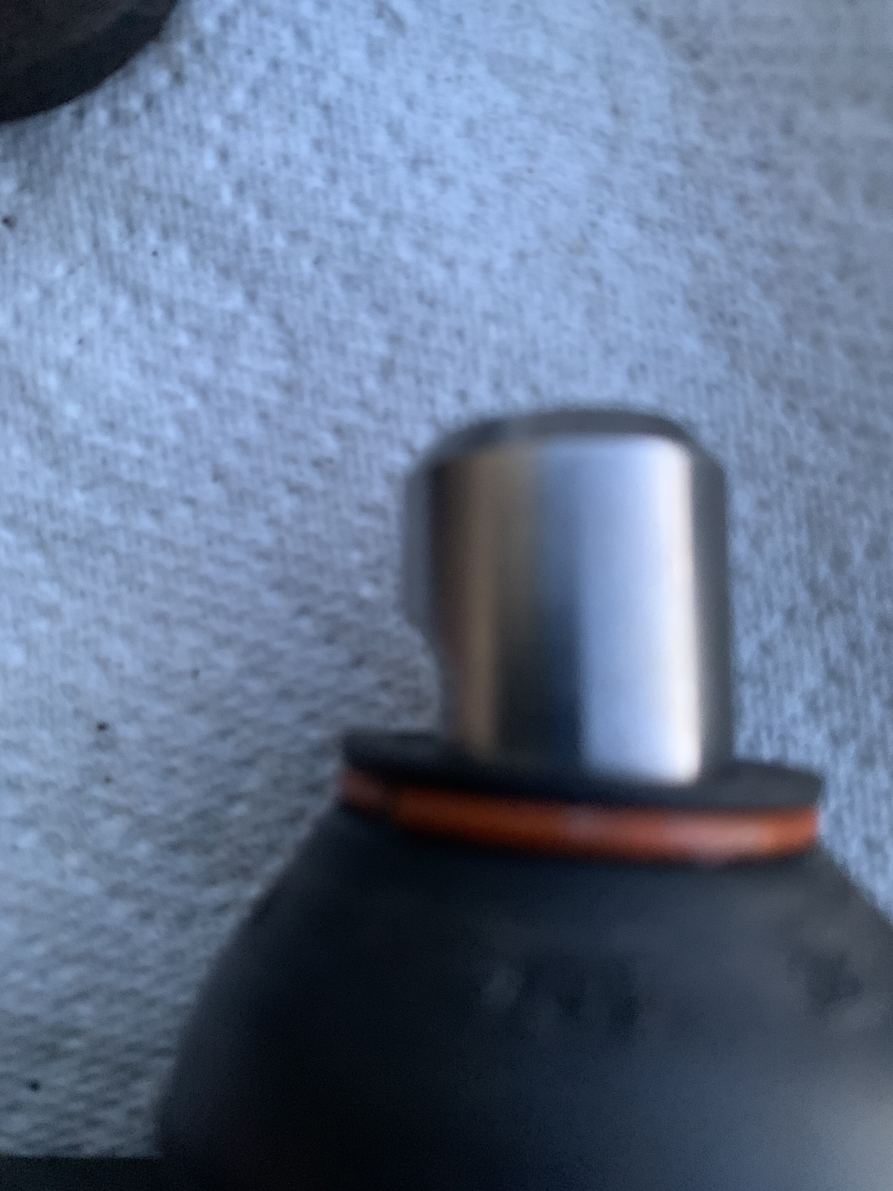

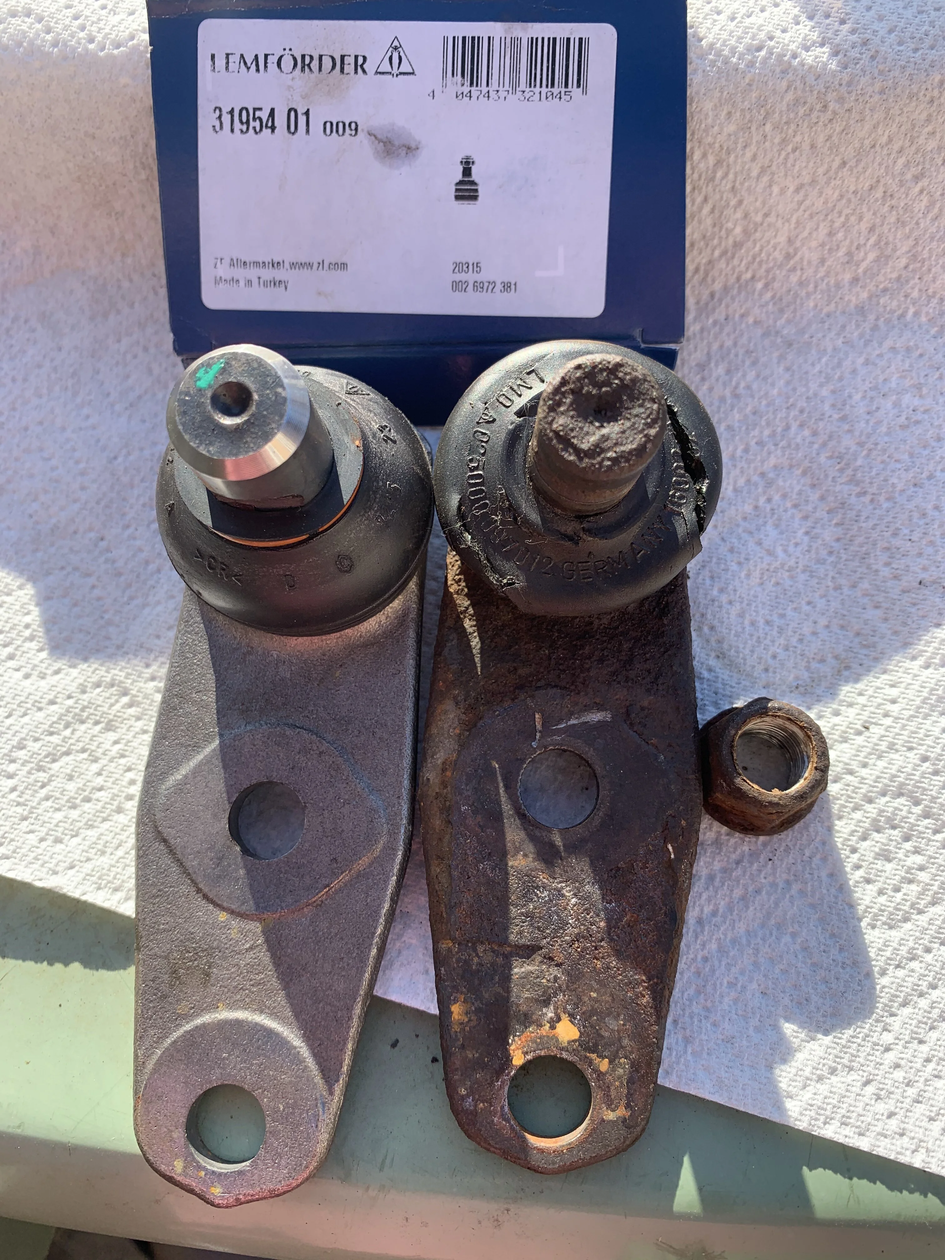

On removing the old one it quickly became obvious the stud that goes into the hub was about 15mm on the old one and 18mm on the new one.
Any ideas, as the ECP / GSF websites aren’t sufficiently detailed to give all dimensions.
It’s ‘just’ that the diameter of the stud is too big.
As it’s a fairly early phase 2 is there a weird crossover in parts?
same size for all mk2 clio sports.
lemforder part no 28892 03 if you buy the above from euro
Thanks for that, just ordered one from ECP (the ECP part ref is 617745225).
However that option doesn’t come up either with my reg number or when you manually select a 2002 172, so there’s definitely a glitch in their database.
