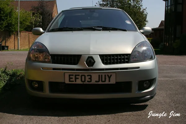

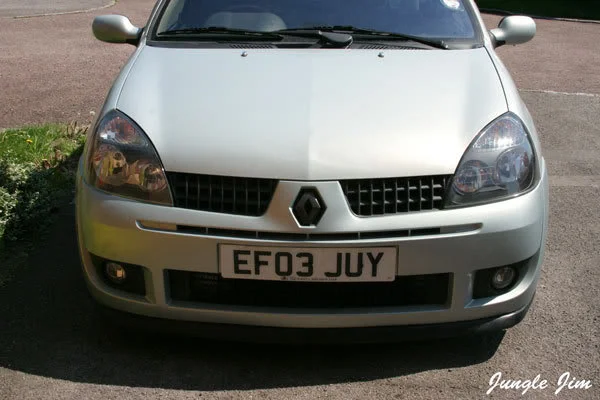

  Suzuki Ignis Sport
JungleJim did it... ^^

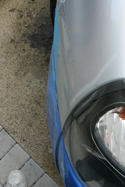

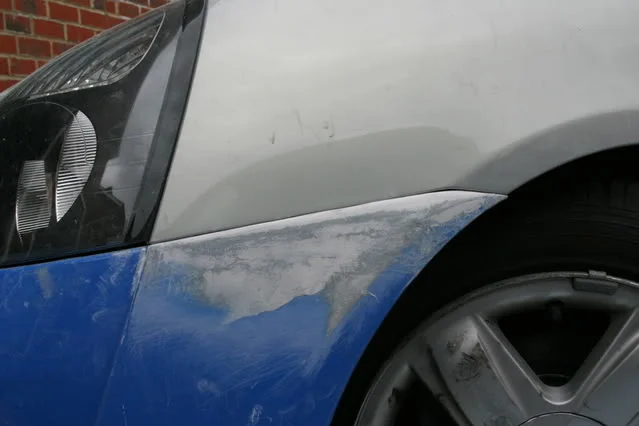

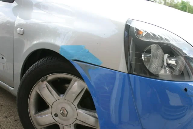

i then started to custom fit a 182 front bumper to the standard wings, along with a meggy splitter.

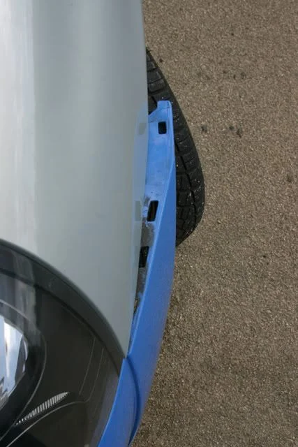

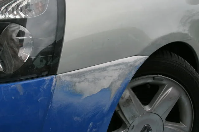

before adjusting bumper brackets
after adjustment

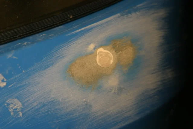

i smoothed out the washer jet holes

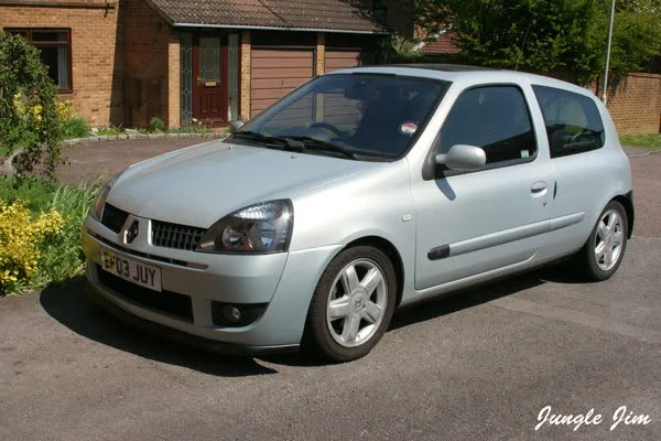

after a bit of fibreglass work and some filler i got a decent fit
front end done :) (door handles not painted)
