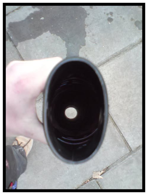

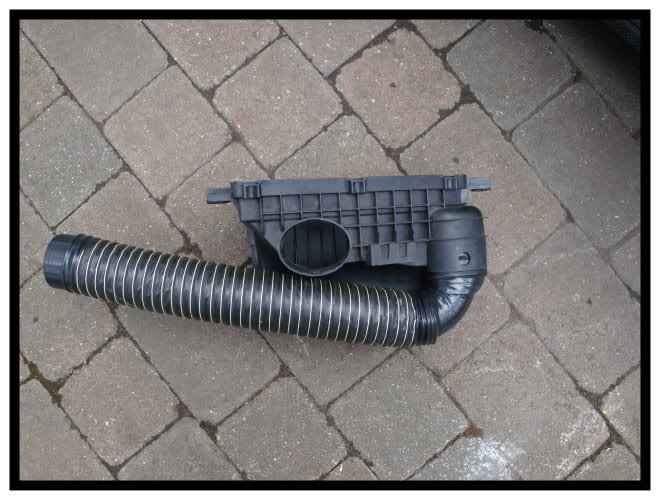

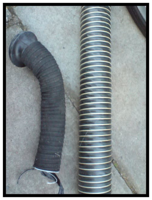

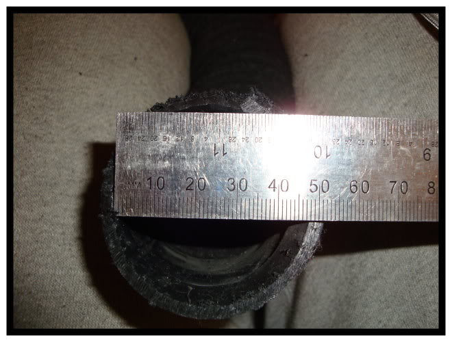

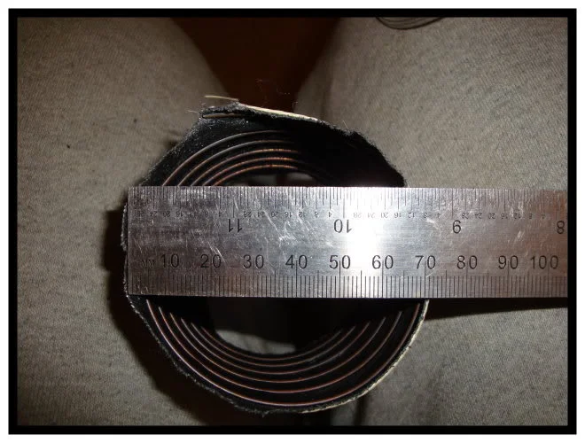

So standard caf along side the new 70mm

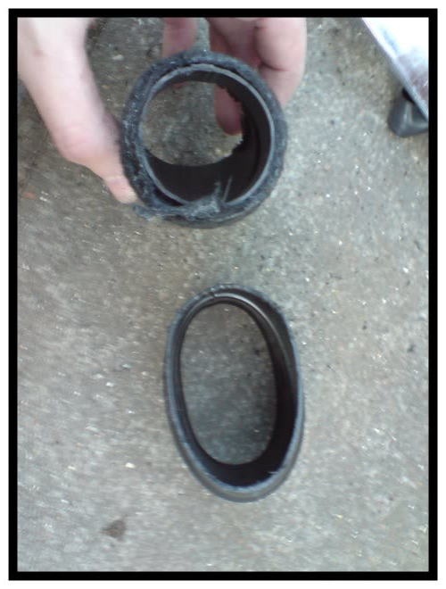

As you can see the standard feed is tiny, so this is where the first issue occurs but is easily fixed by abit of chopping cutting, the actual hole from the airbox is 70mm but it gets reduced to under 50mm for some reason, can only think because of space issue, as you can see in the pic below, the right hand side is what clips into the airbox then the piece on the left hand said is the "reducer" that i cut off

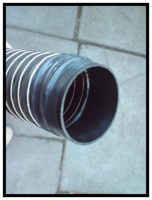

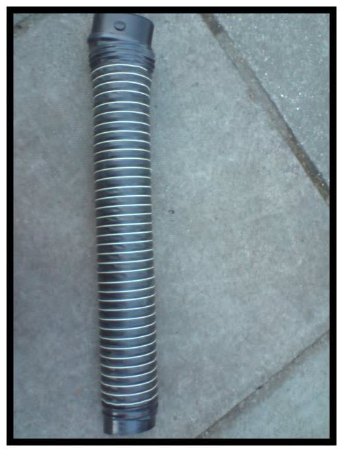

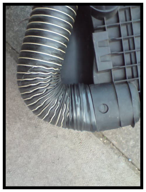

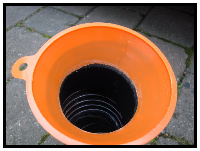

So then i got my new CAF & used duct sealing tape from a pipe fitter at work & attached the clips so it was a simple plug and play when removing for serviceing/work on the car
And attached an end to clean it up
Nice & tidy inside

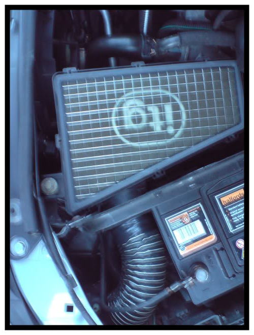

Then finnaly it was a case of cutting up the other standard feed ( one that connects to the acoustic valve ) & fitting, i ran this down to the wheel arch in this pic
But i have now shortend the wheel arch cold airfeed to rougly 6", so it now just runs straight out of the airbox & stops - no bends, the reason for this you ask? well i did 30 minutes of spirited driving & although the engine bay was red hot all the metal round by the batterey was stone cold so the less bends the better in my opinon & since its cold enough there & the fact the ITG maxogan gets it feed from there i cant see it being a problem
