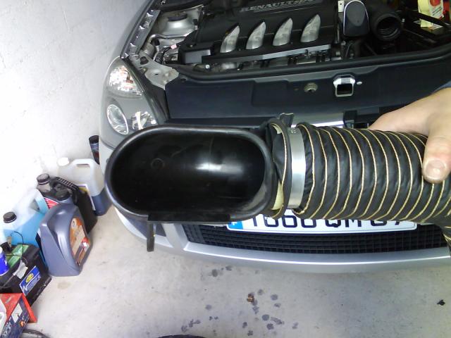

About CAF, look at what I found on a Meggy mk1 :
It's the perfect caf :)

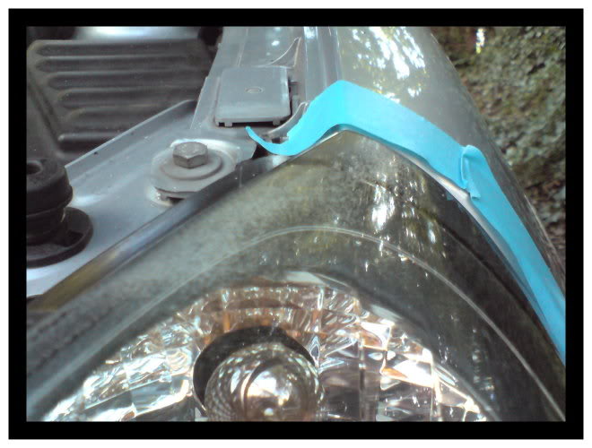

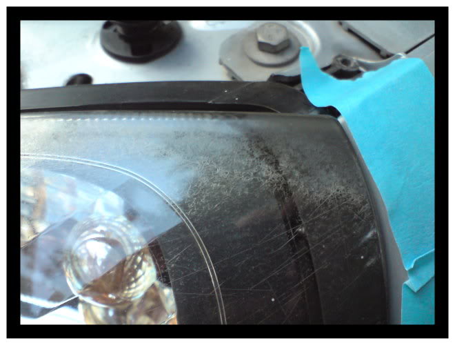

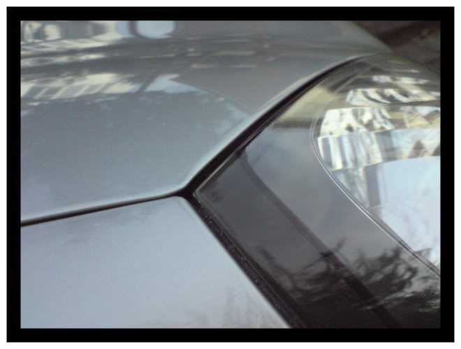

So finnaly decided to tackle the the nasty mess on the top of the lights today, only real flaw my 172 has & i sure wasnt gonna leave it that way! seems a few Ph2 172/182 suffer from this.. anyway heres what the lights looked like this morning after they were cleanned

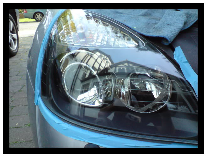

So hit the both head lights with various grades of wet & dry sand paper then brought the shine back with my trusty Megs G220 & various polishs...
So 2 hours later...
And a nice reflection shot :cool:

MoRpH3uS, the cold air duct form the meggy looks good mate, handy for getting to the lower grill.. but! wait to see what i have in mind, will hopefully have it put together within the next few weeks ;)

James ! I didn't know that you knew wetstanding, G220, and plastic reconstruction (lol)...
I even see Meg #80 and #83 on the picture ;)
Very good work mate, I've tried that with Meguiar's Plastix on my headlights, didn't work too well... I'll have to try out with the Makita :cool:
Thx for the meggy cold air duct I just need to fix it a little better and that's it :)

what grades of wet and dry paper did you use on the headlights before polishing them back up? my headlights have the same marks as yours. thanks

greenalex90, Started on 1000 grit then ended up on around 2000 grit, some parts didnt even see lower than 1800 as it just wasnt needed it, make sure you have a good polisher & polish's, there is no chance of you restoring them purely by hand..

No worrys mate ;) , Its tough cutting back through the plastic so dont go mad with the wet & dry lol

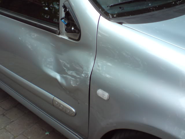

Big change of plans since having some one smash into my 172 -
:dead::dead::dead:
Luckily he has admitted it all & its all getting sorted, but something crossed my mind that i never really took into account... what would happen if i wrote this off on the track, probarbly be seriously fooked & no insurance to fall back on so could be tears... well the would to be run around PH1 is now going to be the track weapon, with the full strip out :evil:

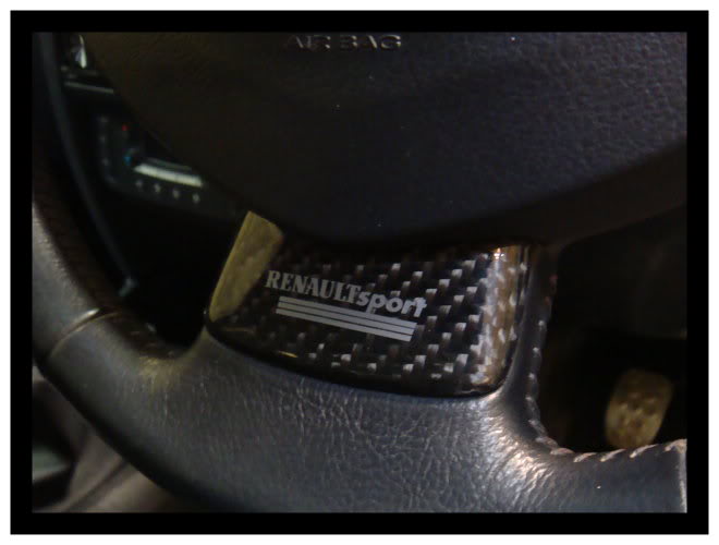

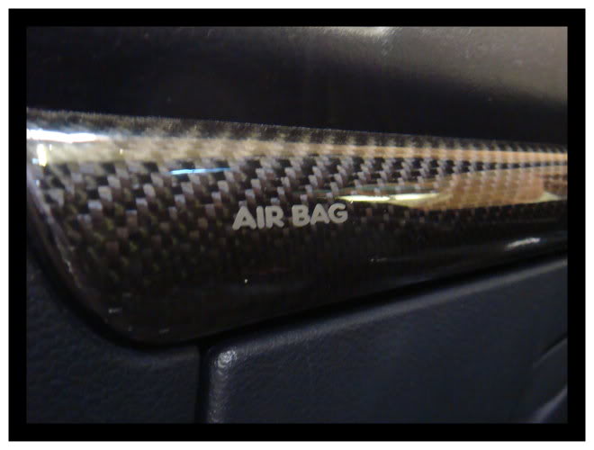

Next on the list was to add the finishing touch to the carbon bits, so got into gear & ordered some stickers from N2grafix, very happy with the results, top work guys!
