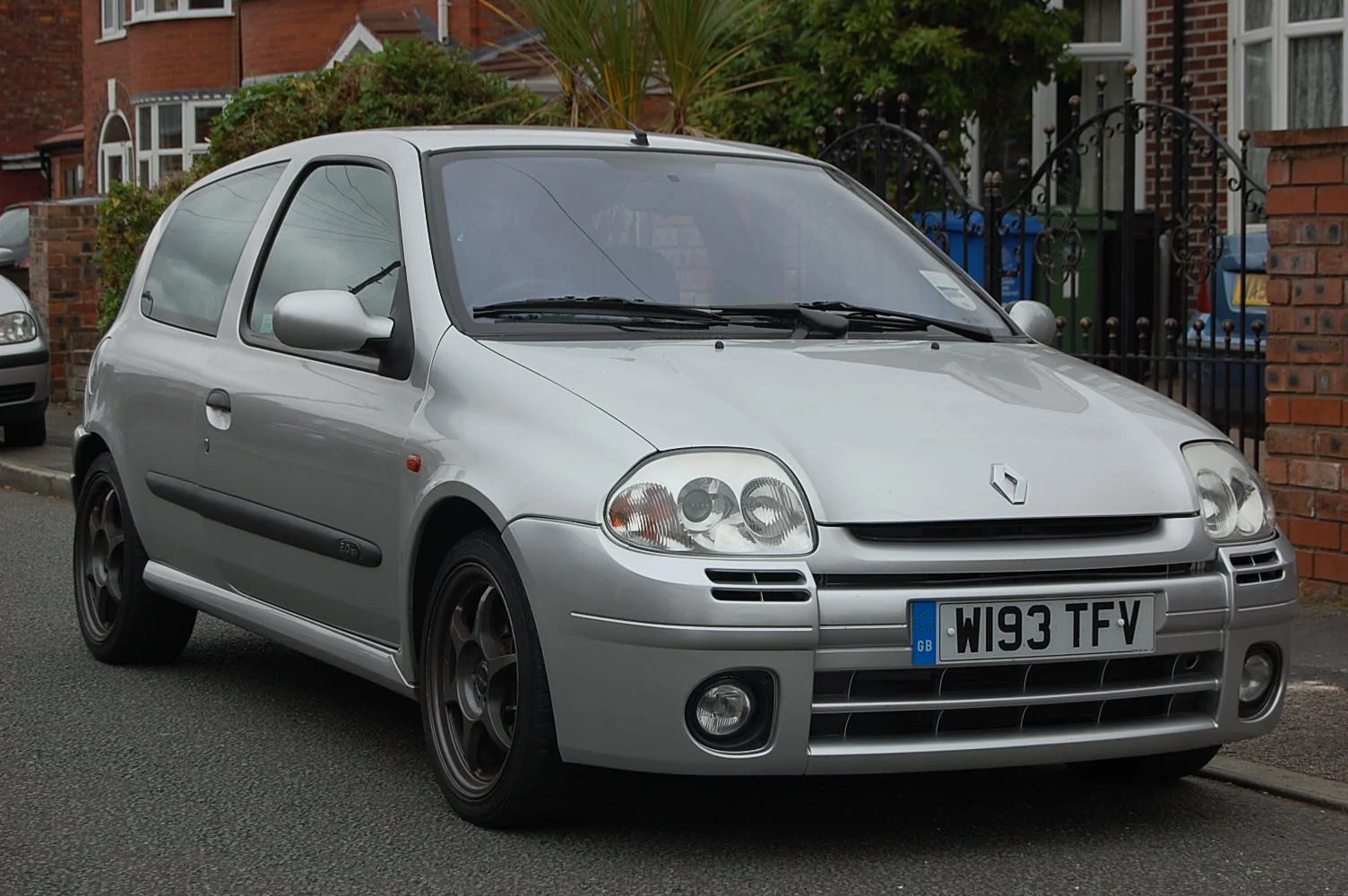

I have started to work on my car for next years motorsport season so I have started a blog, theres not much in it but all that will change over the next few weeks.
If you dont know what hills and sprints are I will put something in the blog when I get time.
One thing I have noticed is alot of peeps seem to be buying these for track work especially silver ones, so not to spoil the party so's mine :)
http://w193tfvhillclimbcar.blogspot.com

Most Ph1's are silver!
Ah that will be why then! Sort of stumbled on a phase 1 as I was after a cup but then realised I would be removing the aircon abs and most of the trim so saved myself a grand or so and will end up with a lighter car.

Added a bit more info to the blog and lots more coming as I am splashing plenty of cash at the moment ;)

according to my records it's a 4.83, bolt on. I had the box built with the gripper for my hillclimb car and blew the box after 10 miles, it's sat in the garage where I threw it in disgust.

We used to run a gripper diff in a 5 speed dog box, and we lunched the diff twice, the 2nd time it broke up and found its way into the bellhousing, which munched a twin plate paddle clutch and billet flywheel:mad: All of which are also sat in the back on the garage after being thrown there!

yeah, the complete box is there.
Competed in the National rounds at Gurston, Prescott, Loton, Shelsley, and Harewood, plus the odd pot hunting expedition to Curborough. It's a Mod Prod Saloon.

Anyone else using these diff's had problems with them?
Don't want to spend 2k on a duff product that's going to take the box with it!

How long ago was this as I have been told the early ones suffered with poor quality control which has now been resolved !?
2006, as far as I know the diff was Ok, just the box grenaded. If you're interested in buying I think I'd like to return the box to Coventry to have the experts strip and inspect it, then go from there.

Oh ! Any idea what or where I can find info on gearbox ratios and final drives for an early phase 1 box.

Small update with event dates and a few more mods.
Cage going in this week I will update when finished.

ECU relocation looks very neat, good job

Re ecu didn't think that moving it under the seat was worth all the hassle/gain.
Also thought it may pose problems at scruteneering as negative for battery would have to loop out from under seat, just need to fit a yellow cable around airfeed pipes so it's easy to find.

But I have just fitted a used K-tec stealth for the time being.

Blog updated with Safety Devices rear cage and APD matched inlets.
1st event on saturday at Cadwell park, cant wait!
