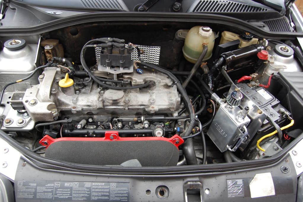

In march this year I took the car to BTB to have a new system fitted which was a 182 cat modded to the same diameter pipe as the rest of exhaust and their stealth system as people have said they are very high quality and sound great !!

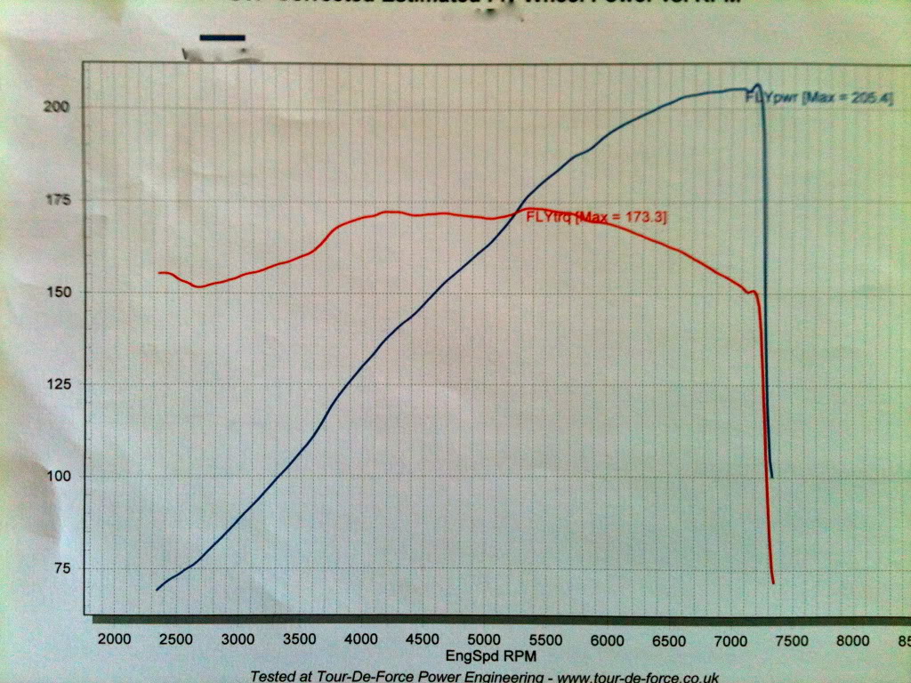

I then dropped the car off at TDF to have the AT power ITB kit and EC1 ecu fitted as I needed to keep the slam panel for the class we run in it was the short intake pipe version.
Matt did a mega job on the mapping which on an otherwise standard engine made 205hp and 173lbft torque :clap:
I think this is the best he had (has?) seen.
See map and install pics below, I fitted the heat shield and catch tank to comply with the hillclimb regs.
