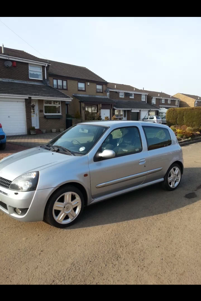

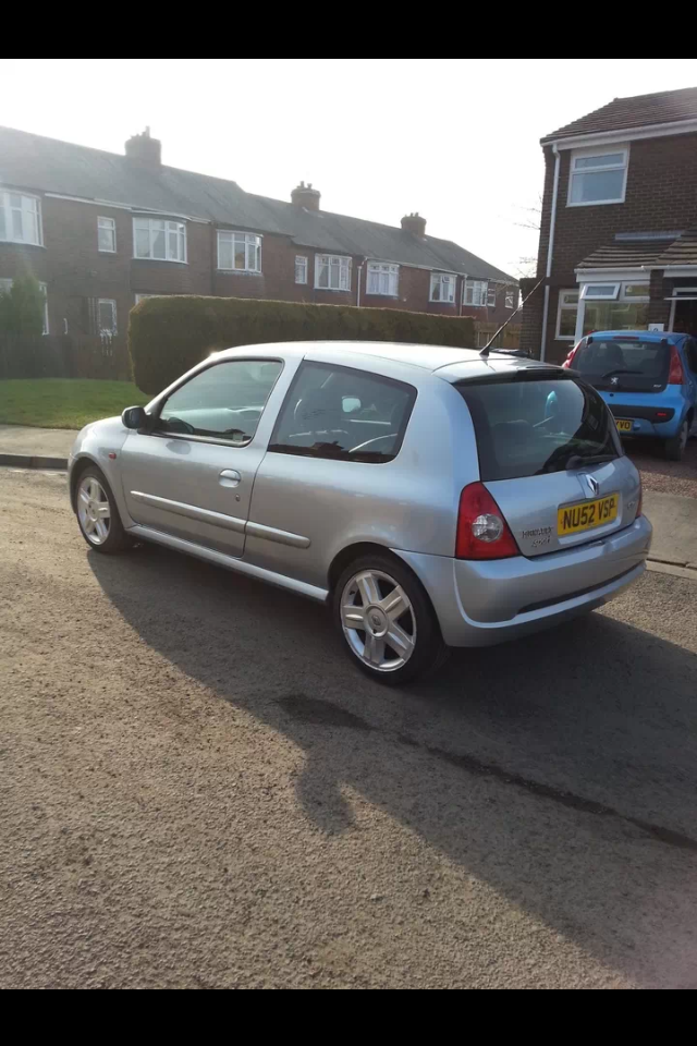

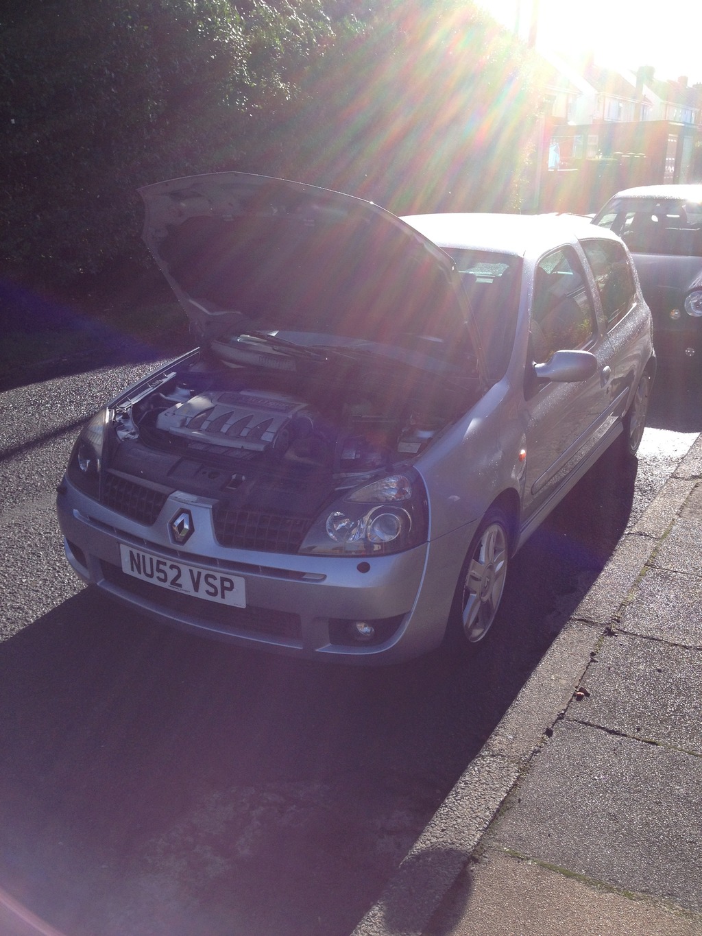

Here are a few pictures from the day we picked her up. Apologise for the poor iphone pictures.

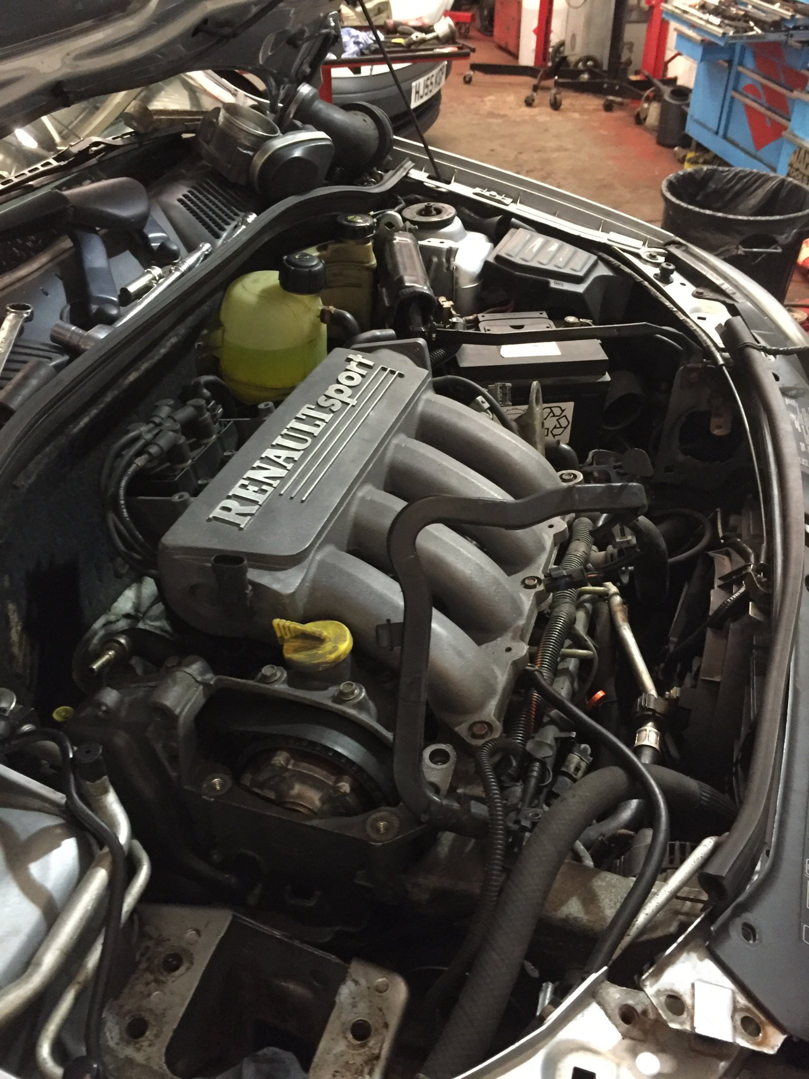

Car was overall in good condition had not been abused and was totally standard. Owned from new by a friend of the missus and had been parked up for around 5 months due to the purchase of a new vehicle. The brakes were in a terrible state and there was no record of belts or dephaser ever been changed. Managed to get her for a cracking price to be fair.

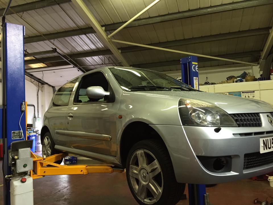

Next job was to drive her straight to the garage where the work would really begin. Luckily we have a very good friend who is a renault master tech and owns his own business. Deal was done and now there were three of us involved.
Arrived at her new home
on the ramps
After a quick check over on the ramps all was good and I was given a list of things to order for the Clio.
We started off with the following a major service including all belts pulleys fluids etc then on to upgrading the brakes and replacing the knackered exhaust hangers.

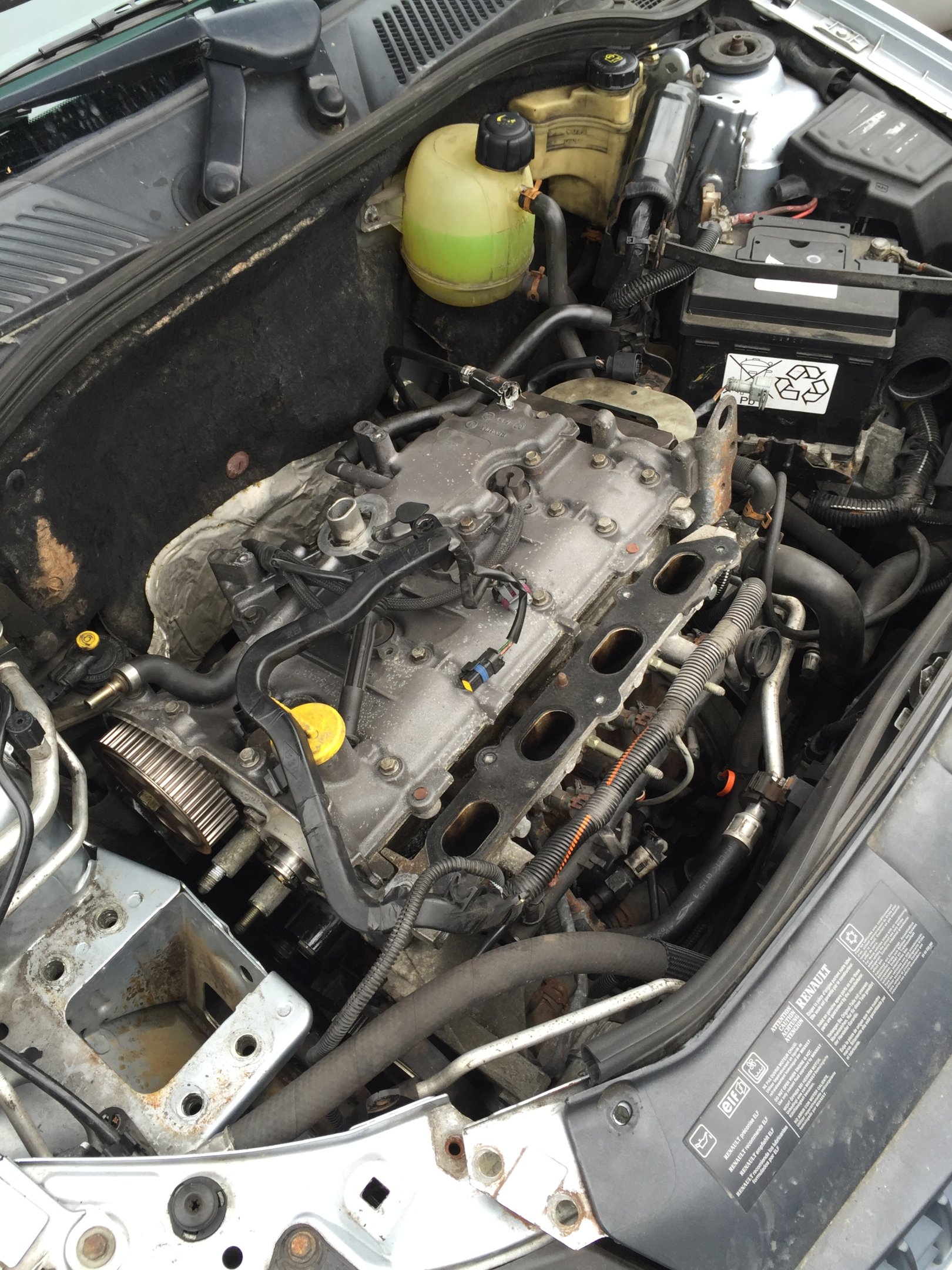

All the following parts were then ordered and fitted.
Gates cam-belt kit
Water pump
Dephaser Pulley
Aux belt kit
Hydraulic lifters/tappets

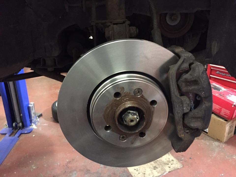

Brembo HC front discs
Brembo front pads
Brembo OEM rear discs/bearings
Brembo rear pads

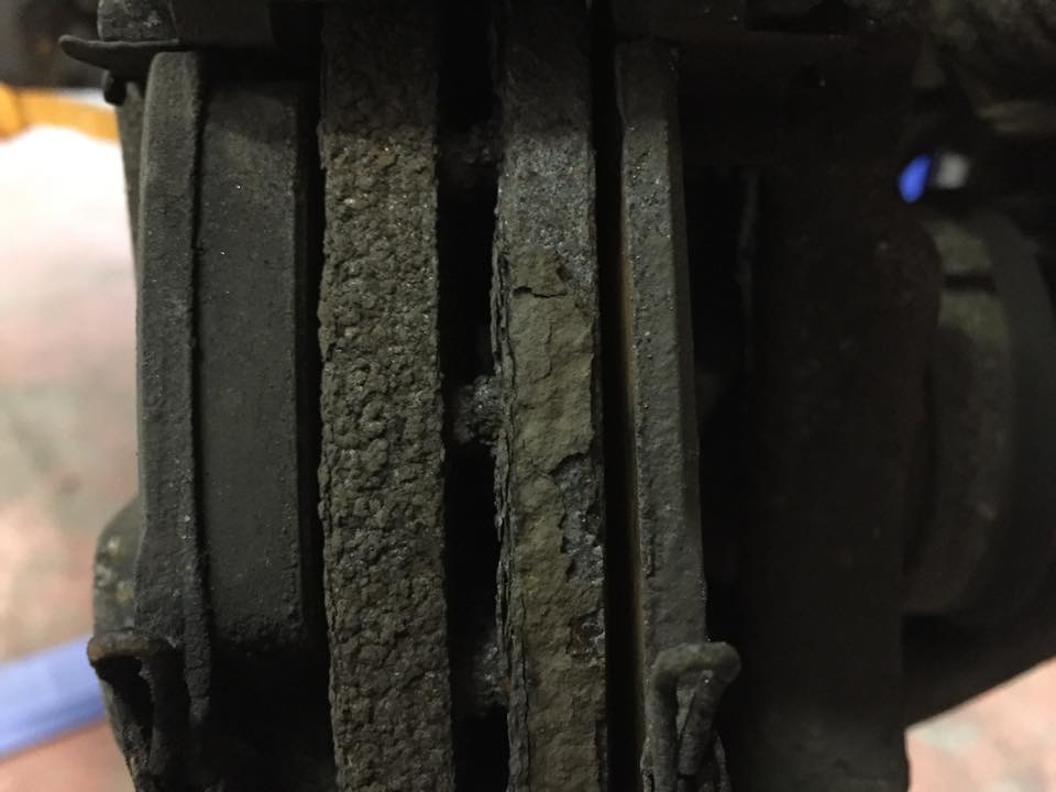

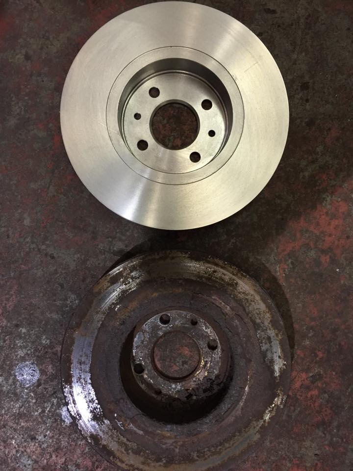

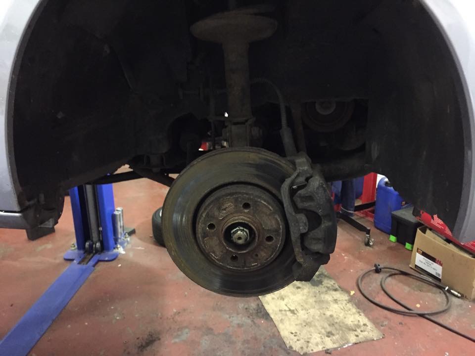

old brakes
old vs new

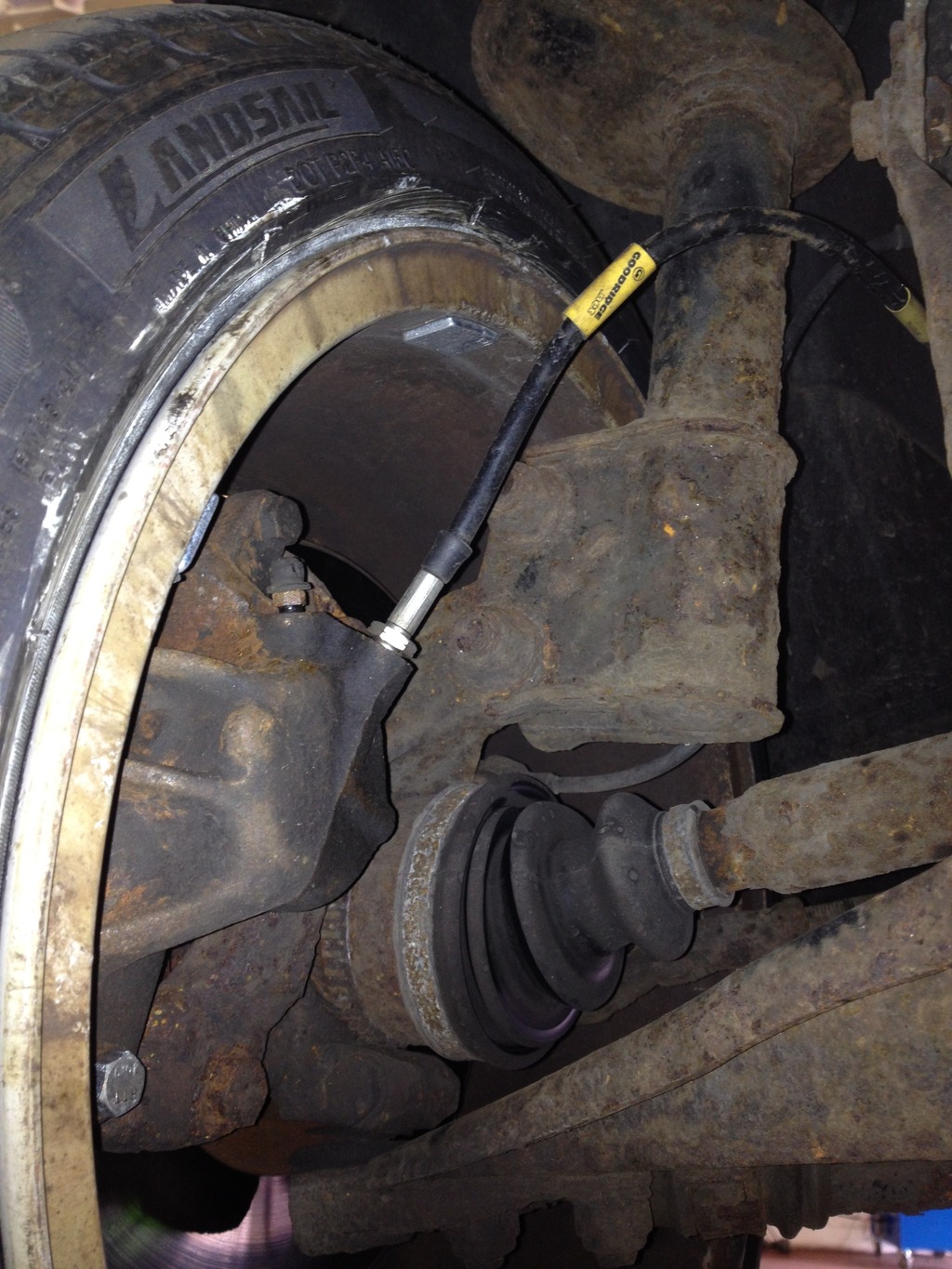

Uprated Brake lines
Brembo hc disc fitted
While doing the brakes we found the passenger front calliper was seized so this was replaced.

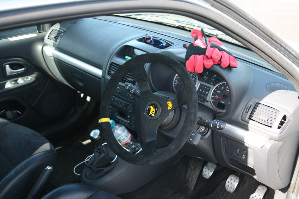

Forgot to mention we replaced the standard steering wheel with an OMP one due the usual melting and thumb grips splitting.

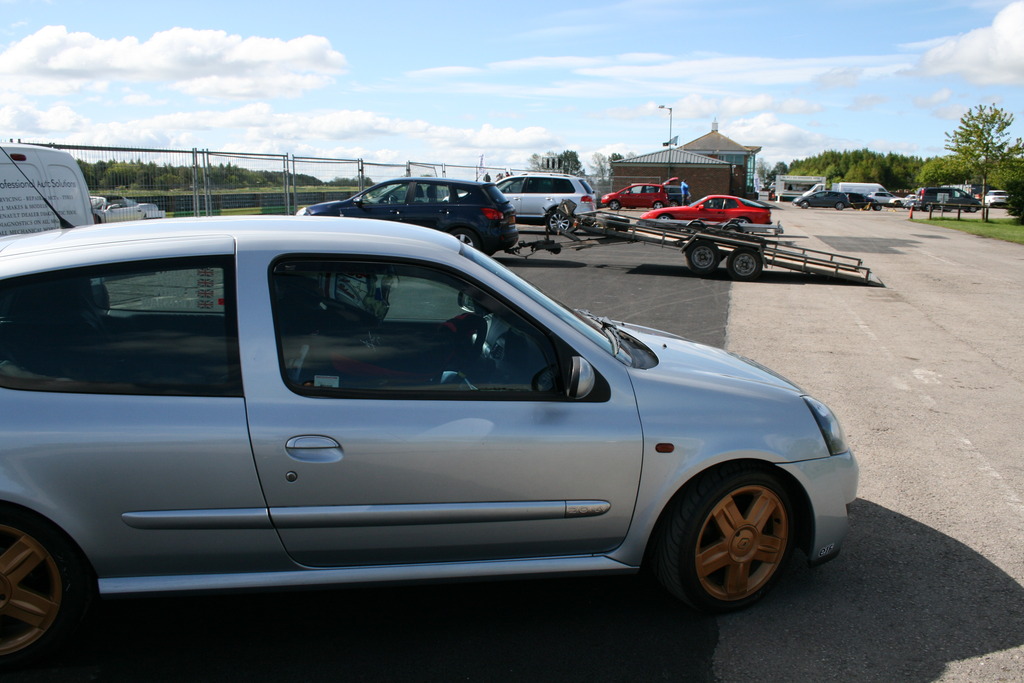

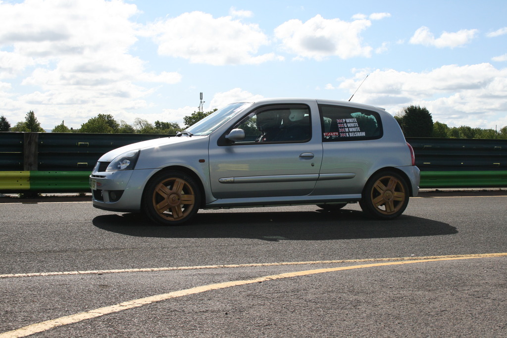

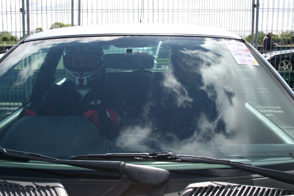

Here are some pics from the last trackday we did in 2015.
Spec was pretty much Standard..
OMP Steering wheel

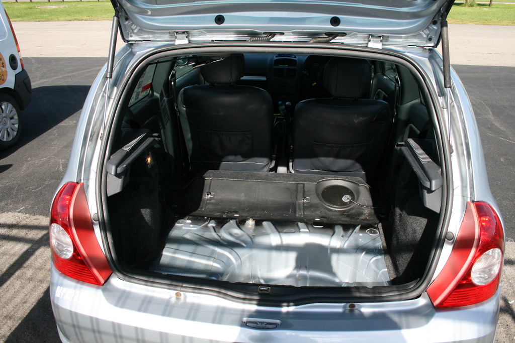

Stripped out rear seats
Fabia spliter
Wind deflectors
Painted the wheels gold
Federal 595 Tyres
few stickers

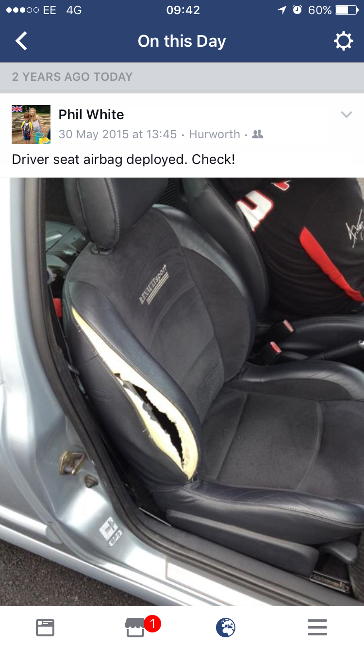

Oh and this happened ran a little wide touched the grass with passenger front wheel hit a hole and then drivers seat airbag deployed oops. also snapped the earth strap. 30mins later we were back out on track.
She pretty much sat for a year after this happened as I never got round to sorting it out.

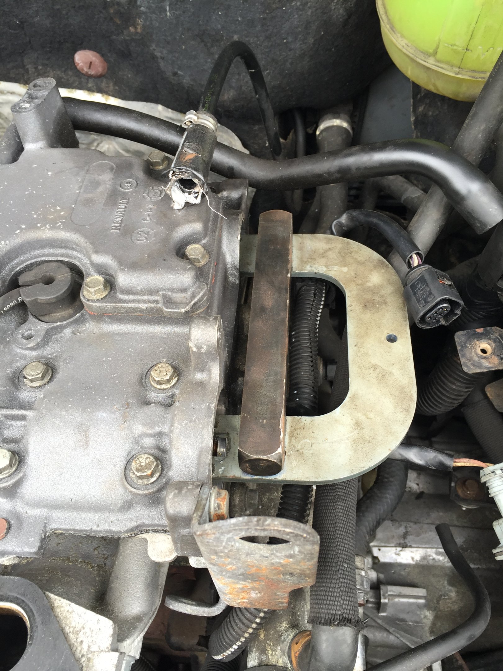

Had some running issues and a bad oil leak so decided to get that sorted out and fit a new dephaser pulley etc.

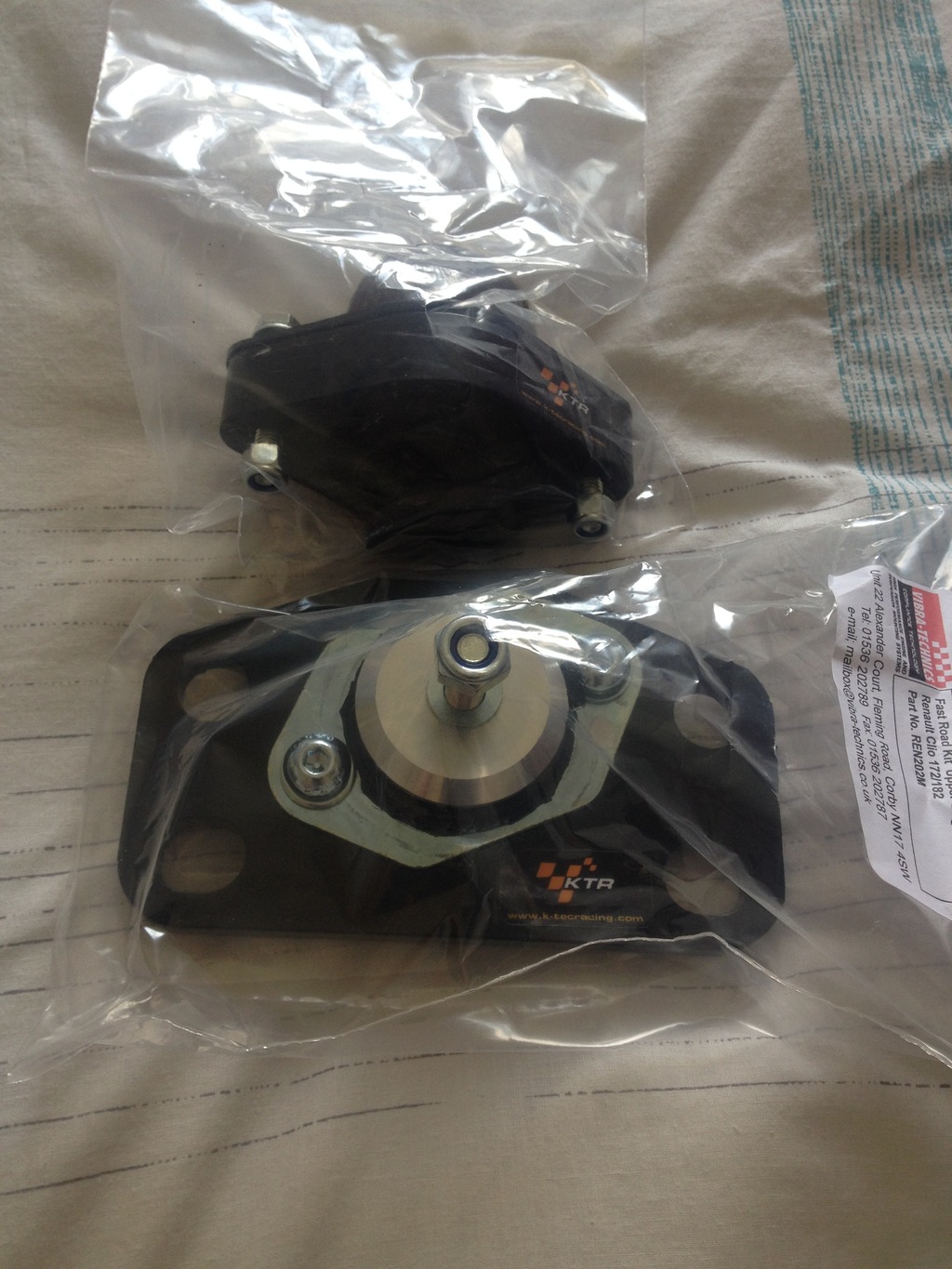

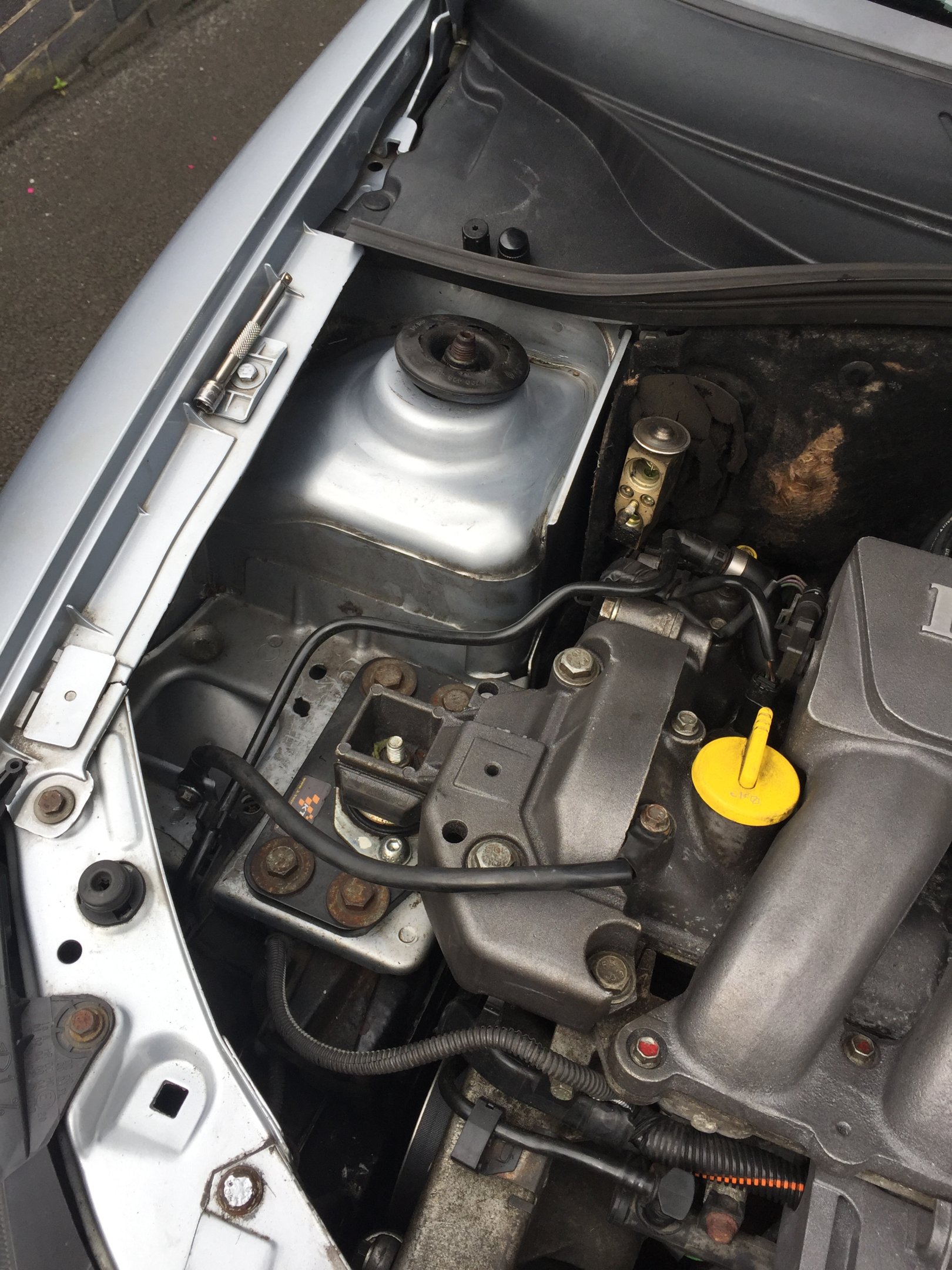

Then decided to upgrade the engine mounts fitted the KTEC ones.
You certainly get a lot more vibration off these over standard but its a track car not a daily so all good.

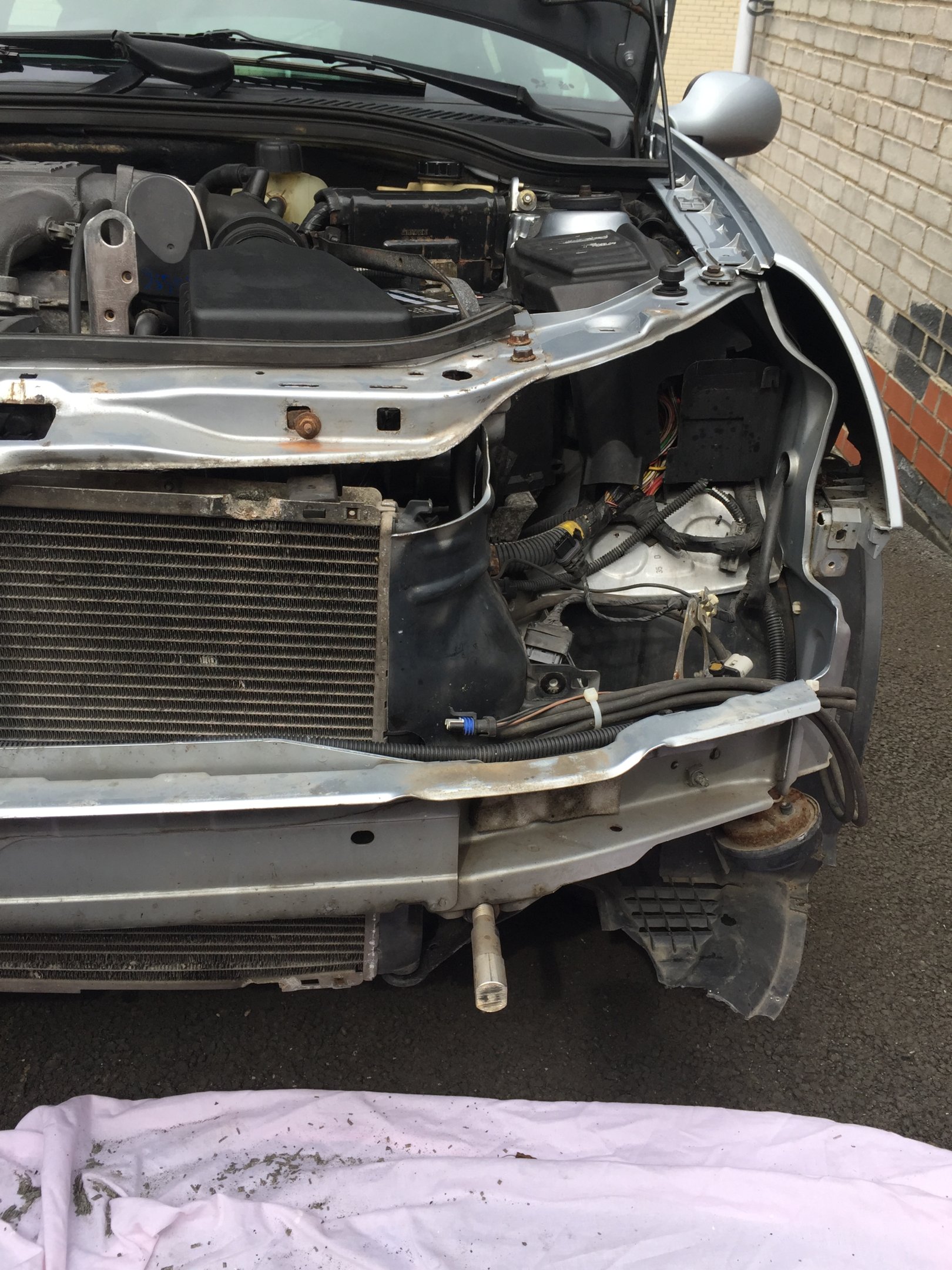

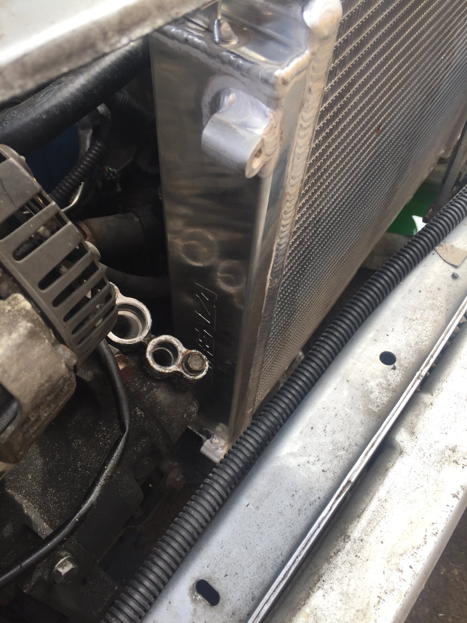

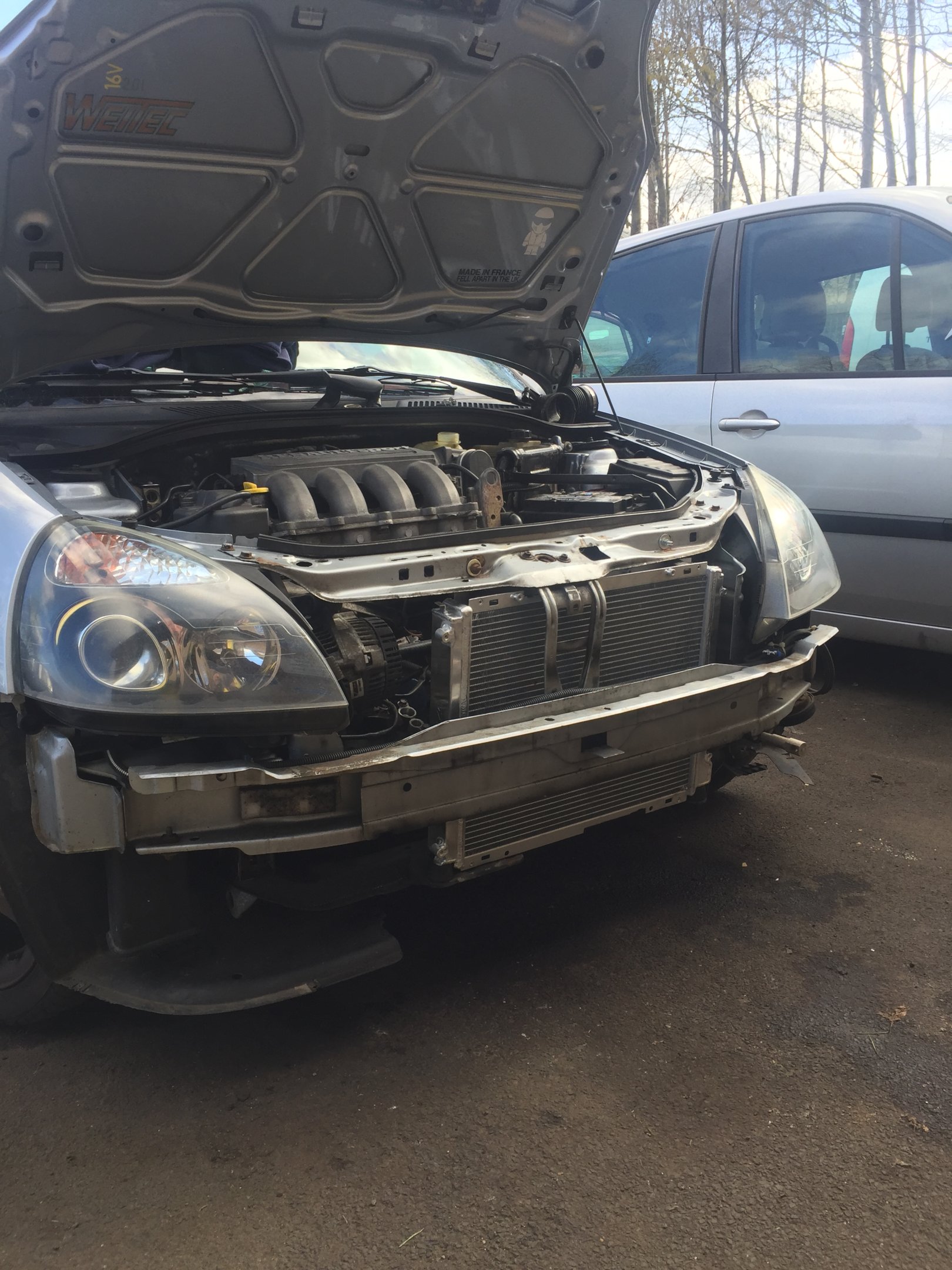

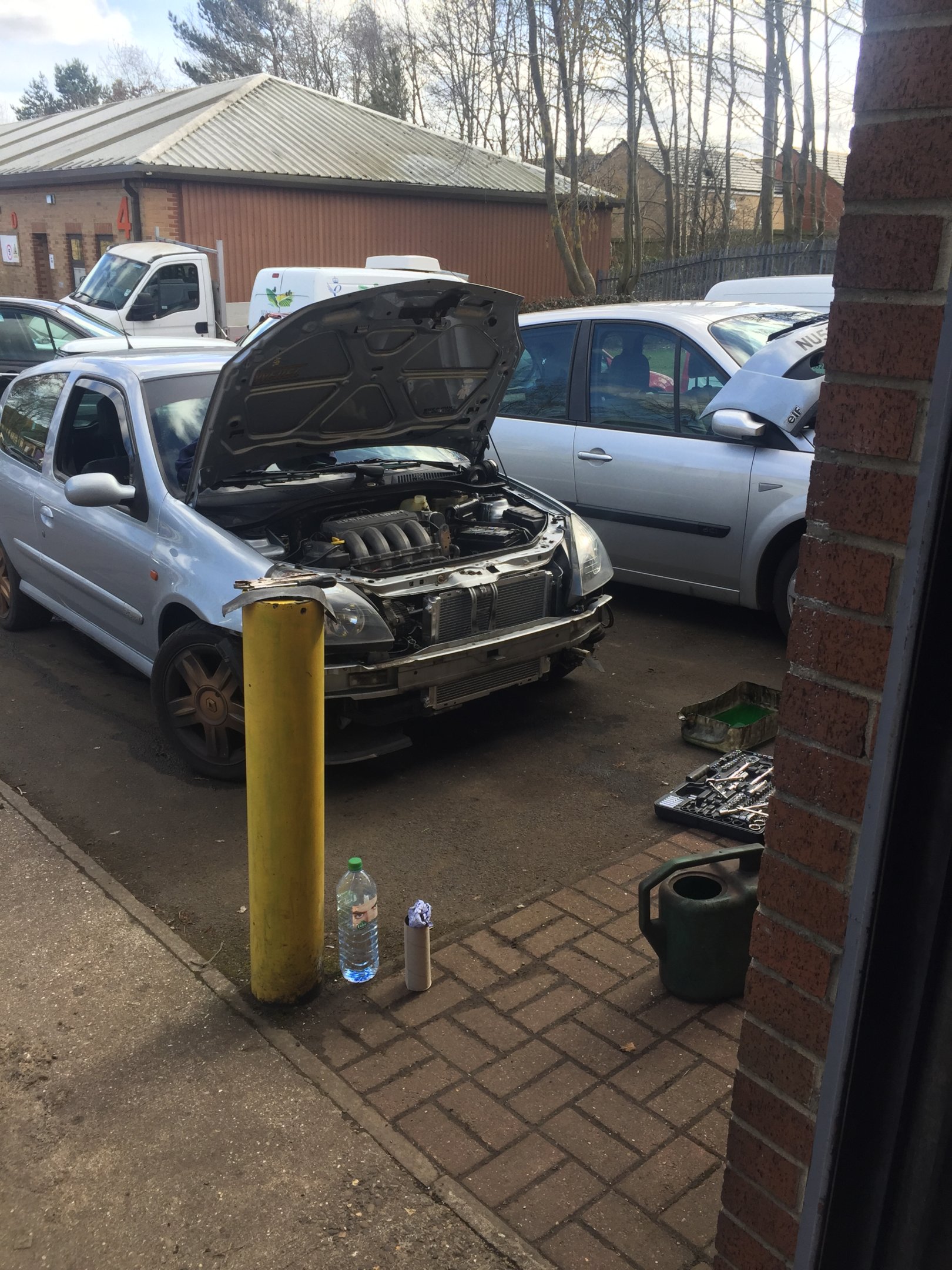

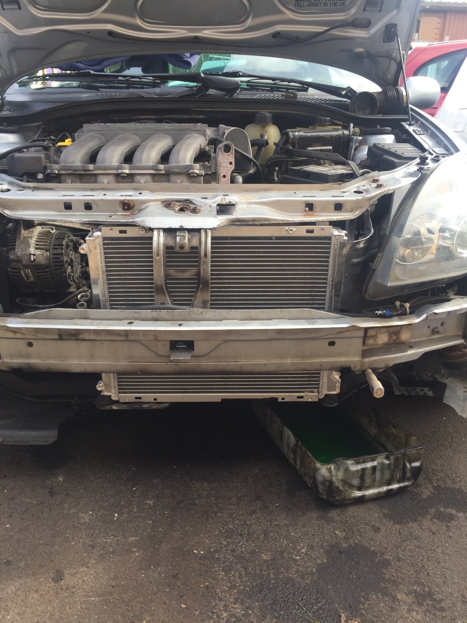

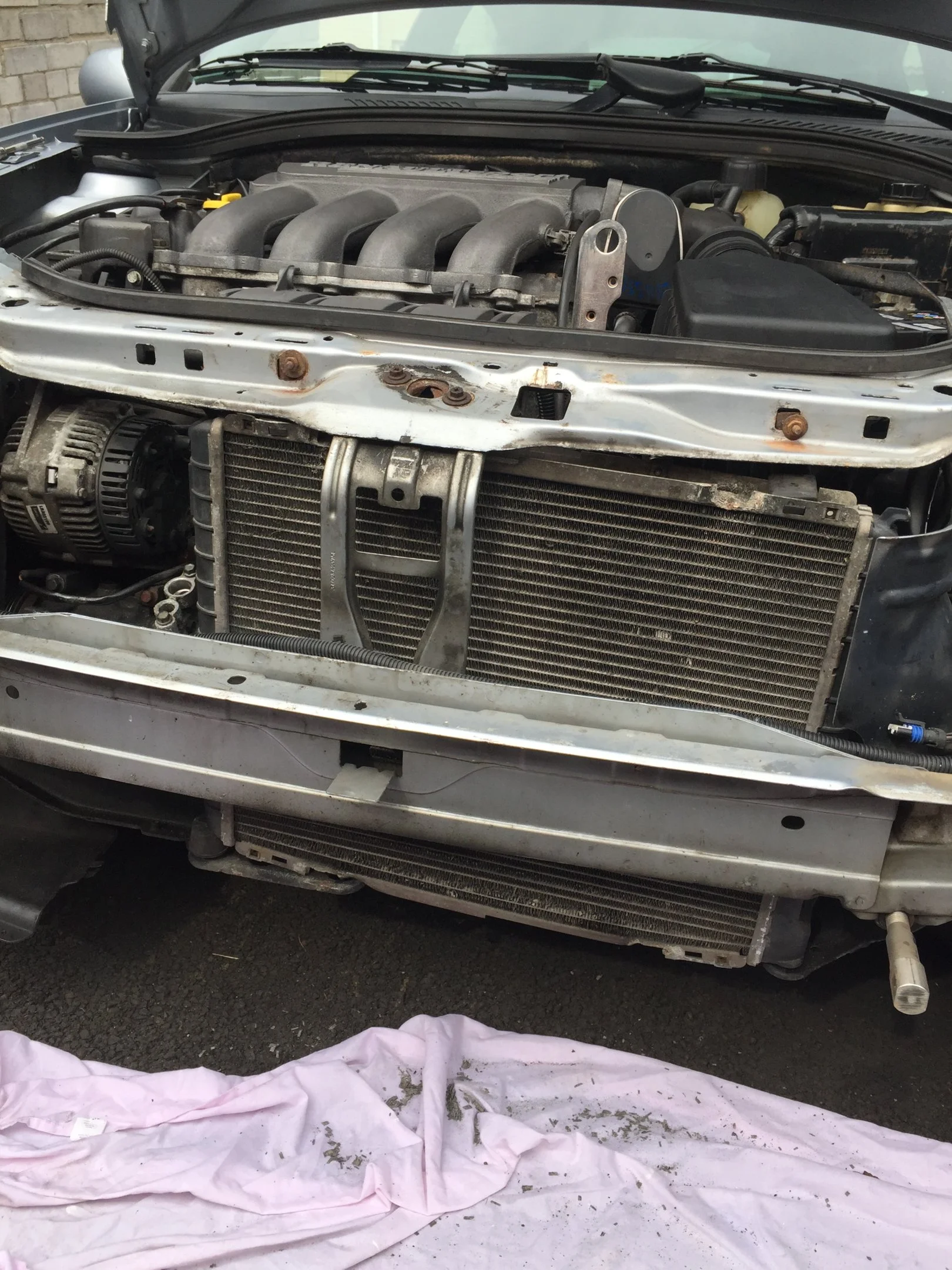

Took out the A/C pipe work and condenser as it was knackered. Noticed my radiator had seen better days so that would be the next upgrade.
Ordered the Direnza alloy radiator for the 172 to replace the tired original got it fitted fairly easily.
Filled her up with some fresh type-D coolant and bled the system job done.

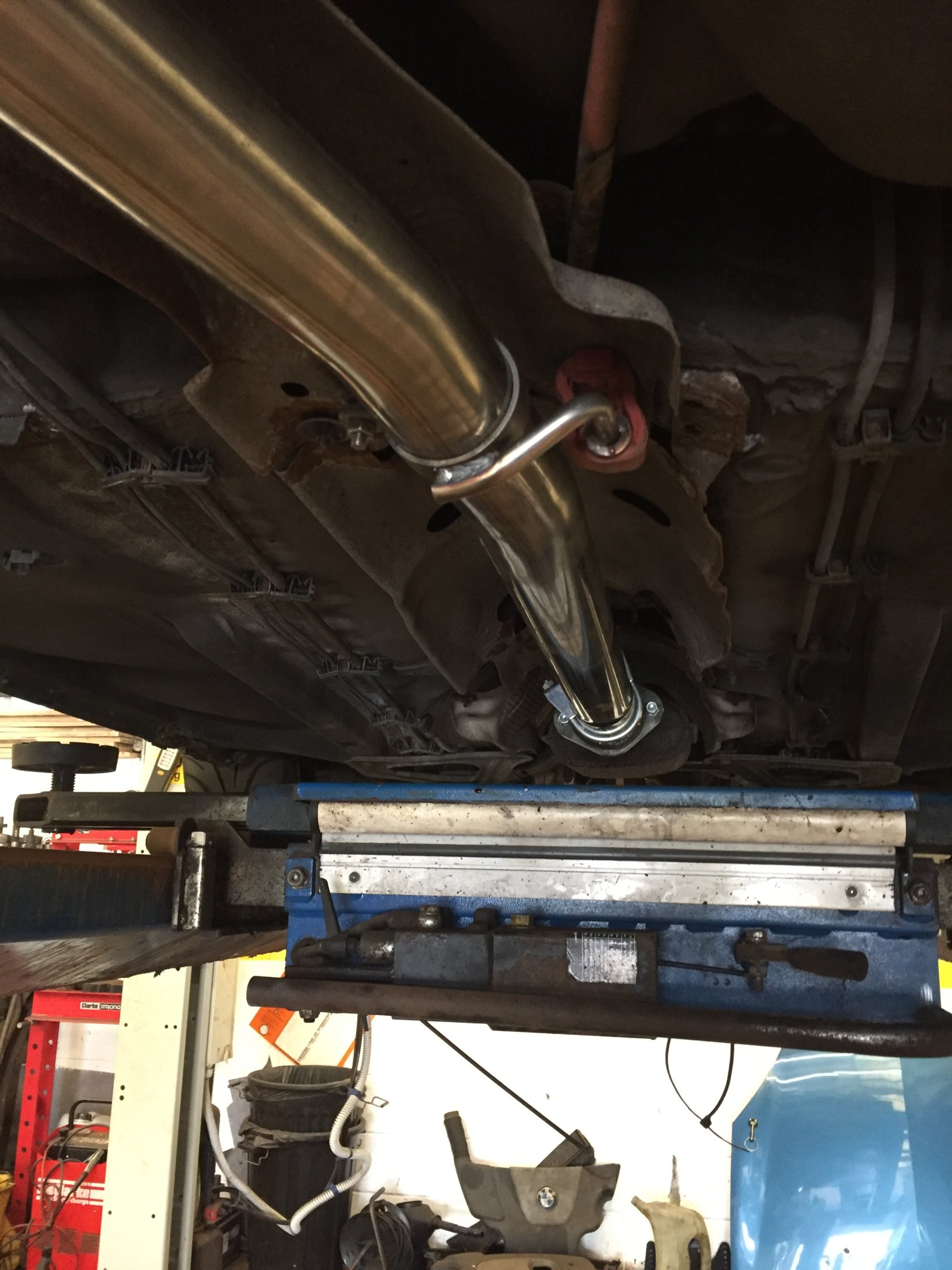

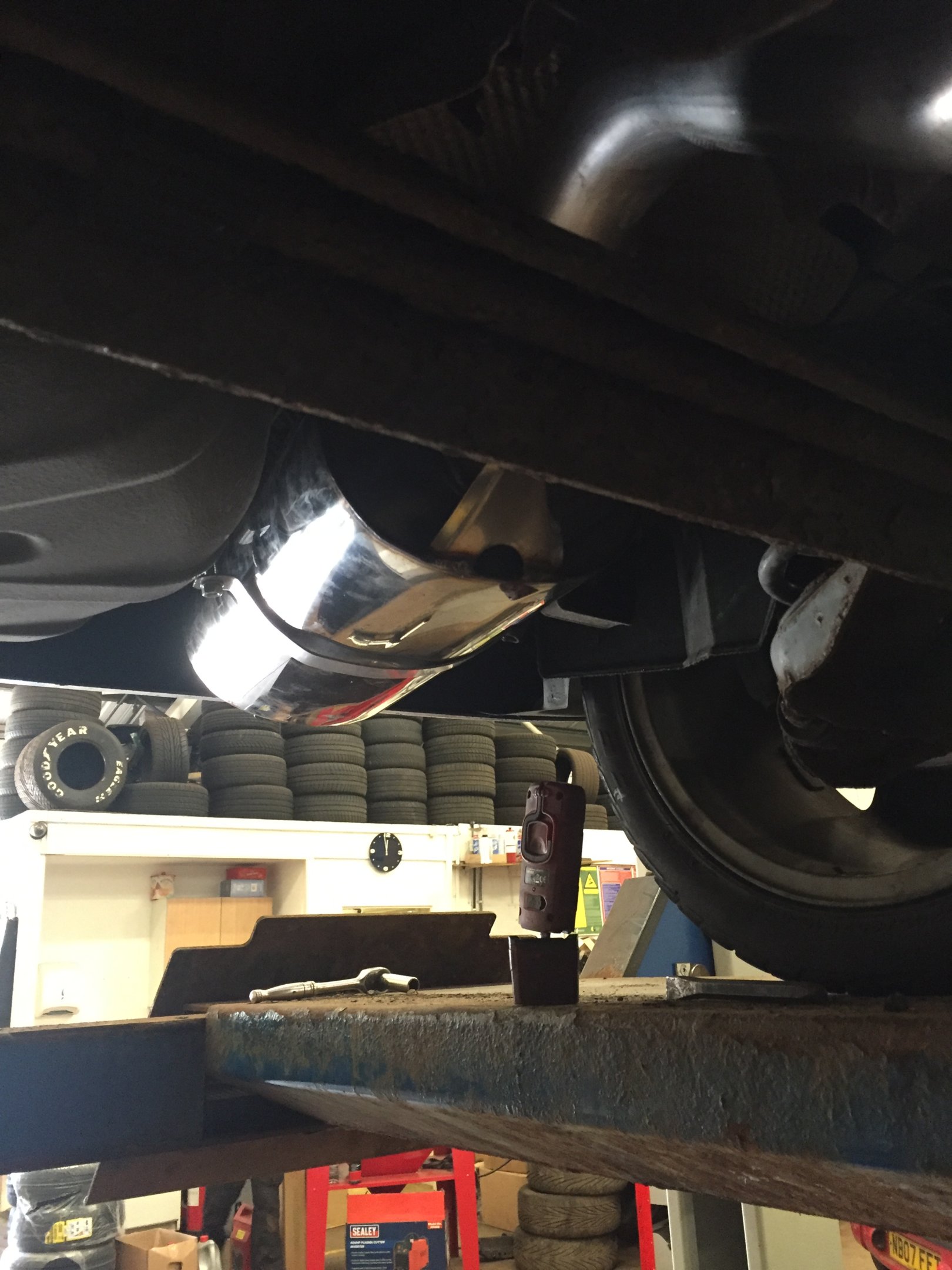

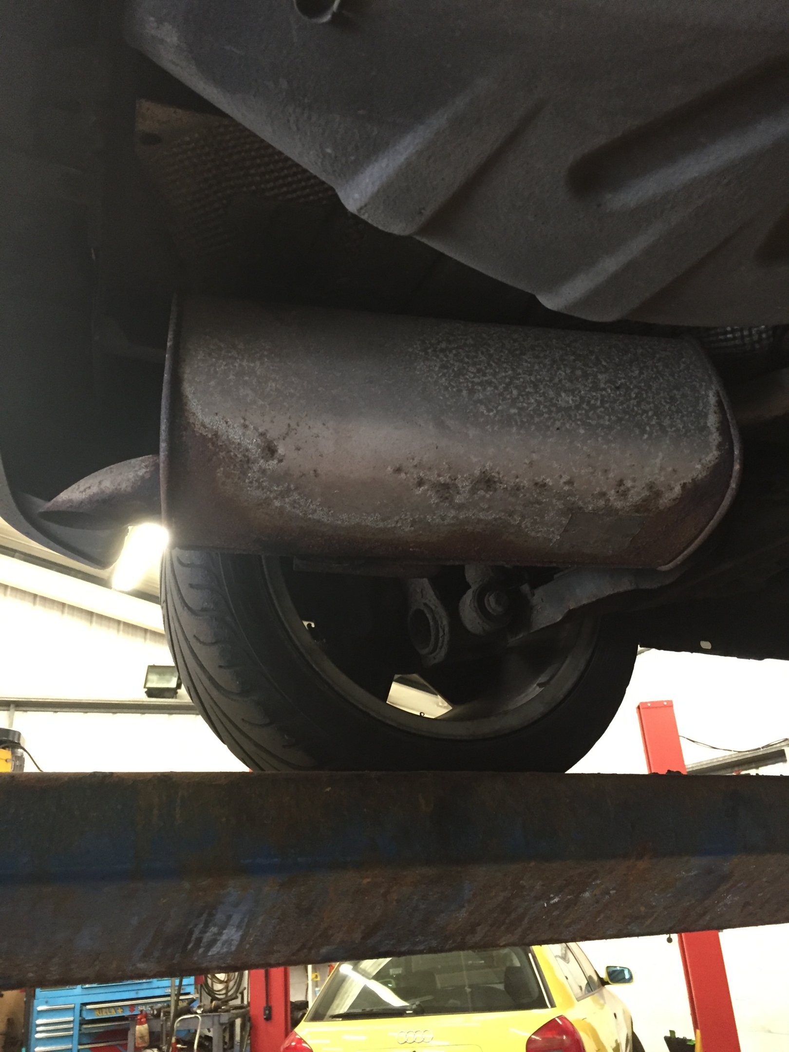

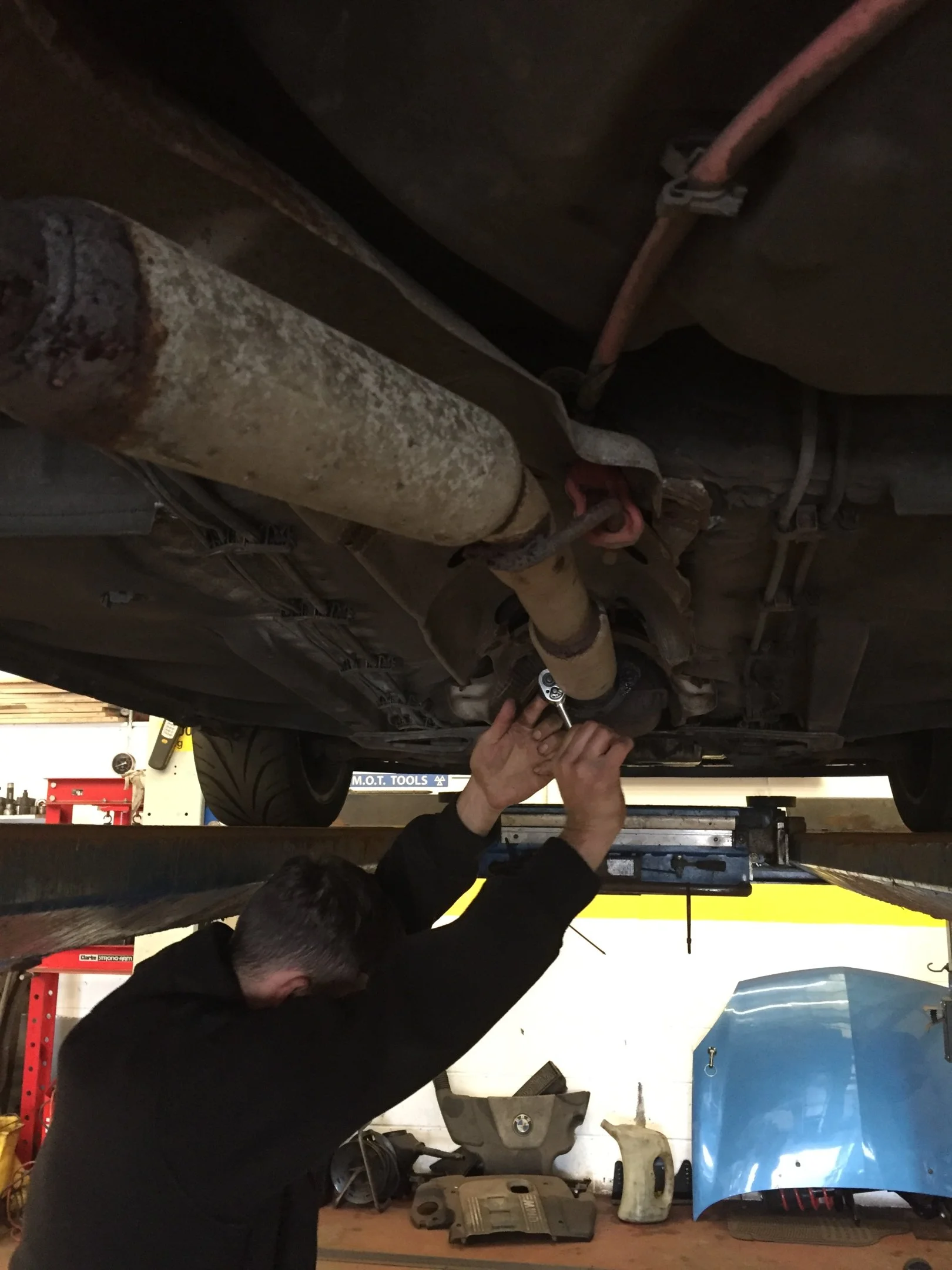

Next job to do was replace the rotten old exhaust system decided to go for a KTEC stealth supersports system.
Off with the old system.

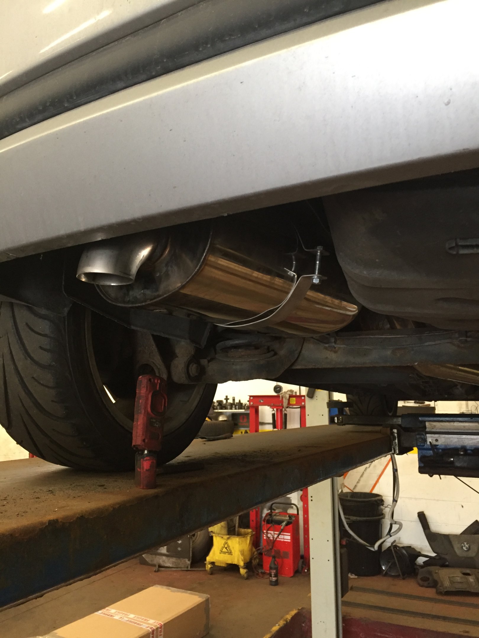

On with the new.
Really impressed with the KTEC system nice to have a bit more noise over the standard system few kg's lighter than the standard system also. Left the cat in as I cant be bothered with the hassle of MOT's etc. Also got some new exhaust hangers to go on.

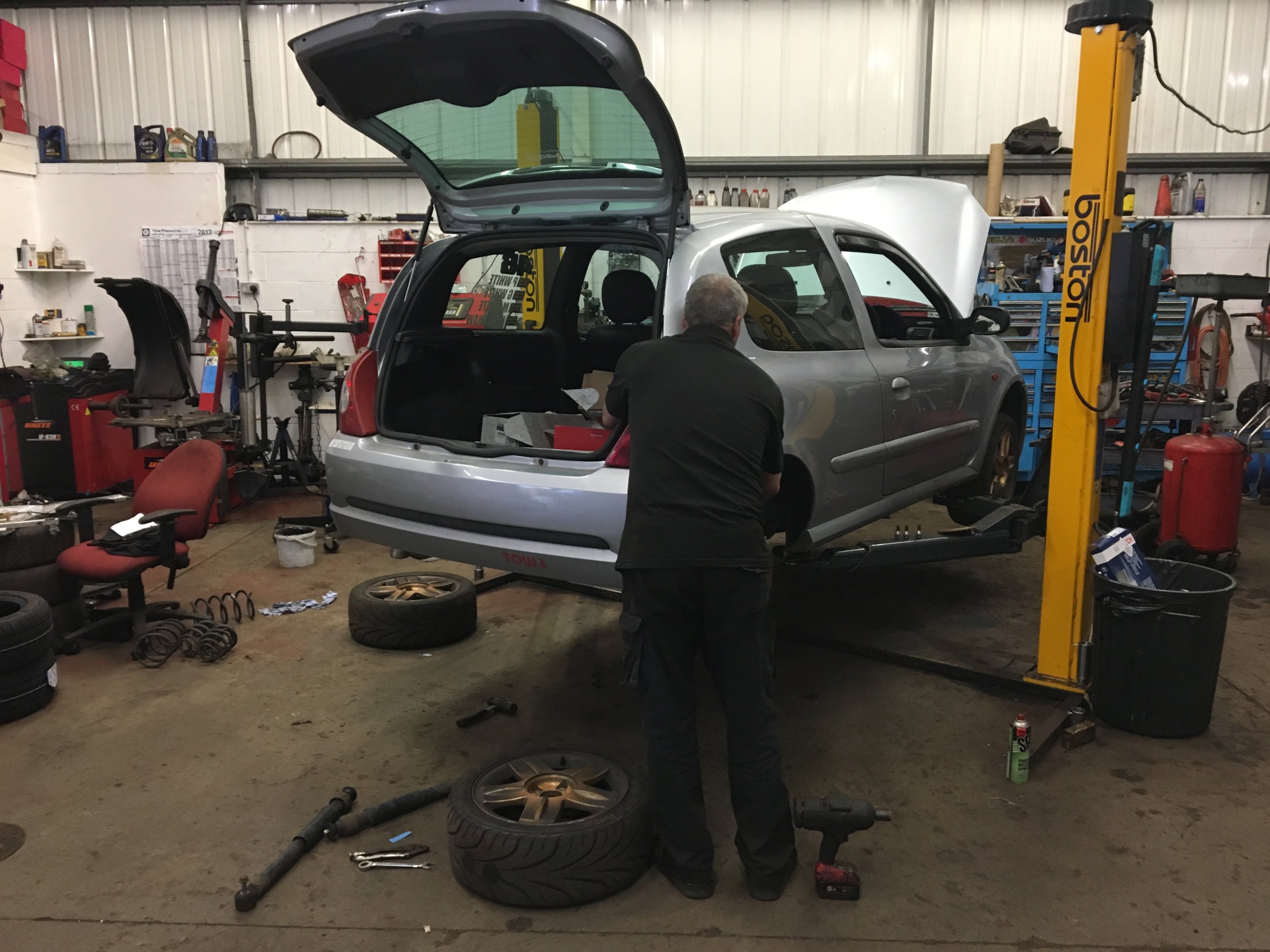

I use the car on the road every so often its mainly for track days with the occasional weekend blast. I couldn't decide what to do suspension wise coilovers or cup dampers plus cooksports or eibach etc. In the end I just didn't fancy coilovers and went for cup dampers front and rear with eibach sportlines. Put on some new genuine Renault strut top mounts as well.
Was working away the day the suspension started getting done so don't have many pics really just her on the ramp where she spends a lot of time.....
Found we had a snapped front drivers side spring right at the very top when we took it all to bits.
Just need some new wishbones and bushes to complete the suspension refresh and then I think I will get the pms rear stub axel spacer kit and some 15mm hubcentric front spacers. Oh yeah fancy the whiteline rear ARB too.

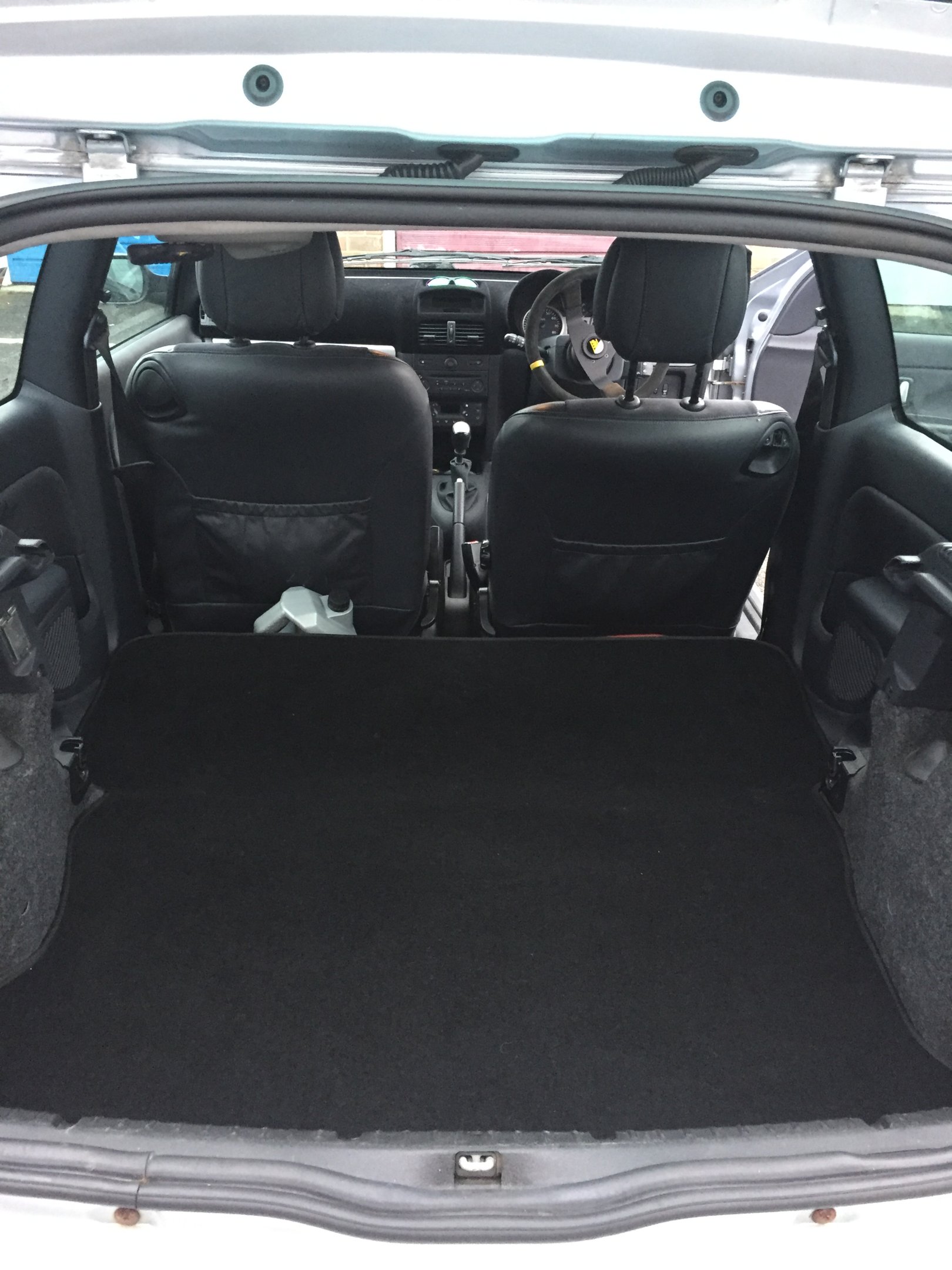

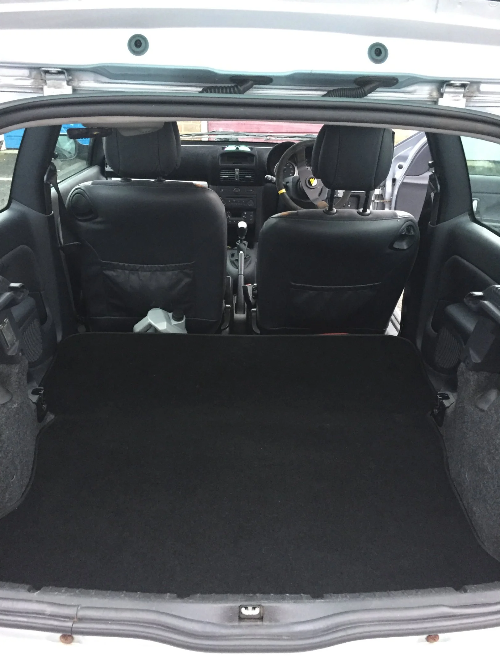

Tidied up the rear by putting in a boot mat.

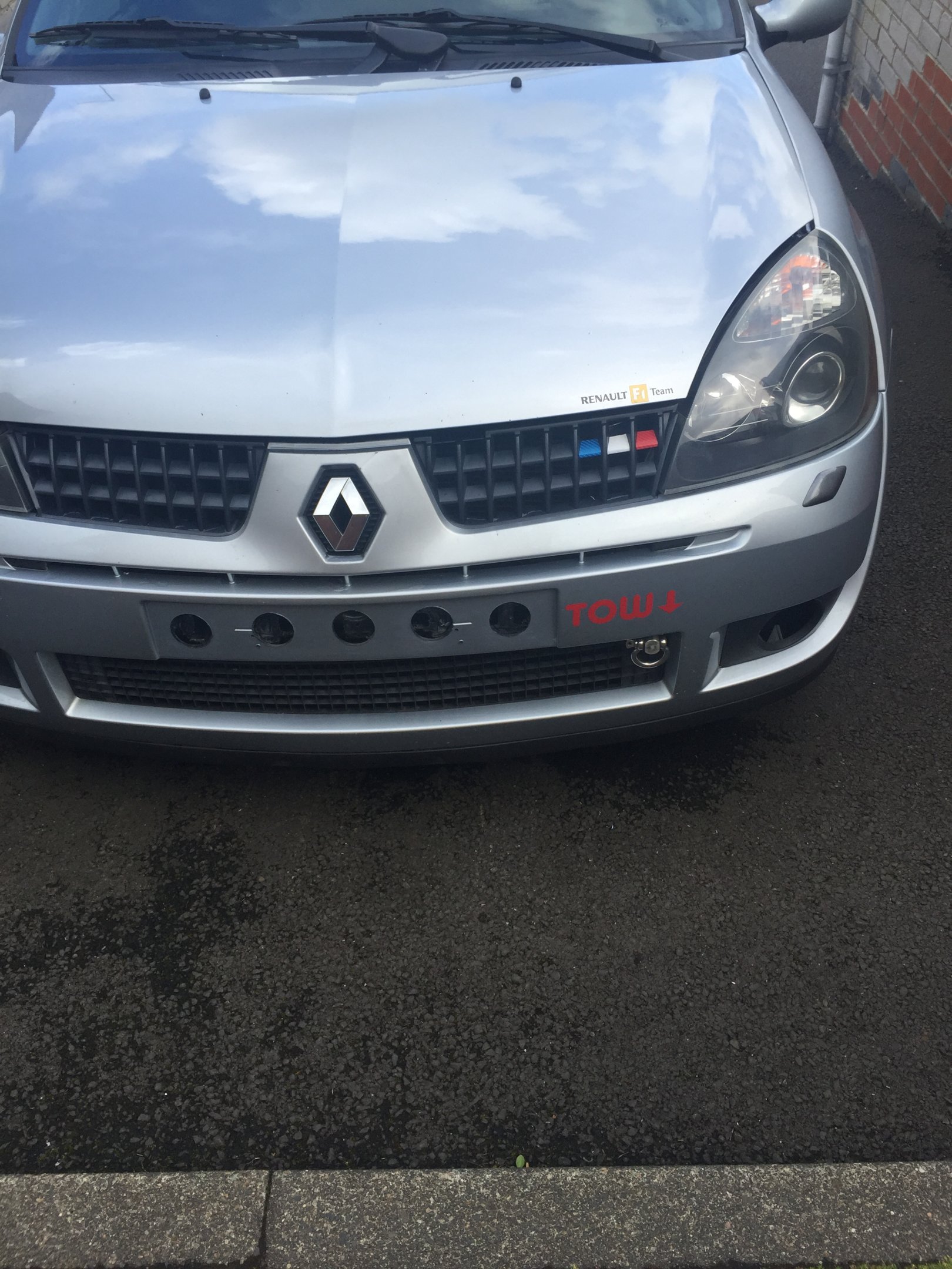

Added some more stickers and drilled out the front bumper for better cooling. Moved the number plate to the corner got this made up from someone on ebay.

Replaced the airbag ecu due to blowing the drivers seat air bag at croft and used the clip to sort out the rest steering wheel dash etc. Also had to replace the TDC sensor as I would park it up after driving and it just refused to fire up put the modified loom and new sensor cured it.

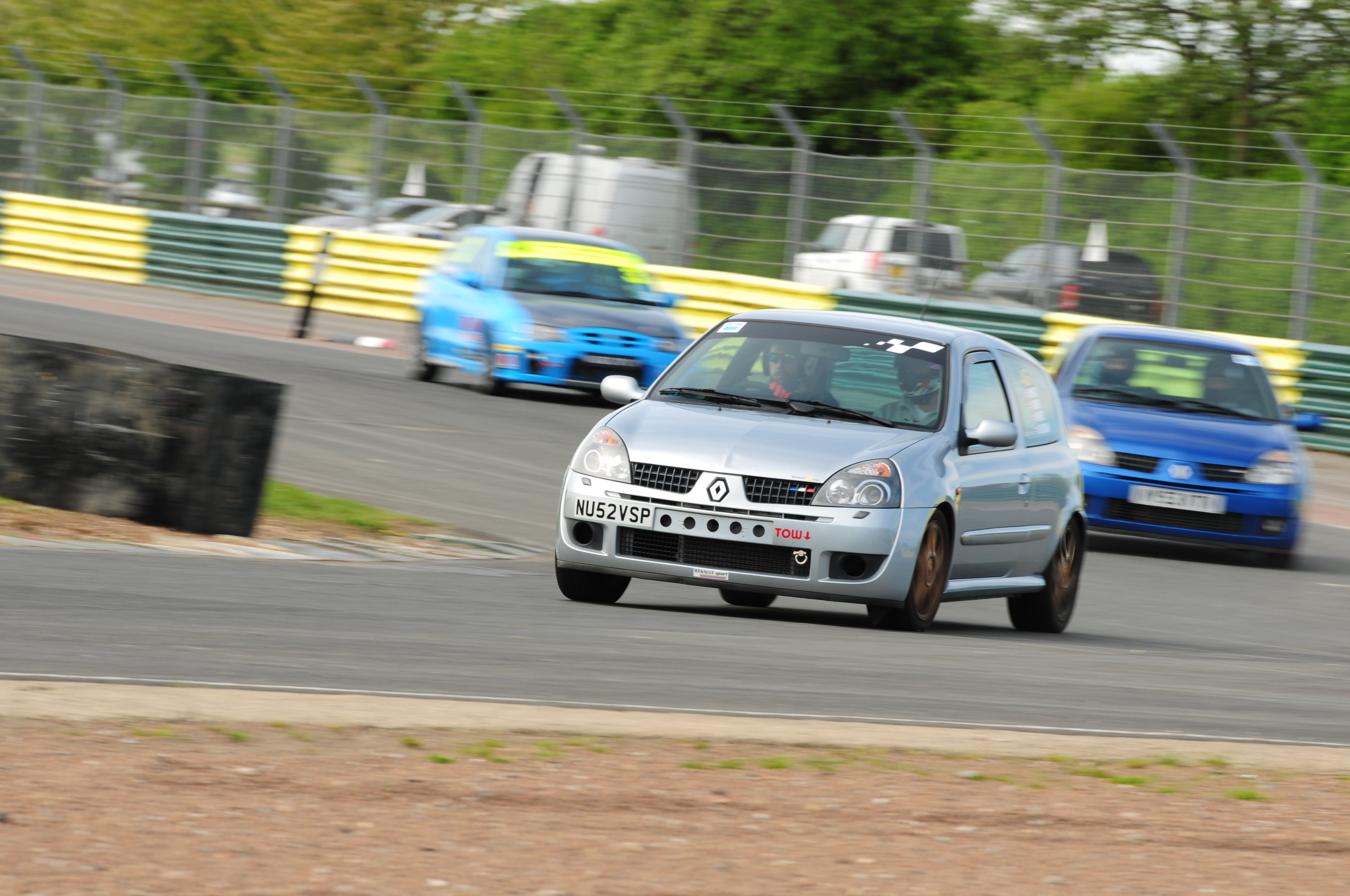

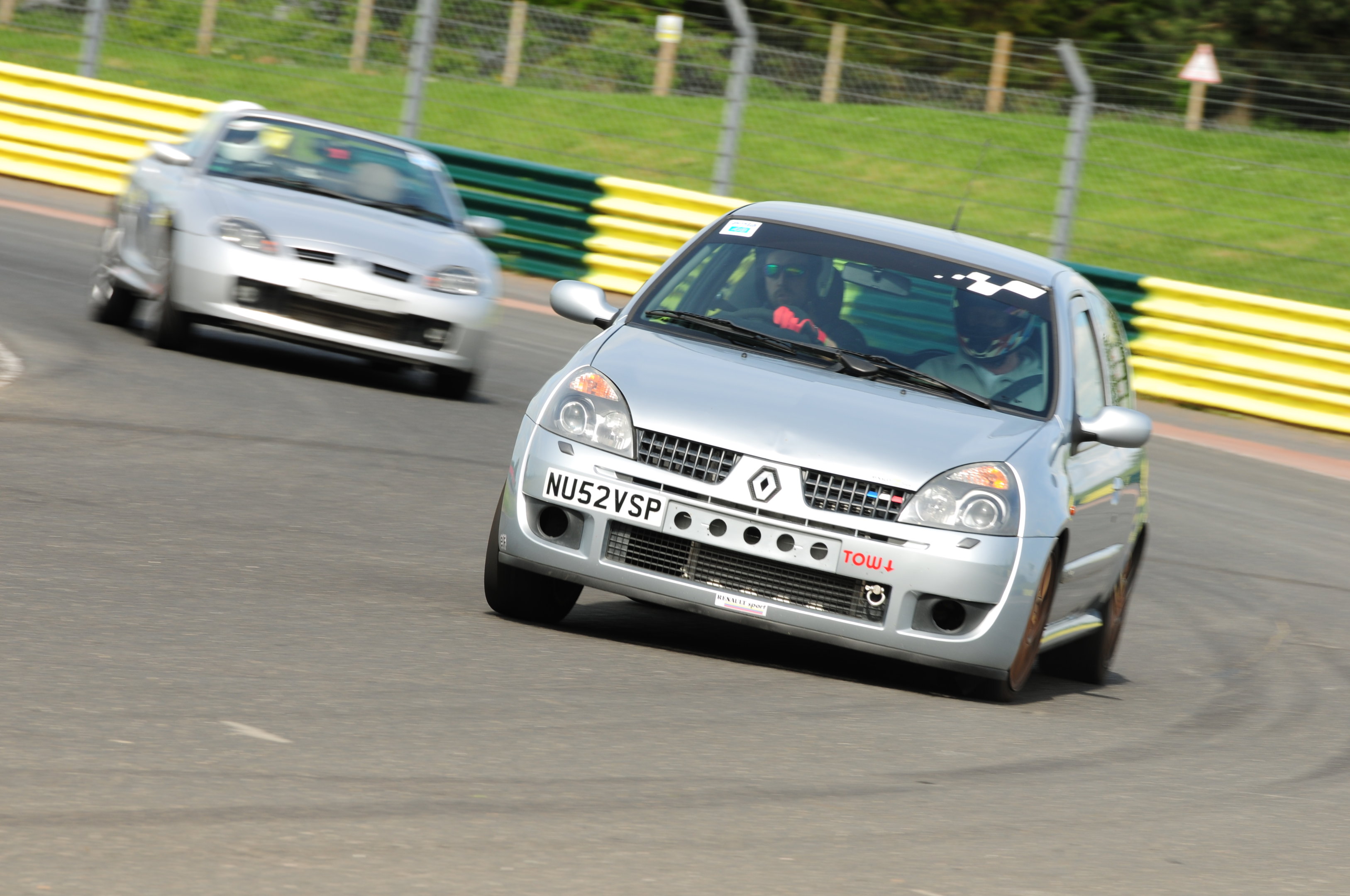

Booked up to do Croft on Saturday 12th May last week to give the Clio a run out. Turned out to be a cracking day car was faultless went better than she ever has done and sounded amazing with the new exhaust system on.
Ill let the pictures do the talking.
Awesome little car.
Can't wait to do it all again as soon as possible!
