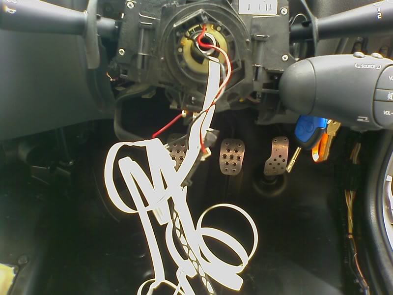

I have a horn not working, took airbag off the steering wheel today and realized horn buttons are not connected to power - wiring is missing.
Could anyone post a picture of the steering wheel with airbag off please?
Airbag is fastened with 2 etorx size 27 screws accessible from behind the steering wheel.
A wiring diagram or reference to a corresponding pdf from Dialogis would help as well.
I can't access this thread, probably for club members only? (and I'm not a member, yet)

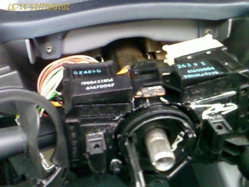

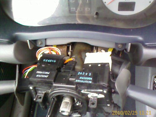

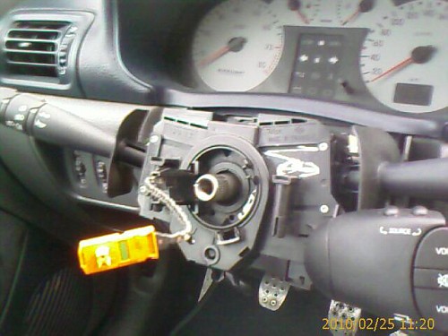

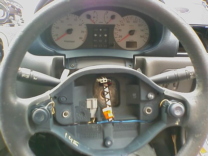

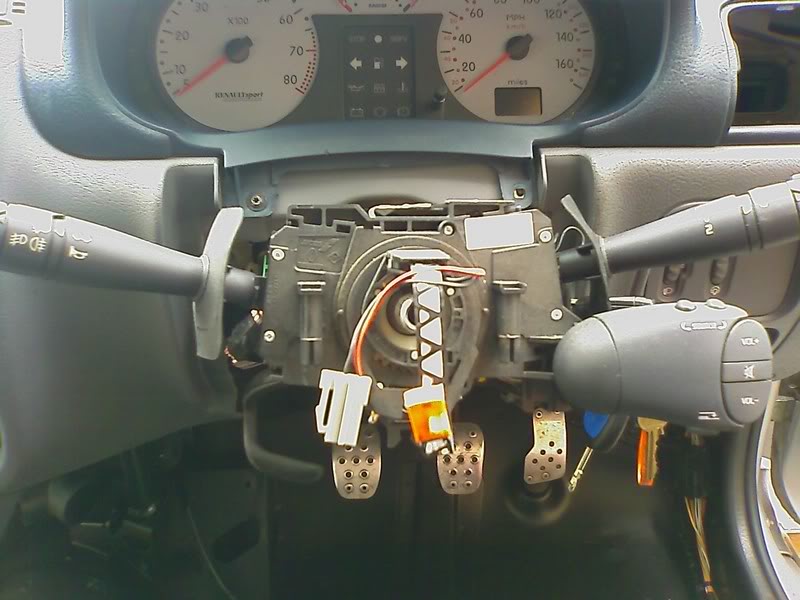

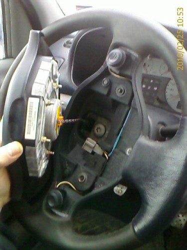

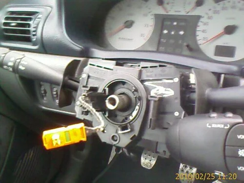

Took my steering wheel apart today, looks like pictures in the three threads I referenced above are not for ph1. Posting my pictures.
Apparently I'm missing a plug for horn wires. Anyone can post a picture of a properly wired ph1 wheel please?
Found pics in another thread and realized I will need to find another ph1 anyway to find where my wiring was cut off
The funny part is that I didn't know untill y-day that there's 3rd horn button in the car, that one on the left stalk - this is my 1st french car ). It was frustrating to learn that it doesn't work either and I won't avoid spending some time faultfinding and rewiring.
Had a chance to quickly look at another clio rs today and now I know the left stalk's horn button must be powered from the steering wheel (and I'm missing those wires), not vice versa. It's a pitty can't find corresponding description in Dialogys, just description of stalks' contacts. If anyone knows doc # with detailed wiring description of steering wheel, plz let me know.
I was wrong here, power does come from plug to left stalk (apparently horn uses one of +12V contacts documented in Dialogis as power source for headlights and other things but horn), from there through 2 short wires it goes to the steering wheel contact disc and from there to steering wheel buttons.
