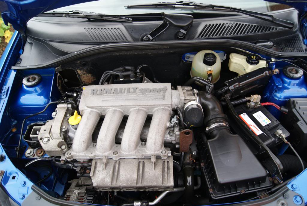

pic of the standard setup please
  iceberg phase 2 172
could someone do me a huge favour please and take a pic of the standard ph2 172 airbox setup with the original feed ? as mine is just a hole on the side closest to the battery ..
DaveDreads
10 second search on google.
The pipe comes from the acoustic valve behind the headlight and clips into the airbox,
if you don't have one it's possible someone may have removed your acoustic valve,
or just removed the pipe in an attempt to get more induction noise.
You could just get a length of air feed ducting and stick it in the airbox,
and the other end down towards the acoustic valve.
