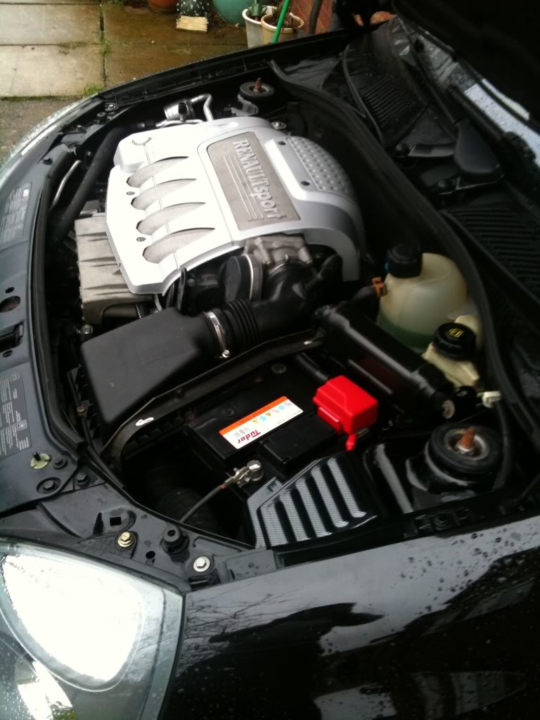

pic request - 1*2 standard engine bay photo showing airbox n standard cafs
Car  clio 182
as above, wanting a photo of engine with standard airbox with standard cafs.
i want to know what it looks like etc as am returning my car back to the standard cafs but dont know where they go as previous owner put a caf from fog light and am wanting to put the fog back in
cheers
where do the cafs go? the one under go to...???? and am guessing the one on the side goes or sits just behind the headlight?
The one on the right points towards the passenger wheel arch. The one underneath just routes next to the one on the right.

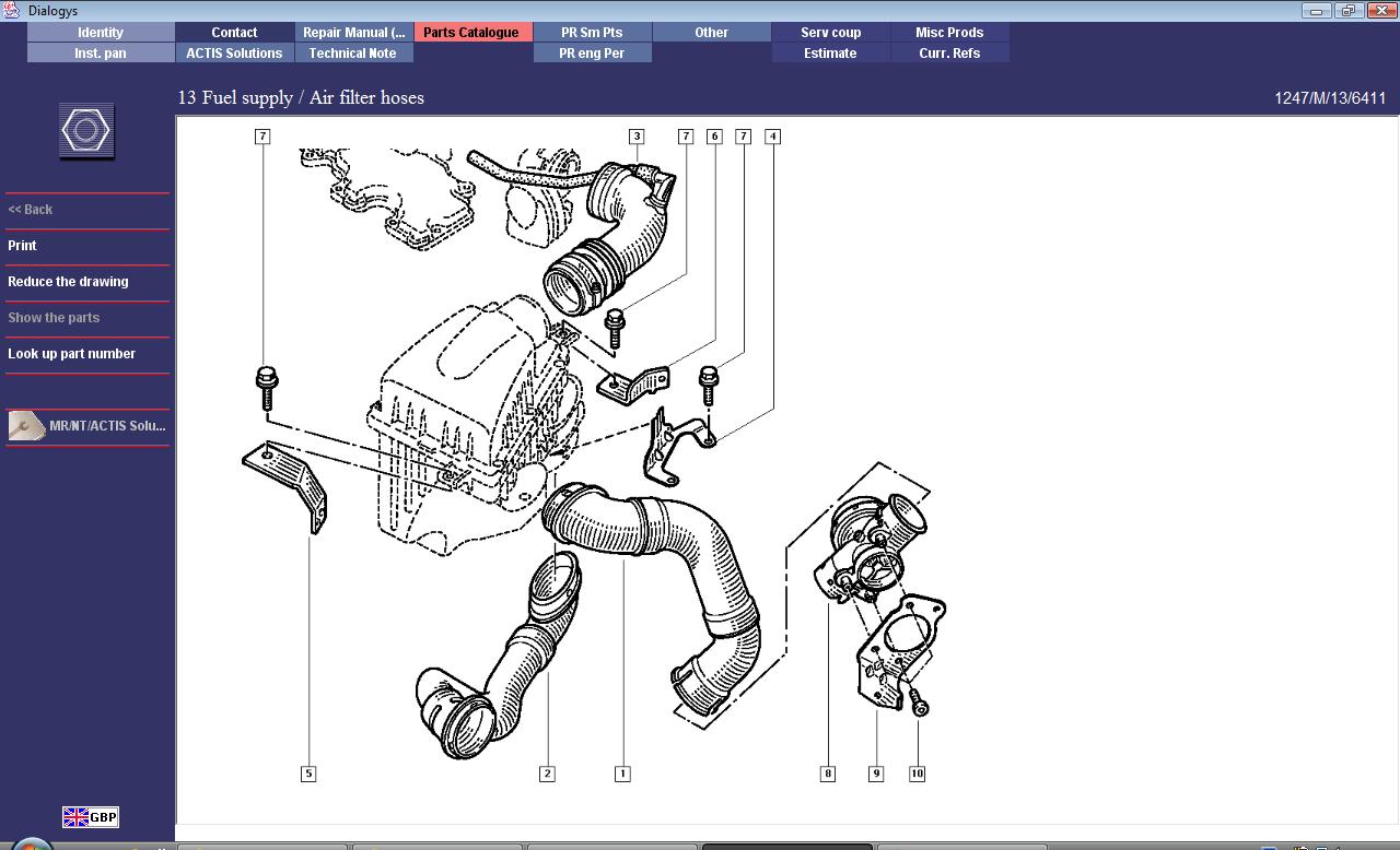

Oh right cheers for that! So they are rear facing? Am guessing they get enough air there else Renault wouldn't put them there...
The caf from under the airbox mounts to the plate at the rear of the headlight.
The caf from the side of the airbox connects to the acoustic valve which is mounted in your near side wing.
The caf from the side of the airbox mounts to the plate at the rear of the headlight.
The caf from under the airbox connects to the acoustic valve which is mounted in your near side wing.
Other way round ;)

think ill just push my fog intake back in n tie it up n put my fog light back on. do you have to take the bumper off to put fog light in does any1 know?
To put the fog back in think you can just undo the arch lining but if not its only a 20minute job taking the bumper of not that hard at all.

Do both CAF's feed into the acoustic valve?
