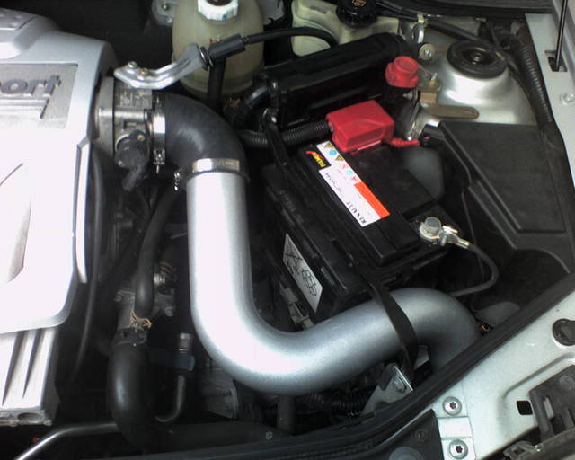

Rite ladies/gents...Post away, i'm aware it's a b**ch to get a feed to the bumper, Think Eve's managed it, so pics of urs would be good mate. Chris? And a few others.
More the beta to be honest. It looks really tight in there and i'm struggin for idea's.

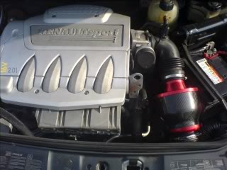

K&N Typhoon IIRC
  172

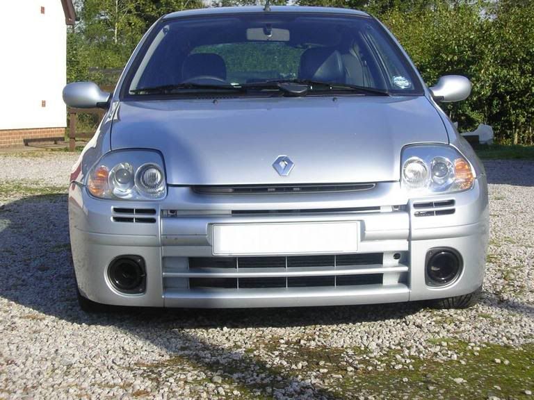

I ran it where the second original air feed goes, that 1 near the headlamp
It gets cold air allright but I am always woried when it rain, but have not had problems yet

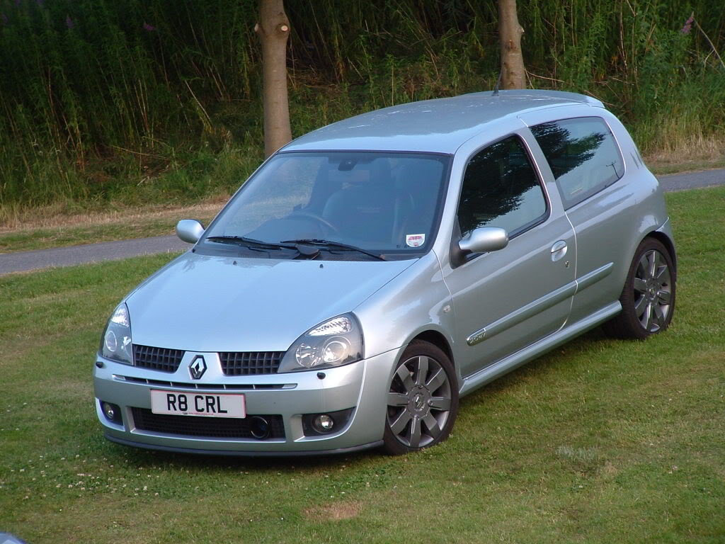

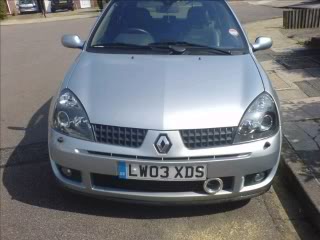

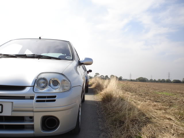

i have a viper and fog light relocation. Sounds reet good it does too, as Uncleiven, dutty and ben_p will tell you. :)

Hummm, looks ace chris, but i'm not wantin to remove the foggy. Although i'll neva use them, i want to keep the front simple and uncluttered. Not sure where else it can go tho??

Perhaps not as subtle as you want, but I like the way it hints at what's hidden under the bonnet and sounds awesome!
and indeed it does.....lol (now also ben_p has put a viper on)..mint
hardcore!
lovely stuff.
one's a dummy right?
  BMW E46 330i Touring
Lol, yeah, the driver's side...

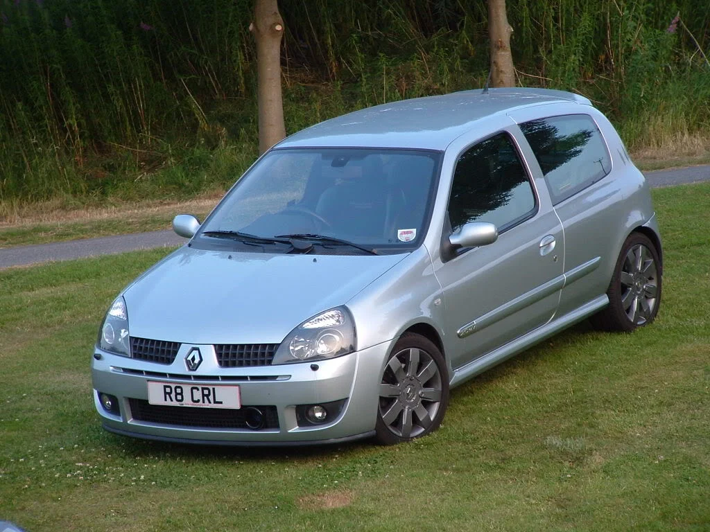

The previous owner fitted it and decided it looked a bit funny with just one fog so bought another intake pipe. I love it the way it is so no plans to change it just yet. :)
