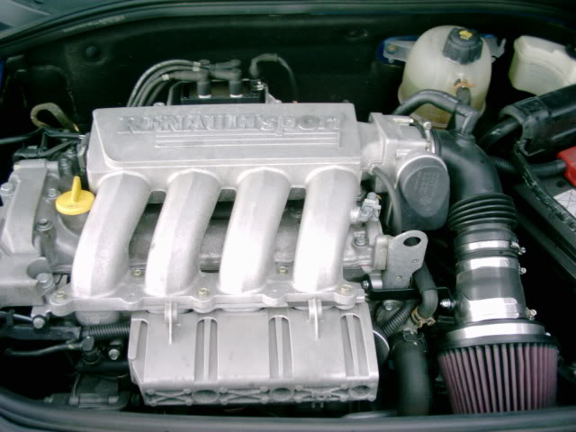

My Old K&N.. ^^ For sale BTW..;)
I've found the GEN II very good.. big improvement over the normal 57i.. Haven't used an enclosed kit so can't really coment.. but it still pulls very well even in 90 degree heat.. so the heat shield obviously does the trick.. + it has 2 cold feed pipes going to it...:) Standard + the new one pictured above..
Oh and it sounds awesome... nice and loud..

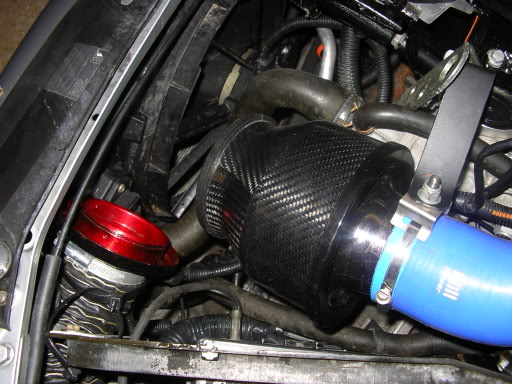

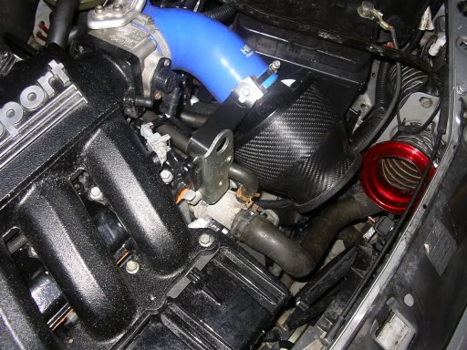

First of all, have patience! :D

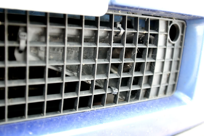

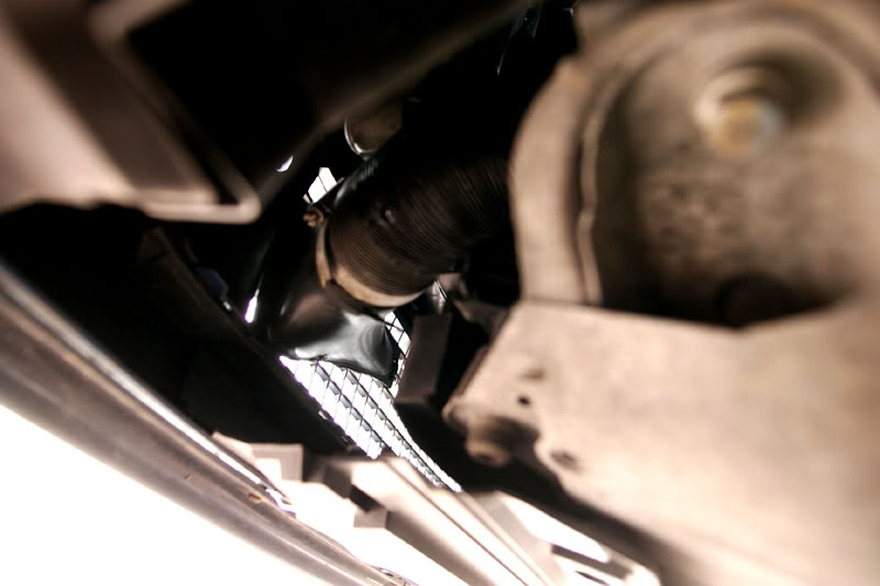

Then see if this lot will help you... at this point it's probably useful to mention that I couldn't get the supplied air feed to reach all the way to the front grill and into the supplied red inlet trumpet, seemed to be about 3 inches short...
First off, my filter housing connects to a Hill Power hose which is very flexible (and more free flowing) compared to the Renault stock part...
The route then takes the air feed further down to where it meets the battle of A/C cylinder -vs- metalwork, at this point I had to 're-shape' the feed into an oblong () marked in red rather than its standard O shape, this was the only way the supplied feed would journey on the grill area...
Next you can see where the feed appears between the a/c cylinder and the metalwork again, marked in red...
The next pic is a bit further left, there is a flat piece of plastic that you will need to cut out with a Stanley knife, approx position marked in blue, the feed can then just be fed round where the end of mine just sits nicely in the grill area (not secured yet), marked in green.
With the supplied air feed this is as far as I could get it to travel to, hope this helps!

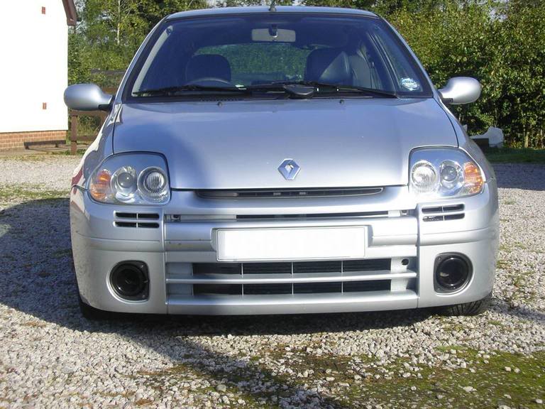

mate andrew has a mark1 172 and has it replacing the fog light but has replaced the otherside with a dummy air feed aswell looks damn good instead of having only one foggie

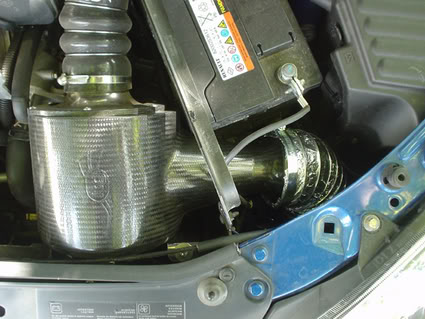

What like this... this is what i used..
oooh this is exactly what i need, where can you get something like this from?

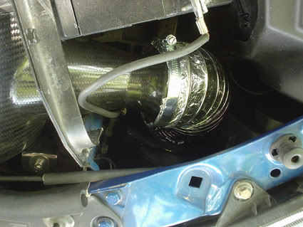

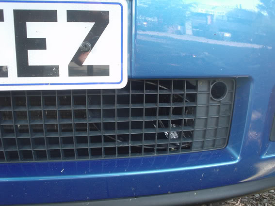

I managed to put the cold air feed in on my 182 ... I Have a 57i on mine and wanted a sheild for it.. decided to use a piece of alloy steel for it, I custom made mine but it aint perfect but, does the job...
Before I put it in I drilled a 2 inch circular hole underneath to get a feed in....
And heres my air feed at the front end behind my meshing ....
Can be done .. I had to slightly compress the pipe bout 7 inch from the mesh .. but its gone in and does the job.. :)
