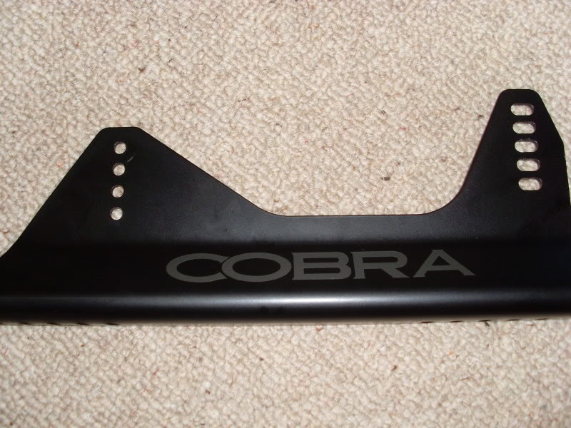

Wonder if you people could help I'm after some pictures of how people have mounted there side mounted bucket seats into a phase 1 172, I have cobra evolution seats and side mounts just need to see how people have fitted them as want the driving position to be nice and low and solid mounted no runners

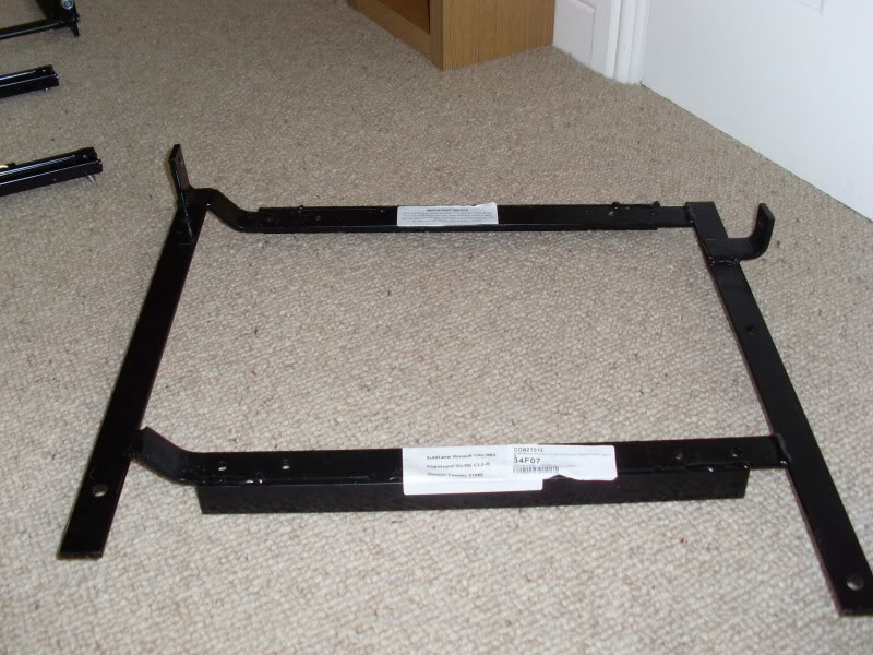

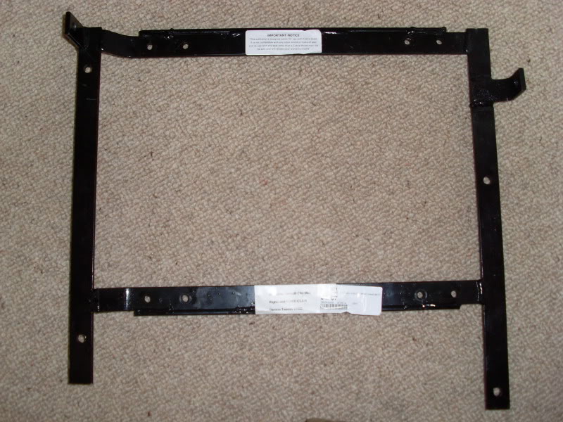

Side mounts onto a subframe, such as OMP or some people have custom frames to be as low as possible. I belive Cobra do xlow frames or at least did at some point! Im running an OMP for the passenger and an xlow old skool GDI subframe for my Suzuka.
Yea have seen the Omp ones but I'm not paying the money they want for them, if people have some pictures a mate of mine can knock me some up at work
Fletcher
Side mounts onto a subframe, such as OMP or some people have custom frames to be as low as possible. I belive Cobra do xlow frames or at least did at some point! Im running an OMP for the passenger and ax xlow old skool GDI subframe for my Suzuka.
I'm looking at getting some Cobra X-low frames!
Greeny.
  440i + 182
And they are the cheapest ones really! They must be some pics around here mate, however fitted pics arnt gunna help you really?!

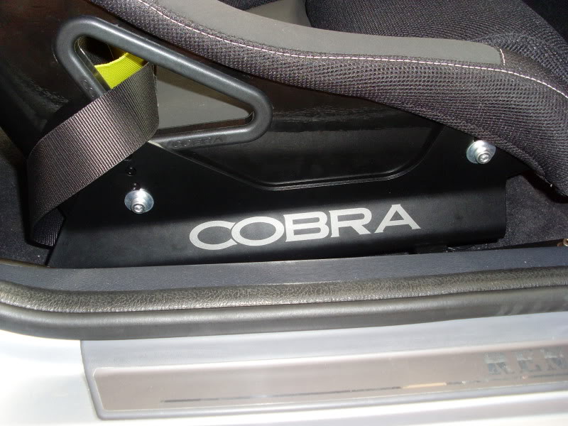

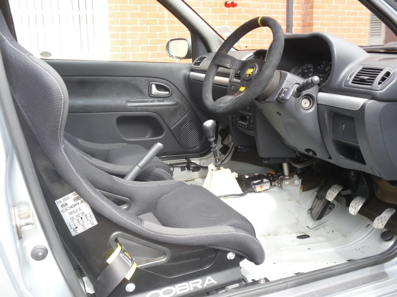

Here's a couple of mine, bolted to a strip of steel then all bolted to the box sections on the floorpan.
So in theory I can bolt my side mounts to the box section? Just by drilling straight through and using spreader plates,
Aren't omp mounts 120 ish?
  Qashcow
Yep, depending how far back you need the seat you may need to use some steel lengths like I have so you can bolt it all to both box sections. Mines been good for 2 years or so
Looks like the carpet is coming out Tuesday so I can have a proper look then and get y seats mounted, do you have any closer pics if possible?
  Qashcow
Not at the minute, but the seats are out at the moment so will pop into the garage and take some pics tomorrow for you
