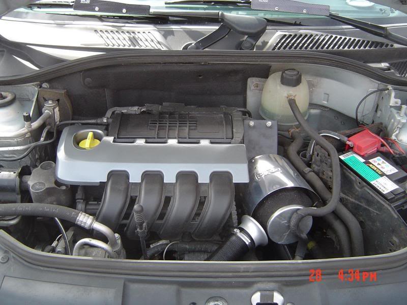

Got this type of set up atm...sorry for the nick of pic haz511, but iwtohut the heat shield and pipe :o .......aint had it on too long.........just wondering.....whats better this or just my standard air filter set up with a k&n pad????

lots of people say standard (with for example ITG panel). Me too ;)
My car had an open one on there (took it off after one week) , seemed to loose torque a bit and throttleresponse was less. Fuelconsumption was worse.
Sound was Bombastic :eek: :rolleyes:

You can nicely use that piece of tube you've already got there in the pic. Probably will fit to your airbox. Run it somewhere down below the headlight at the wheelarch. maybe your old feedconnectors are still there.
Take off the wheel, dismount the protecting plasti/rubberthing in wheelarch (soorry, Dutch) so you can reach down there... this way you'll have a nice amount of space to work.

Hi, thanks for the advice....that pic is one i stole off another clio member....i dont have the piping or heatshield just the pipercross.....seems alot of work what you are suggesting....is there an easier way?? thanks for the advice though - top guy
yeh maybe just remove battery and see how you can fiddle your caf down to beneith the wheelarch, good amount of cold air there away from engine heat
All he needs to do is just put a Sports panel filter in the original filter housing and run the original CAF or better CAF to the original place in the engine bay at the front of the battery. Gains are crap in the 1.2 anyway.
best setup i had on my 1.2 16v was the standard airbox but i cut it open and modified it to allow it to flow more air, K&N Pannel filter and larger, wider CAFgoing to the standard cold air duct behind the front grille (ull see it, it leads to thebattery bit)
