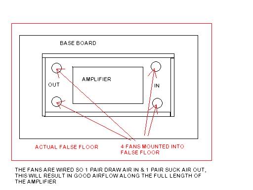

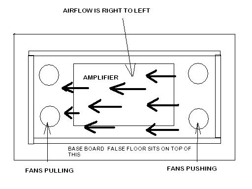

If opting for boot mounting under a false floor you simply design a full width compartment, then fit either 2 or 4 fans to supply good airflow....

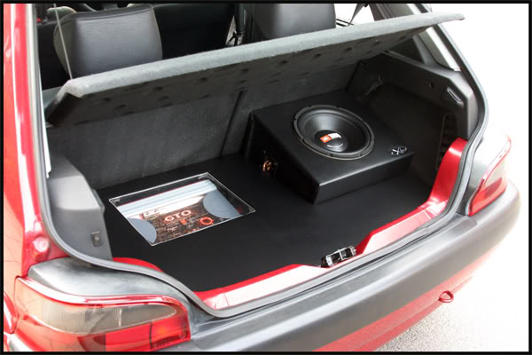

A few pics;

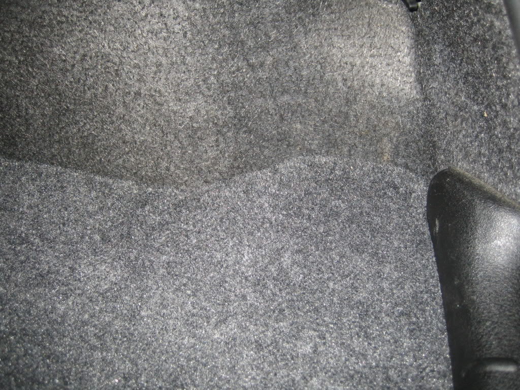

i did mine like this, building a woodern frame to support the sub box and amp under the false floor. dont have a pic of the floor and box retrimmed though but it gives you an idea

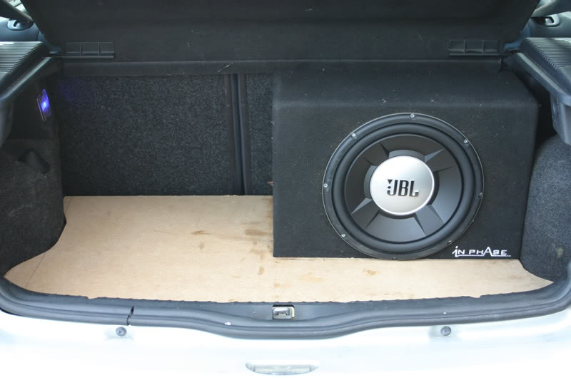

will look like this one i did in my bros old car but without the amp window
thanks guys that boot build is very nice but i realy need as much boot space as possible.

no probs mate, the woodern frame leaves a large air gap around the amp and in some sections the frame itself has been left with cut outs to help airflow but other than that i dont have any fans etc. this is the same method i have used in my old car, i ran that for 4 years and never had any problems. my brother has also has got the same setup in his clio now, it too has been in for over a year and been fine

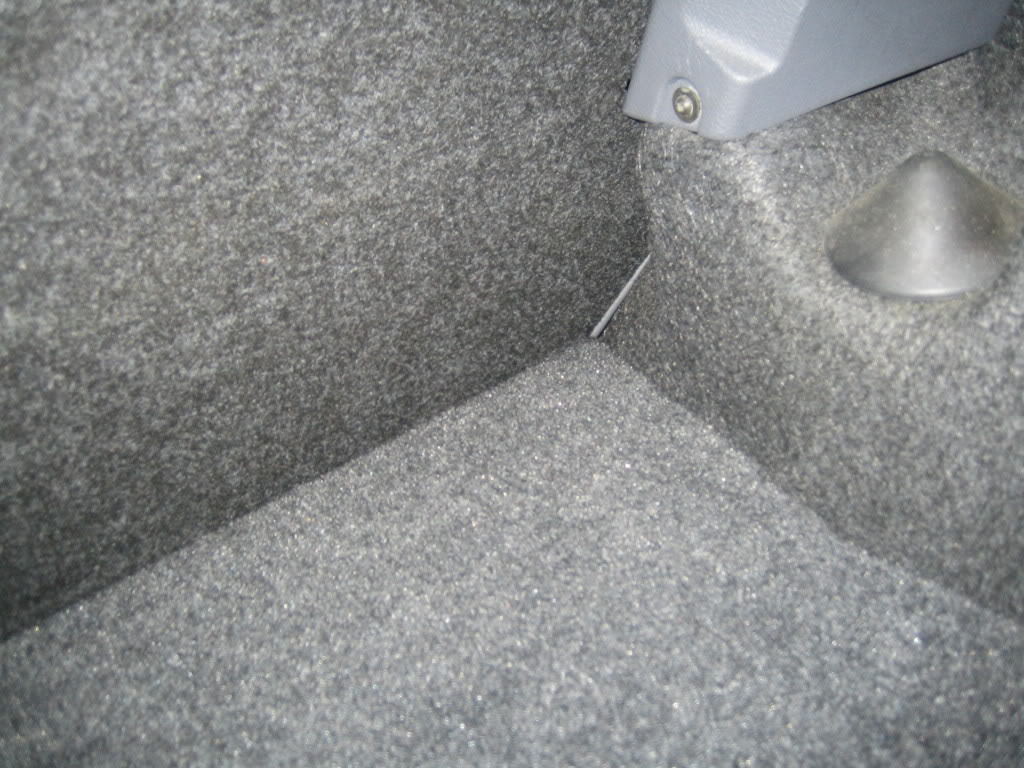

Cardboard is what i used to make mine.
Once you have built the bottom part of the false floor get a large sheet of cardboard and draw around your old boot carpet with a few inches ouround it and cut it out. Whack it in the boot then go round the edge carefully with a stanley knife. Once your happy with it draw round it on the mdf and cut round it. Leave a few mm for when you carpet it though so you can overlap the edges.

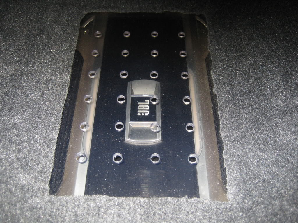

And for cooling my amp i used:
looks nice :) i'm new to the whole ice thing and i had a friend of my brothers show me how to wire up the amps etc. how would i go about powering a couple of PC fans for underfloor cooling?
