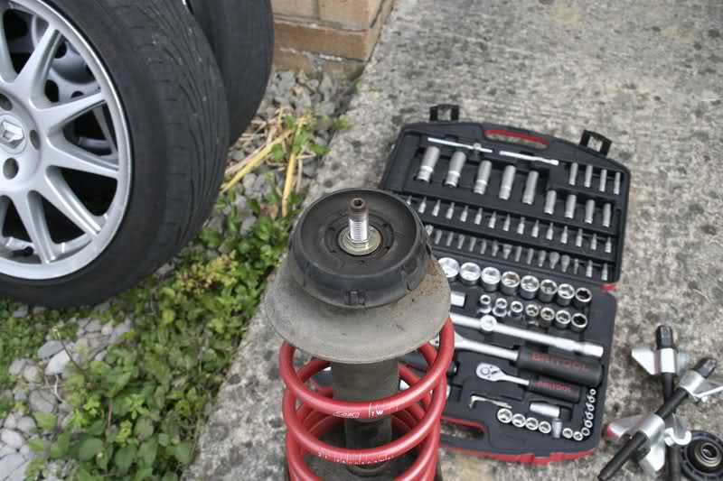

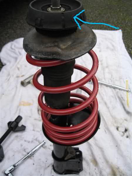

Had a knocking from my front suspension since owning my Cup, the 'washer' fix made no difference. Fitted some Eibach springs today so had the dampers apart and noticed that when assembled and all done up tight i have 'play' in the top part, when you shake the rubber part it feels loose still. Could this be where my knocking is coming from?

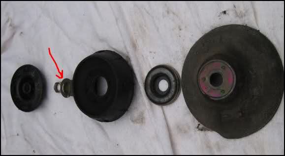

Borrowed pic from Fubars site (cheers in advance)

Are these rubber bits in the photo the parts thats repalced with solid mounts?
If so would that not resolve the knocking issues?
I think the solid mounts are the proper fix for this, yes.

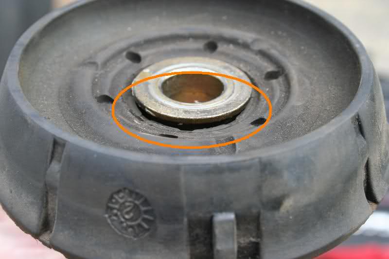

I know what you mean, replaced the top mounts when i fitted my coilovers on my Ibiza Cupra and they were lovely, thats why i was concerned when i felt the Clio ones. I take it this is the sleeve that needs reducing....

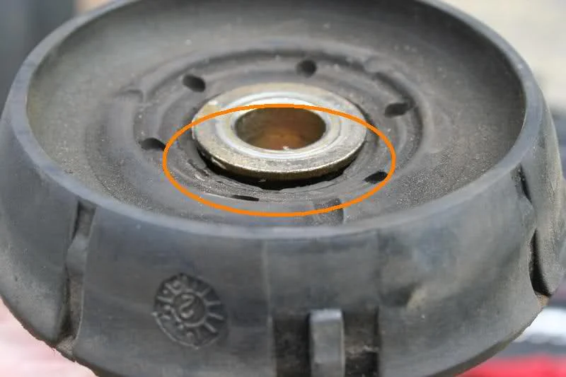

You can actually see the gap here....

There are two causes for the knock. 1. The part above the inner wing hits the wing due to the flex in the rubber. This is resolved with the washers or grinding the wing.
2. Play in the mount assembly itself.
To me to sort them once and for all you need cut down this sleeve. If they still knock then fit the washers, but they are seperate issues.

EDIT....Looking at pic above, i'm assuming that your saying the rubber inner is loose. So possibly grinding the bush may extend the life of the inner.....i see.
The main thing shortening the sleeve does is reduce the up and down movement of the rubber itself thus when you tighten the 17mm nut it tightens close to the rubber but still allows movement and rotation but iff you did like my 1st attempt take too much off the sleeve it tightens up nicely but it too tight for the strut to rotate and you damage the rubber as that the part that rotates instead of the bearing
