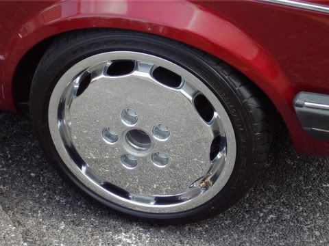

for my best results i started using wet n dry, depending how good the start surface is, go from 240,400,800,1500,2000,4000 but you have to remember you need to get every scratch mark out as you go
heres one of the wheels i have done
http://i22.photobucket.com/albums/b318/jasonfox/IMGP0185.jpg
all the polishes you have probably used (peek autosol ect) are all finishing compounds
if you want to use a refurb company most will just diamond turn them on a lathe which isn't great, and proper alloy polishing firms who do a proper job want 20-25 quid an hour, at anything between 2-6 hours per wheel
you can get good results doing it yourself, but its hard work
