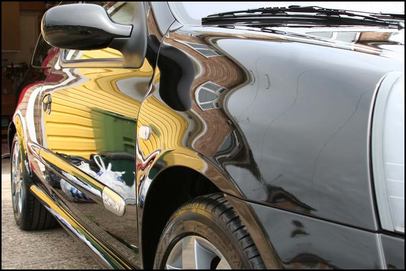

Can't go wrong with good old Autoglym Super Resin and Extra Gloss on Black (Below)

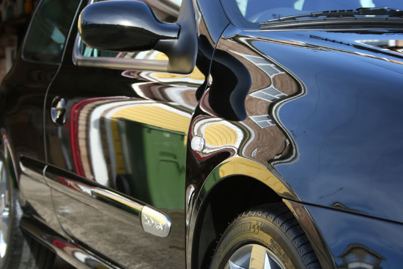

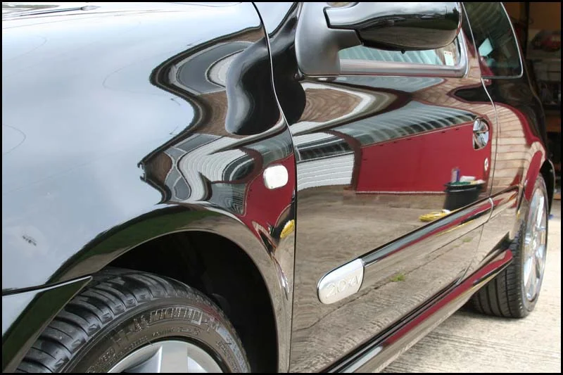

I currently have Wolfgang Sealant, with Pinnale Souveran and Poorboys Nattys Blue Waxes on mine. (Below)
