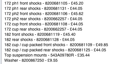

my other question was in my intro but nobody replied so i try it here..
i want to change my shocks maybe for beter handling/response..
(car 172 non cup) i want to maybe order cup shocks with maybe other springs.
so my question is what are the part numbers of the cup shocks (172!) cause i live in holland ther were no 172 cup only 182 cup.
so thats why i ask this. i ve found some info of them only i dont now if its truth(info is down message.) ore maybe can someone give me his VIN of his 172 cup cause i have oppertuntity to look at dailogys. and is i truth that cup are 15% on front and 5% at the back.
