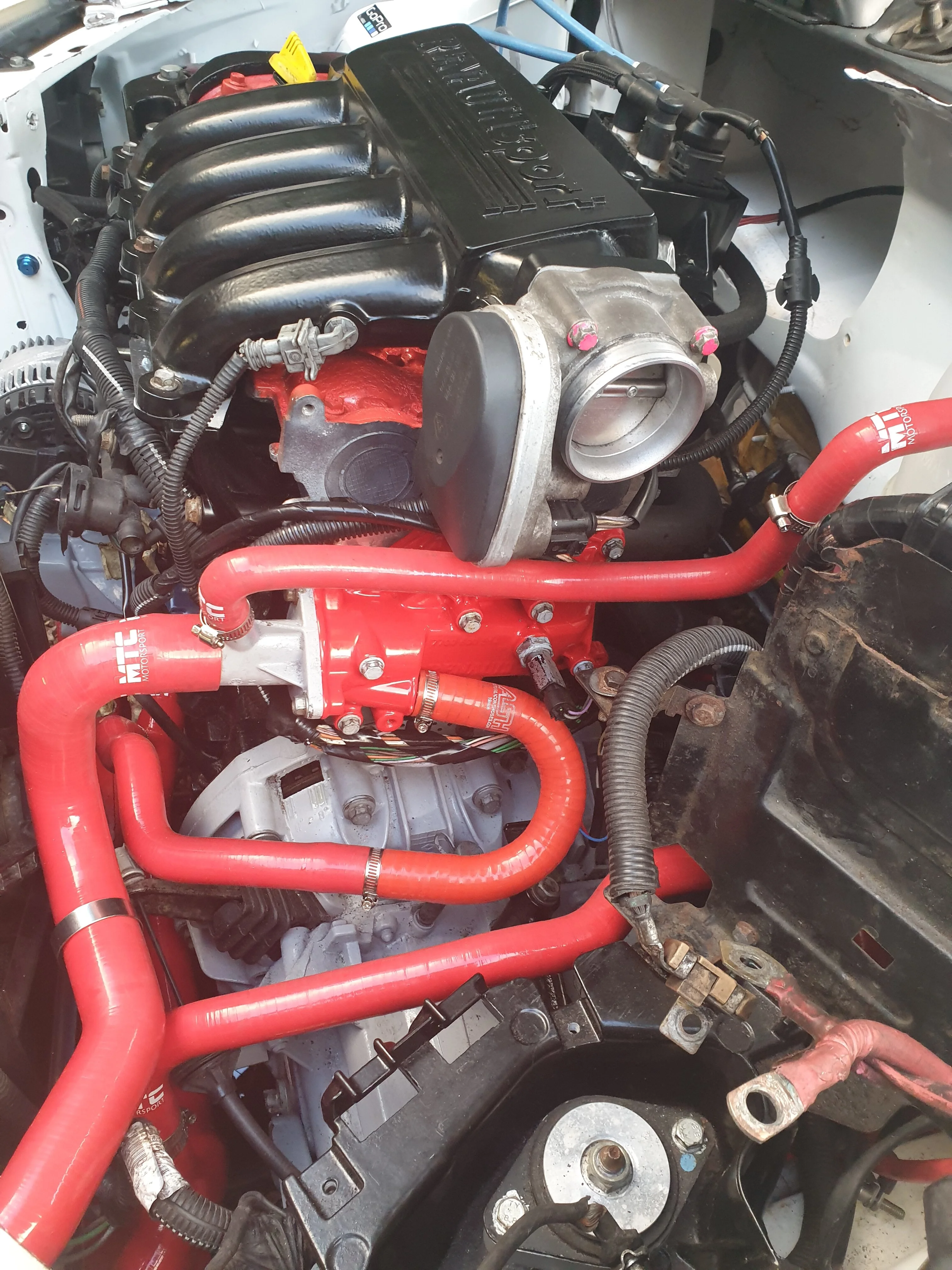

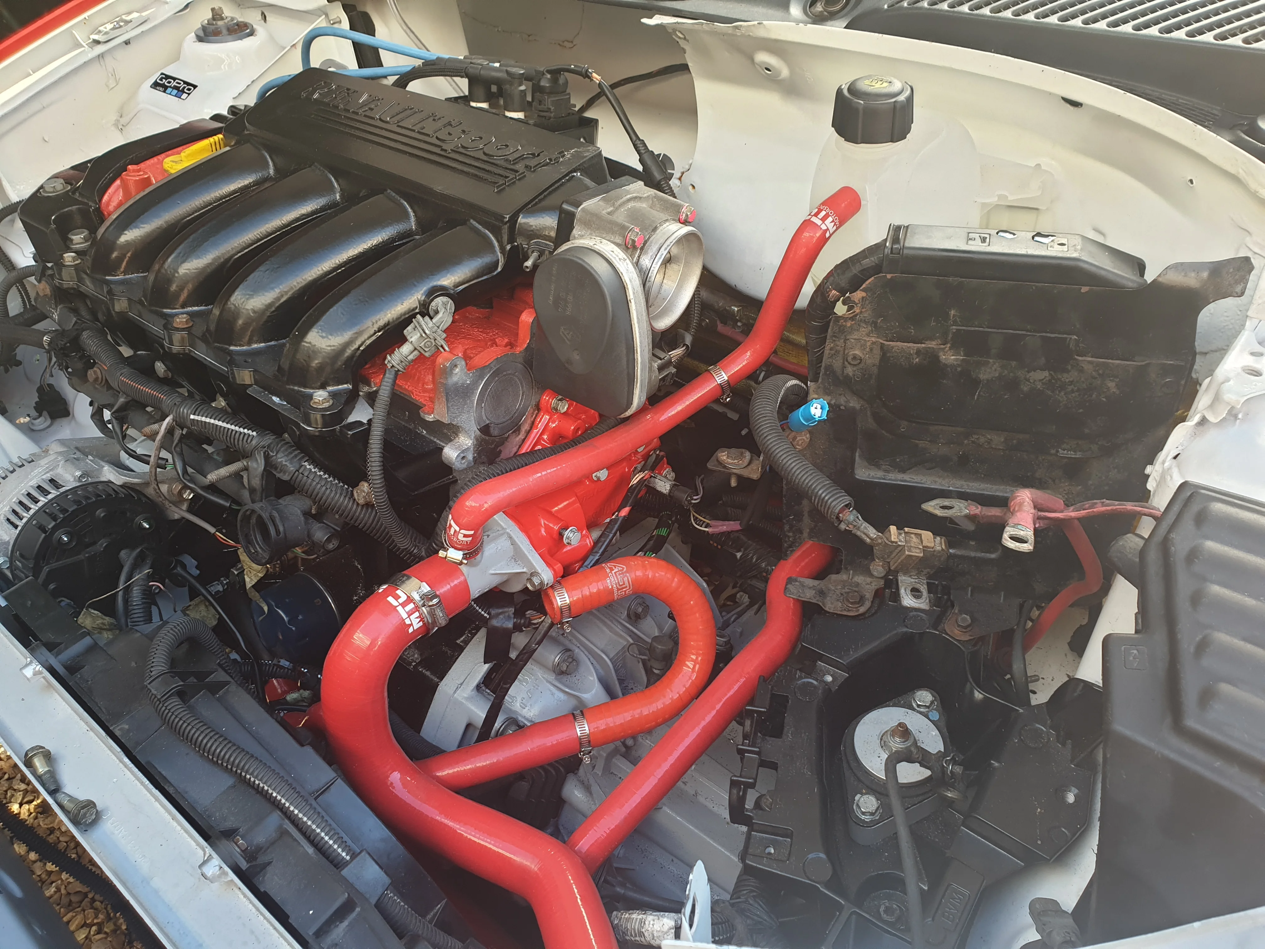

Received my new thermostat housing from @Kev@KAM hoping this solves the leak. Torqued them to 11nm , scared im going to snap one of the m6 bolts !
Stripping down for new gasket.
New Gasket in place , fingers crossed this fixes the leak 😬

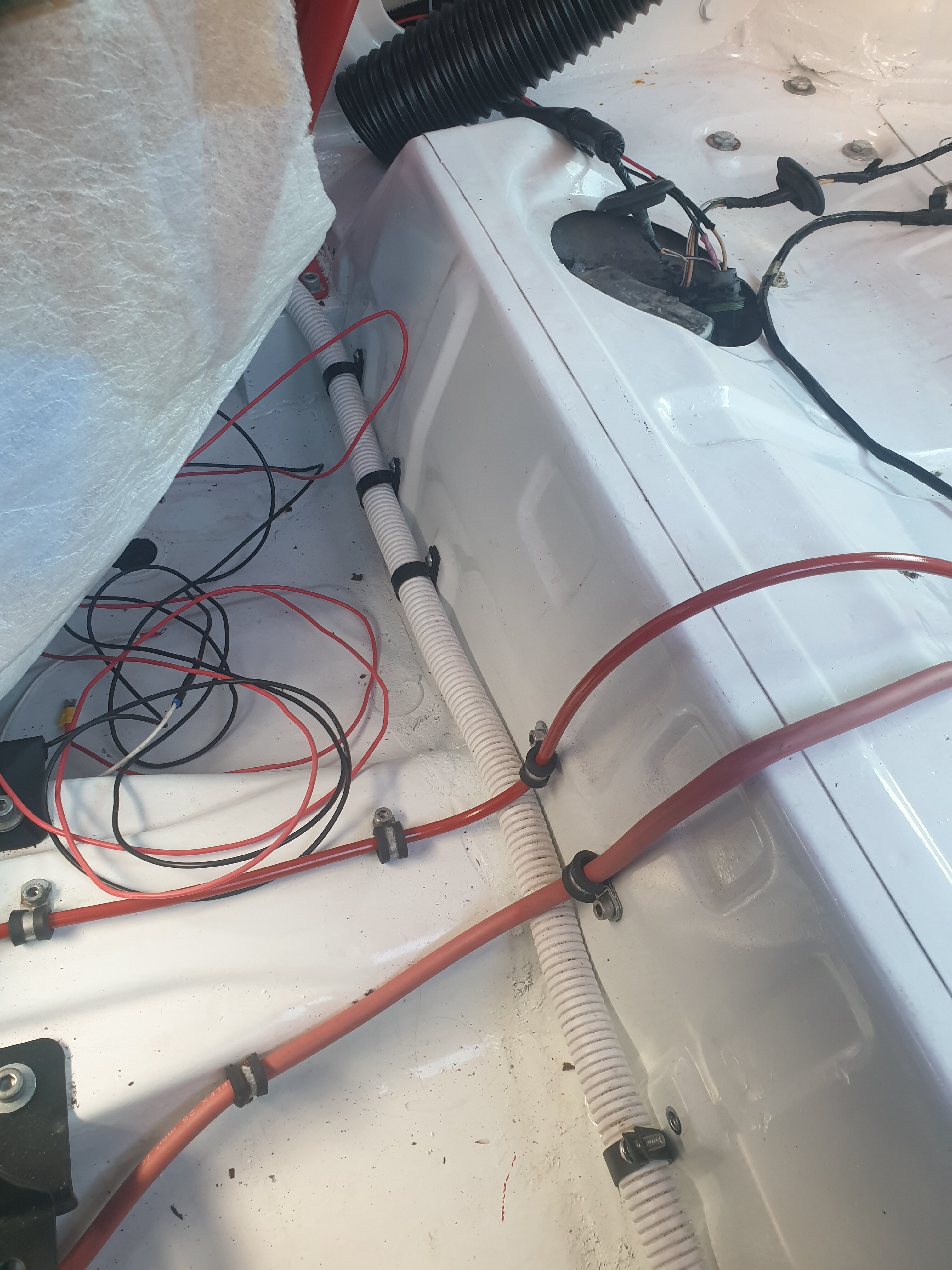

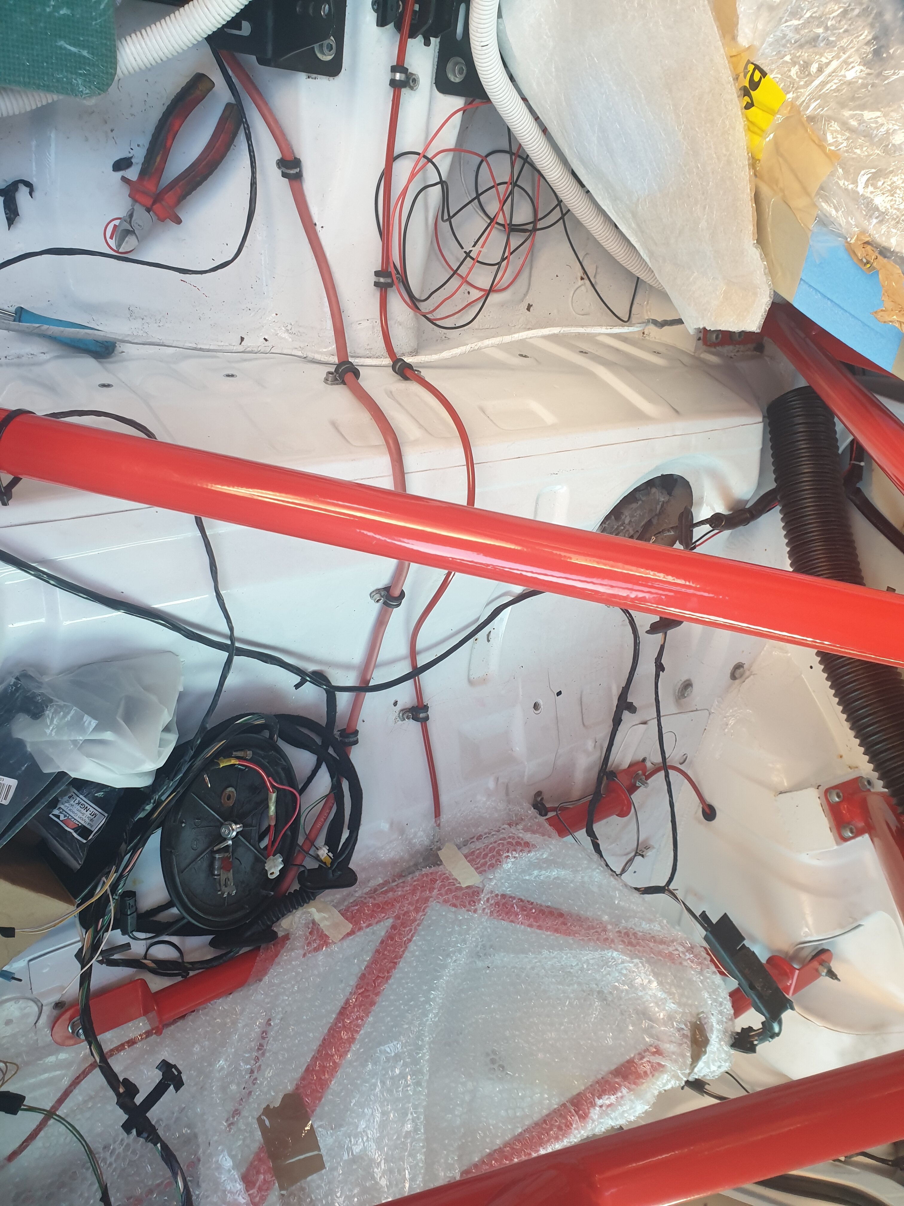

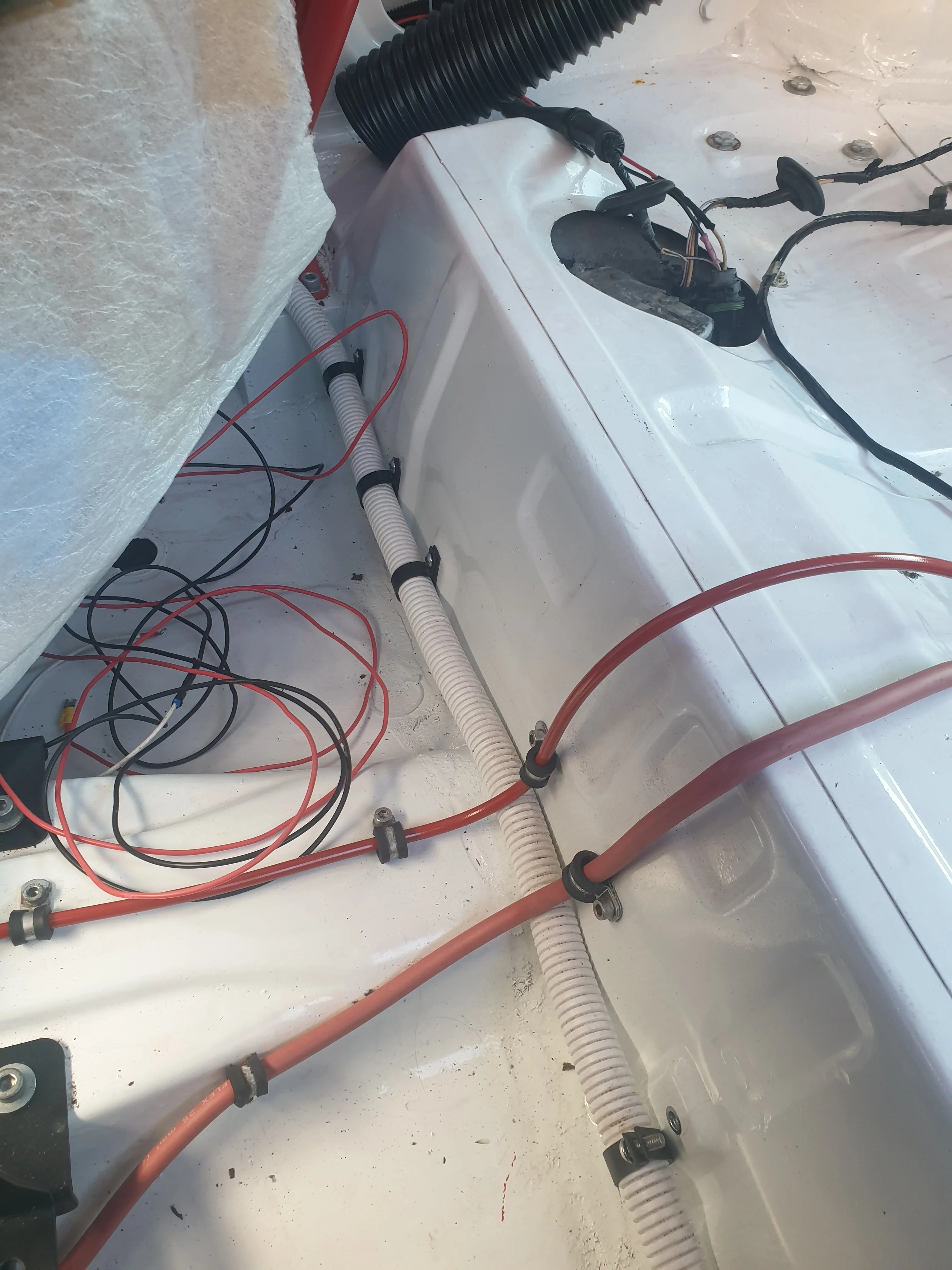

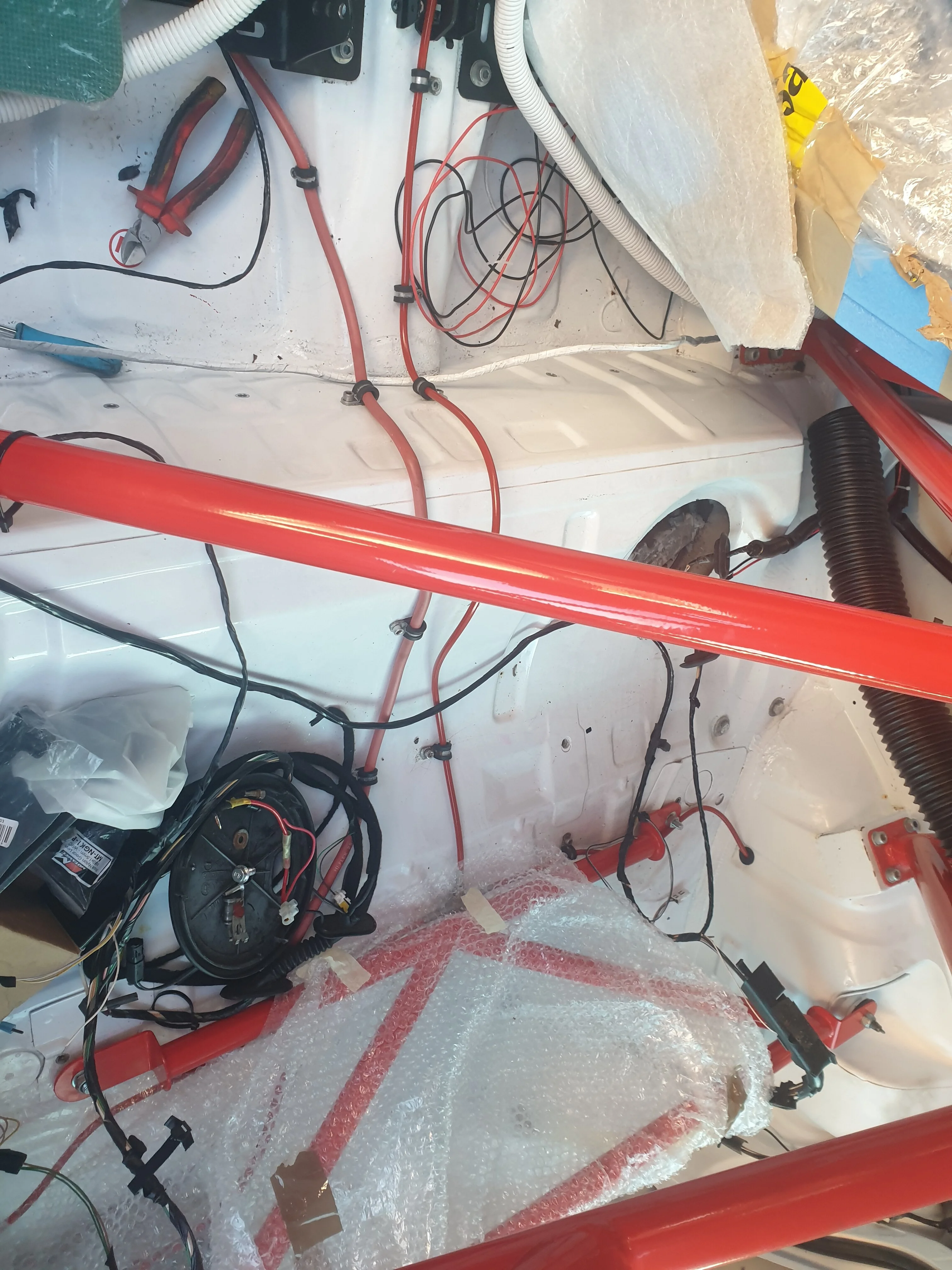

Starting to sort out the wiring now that the car is starting of the key ok.
The looms are just running in the car currently.

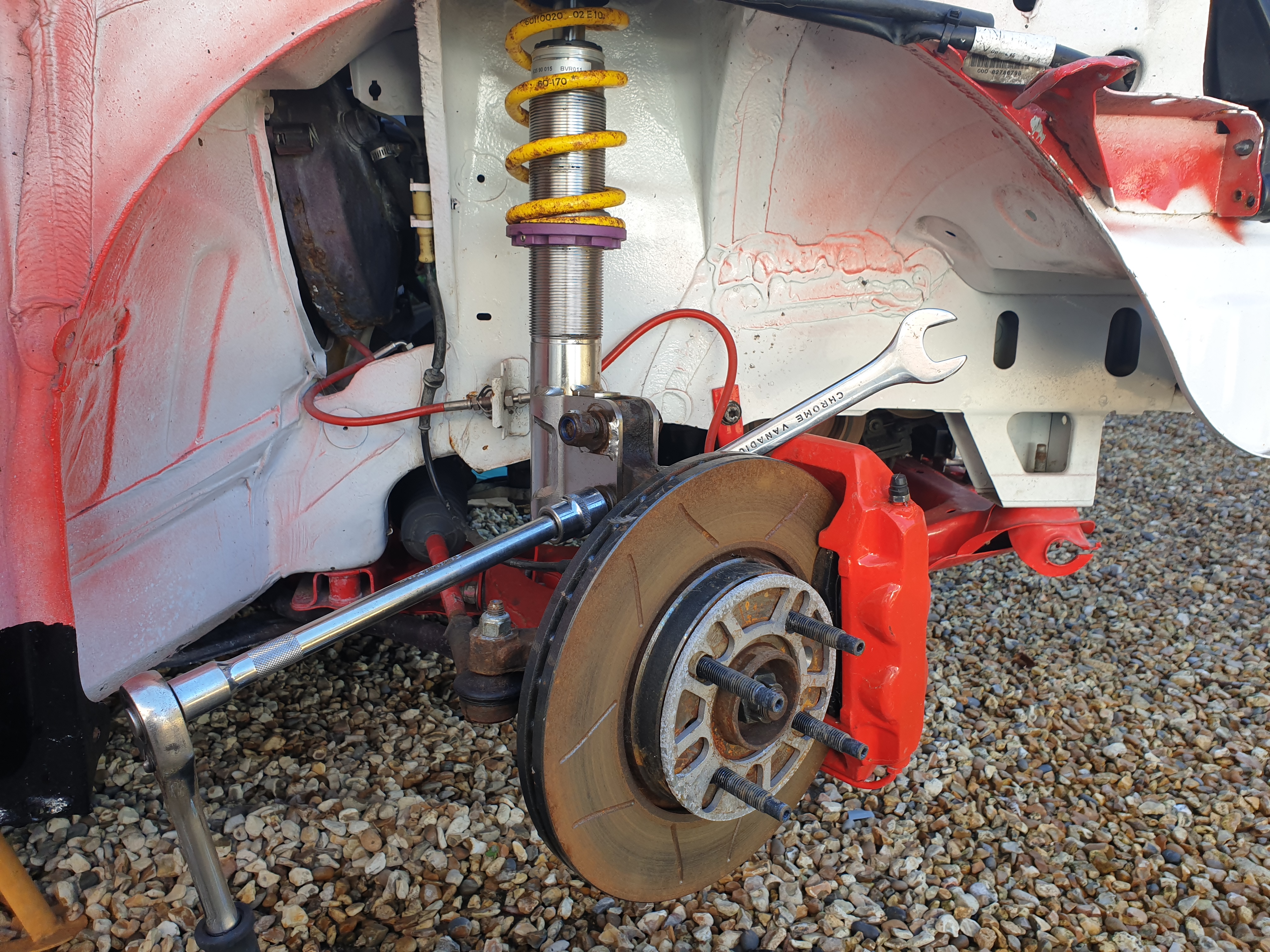

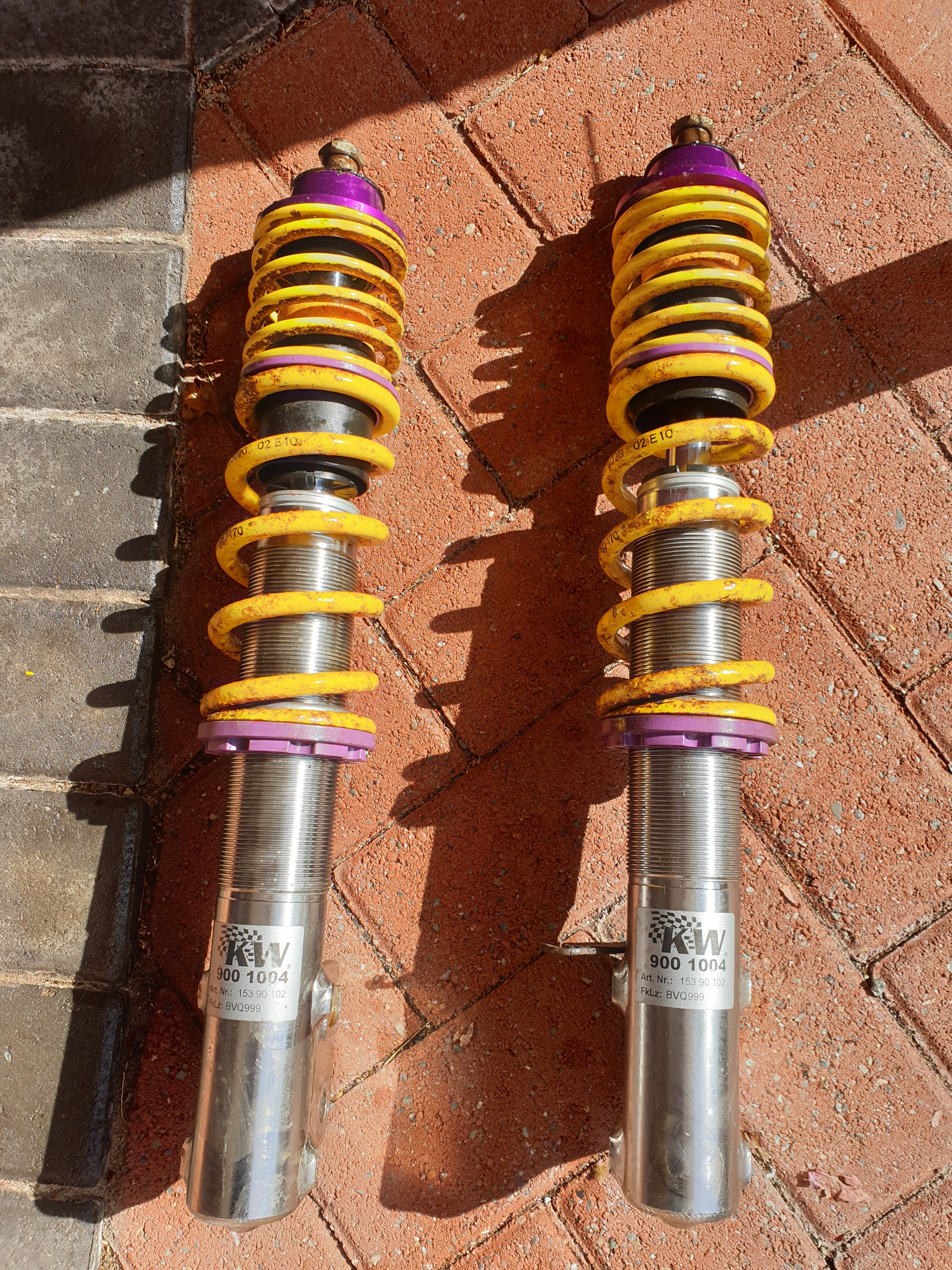

Removed the KW V2's as these will be going on my white road car.
Got to give credit to KW for the quality. Ive had these shocks 10 years. Yes they've not done many miles but still.
