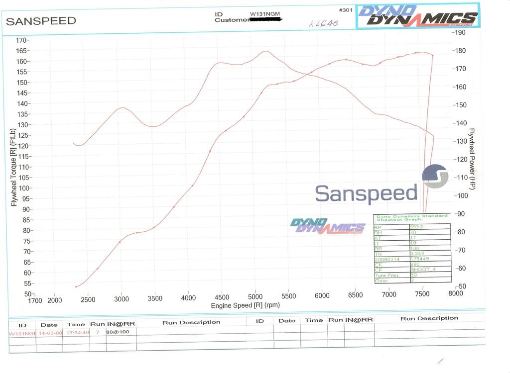

Bought the ph1 172 a couple of months back. The previous owner kept telling me how it needed remapping to get to its full potential.
The car spec
- Cat Cams 420's
- Open induction kit relocated to behind light
- SS exhaust + Decat
- Group_N ECU unlocked to work with car

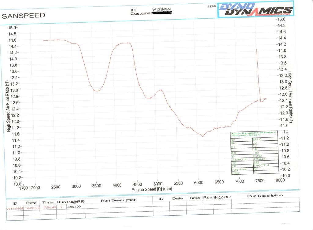

Apparently it is overfuelling but i have no idea on power graphs so thought i would post it up to show people who may have a clue. Would a remap totally transform the car and how much would i expect to see once its been mapped to suit the cams?
Power Graph
Fuel Graph
