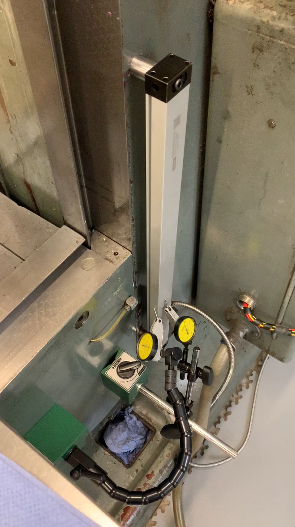

Ended up mounting the dro to the original mounting for the old dro, just with an extended arm. Also bolted the switch panel to the arm so its now not at ankle height, much better. Still have to align the z axis and fit the rest but its nearly done!

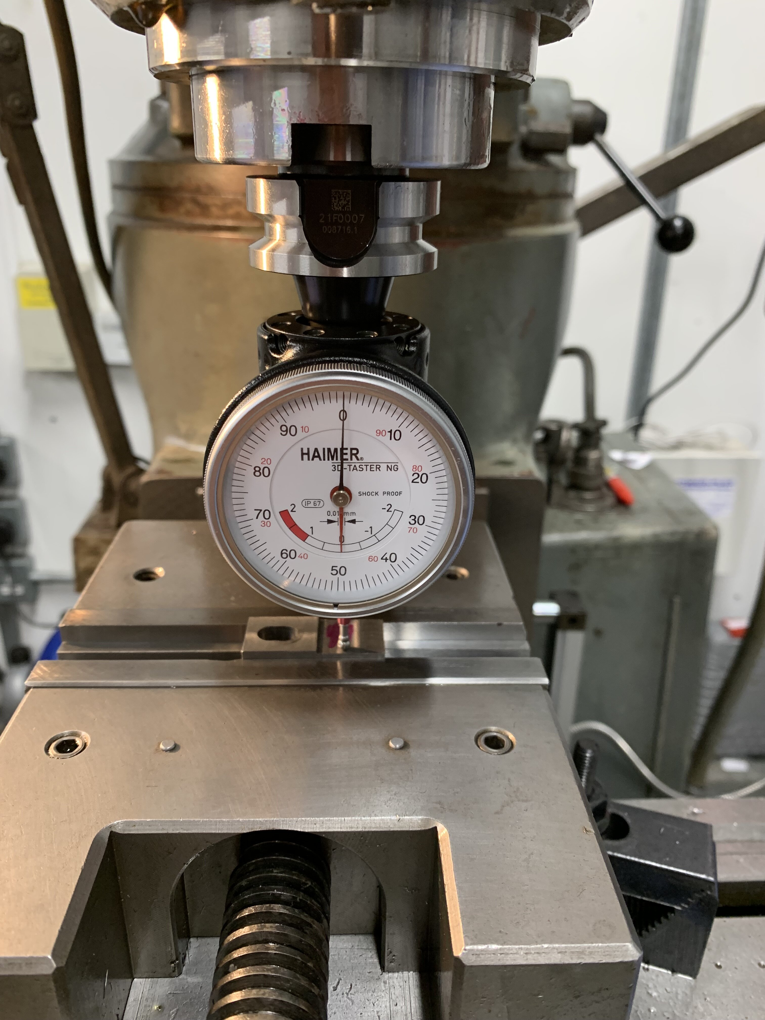

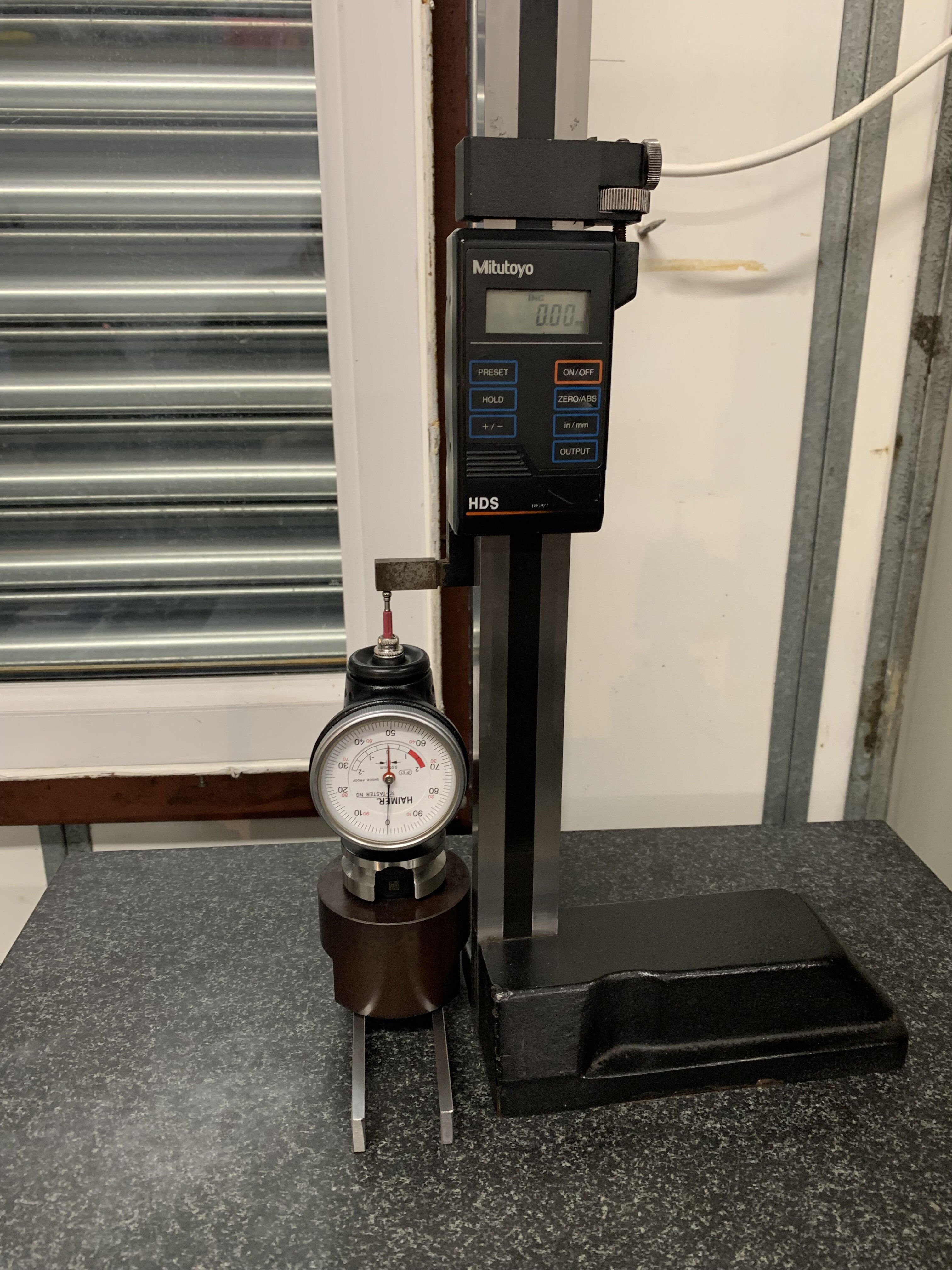

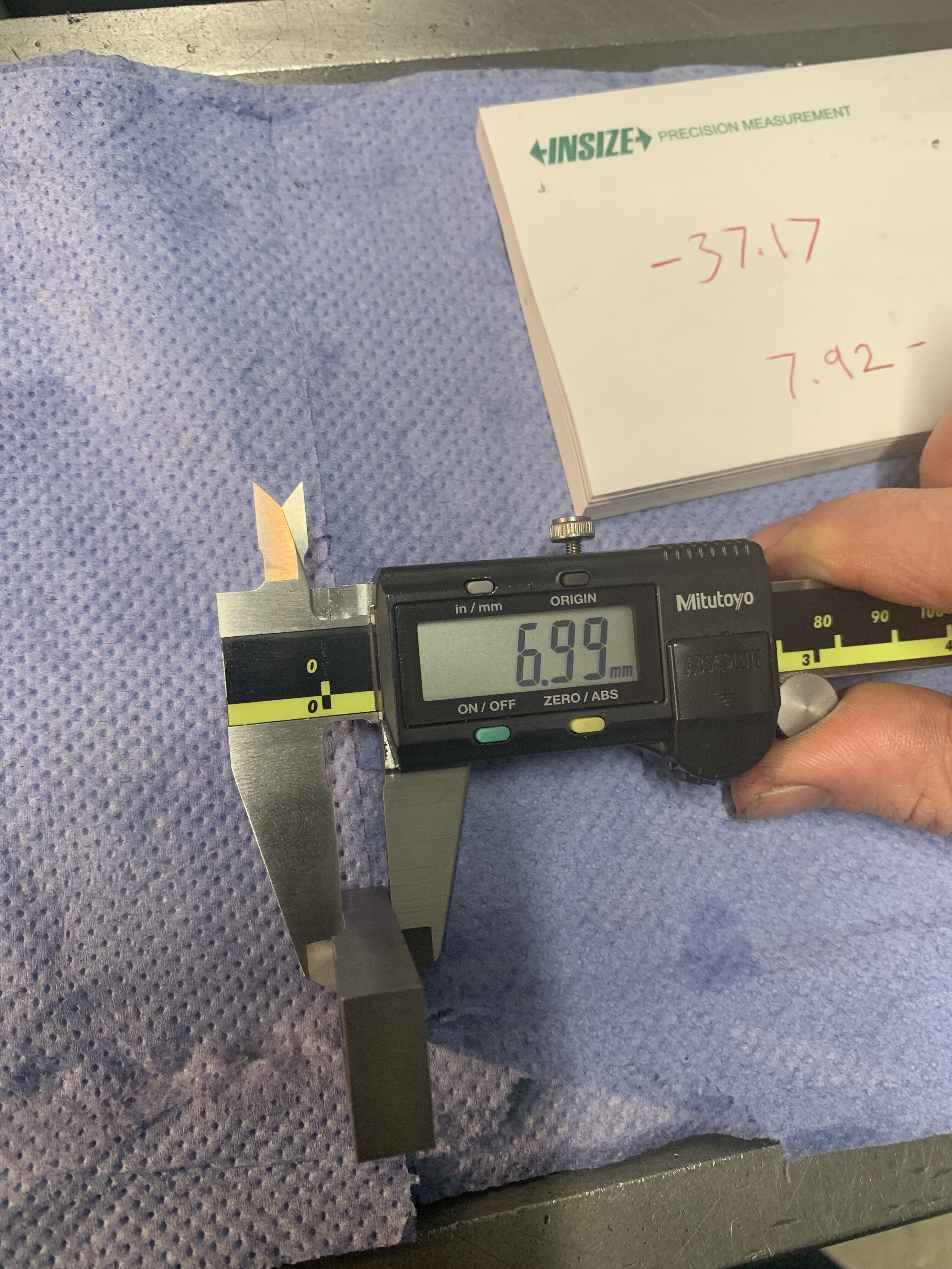

Z aligned and tested. Very happy with the results, I think I need to put a little less pressure on the height gauge. Considering the gauge and the calipers are 10um I think this is perfectly good for an old dinosaur, helps having the haimer probe!
Cable management will be done when the rest of the scales are fitted. Y should be much easier as less to do and more space.
Aimed for 7mm. I think If I can be with 0.01+- Ill be chuffed.
