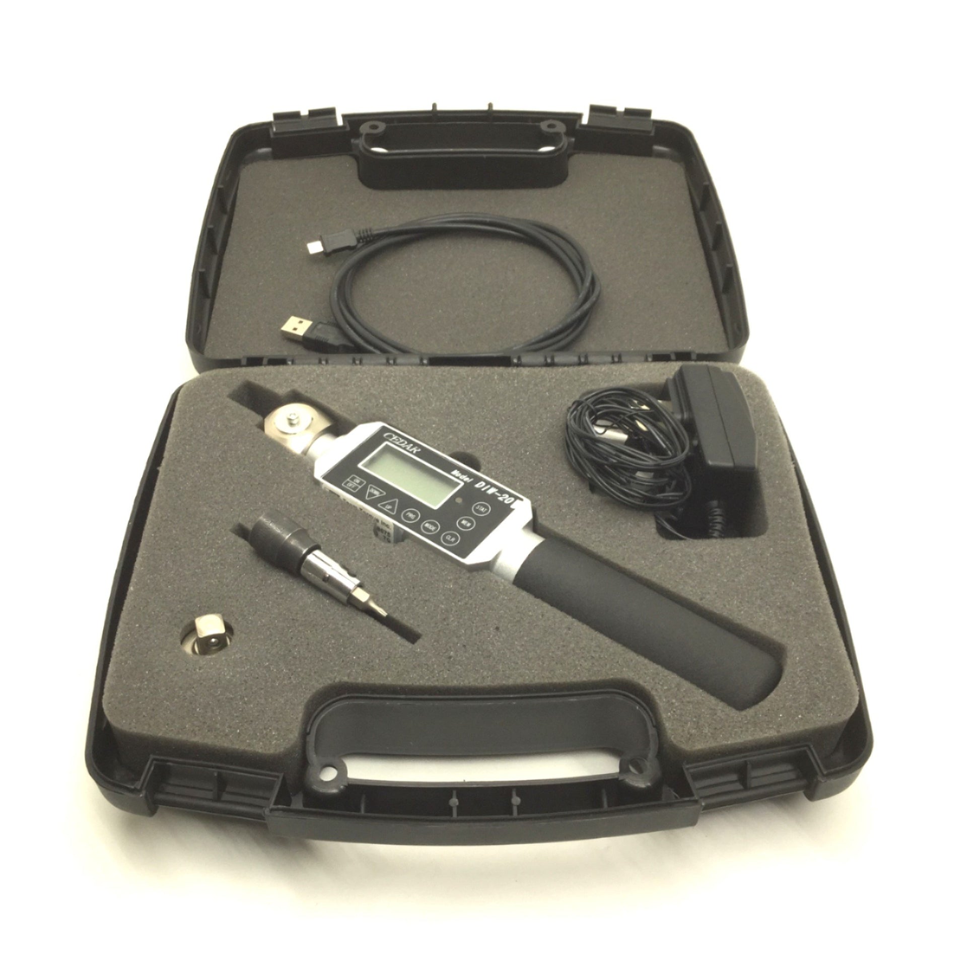

I'm looking for a digital torque wrench with usb output for live/continuous data recording on pc and have only found one company that do the sort of thing Im after. Anyone know of something or have any ideas? @Flob
I don't know of any mate, but I know the are very common in factory setups where bolt torque has to be recorded for QA shizzle.

I received a good offer from the seller so bought that one for £200. I need it to be continuous because its for measuring steering rack pinion torque.

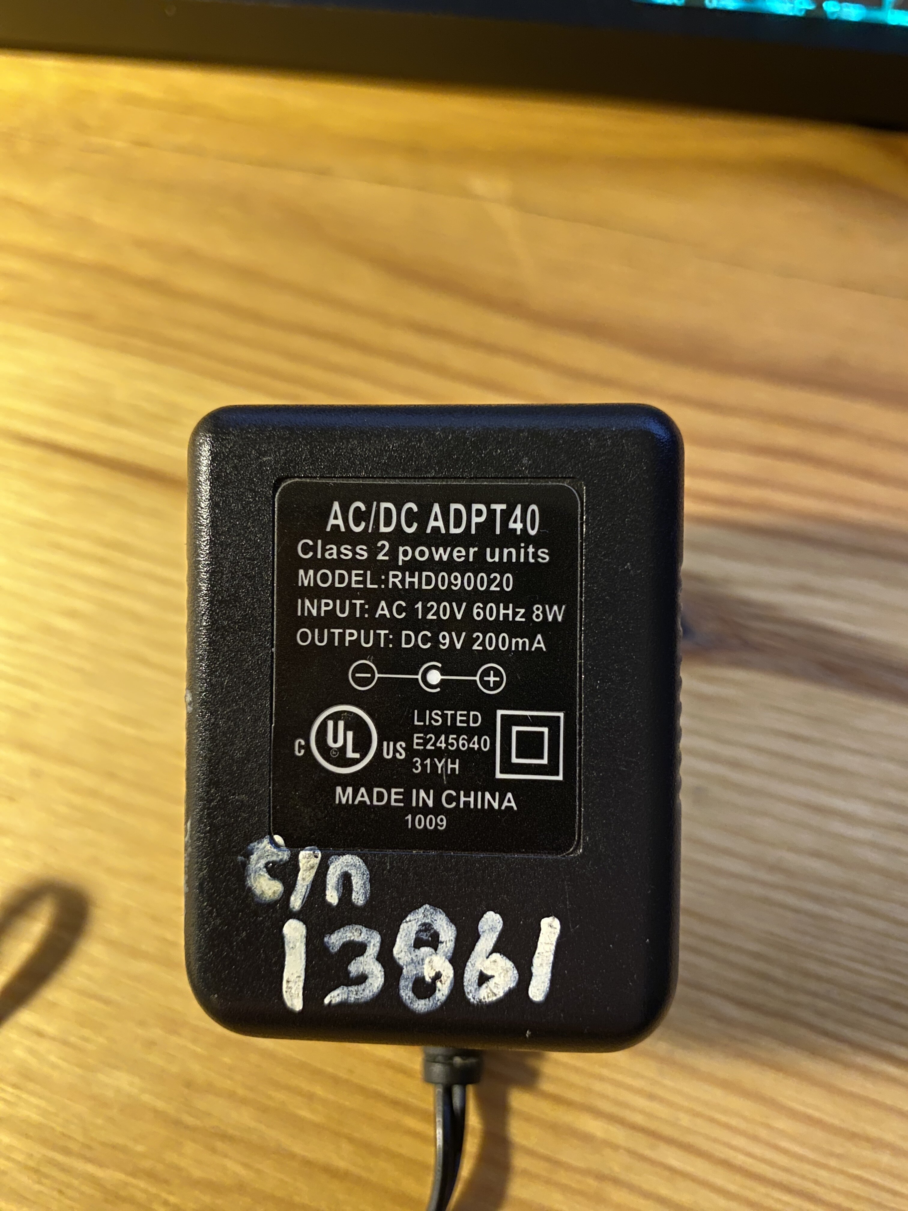

I need a uk ‘3.5mm ac/dc power supply’, don’t know what they are technically called, ideally exact spec as not sure how important it is. Seller pictures showed it turned on but with a adaptor plug it wouldn’t turn on.. 🤔
Just google for a 9v dc 200Ma output power adapter with whatever jack you need, loads on eBay, Amazon etc.
As already said tho you’ve potentially fried whatever your plugging this in to.
I wouldn't say hes fried what hes plugging into unless the adaptor has royaly fucked up inside when hooked to 240v, i was meaning the adaptor would be fried

The power brick is likely a transformer with some kind of protection on its output - if it had no protection the output would have gone to 18V and potentially hurt whatever you plugged into it (if you had anything plugged in at all).
Cut the plug off - use the connector from your power brick.
Heads up though that the cells are likely shagged so going with new cells and en external charger is possibly the best option anyway.

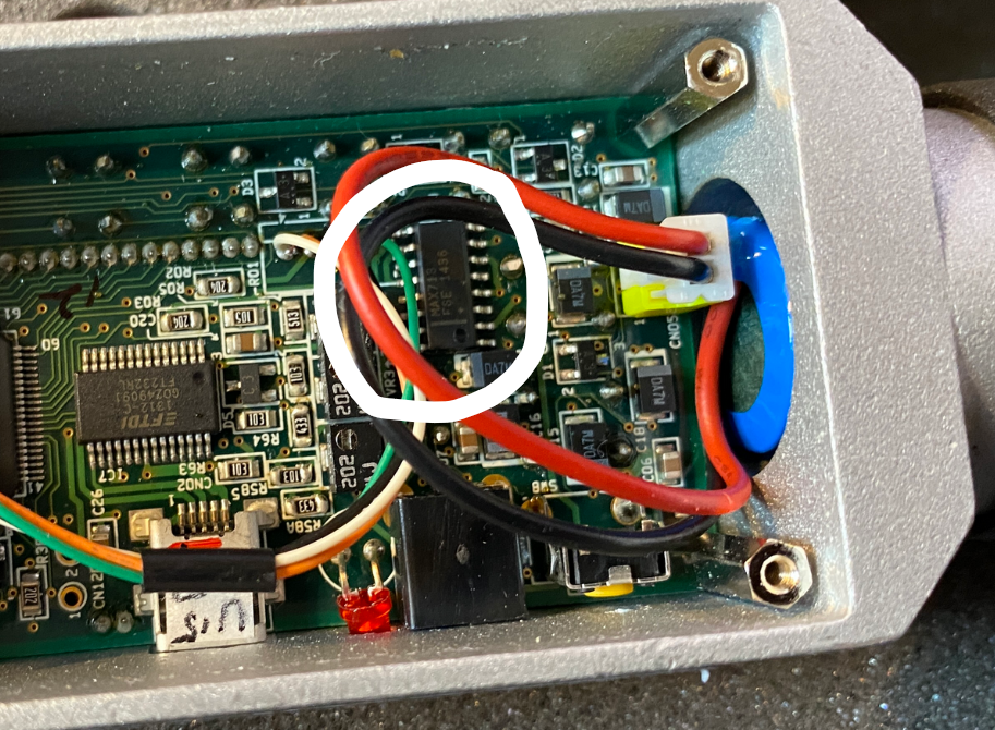

Good news,
Thats a charge control IC. So you can plug any 9v power adapter into it. Doesn't have to be 200mA output. Some really shitty stuff charges NiMH cells very slowly and relies on the current limit of the power supply rather than anything intelligent.
Bad news - its been designed by a dog shagging c**t because you have to pull the PCB out to remove the battery and the hex stand offs are super close to the edge of the box so a normal nut driver probably won't go on.
Good news - its a standard looking NiMH battery which will be easy to buy.

Might be of value, I plugged in the usb to pc and it registered something was connected, wont turn on though, didn't before I tried to charge it.

USB would have enumerated, it has another chip with a FTDI label on it that deals with USB and will do that without the processor running. That charge IC says it will accept upto 20v input but I would stick with the 9V as I haven't read the datasheet deeply and I don't want your new toy to catch fire because I've given shite advice.
