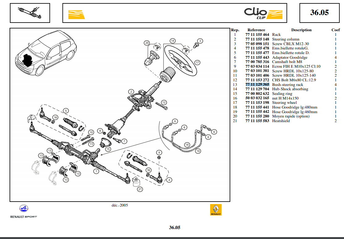

Yeah I would expect a lot more than that, mine wasnt tracked in that time as well so not exactly like they were under a lot of stress. Ive got solid nylon ones now, zero play.
Is that in the rack? Who did those for you?
